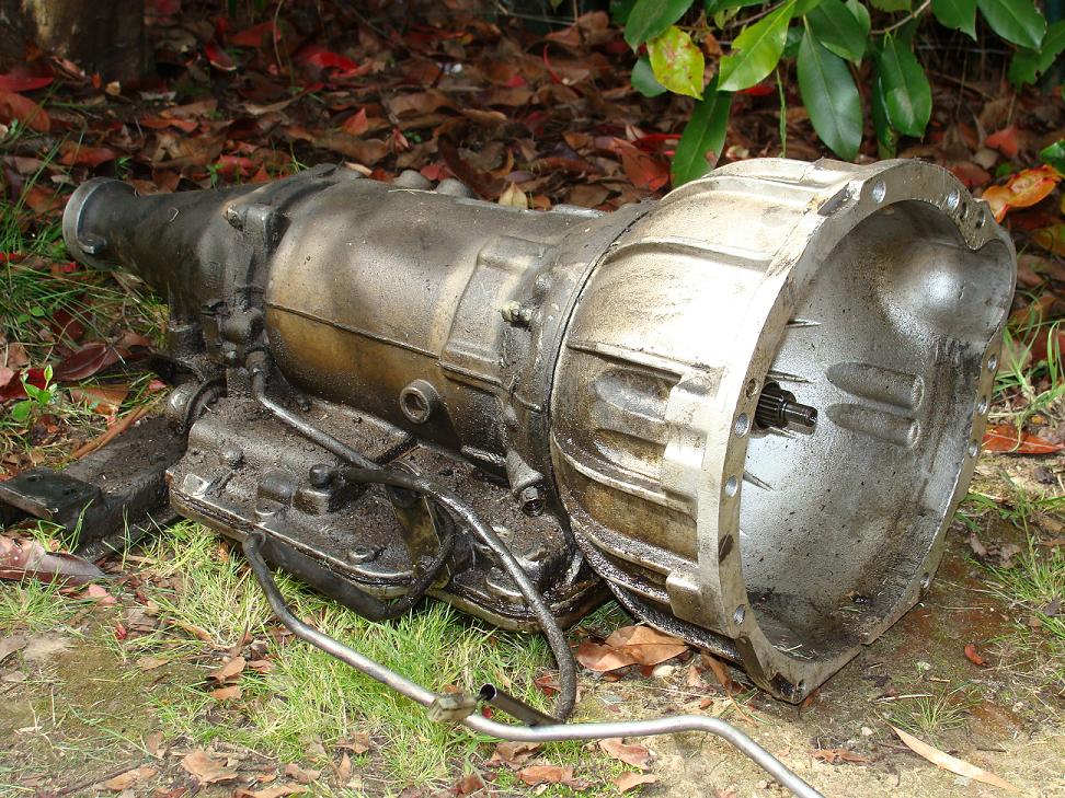

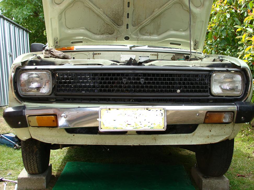

Have just removed the rolla GMH TRIMATIC auto :P So I should hopefully have the 5-speed in by the weekend. :P
Here's some pics of today's progress. :lmao:

Well things haven't gone all that smoothly when I went to put in the ke55 5-speed. :sob: First off I tried the manual gearbox crossmember up against the floor and it doesn't quite reach the holes. :P
So then I slid the 5-speed under the car to see if everything else matched up, but you guessed it, the 5-speed shifter position didn't match the hole in the floor, and the rear mount was way out. :P :sob: (to far forward)
The car is a 1980 ke55 auto and the 5-speed I have came out of a 1980 ke55xx manual coupe, so I thought all I'd need was a manual crossmember which I bought and it would bolt straight up to the floor, but it didn't. :sob:
So now I decided that I need a ke70 5-speed rear extension housing to bolt onto the ke55 5-speed box, which should solve these issues and all SHOULD be sweet. :hmm:
Nothing runs acording to plan :bash: Anyway I will start pulling out the auto pedal box and putting in the manual one and HOPEFULLY that should be all smooth sailing. :yes: :y: :y:

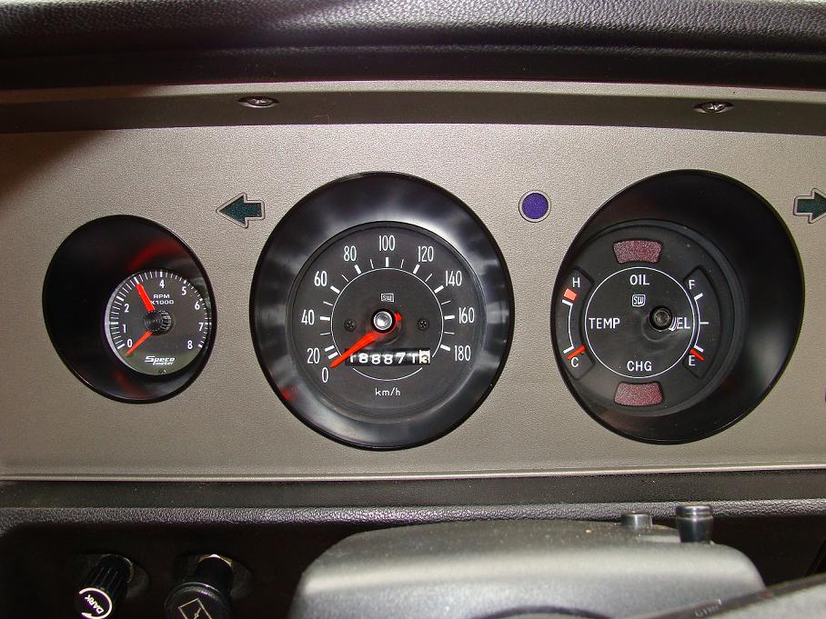

I decided to install a tacho in place of where the clock was, while I am waiting to sort out my 5-speed gearbox. :y: ;)

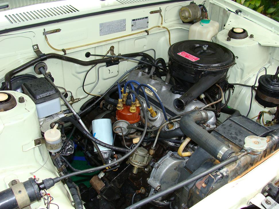

I also gave the engine bay a degrease, and now you have to put on your sunnies when ever you lift the bonnet. ;) :wink:

wow that is one clean engine bay, I also love the taco it looks like it belongs there. good luck with the 5 speed conversion.

Is that a 2" tacho you installed? Whats one of those worth?
