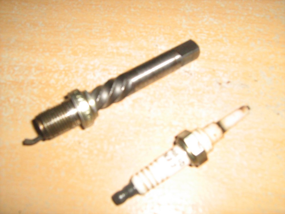

Today I decided to check the plugs and clean the oil out of the plug valley in the 4age i just put in the misses seca as I have never had the plugs out, I cleaned the oil out and managed to get the 1st 3 plugs out fine but the last made a click and came out (oh dear), I looked at the plug and realised the earthing electrode was not on the plug anymore and it had broken off just below the hex on the plug so i raced up to work and got an easyout (also know as a screw extractor) and after 20mins managed to get the rest of the plug out (thank phuck for that), But anyway here is a pic as to say DON'T OVERTIGHTEN YOUR DAMN PLUGS.

I'd say you are lucky you got it out with an easy out, because those ones are tapered, all the stress is placed on one part of the easy out and more often than not they break, leaving hardened steel easy out stuck in the middle of the thing that was stuck in the hole in the first place....

I know I'm lucky to get it out, If that didnt get it out i would of been taking the head off, I can't believe that someone would do them up that tight, When I was doing field service on forklifts i used to just spray the threads with lanolin as they were only in there for 200 hours.
lucky to get that one out :) good work on the screw extractor!
