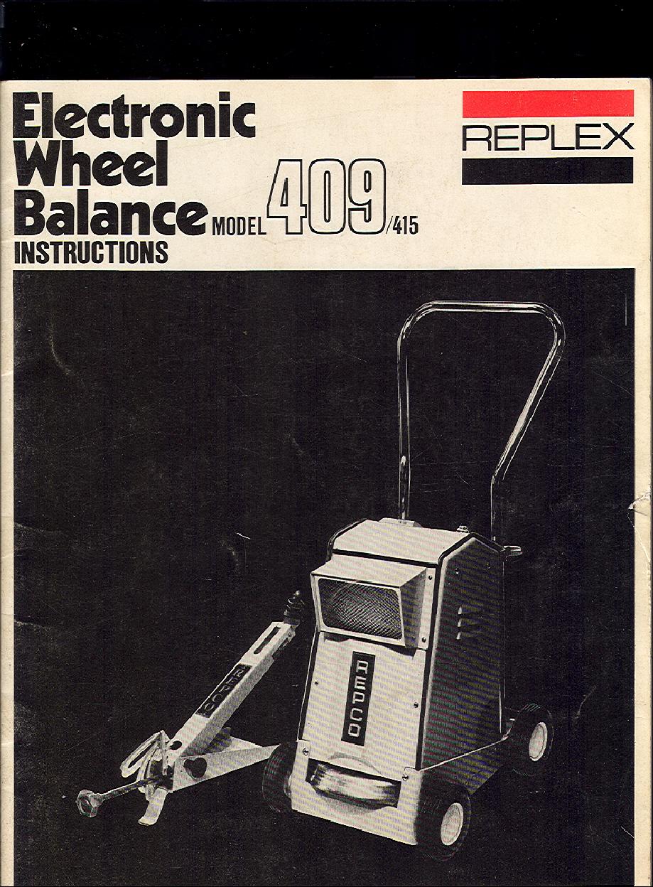

KE30_KE35_KE55 Posted January 18, 2009 Report Posted January 18, 2009 Hey Hey, I put my wheels off my ae82 twincam on my daewoo cielo and there is always a vibration at 100kph like the wheels are unbalanced. They're 15x6 and 195/50/R15 and a tire shop my boss and my self have balanced them and the vibration is still there but its only there with these wheels and tires. When i fitted them they fit fine on the studs and they are the same stud pattern. Any ideas Get an old school on car wheel balancer and do the balance on the car. or use some balance powder. Quote
