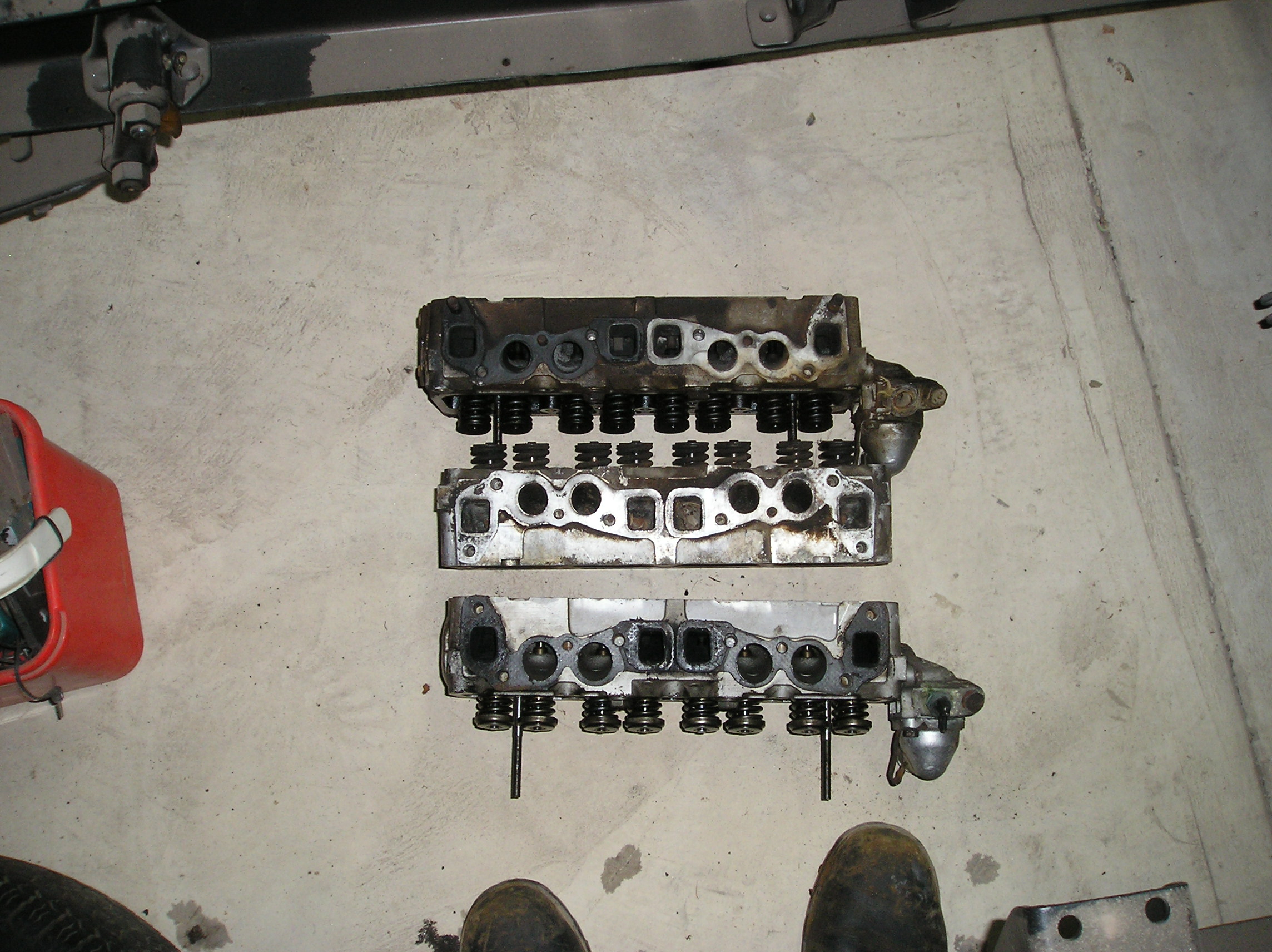

KE30_KE35_KE55 Posted January 30, 2009 Report Posted January 30, 2009 (edited) Considering the valve is probably 38mm at the most then it probably is too big. All the texts that I can find on porting, and any work I've done seem to indicate around 30-32mm wide. The bigger port the better flow its that simple, just because a exhaust valve is say 27mm you wouldn't run a 27 mm exhaust system. I have a standard big port head I can measure for you. in pic standard big port at bottom Edited January 30, 2009 by KE30_KE35_KE55 Quote
snot35 Posted January 30, 2009 Report Posted January 30, 2009 The bigger port the better flow its that simple, just because a exhaust valve is say 27mm you wouldn't run a 27 mm exhaust system.I have a standard big port head I can measure for you. in pic standard big port at bottom It's not even nearly that simple. Define better flow. Quote

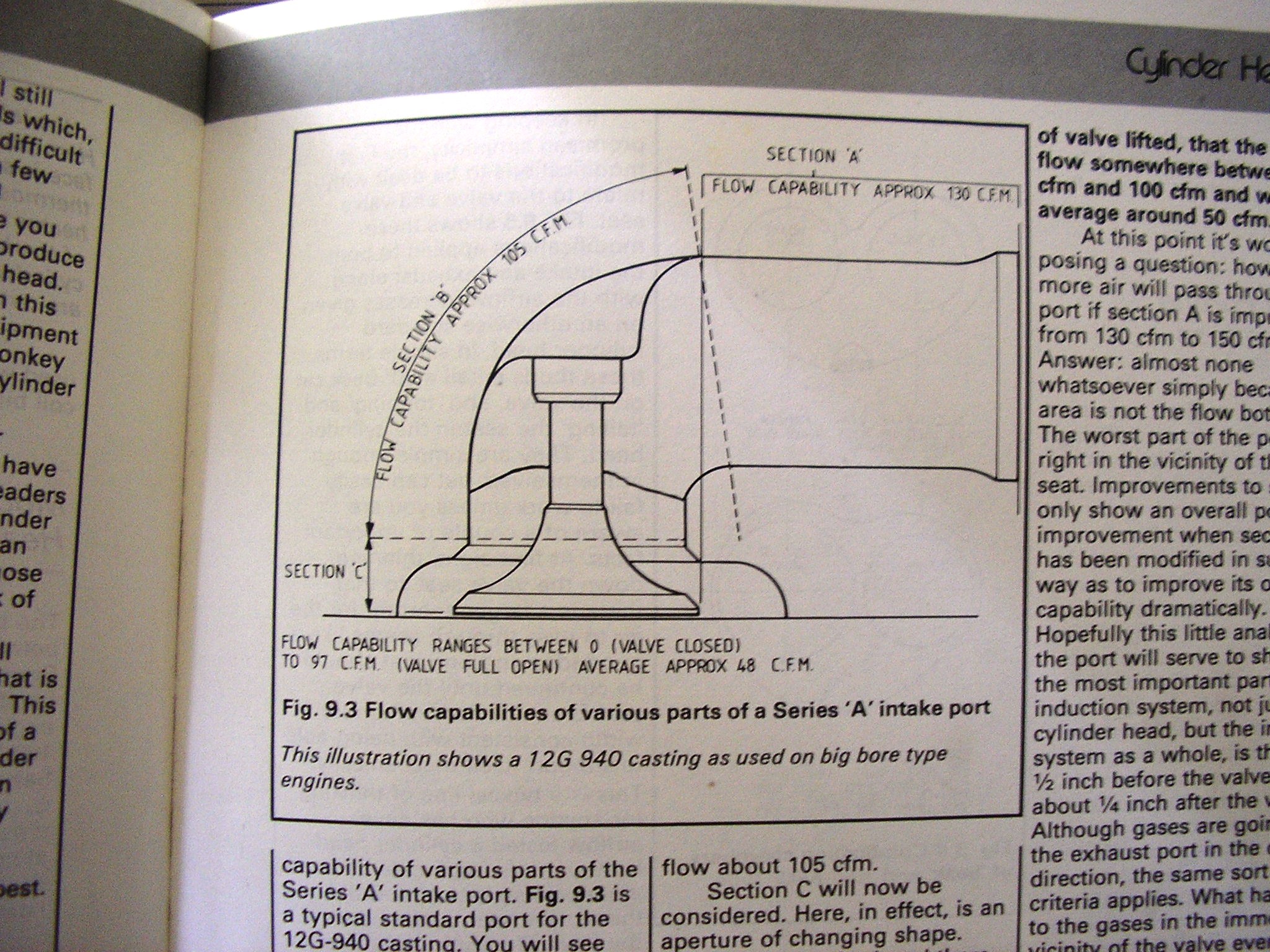

Felix Posted January 31, 2009 Report Posted January 31, 2009 Rob :y: Bigger ain't necessarily better when it comes to getting performance out of a motor. This applies to exhaust selection, cam, carbs, portwork, etc.. A properly matched package suited to the intended application is what it is all about to get the best allround performance. Peak HP means shit all. Area under the powercurve is where it's at. Hogging out the ports on a 5k is going to kill all it's low-mid torque. It won't really affect the top end as the valve size is the governing factor for flow. As stated there isn't much meat between the valve seats to fit in larger seats and valves. Offset valve guides is the go to fit in larger valves if you have a few bucks. Check out the attached image showing flow in various sections of a mini engine intake port. Quote
