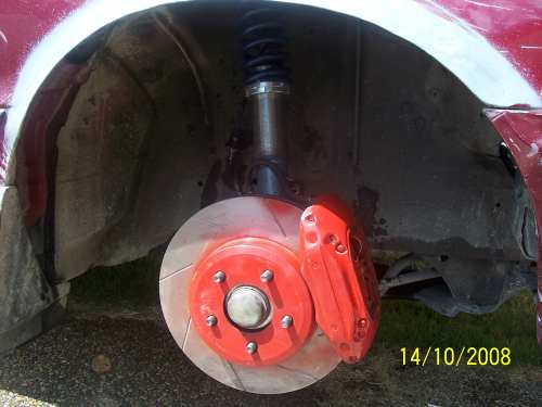

I was hoping not to have to got to too mich effort, but we have decided to make our own.
Running XT130E Struts Converted with STEEL coilover kit, twin locking perches usual drill here, captive spring 5k main springs.
Shocks (I get really cheap discounts through a friend) so until I finish making up my mind here will be using Monroe GT Gas Shocks (Short Stroke)
Noltec Camber/Castor Tops
Sumiato Calipers (Thanks be to BLinded for those)
DBA Slotted Rotors and EBC Green Stuff Pads (For Now at local club level, will go to Reds once we get into the forest)
Note we are not lowering the vehicle, so should be an easy one, this is a PRC Rally Vehicle so hence why we are not lowering.
