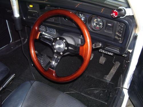

luckily for me my ke came with black interior so i wont be changing it to much from stock, later on down the track ill give it all a re-trim
to bring it back to its former glory as for what options it came with this must have been cheapest ass model toyota made as it
has no ciggy lighter no clock no radio but it was an auto so at least 1 option box must of been ticked.....
