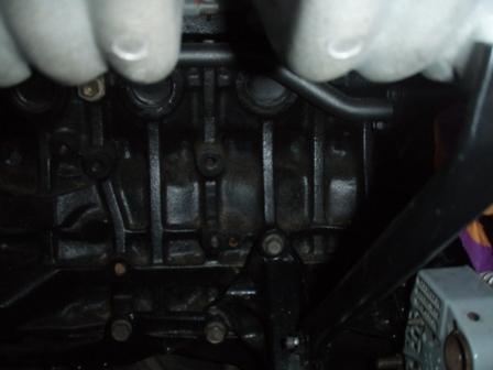

Stixy Posted June 24, 2009 Author Report Share Posted June 24, 2009 (edited) Ok so i think i may have made a mistake...... pleases tell me that there is 7 ribs there...... and yeah its got tvis? whats the go there? I'm going to get a custom plenum made anyway but still P.s no charger, going turbo. Edited June 24, 2009 by Stixy Quote Link to comment Share on other sites More sharing options...

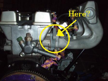

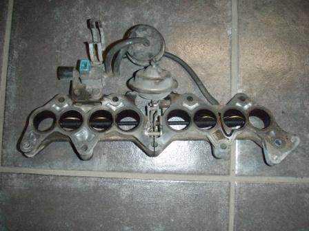

Stixy Posted June 24, 2009 Author Report Share Posted June 24, 2009 AAHHH ok I’m starting to freak out here, as i said in my original post: I have been reading thing and they all just don’t add up..... Well I found this site that was talking about the TVIS bizzo and I realised that I only have 1 large throttle body (butterfly) at the front o my intake plenum..... Now is this supposed to be in the yellow circle? I got it from the wreckers the other day when I went to get a wiring harness I just couldn’t be bothered taking it off the harness. Quote Link to comment Share on other sites More sharing options...
Jason Posted June 24, 2009 Report Share Posted June 24, 2009 Thats were tvis goes. Bin it imo. Thats a 7 rib, and thats not a gze intake, but thats ok there bad any way. Quote Link to comment Share on other sites More sharing options...

Roo Posted June 24, 2009 Report Share Posted June 24, 2009 (edited) yea thats a 7 rib block, and you got a knock sensor so its should be 4agze, unless someones put a bigport head on a smallport block (very possible as you got a NA 4age alternator mount on it) looks like some one bolted on the tvis and NA manifold on if your going to turbo chuck the tvis in the bin :) Edited June 24, 2009 by Roo Quote Link to comment Share on other sites More sharing options...
Stixy Posted June 24, 2009 Author Report Share Posted June 24, 2009 yea thats a 7 rib block, and you got a knock sensor so its should be 4agze, unless someones put a bigport head on a smallport block (very possible as you got a NA 4age alternator mount on it) looks like some one bolted on the tvis and NA manifold on if your going to turbo chuck the tvis in the bin :) yeah when i pulled it appart to get it out the car, the tvis was bolted to the mani/gasket then to the block as is now in the pic, no tvis So i think the prev owner was just using it as an intake plenum? wow ok this is difrnt Quote Link to comment Share on other sites More sharing options...

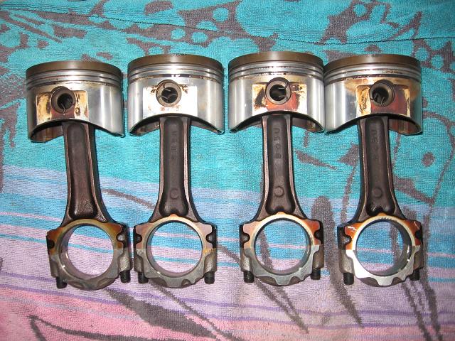

ae174agze Posted June 24, 2009 Report Share Posted June 24, 2009 (edited) could it be a 100kw?? big port head is better for turbos i think, you don't want a tighter space to force the air in, do a compression test, my good gze bigport put out about 138-140psi take the head off and look at the pistons they should look like this should a ciramic coating, deep dish with flycuts for the valves its like holding a baby Edited June 24, 2009 by ae174agze Quote Link to comment Share on other sites More sharing options...
