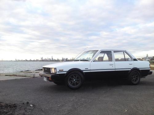

half a panda ....
This is taking way longer than expected... we wasted a sh!t load of vinyl... i'm gonna need to be very careful with the drivers side...
progress pic....
looking good! this will be awesome when you chuck on the guard mirrors.
what kind of fender mirrors will you be running? kp61 style or more chrome like the ones on the te72 gt on the first page?
what are you using to apply the vinyl?
you can get 3m vinyl applicators which do a really good job
also sometimes doesnt hurt to put a fine mist of soapy water on the surface you are applying to first, so that you can make mistakes and work the air bubbles and wrinkles out. also means you can slide the vinyl around a little to get it into position
i used to do a fair bit of signage application on race cars and it takes a bit of practice but you will get the hang of it - there were plenty of times the race cars went out with wrinkles or stickers at slightly odd angles. at 200km/h no one could tell - but may be different on a ke :lolcry:
