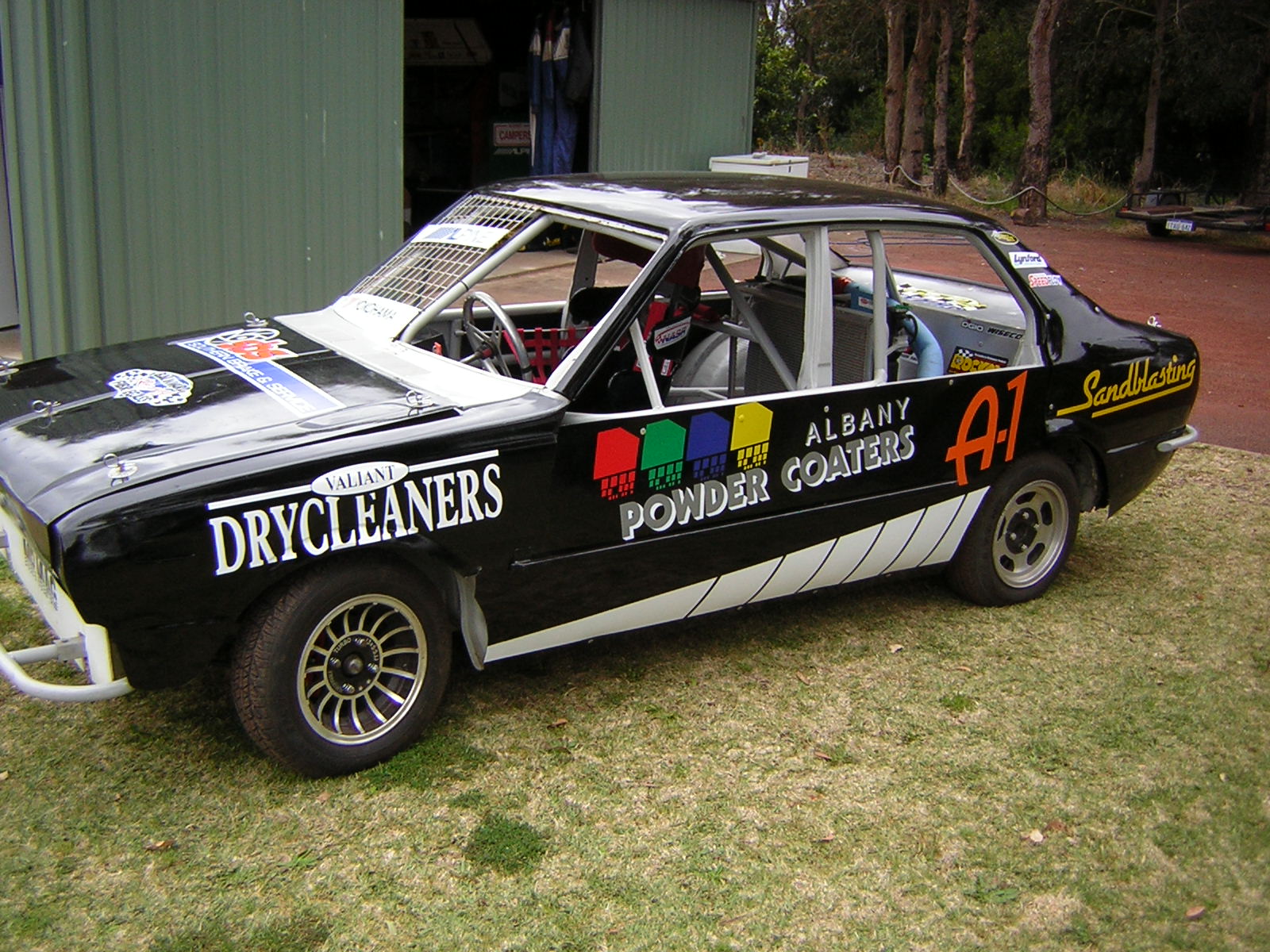

The radiator is not mounted in the front as u can see from this picpost-7500-1248852965_thumb.jpg
anyway we have 2 pipes leading from the radiator one goes the the water pump and the top hose to the thermostat.
And no i don't loose much coolant during races as it is changed fairly often.
ahhh k i get it now, so the alloy one u have atm is not cooling enough? hm maybe make up like an aluminium intake to direct air right into the radiator?
