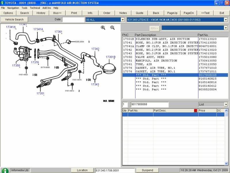

anastasios Posted October 20, 2009 Author Report Posted October 20, 2009 (edited) yea i saw that you can buy aftermarket Porsche block off kits, well i rang up toyota and found this, so from factory they only come with 3 injectors so thats why i have one bolt, the other three are part of the air pump system. ill post it up incase anyone ever needs it again should i just head down to the hardware store and get some bolts that size? and forget about the loss of flow? Edited October 20, 2009 by anastasios Quote

anastasios Posted October 22, 2009 Author Report Posted October 22, 2009 ok well I'm back to square one, japan do not have those air injection block off bolts...i think i might have to just get normal style bolts and not worry about the gap left over what do you guys think? Quote
Felix Posted October 22, 2009 Report Posted October 22, 2009 Looks like bolts will just have to do. Either that or set up a new head which doesn't have the air injection crap on it. Quote
