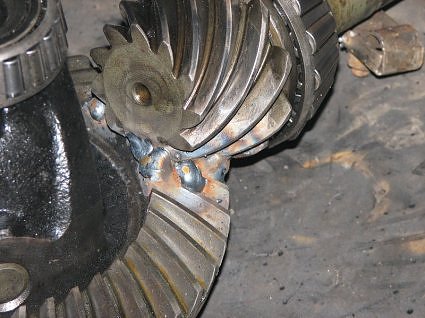

Hi people I'm thinking of welding my diff in my ke70 do i weld up all the spider gears or just all 4 corners? can any one help.

Like maybe don't attache the earth clip directly to a bearing. They slip off pretty easy anyway so maybe remove the so they don't get covered in slag, same thing with the crown wheel, don't be lazy and remove it.
As for the welding the more you do the stronger it will be. Weld sun gear to sun gear, and sun gear to carrier, even a steel plate jammed into the sun gear and welded in place is good.
