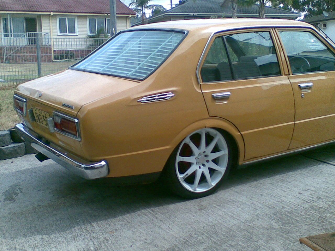

lol i had 215/**/17''in only on the back tho
thay didnt fit on the front ay
front wheel drive offset i think
and all so this photo of the ke30 is dumped on its ass
tail sharft is banging around underneth the car when
i boot it lol silly i no but now she is back to stock hight
:P
