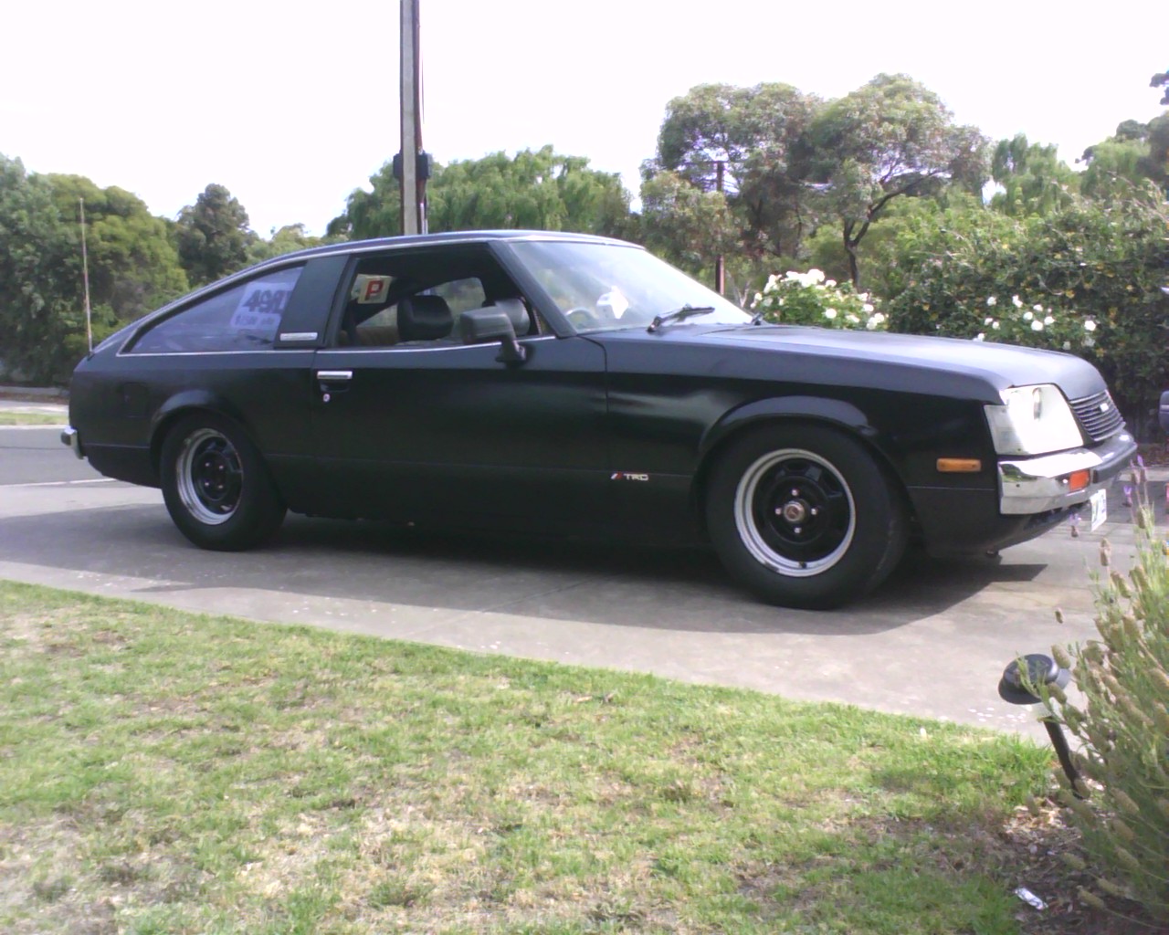

My New 70 Aka The Black Pearl

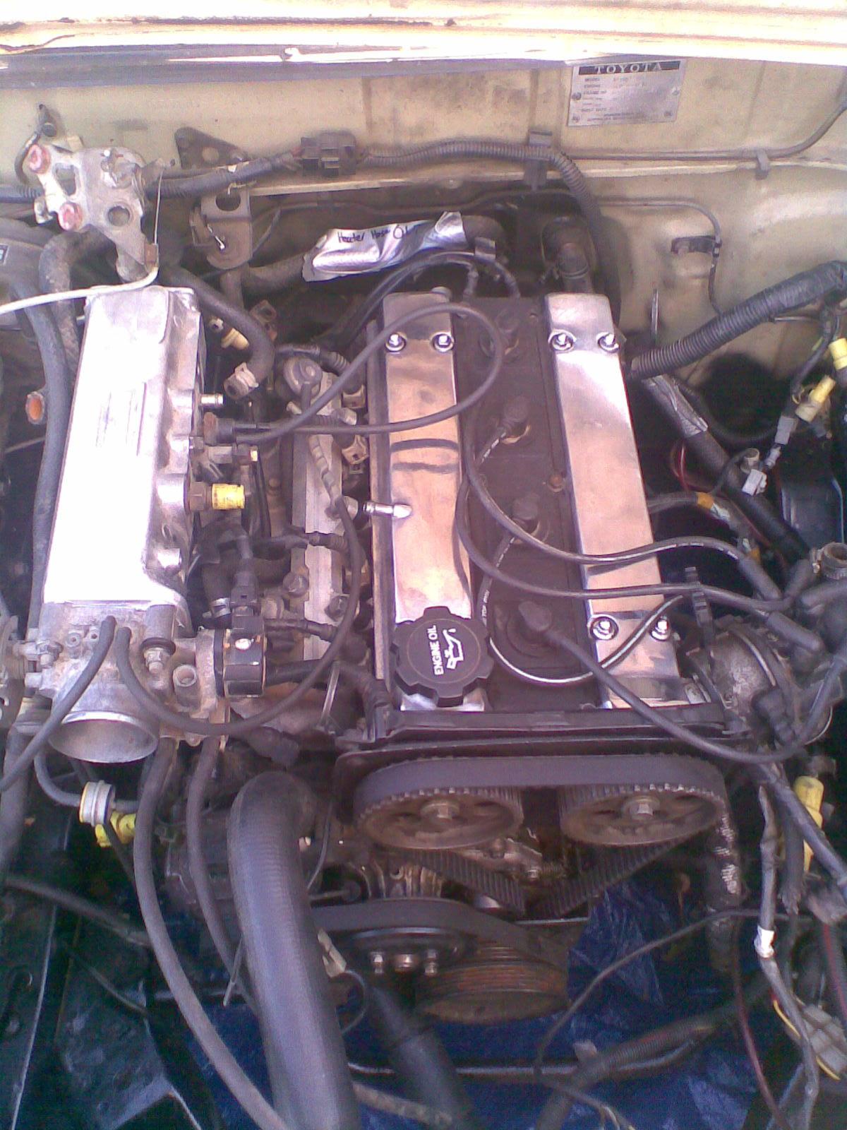

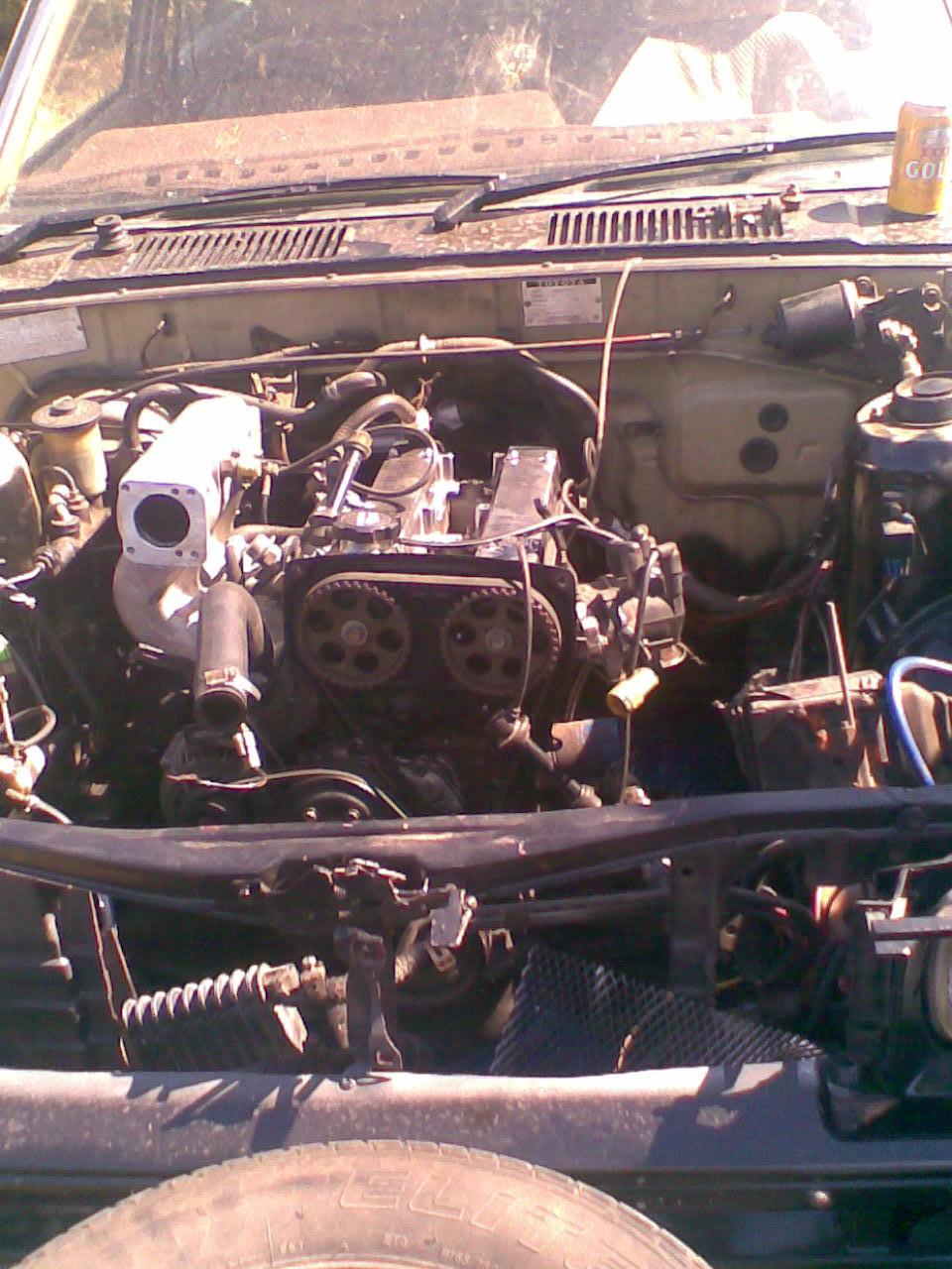

the 4age is now in the car with about an hours worth of mucking around it is finally in here are some pics
ENJOY

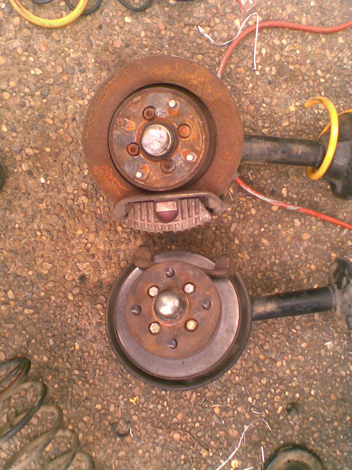

my big brake upgrade that mucked me around alot due to these struts being kexx not ke70 struts i think there 55 struts it now uses commondore brake setup

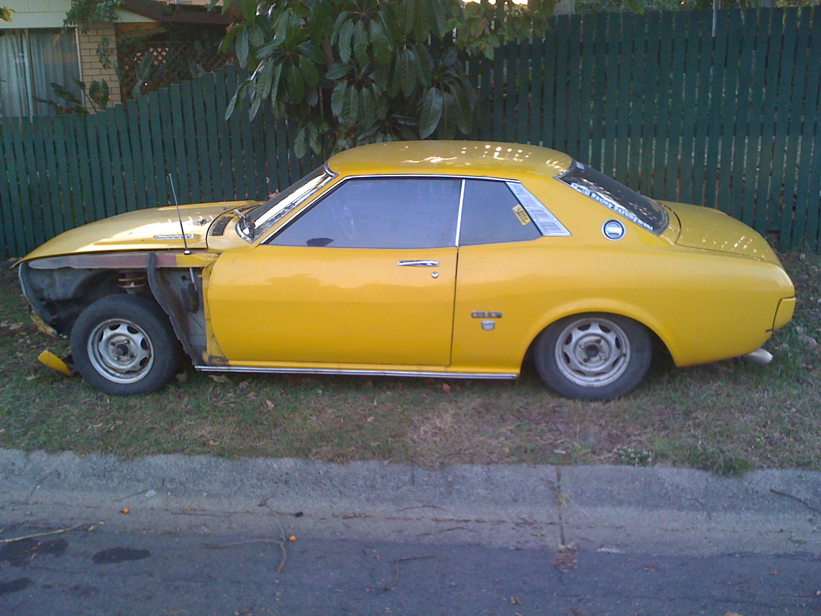

what state is your ta22 in? i got a ra40.. yeh i know barrfff. but ive made decent enuff
the ta22 is was sitting around at my old gurls house doing nothing till my mate said aye gimme all your parts so now it is sitting at his house getting stripped to build his ta22
i'll throw up some pics of how it sat when i last owned it

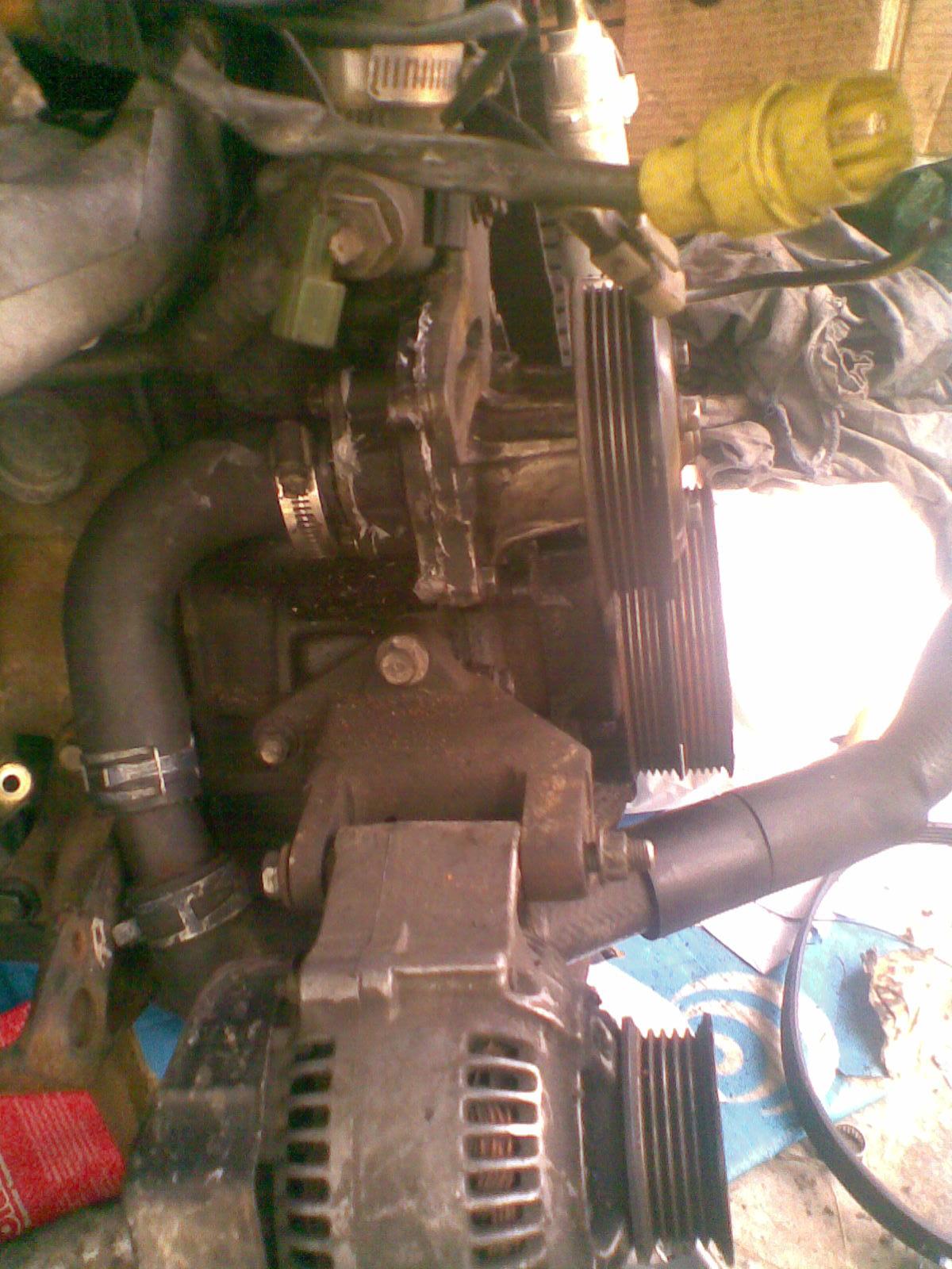

I have figured out the cooling system finally on this car it isn't pretty but it should hopefully work i have mounted the standard oil cooler that comes with the 4age in the ae82 it now sits next to the support bar in front of the radiator just in behind the grill still need to run new oil lines to and from the cooler, i have mounted a set of gauges into the cabin aswell the tacho is mounted where the centre console bit is just above the gearstick and there is oil pressure, temp, and a volts gauge just above my left knee in a chrome gauge holder thing so nothing really has changed just nutting out little things
