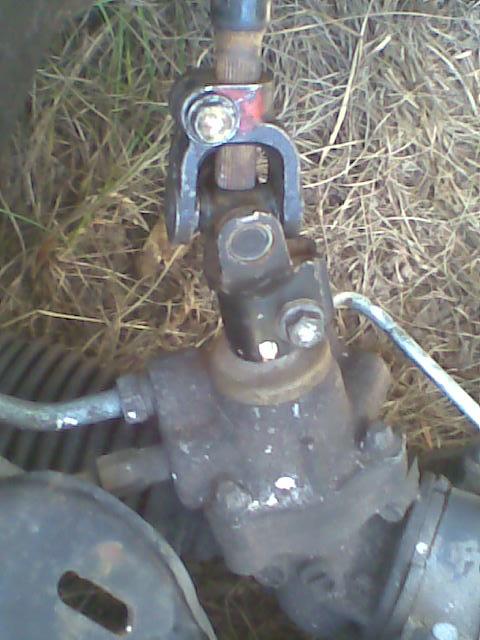

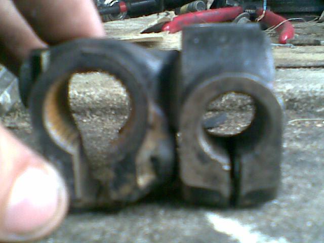

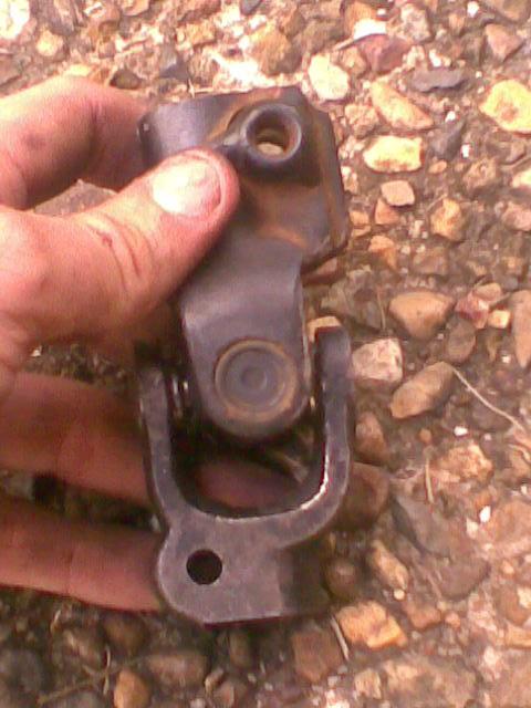

here are afew pics of my steering colomn bud
this is the colomn joined with the silvia/rolla hybrid steering uni joints, i still need to take a bit off the colomn though,
with this picture the steering knuckles on the left is the silvia one, and the one on the right is the rolla one,
this is how it looks once it's finished with the silvia and rolla bits joined out of the car

wow i couldn't of asked for better pic's thank you so much now i can see where you have to cut down the colum
when it's cut down you wouldn't even know, i thought that when people were saying cut 20mm off the end, that you would only have
a little bit of spline left on the colum and that look's fine to me.
when the tip is machined down i don't think anyone would know as the spline still travels all the way through the knuckle.
i am going to ring my engineer next week and ask about doing the conversion so thanks heap's mate..
Yeah thats cool man anything else you would like to see pics of?, that photo of the colomn in the knuckles needs to still have a bit taken off it as it only just misses the uni joint,
