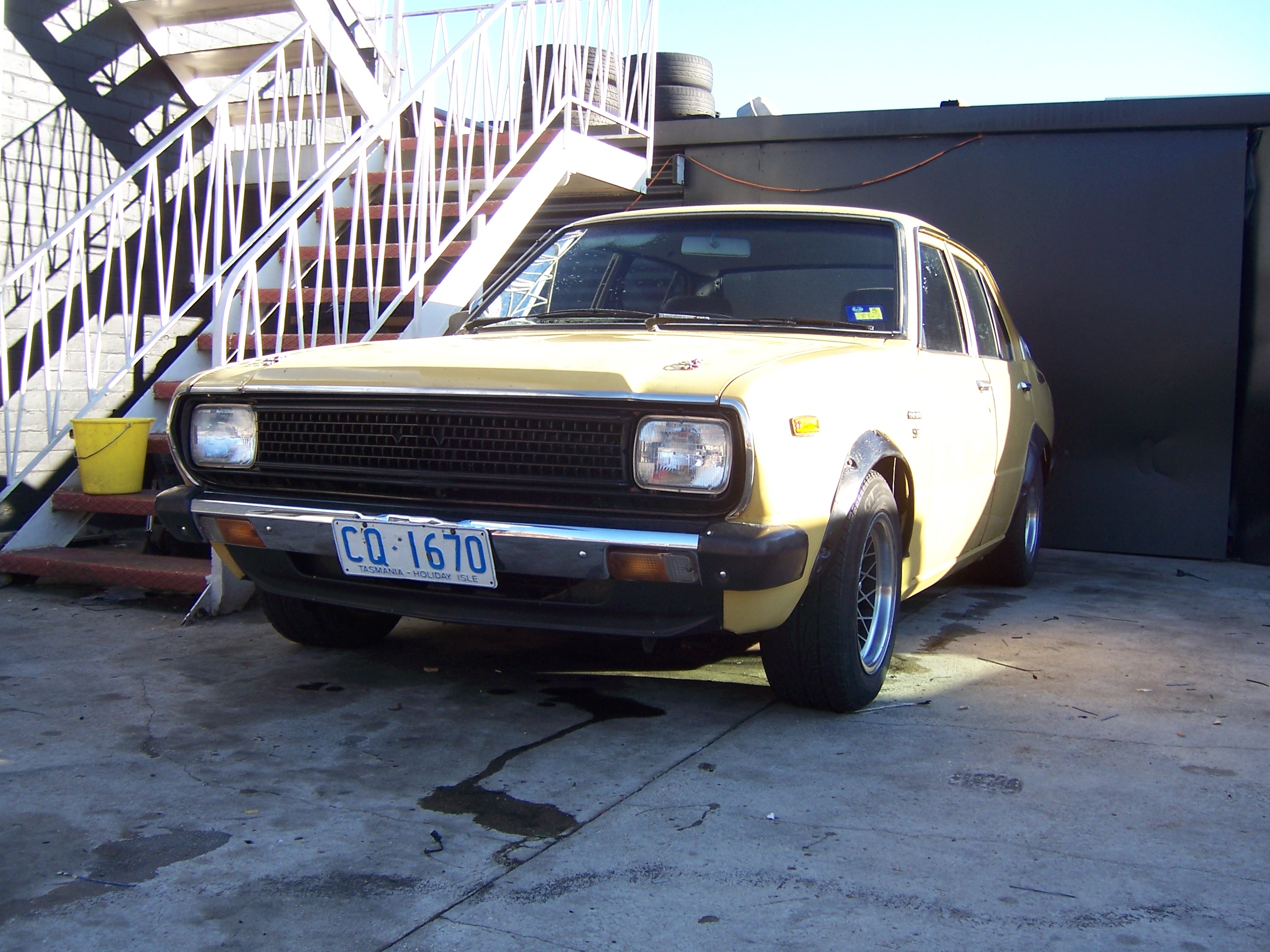

September 28, 200917 yr comment_377276 Can also buy bolt-on flairs from Meridian Motor Sport in Melbourne. Come in 1", 2" and 3". These are just the 1"s.... Click on "Tar" in my sig for more pics. :) Report
September 28, 200917 yr comment_377279 Nah not really. Previous owner of that car had some on it and he did most of the cutting. He then sold the flairs on and I bought the car and had to get some more. If you fit them asap when getting them, then the fibreglass is still a bit green and flexible and makes life a bit easier. If I had to fit another set I'd just: dummy fit them with tape Drill holes for bolts and test fit remove flairs and draw an arc (from trimming) as close to the bottom of the bolt holes as possible. trim guards with tin snips re-fit flairs. I still need to fit mine properly after I paint them (still in gel coat) and get some flair tubing. There's a few pics of my car with cut guards and no flairs in the first couple of pages of my projects thread just after I bought the car. :) Report
