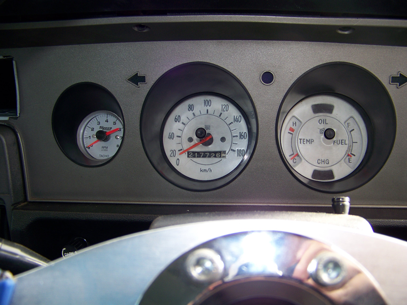

But in all honesty, its a stock 4k. Get an 3 3/4in 8,000rpm speco or similar. Big enough to see at a quick glance and small enough to grab unwanted attention.
monster tachos are gross! was a starlet at work with one i was loling the whole time i drove it!
i had a 2" speco one in my 55 was more than enough but then i needed something small enough for the clock hole, was a pretty penny thou! and then did my other dials to match!
