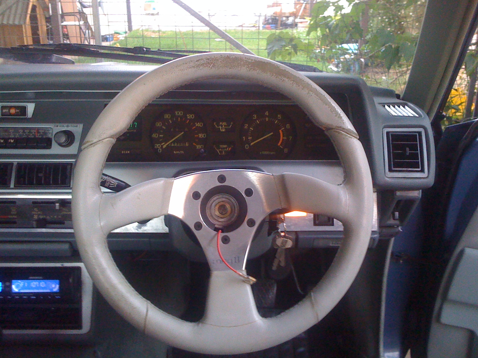

Well i got the old one off and the new one on in 20 minutes...Now i just need to get a horn button and I'm set.Thanks for the help.

Nope!!! I left the nut on a couple of threads and then hit the wheel a few times and it wiggled off perfectly.
