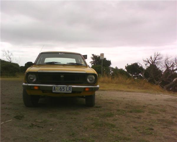

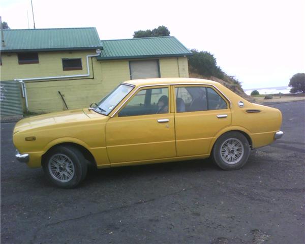

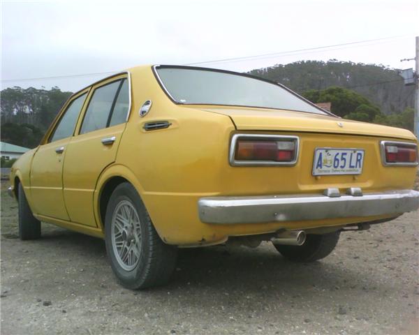

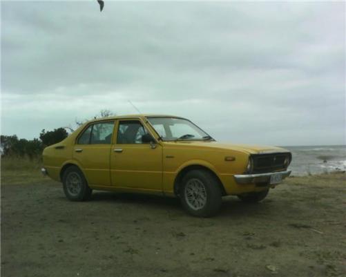

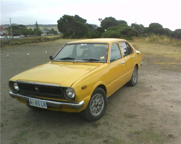

G'day guys, i have had a KE55 project for about a year now, lost intrest and is still sitting in the backyard.
Seen a chick driving a KE30 around for a few months and always wanted to ask her about if she'd ever sell it, but couldn't get into contact with her.
Then my girlfriend told me that she knew the girl. So my girlfriend gave me the ke30 chicks number, So i messaged her.
Looked at the car the next day and bought the car the day after. It has some rust, but i can fix it due to now owning a MIG welder for the past few days :)
Bought some sort of Corona alloys for $150 with about 95% tread :blush:
Anyway here are some pictures of the old girl.
It now has sheep skin seat covers in front instead of frangapani covers and a granny knitted blanket over the back seat. lol
