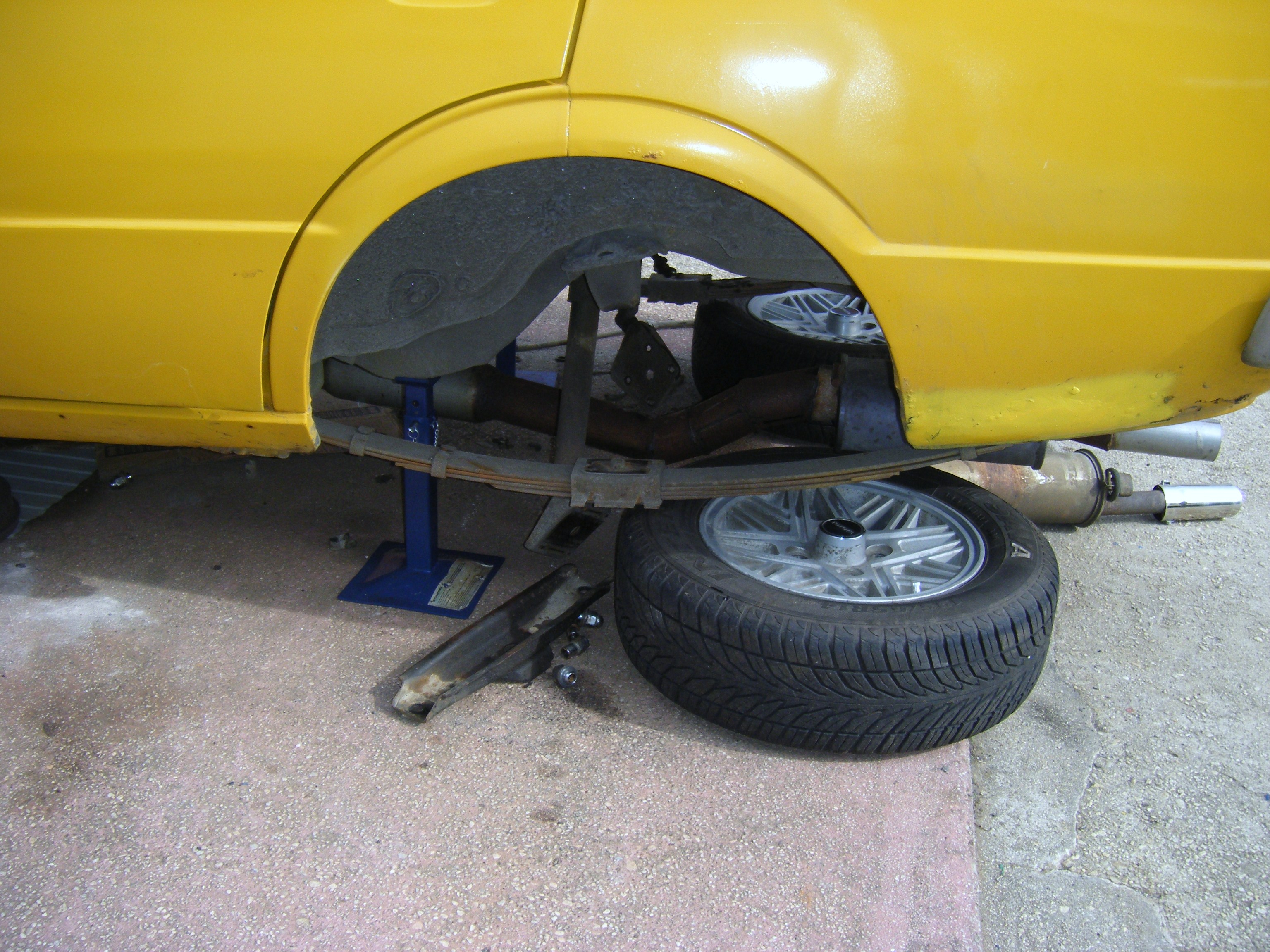

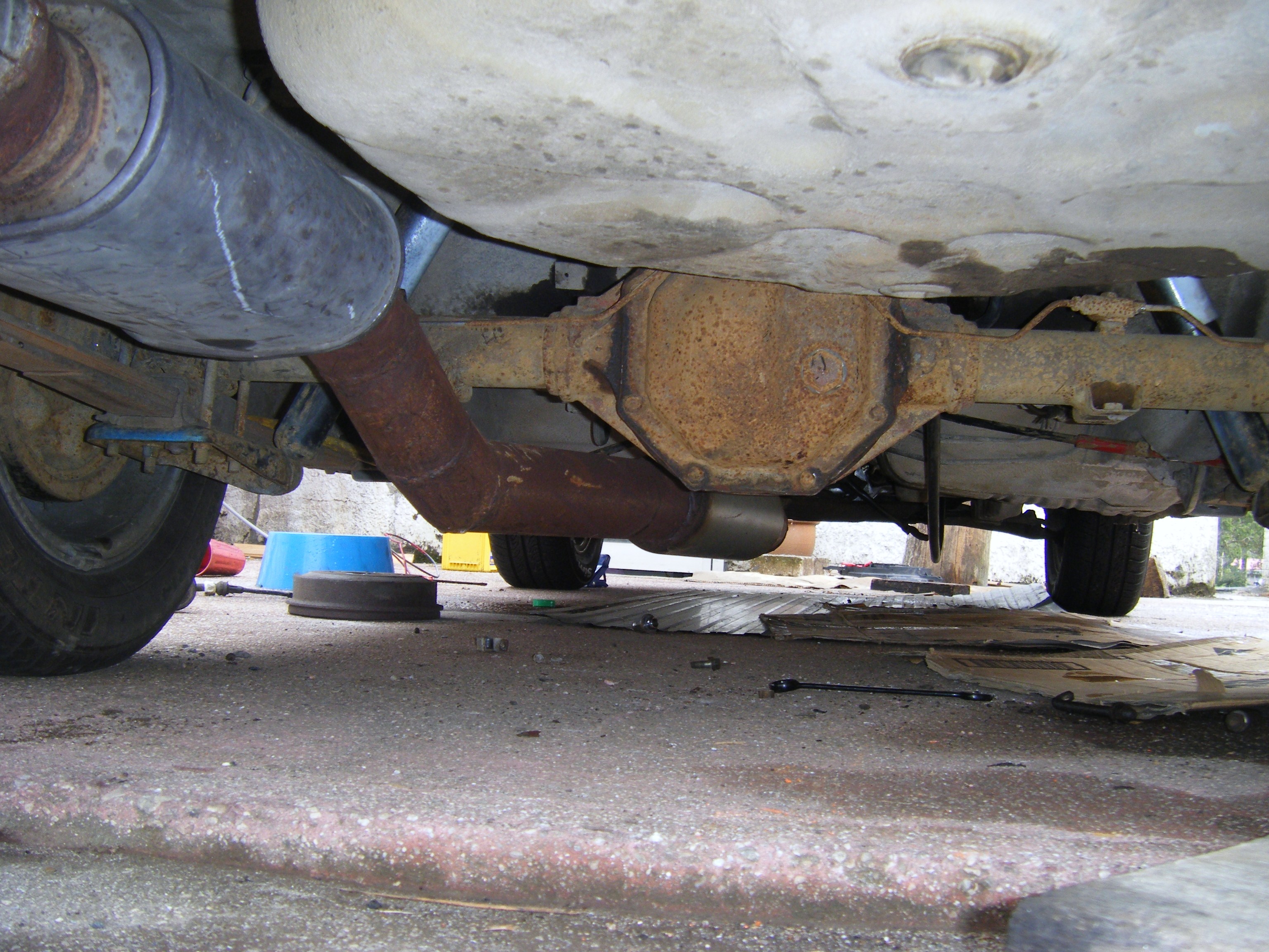

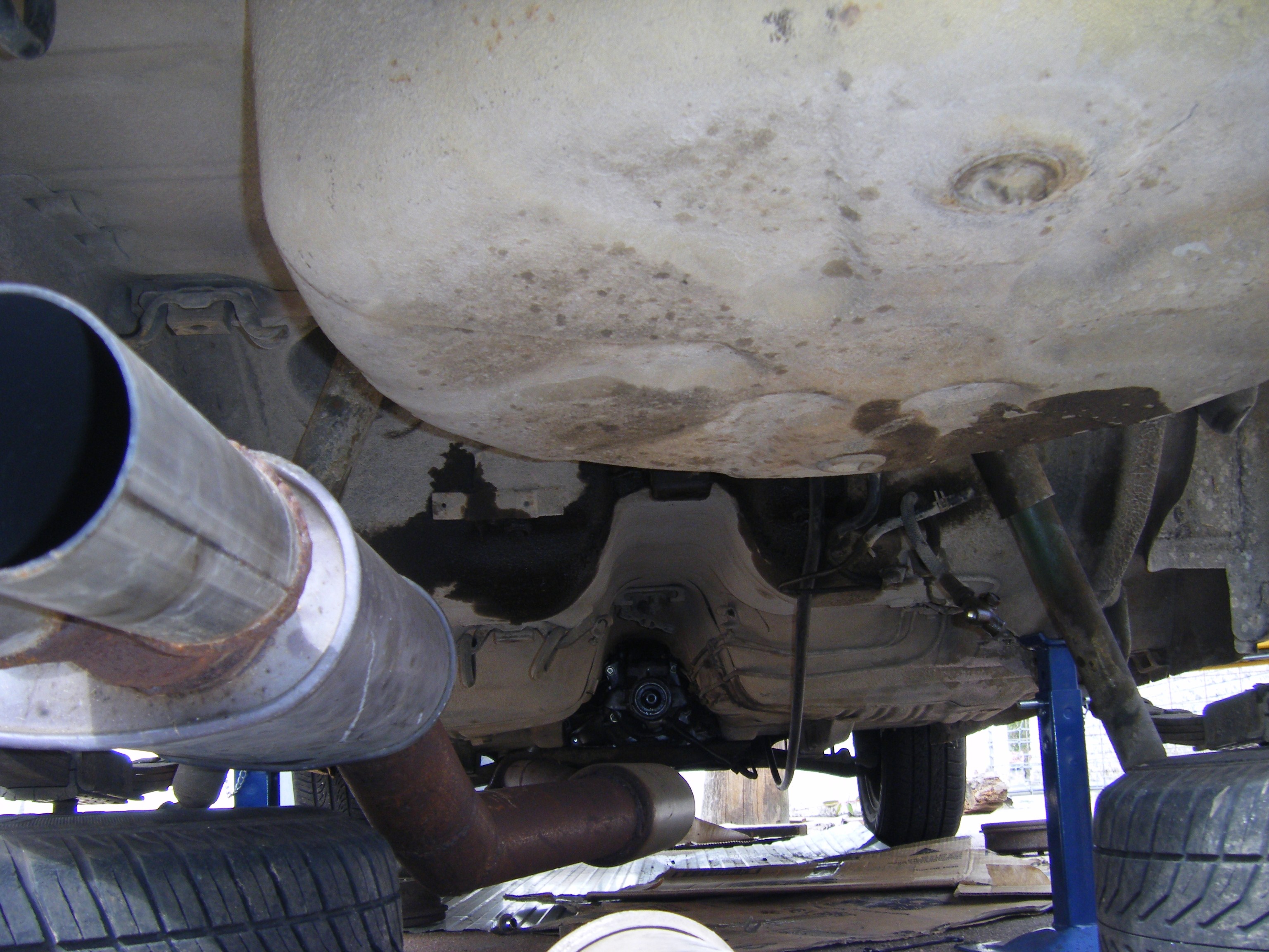

Banjo diff out
Borg warner in

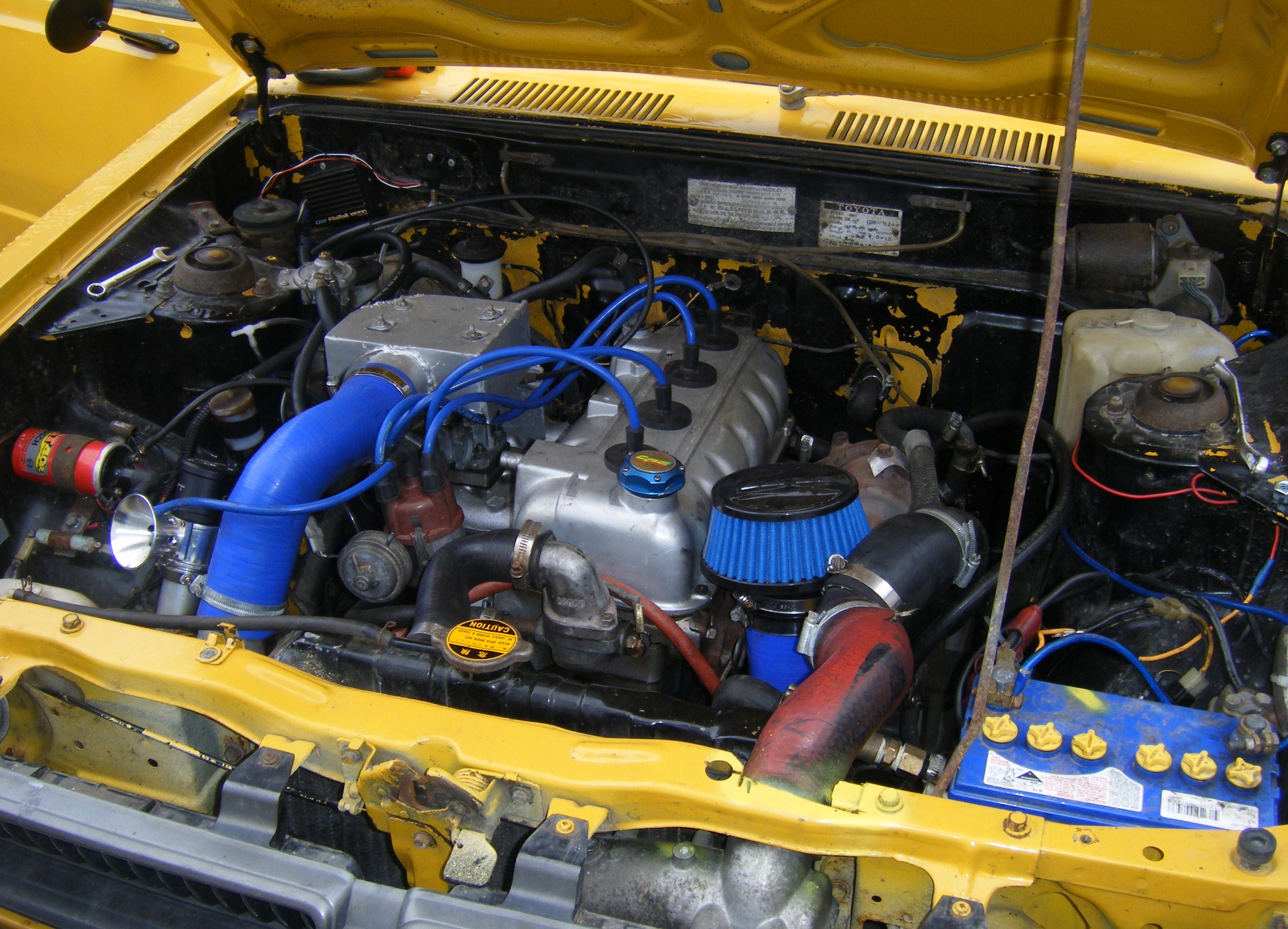

2T in, looks a bit messy but i still have to tidy it up a bit

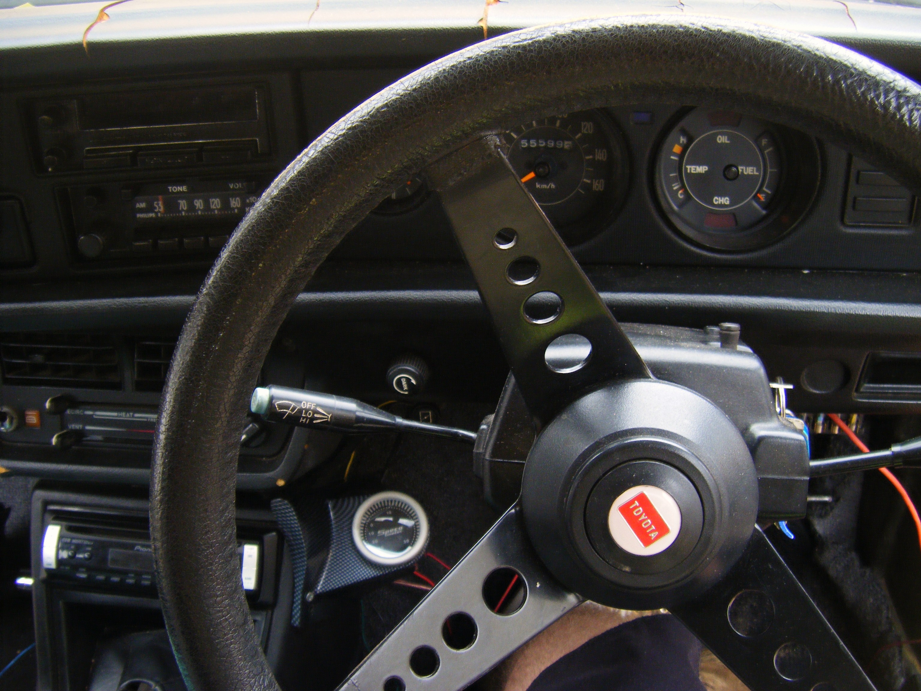

Dash, old school toyota steering wheel CD player, Boost guage and a cracked dash lol

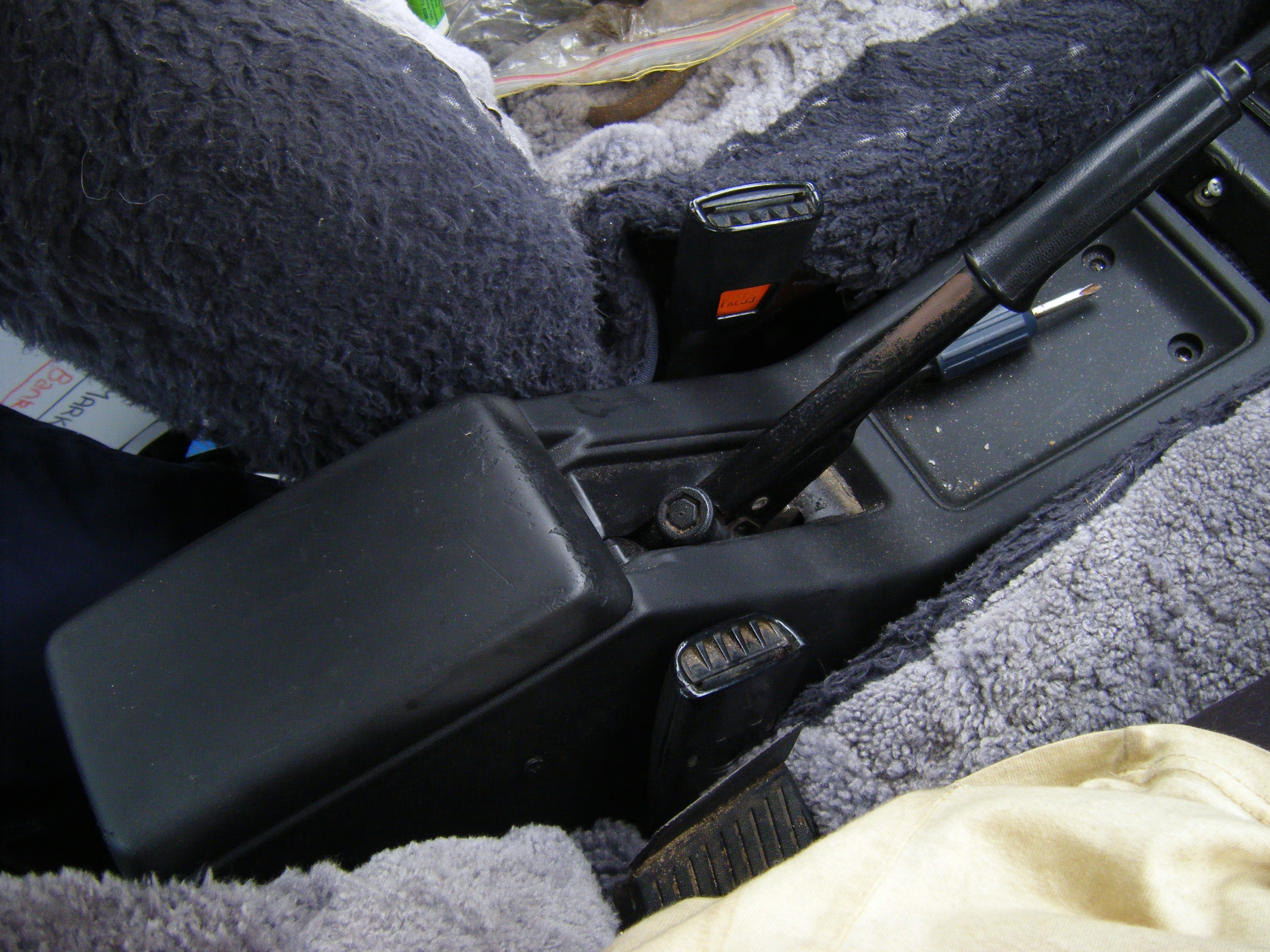

KE70 centre console

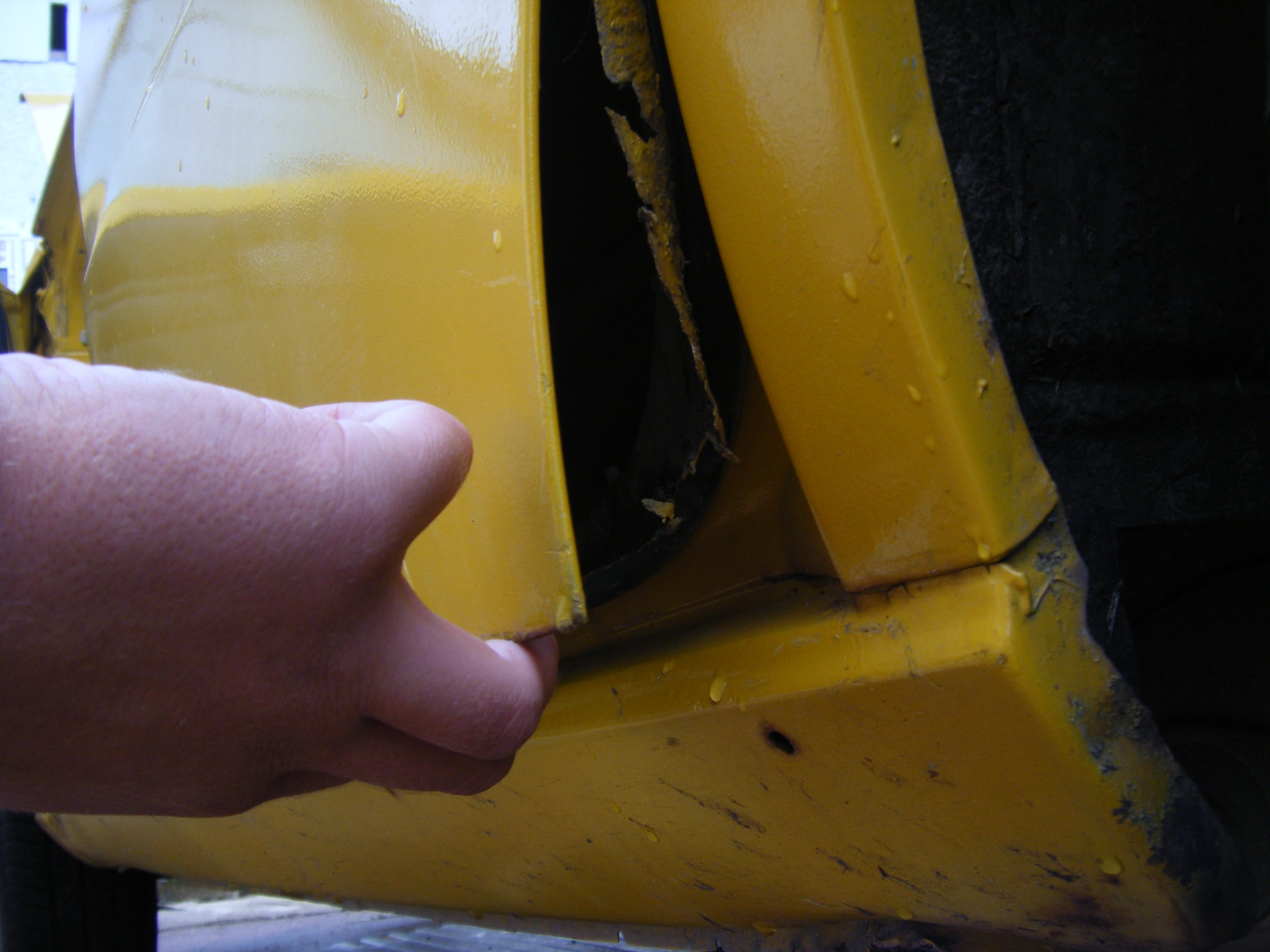

Back passanger side door has completely rusted out at the bottom. Hence the door skin no longer attached to the skeleton of the door :)
Tell me what you thinks guys
