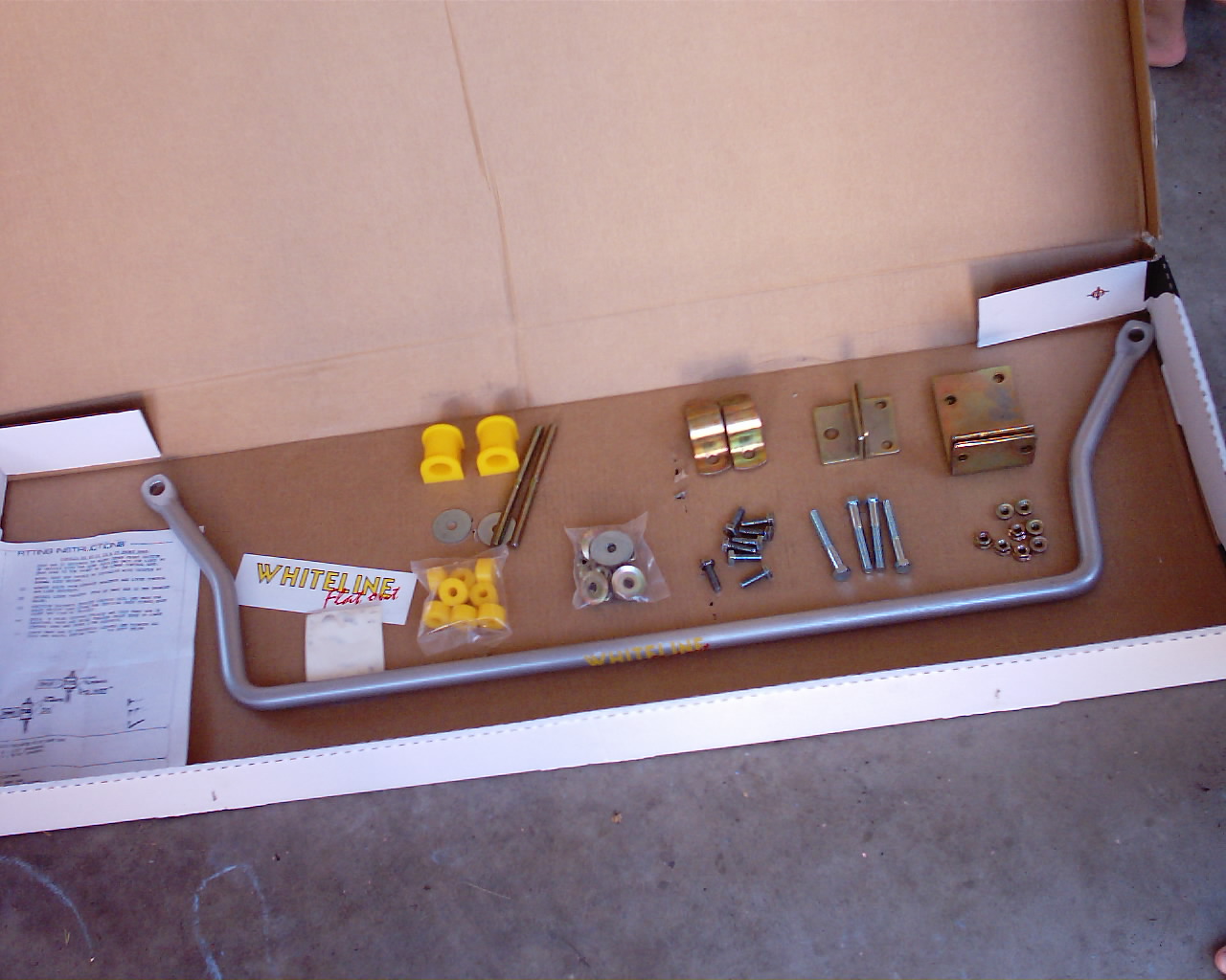

had a look on the whiteline site and came up with this
Swaybar 22mm-heavy duty
part NO: BTF7
this is the one yes? what do you get with the full kit? and its just a few holes to drill... any other modding?
sorry for all these questions, ke1xs are a new series or corolla to me
Yep that is the one.
You have to drill a couple of holes in each front rail for the mounting brackets. Also have to drill a hole in each suspension arm for the lower mounts that the link pins hook up to.
Everything is included in the kit, ie. swaybar, mounting brackets, link pins, 10 urethane bushes, nuts, bolts etc. You just have to supply a drill, some bits, spanners and an hour or two to mount it.

I had this kit on my ke11, definately worth doing if you want it to handle.
