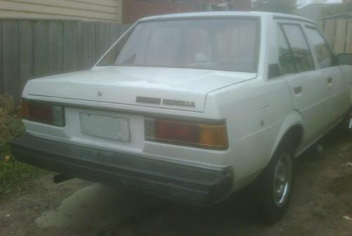

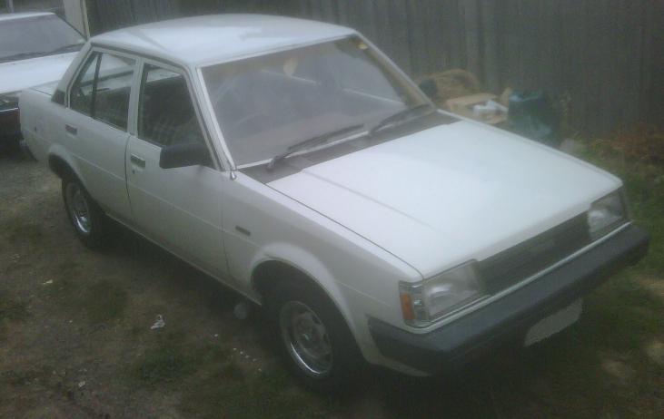

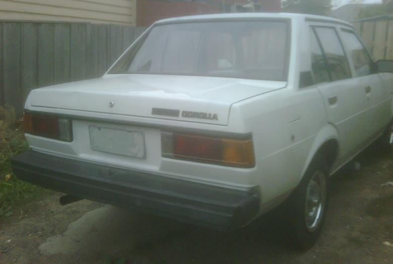

Jello everybody, thought I would finally introduce myself and my machine. It is a 1984 KE70. Plans include, flat front end, chrome bumpers, chrome trim tail lights, Datsun 280 side repeater indicators, redo interior in red, full respray in crisp white, and renovate my 4K to look shiny!

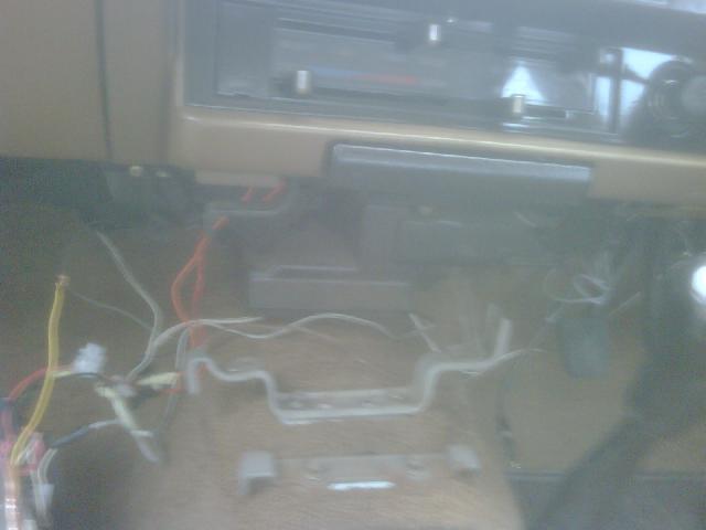

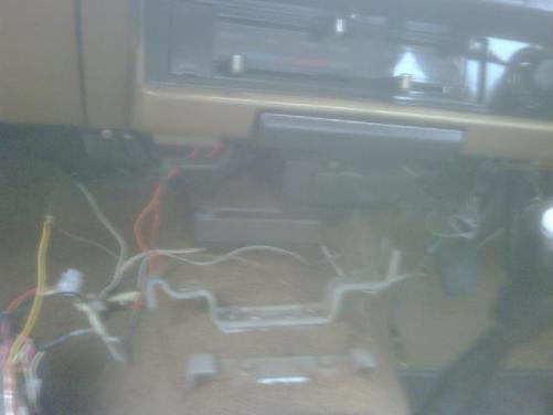

It needs to get RWC for rego however. Can I get RWC while missing this bit? I will clean up the wires and such, but do you need that part of the console?

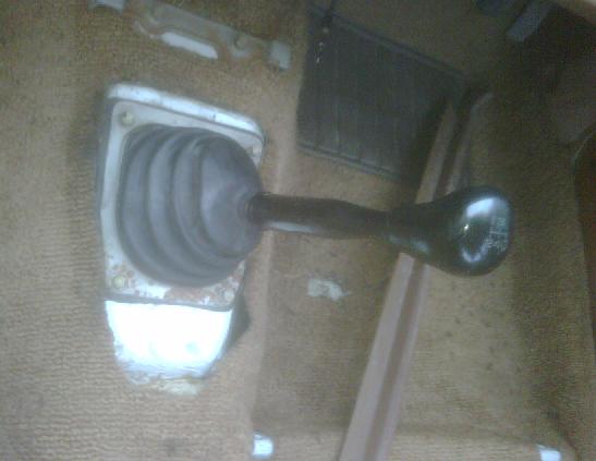

Also, I'm putting in new carpet. Can I cut a hole in my carpet to just go around the geartstick rubber, without having the sheath? As it's new carpet it'll look very proper and not gaping like this hole here.

Yes you'll pass a RWC with no console, provided you tidy those wires up.
Did you buy a Knox carpet?
If I were you I'd be trying to find a console for it. That way it'll tiny things up even more, give you storage space or somewhere for a headunit, plus you won't need to worry about what the whole you cut for the shifter looks like.

Got a console for it, but cos I'm doing a red interior I want to strip out as much as I can. Do as little painted plastic as possible, so if I could just have it as the dash painted red, it won't stand out as being painted so much.
Taken out the sound system. If I was going to have one it'd have to be pretty decent set up, and I'd rather spend the money I could on that, on other things. So the only music in the car will be the engine, the road and the radio.

Also with the shifter, it's just going back to the simplicity thing really. Just want it to look as clean and spartan as possible without looking like a track car.

Yeah Knox carpets are really good, I've had one in my mazda for like 7 years. Mine is the super plush though so I can't really comment on the loop pile. I'm sure the would be just as good as the plush's though. As you may be aware they come with no holes in them what so ever.
With the above in mind RE shifter hole, with no console I would probably cut the hole in the carpet just smaller than the plate (with the 4x bolts in it) than holes the boot down. Then unbolt the plate, slip the carpet under it and bolt it back down. Obviously the plate might benefit with a brush with a wire brush and a coat of paint.

You sir, are a genius. Just cleaned it up then and tried it with the old carpet. It is going to look absolutely overrated with the new one! Is there going to be a Ke** cruise coming up soon?
You'll rego that easy, I've gotten cars in much worse nick through the pits before, so I can't see you having any trouble at all as long as it's not venting fluids and the rubbers are all reasonable :thumbsup:

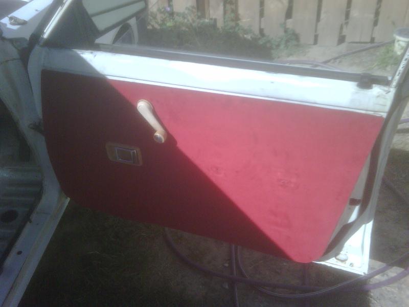

Quick mock up of what the door panels will be. Got the fabric, just need to find some new board to make the panels out of! Going to paint the handle and roller black most likely and touch up the paint above the panel.
Imagine, fresh painted white exterior and doors, red dash, sports steering wheel, red carpet and red seats. Not all in the same shade or material of course :(
