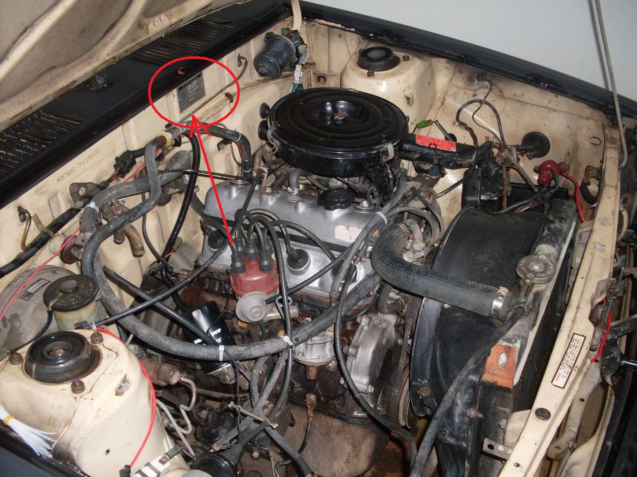

Towe that's some good info but I couldn't find the diff code in the engine bay. I'm sure I'm just not seeing it but it doesn't seem to be on either of the plates on the firewall.

Thats it the build plate. It'll tell you what the motor that should be in the car, frame number, colour/trim, trans/axle <- and this what you'll be after (axle code last three digits and possibly a letter (more then likely the letter "U") before the three numbers).
I looked at that plate and it didn't have a code or anything after trans/axle. Just the colour/trim code and whatever the bottom one was.

The bottom one is Plant/GVW - where the car was built / Gross Vehicle Weight
