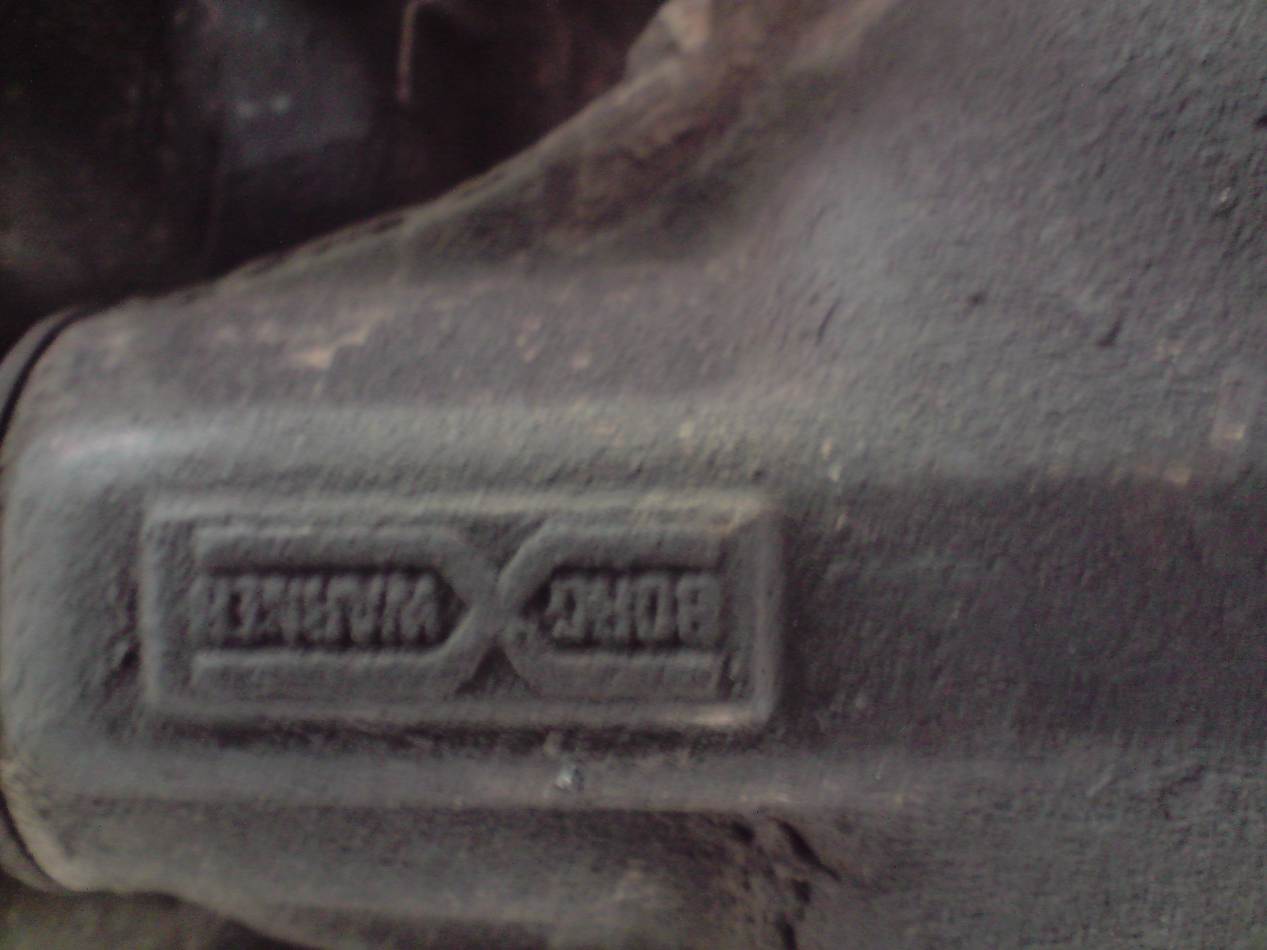

jono I had a look at the diff but the only writing I saw was borg warner. Oh well

Was the "Borg warner" on a little metal tag as jono pictured? If not double check the tag.
I think he means this part.....
The one that i picture before, i couldn't see...i only saw it cause i undid the bolt and the plate fell off, cleaned it up with a wire brush and saw all the numbers.....

That was the borg warner thing I saw. There didn't seem to be a plate or anything where you circled, it's just flat metal.
