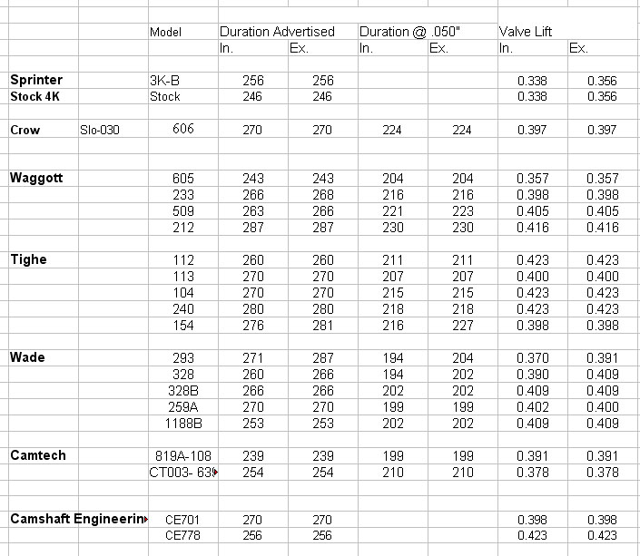

May 15, 201016 yr comment_437749 Those figures don't make sense to me- Look at Tighes Toyota cams (http://www.tighecams.com.au/cars.htm) and the 50thou durations of about 240deg are described as fast road/ rally. However you will have lift of over 0.4". Anyway, either one will do it seems, but if you don't get the carbs and everything matched it will still be a dog to drive in traffic. It will probably bog down and stall when you try to get it moving in the queue, and the idle will randomly die and stall just when you don't want it to... A lightened flywheel will make it worse. So you'll end up blipping the throttle all the time at the lights, and revving it up with slipping the clutch to move it two car places further forward towards the red traffic light! I've just got the car running with the equivalent of their 113 grind & SUs, and it does make a good difference from about 1500rpm up. (& even that cam is grumpy at idle) Report

June 1, 201016 yr comment_441722 If this is how your car behaves in traffic just because of a cam there is something wrong! Pink jemmy, read this line- but if you don't get the carbs and everything matched it will still be a dog to drive in traffic. Having driven rally cars for years I can appreciate the difference between a well-setup car and a poorly setup car, both using the same cam. No, my car's not a dog to drive in traffic, but having driven ones that are I can tell you there is very little pleasure in having a daily driver that only works above 3500rpm. Here is the usual list of mid-range cams- Edited June 1, 201016 yr by altezzaclub Report

June 3, 201016 yr comment_442289 Nope! Too many options- At least a dozen cams would do more or less what you want, and some more would be useless for you. Unfortunately the only real way to find out is to try one! Try something around the 270deg mark. Report
