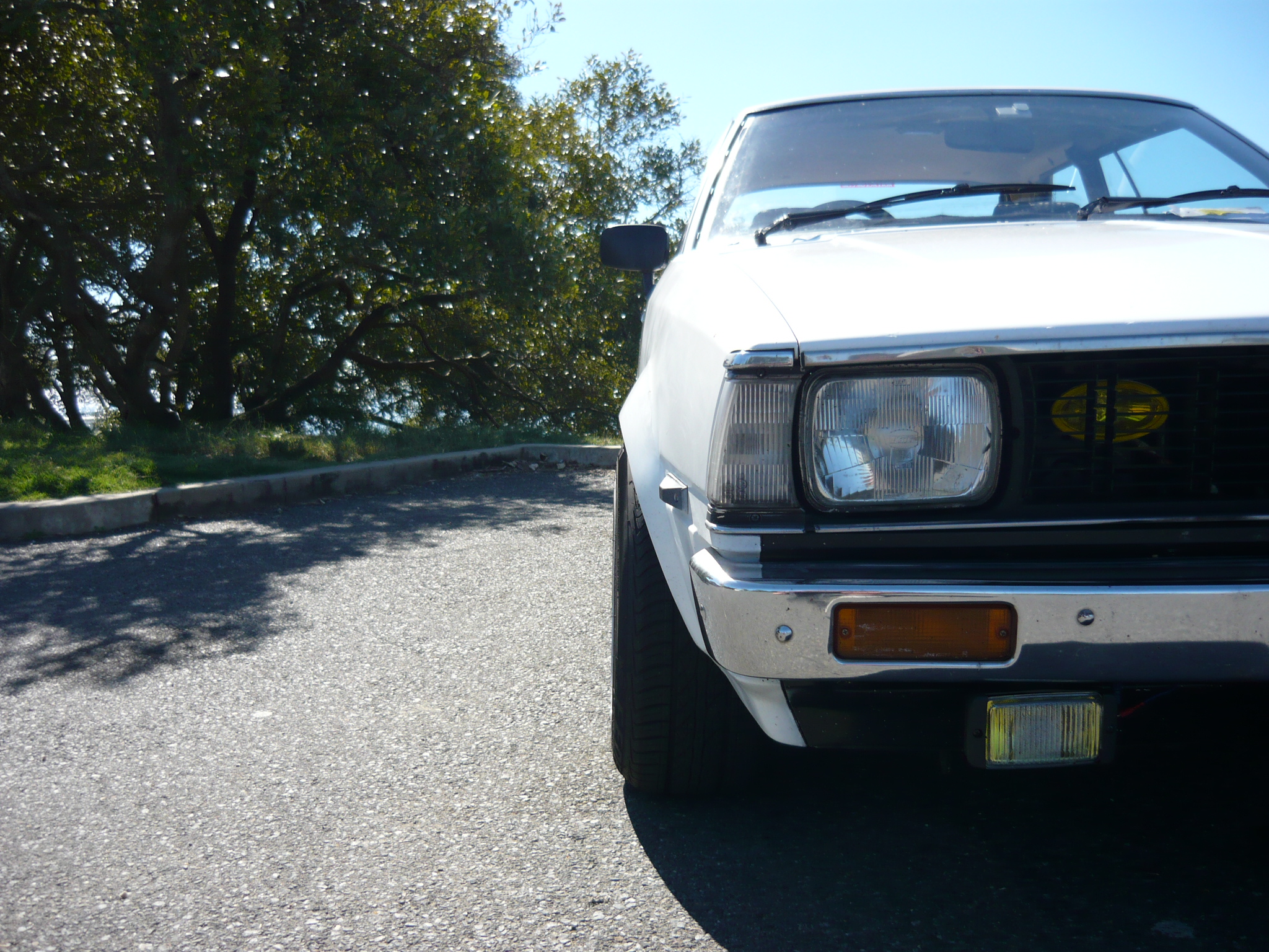

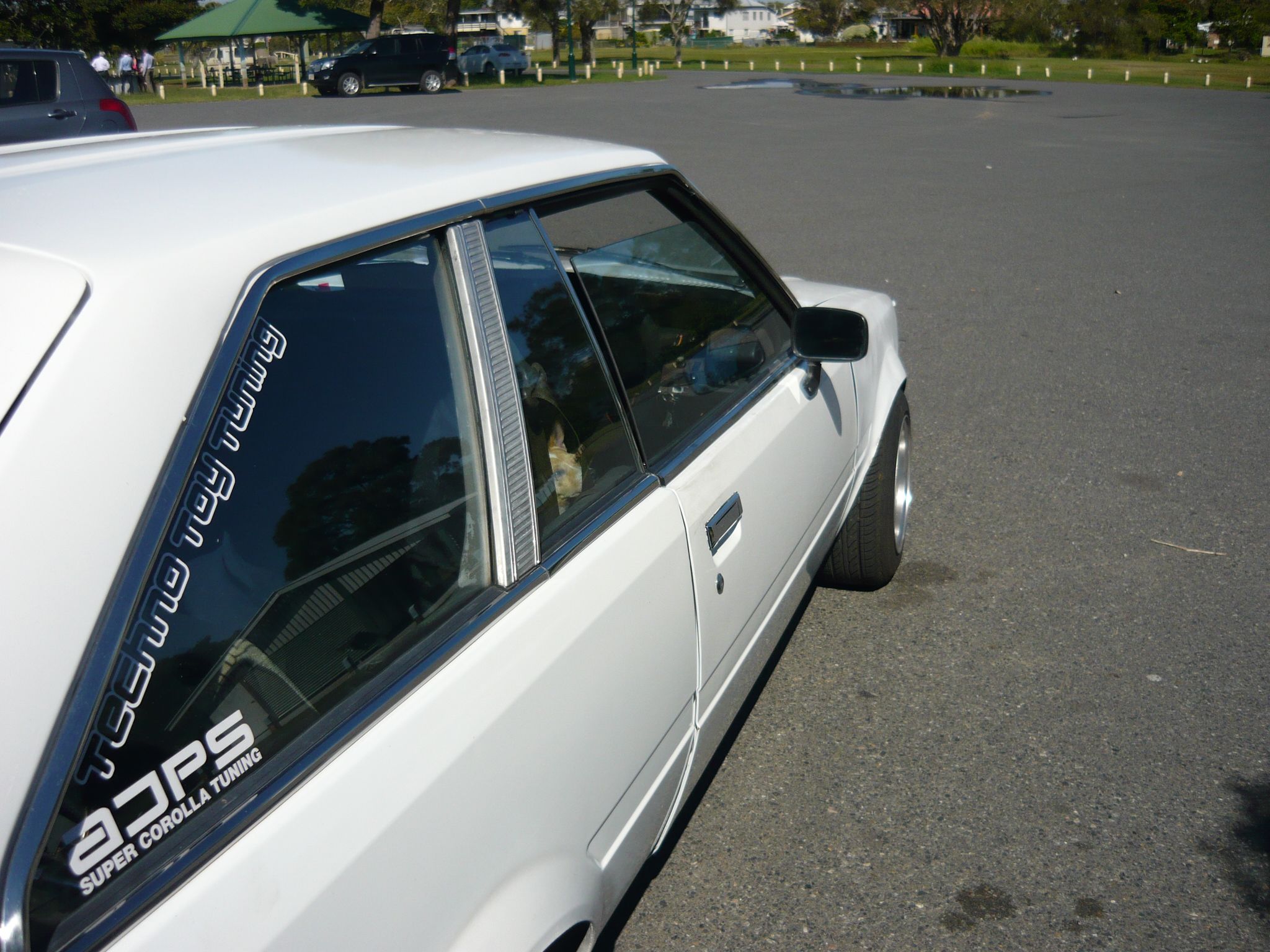

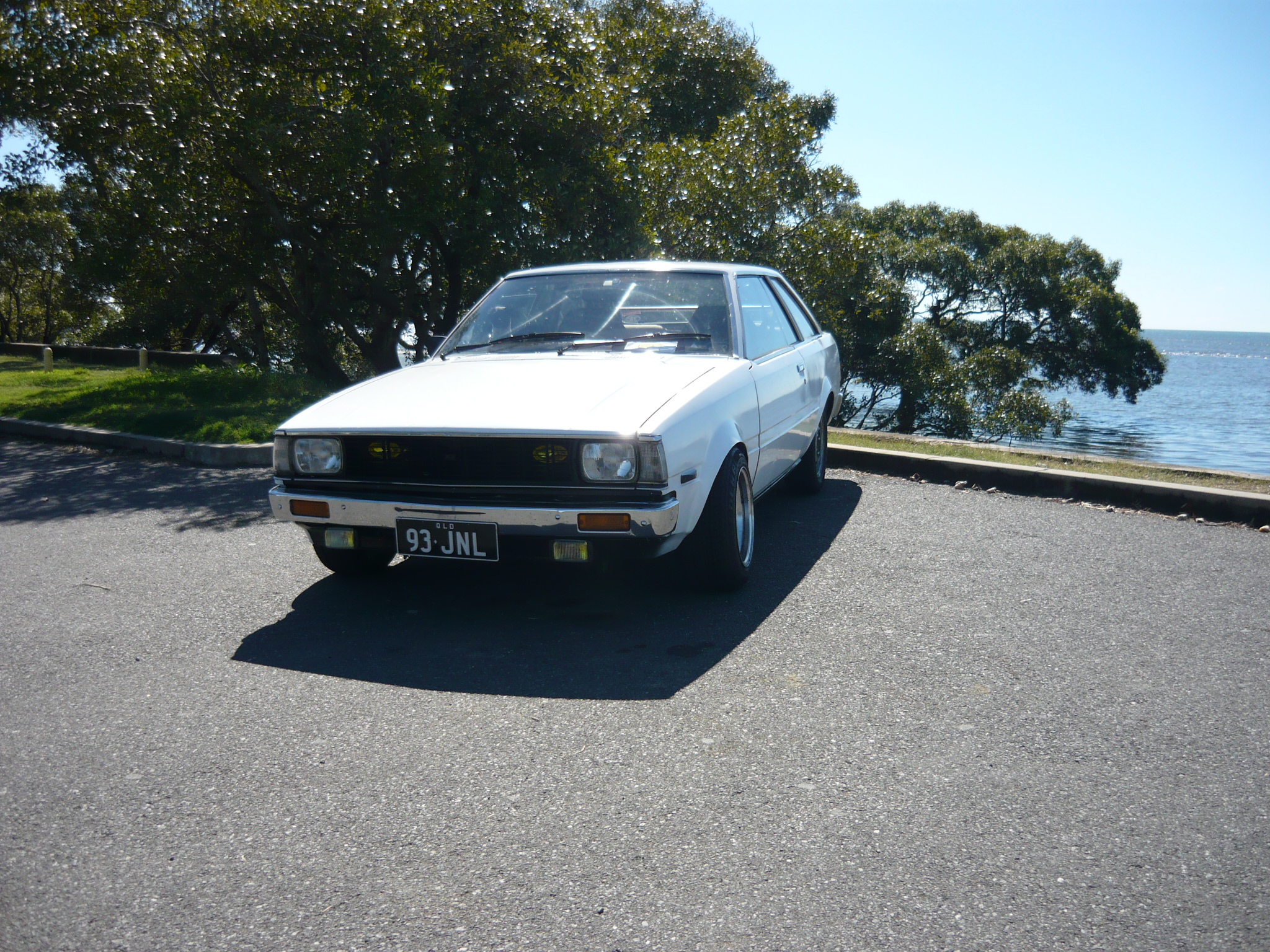

Some new pictures, new wheels on the front with -3 camber, got AE86 coilovers and JDM brakes, and 13x8 neg13 offset SSR Mk2's. Waiting on another pair from Japan for the rear.
duude :D thats awsome how much more traction/harder to slide is it with tires that wide
There only 185/60R13's so not really wide, but yet to try to slide it properly, might have a go on the skidpan at the racetrack one Friday night. It's a bit hairy up in the mountains with the 2way LSD(tight TRD that has been shimmed further), if you don't rev match when down shifting rear wheels compression lock, haha.

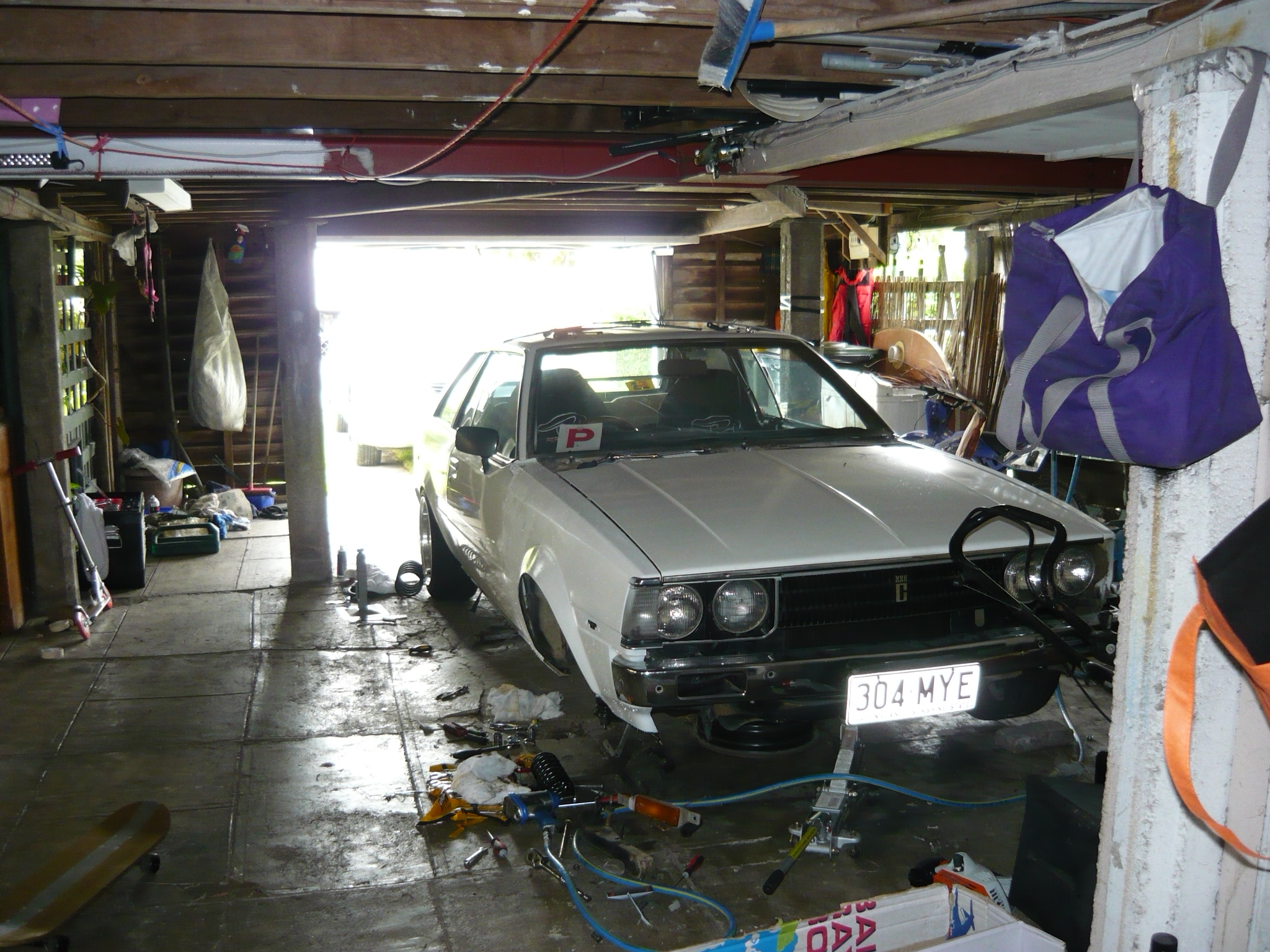

Is this even the same car?
Also I saw your car at Harry on Thursday last week I think it was, looks cool bro
Edit: the picture didn't come up in the quote, but it's the one with the quadlights and different plates
Edited by rianwest
Umm slid ok needs more power though but still fun.
Yep still the same car I brought off your mate from bangalow some of the rust has come though though so might be getting it all cut out after tax return
ah ye the quad lights didn't work out so got rid of them needed to mod the guards so just went back to the normal front end, and would have been mine you saw at harrys, the one time I could go was when I had tafe as I normally work nights and can't go.
