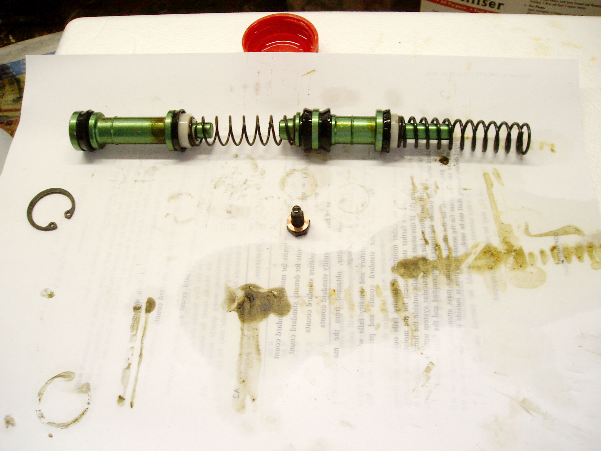

now i need a master cylinder i think?? if i put my foot on the pedal slowly it goes nearly to the floor but if i use in with a bit of force it works normal is my master cylinder about to shit its self??
also does any one have a 4k they want to get rid of had a quick look in for sale doesnt seem to be any there ATM
cheers guys
Does it lose brake fluid over a week or two?? ..or is it just recycling it? If its not losing it then master cyl is most likely.
Strip it, run a brake hone down it with an electric drill and fit new seals. If you haven't done it before, this is what is inside. Brake hones are just two small flat grindstones on a pair of sprung arms forcing them outwards. You slip them into a cylinder held in a vice, give it a good does of WD40 or CRC 556 or kero and pull the trigger while you work it up and down maybe 10times. Then clean it and check for marks or pits down the cyl. Rinse and repeat....
Be careful not to pull it out too much when its spinning, always have the stones right inside or they flail around and smash!

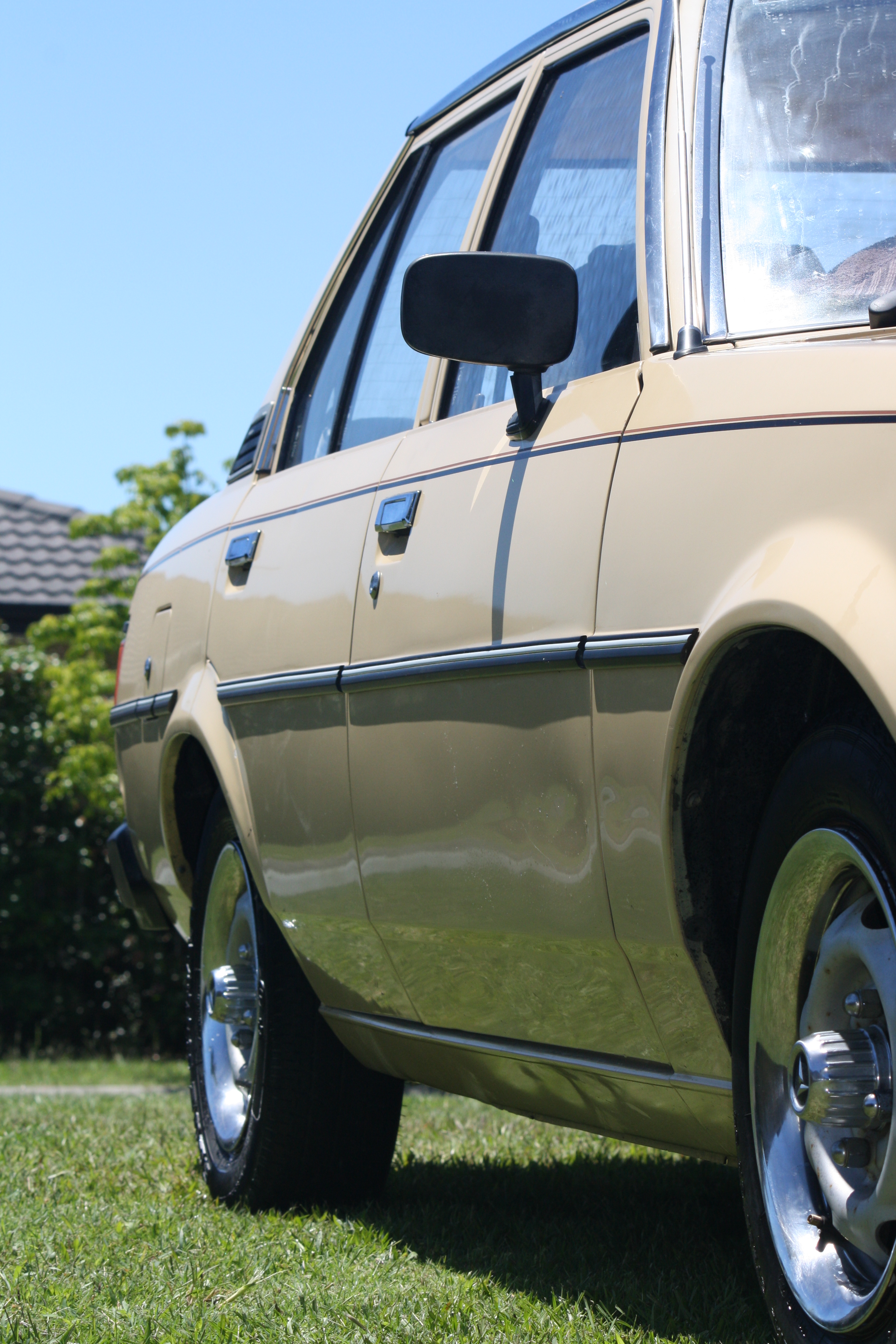

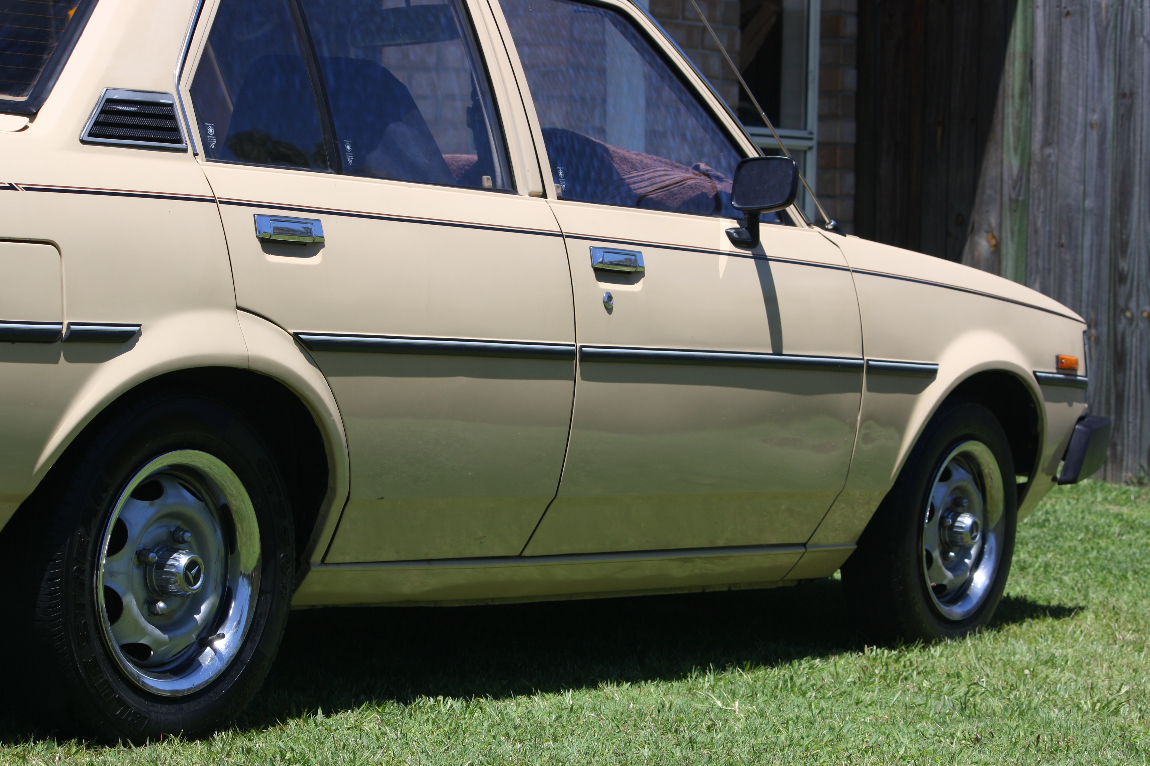

hey guys heres some pics after putting king springs in and all new shocks
just bout a new product to give it a clean and came up a treat got it from these guys
http://www.fullnoise.net.au/featured-products/lucas-slick-mist-speed-wax-710-ml-interior-detailer-710ml-tyre-and-trim-shine-710ml-spray-bottles-kit-of-3.html
