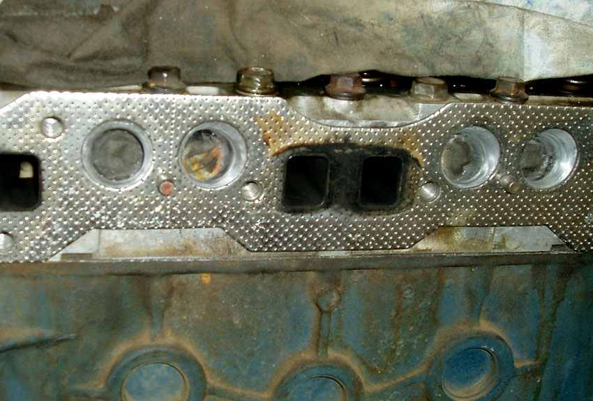

altezzaclub Posted July 18, 2010 Report Share Posted July 18, 2010 recomendations on where to get my head done If you're just going to match the ports to the manifold just do it yourself. Buy a curved cone shaped cutter and put it in an electric drill, which is what I did. Then the local head shop did a clean, skim and valves/seats. If you're in for the big port flow job then you'll need a motorsport orientated head place and a fat wallet. This photo is all I did. After I'd cut it I used an 80grit sanding flapper wheel from Bunnings to smooth it up. I figured it wasn't necessary to polish it dead smooth! Quote Link to comment Share on other sites More sharing options...
