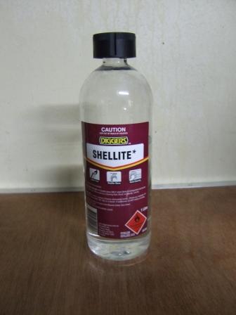

There is a product called "Shellite" that will lossen the glue without damaging the paintwork,
beeen used by panel beaters to remove rubber strips and pin stripes for years.
works brilliantly, just spray on liberally and let soak the peel the rubber off and spray more if needed.
Then use a rag soaked in shellite to rub off the remaining glue.
It is available from Bunnings and also at GOOD hardware stores. :blinks:
sorry, forgot to mention it is VERY flammable as it is normally used as a fuel for kerosine lamps etc.
and it will also bugger up your spray bottle so use a bottle that contained solvents already like PREEN or
