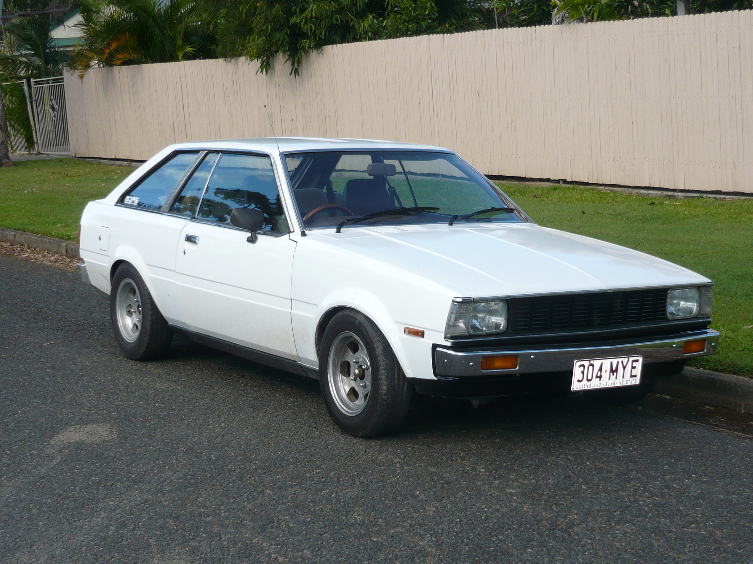

Hey, ive been looking at a suspension upgrade for my T18. Now I was looking at some ae86 8kg coilovers for the front and 6kg with adjustable spring things like ajps make for the rear and short stroke shockies which will cost about $1400 all up, or 6kg front springs with short stroke inserts and 4.5kg rears also with short strokes, cost is $400 for springs and not too sure how much the shocks/inserts will cost, (got quoted $250 each for koni inserts)
The car is my daily but would like to try it out on a circuit track/motokahanas/skid pan days, just some stuff that is cheapish and fun.
I most likely would not need the adjustability of coilovers but would it come in handy for what I want to do?
Or if ST141 corona lca's and struts ect bolt in I can get them cheap, can also get the twin piston calipers cheap too.
