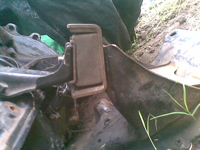

Hey guys, just starting getting together bits and pieces for this conversion and was wondering what you guys did about engine mounts?
I used Custom made ones. Not sure but I think u can use rb mounts but I'm not sure. Have a search on google
i'm using rb30 skyrice engine mounts on a ke70 crossmember and it looks like it may fit i just need to suss it out abit more yet
Apparently they bolt straight in with rb30 engine mounts, ive also heard rb20 aswell
got any pics of the setup yet mate,
I stand by the cortina and SR20 mounts, i don't know anyone that has used the CA mounts for the type of conversion in any car
i have got one picture, the passenger side bolts in alright but the drivers side has a little issue with alignment, plus it seems like it sits to the drivers side with the rb mounts but i'll sort it out and get back to you about it,
Passenger side
With the sr mounts are they the ones that bolt to the engine? And then a cortina rubber mount??
Edited by SLW42
