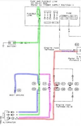

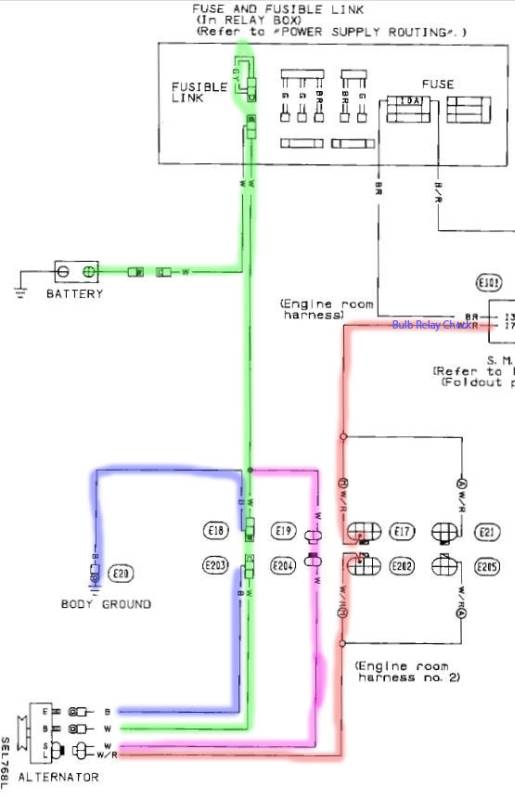

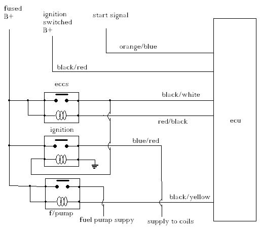

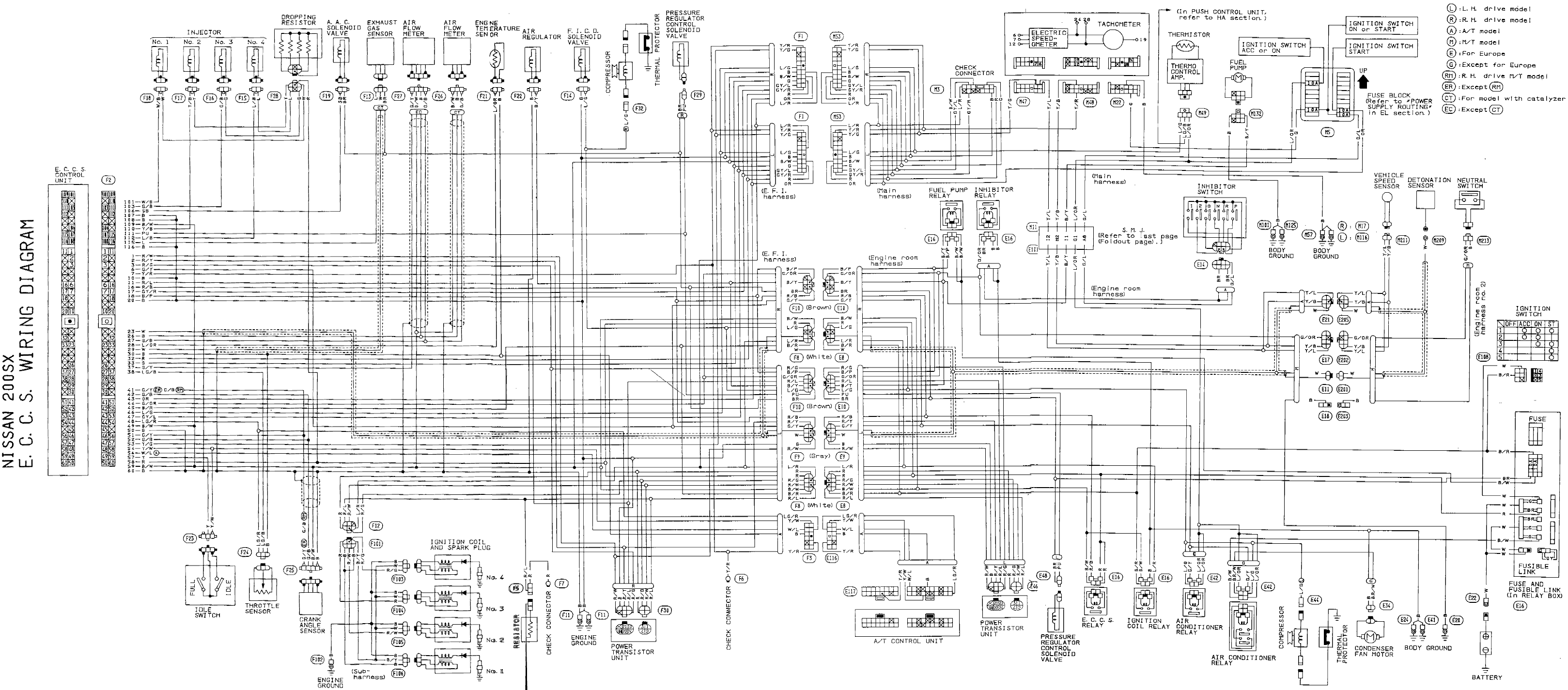

Thought I'd add a few notes for wiring up CA18s since everybody keeps asking about it the S13 engine loom comes in to parts, the ECCS loom and the start/charge loom. In my way, cut-up the S13 start/charge loom to adapt the E7 loom. For all E7 and I'd assume most other K power rollas would be the same. the start loom from the rolla fits onto the CA18, Main starter B+, starter sig, even oil pressure light and water temp wire will reach the CA18 senders. alternator is now on the drivers side of the vehicle. From the rollas external reg, there is a yellow wire in there that is the ALT check bulb, this need to be extended and run to the CA alt plug pin one ,it should have white with red trace in it. Pin two in the plug is a plain white wire and should be spliced to a constant B+. In my case, I ran a boot mounted battery, so I simply made wire from the alt pole to pin two in the alt plug, a 4 gage lead from the alt pole to the starter b+, then a 0 gage to my isolator and back onto the battery. the CA alternator should also be properly earthed, I ran a separate earth wire for it. CA charge diagram with that done, the only problem now is the S13 start/charge loom also contains part of the knock feed back to the ECCS loom. I made a new knock wire out of thin coaxial and just earthed one end of the outer sheath for shielding. Knk wire is a white wire, easy to find because is has a black shielding wire around it with a grey cover and is twice the size of the other wires. ECCS loom is pretty straight forward, engine attached at one end, ECU at the other. most of the powering up of the ecu can be done through the F8 and F10 plugs(two plug that are on the end of the airflow meter branch). I just made up a bank of three relays behind the Left headlight, Ignition, ECCS and F/Pump and made up a loom as below. the Ign switched B+ and start signal I ran straight from the ignition switch loom, under the dash and patched into the CA loom(you'll see the ca loom has a spare plug just up from the ecu that has these two wires.
start the car up and let it idle. grab a multimeter and set it to dc voltage in a 1-10volt scale, put the red lead on to the B+ terminal of the alternator and the black lead onto the positive terminal of the battery. this will tell you voltage drop in the B+ charge wire. a good charge loom should loose no power(ie. less than .1 of a volt). This way is much more accurate way then measuring static resistance in a line because it takes into account the current load on the circuit ie. a length of 18gage wire measured will have negligible resistance, but if you try putting 15 amps through it, you will get a voltage drop that could give problems you won't pick up by checking resistance.
