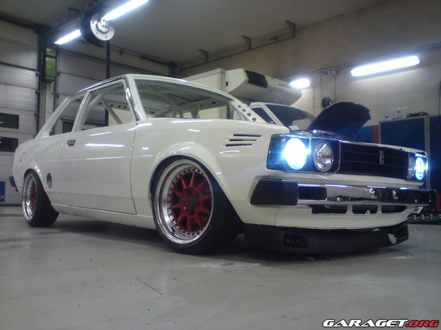

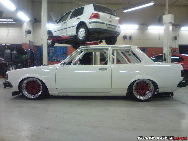

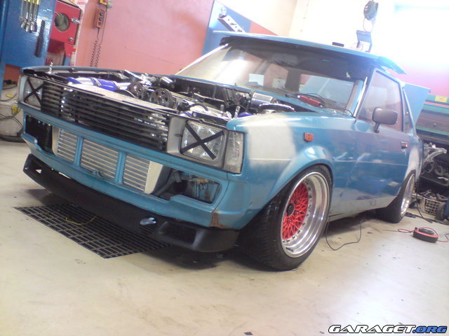

hi my name is Roland and comes from Sweden! I have built cars in 15 years, both show and performance cars have been with the lot o tv repotage tiding over the years that I think has been very fun! But the construction which I have spent most time on is my corolla ke70 that I have been doing for three years and now it finally be finished! hope to have it fully operational and inspected for the Swedish roads in summer 2011:) here are some facts about the car

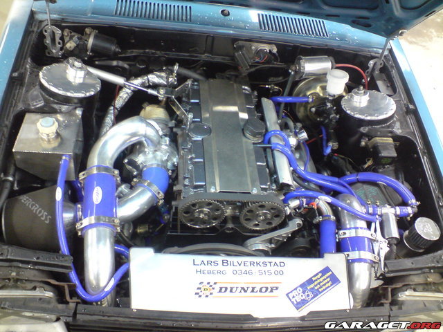

engine, five-cylinder Volvo engine v70R with GLT cams Volvo S60R kkk27 turbo, large intercooler, 40liters fuel cell with twin Volvo 740 pumps to catch the idea and after a bocsh 044 pump, nuke fuel rail. 3 "exhaust with heat bandages all the way back 4.5" tail pipes out the rear fender, engine power ca300-330hk at the moment but the other engine will be built with about 650-700hk
gearbox: BMW M535 GETRAG bmw m-sport clutch Sellholm lever with very short gear volvo rear axle with welded diff until I can afford a locker diff rear axle suspended by four link

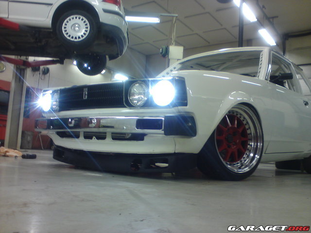

Chassis: coilovers from ölhins back and volvo r-sport front front suspension built by Sellholm plus top bearings only uniballs in front suspension and rear suspension all adjustable

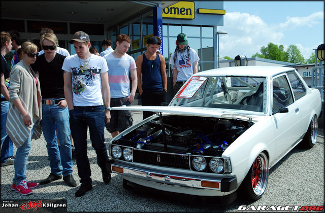

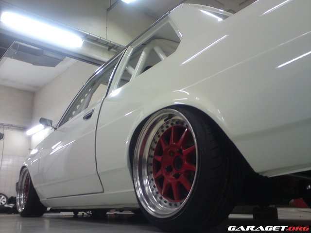

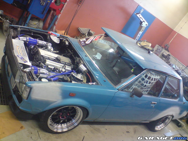

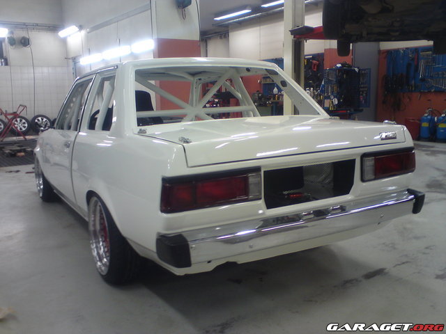

post-12238-032644400 1288420153_thumb.jpg testing my new wheels 8/16" and 9"/15 compomotive post-12238-061115400 1288420160_thumb.jpgthe engine volvo 5cyl from an 2001 volvo v70R about 300hppost-12238-090208600 1288420162_thumb.jpg cage 36m an new paint jobpost-12238-004940200 1288420165_thumb.jpgnew paint and red centers on my wheels

post-12238-064518900 1288420769_thumb.jpgther is sitt behind my ride and talks to the fat dude ;)post-12238-076172300 1288420791_thumb.jpgtesting one of my volvo 244 wheels on my rolla but they are to big and vide 8/17" and 10/17" hahapost-12238-021152100 1288420789_thumb.jpg at my house some of my other cars the vr6 passat is my trailer car for the ke70
