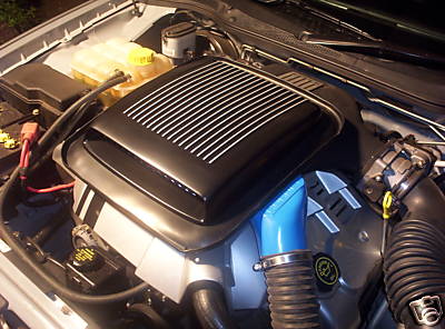

and I'm thinking get one of these cranking straight into the turbo intake aswell :lolcry: 1/i/000/ea/7d/afa5_1.JPG?set_id=7 but seriously :D
