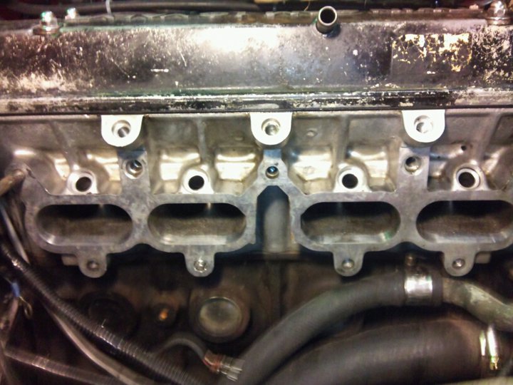

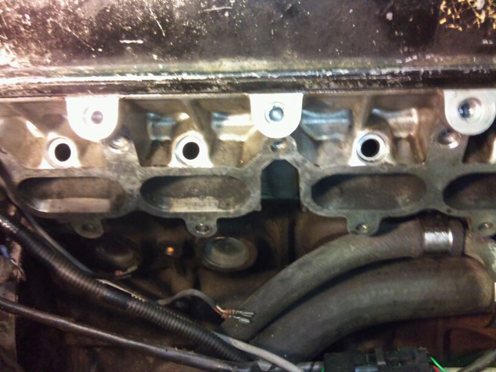

ok so first i begun dismantling the inlet side to get gaskets in there and shiz and found everything was very dirty so i figured cleaning would be good...
heres a shot ot the inlet side of the head and the ports before...
and after a little love with a rag and throttle body cleaner

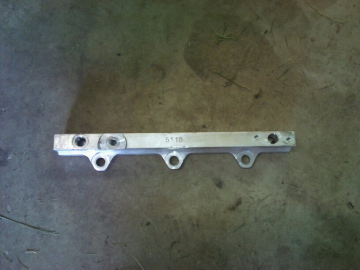

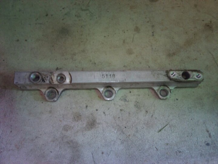

next in line for a clean was the fuel rail
before:
after a little clean with some alibrite (highly recommend this stuff but use gloves lol)

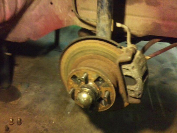

Now with nothing i can do on the engine front until i get my gaskets, i decided to get into the next big hurdle, the front suspension.
it had previously copped 80% or so of a XT130 front end upgrade but it was missing a few key things, and also the caster rod, the rod bracket and the sway bar were all bent on the passenger side, QUITE badly. all the bushes are rooted and stuff too.

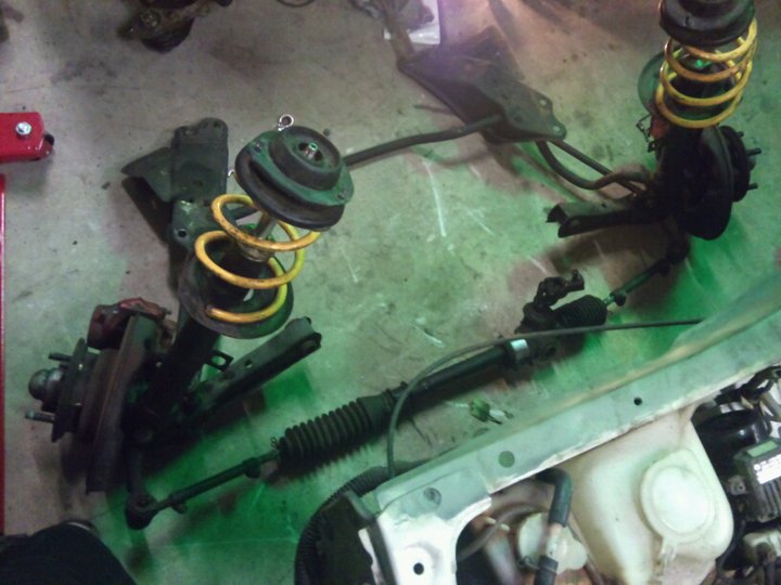

The easiest thing to do was rip it all out and replace it all with my DX's gear as its all been painted up nicely and has little grime and yuck on it, also the bushes are all nolathane ungraded items. A lot of people poo poo the nolathane items but my stuff is over 2 years old and been in some VERY harsh conditions and it all works sweetly still. No cracks, not dried out not even discoloured. My rack also has a AJPS opposite lock spacer and almost new front wheel bearings. So i could pretty much bolt it in except I'm anal as about it all so itll all be pulled down, cleaned and regreased, all the metal work water blasted and repainted (probably in red to match the car...) this will be done tomorrow evening.
some pics for those who prefer the visual kind of stimulation :)
heres one of the poo as single piston xt130 brakes that were in it.

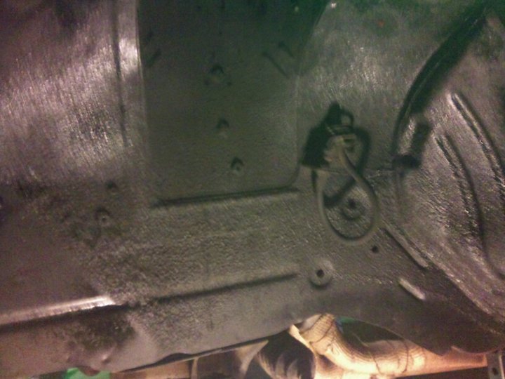

inner wheel arch, passenger side after strut removal and a paint
and heres one of what was the dxs front end removed ready for a tart up and being put into the new car.
