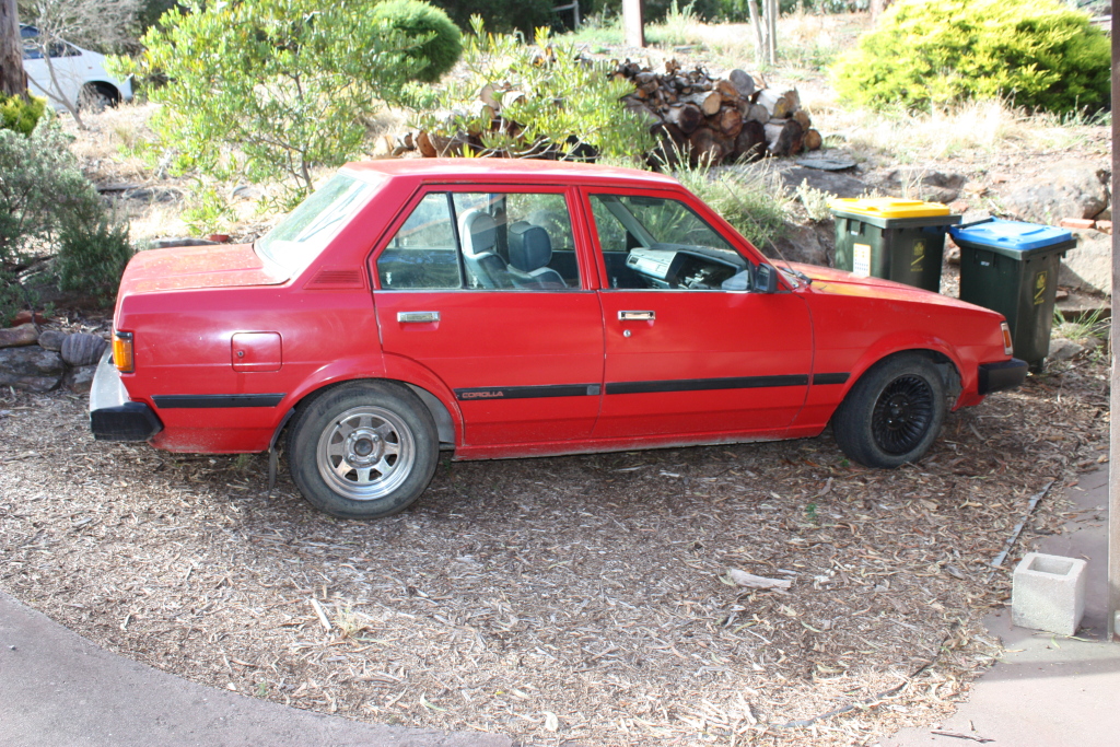

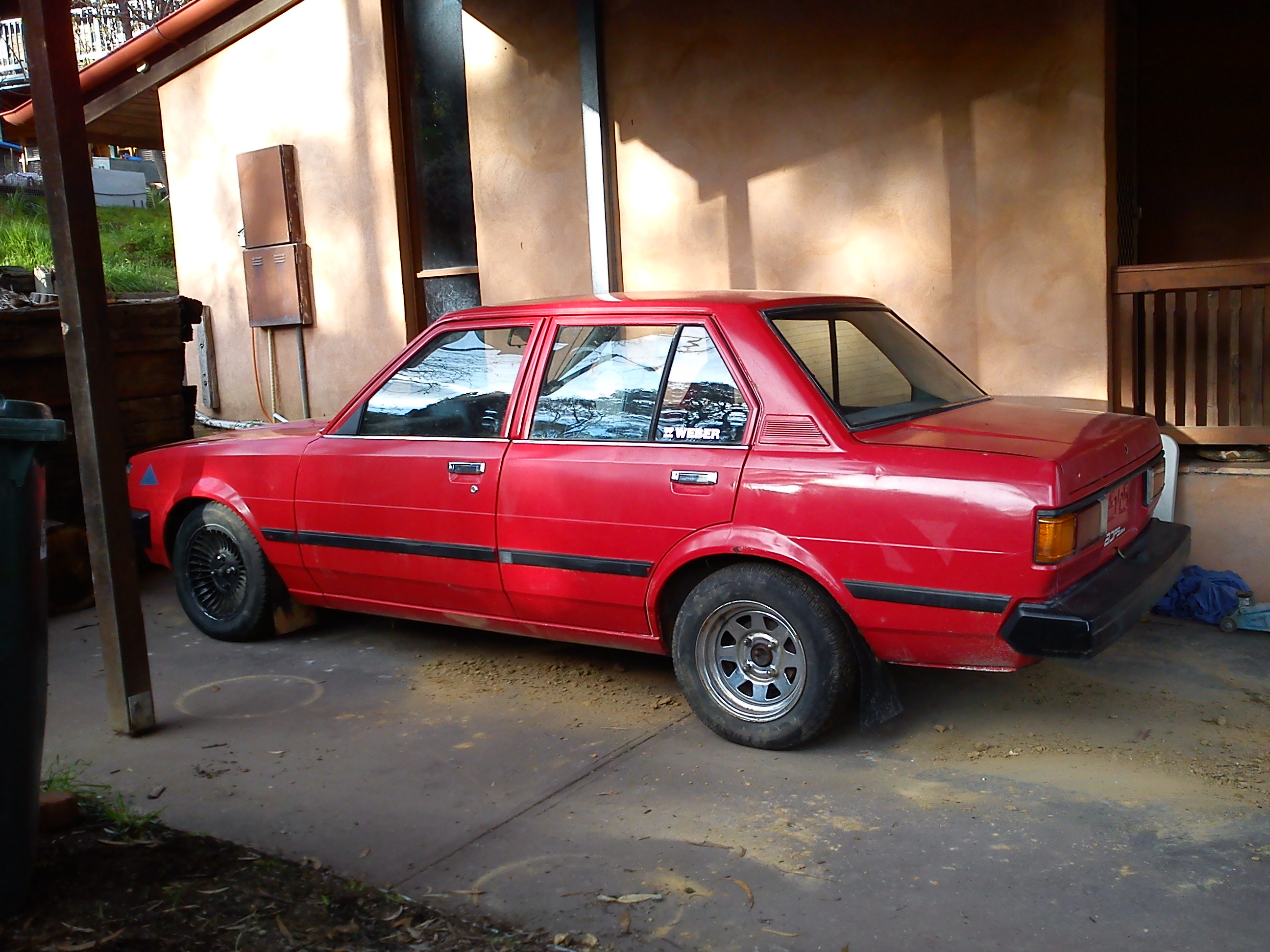

And here she is, a 1984 KE70. It had already been built and taken to khana's a few years ago, but the previous owner has moved into drifting (in his 300kw ATW Soarer!). I'll stick with something cheaper to start. It has a stripped interior, auto 4.3 diff that has been locked, new shocks, 4k with .30 thou shaved off of the head and a DGV Weber. It seems fairly firm handling wise, it will interesting to see how that shows on the track. I suspect the back springs are something different or maybe cut, but I'm not sure.
My plans so far are to leave it as is for my first event in March and get to know it a bit. All I've done so far is taken out some extra unecessary crap.

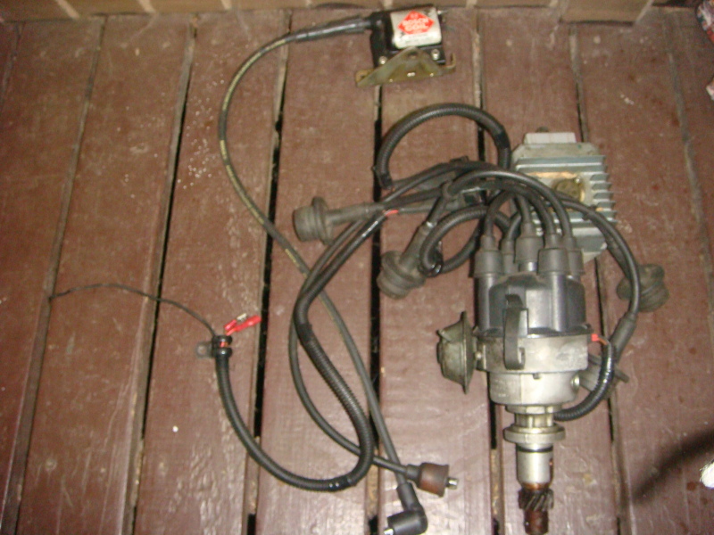

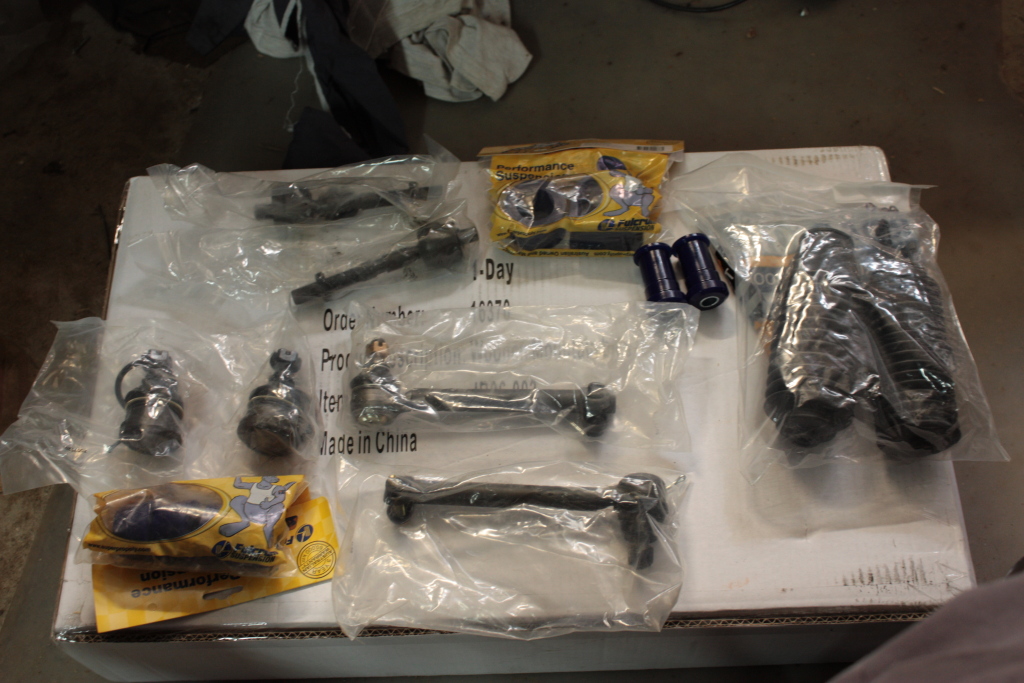

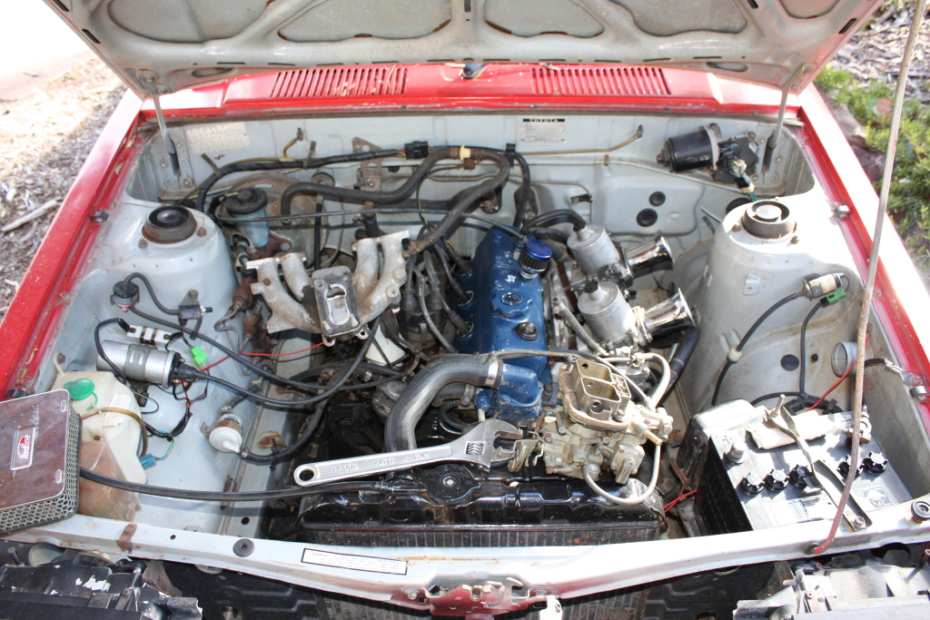

After that I have some extractors and an exhaust to put on. I've recently fitted a momo wheel. I've also recently picked up a twin carb manifold and some Dellorto's for it, but I'll take my time building them up properly. I also just got a front end kit which is basically all bushings, rack boots and all joints to rebuild the front end. The boots are stuffed and there is a bit of a clunk so that's pretty high on the list. I also have some KE30 LCA's that I'll put on while I'm at it for a little, but not too much -ve camber.

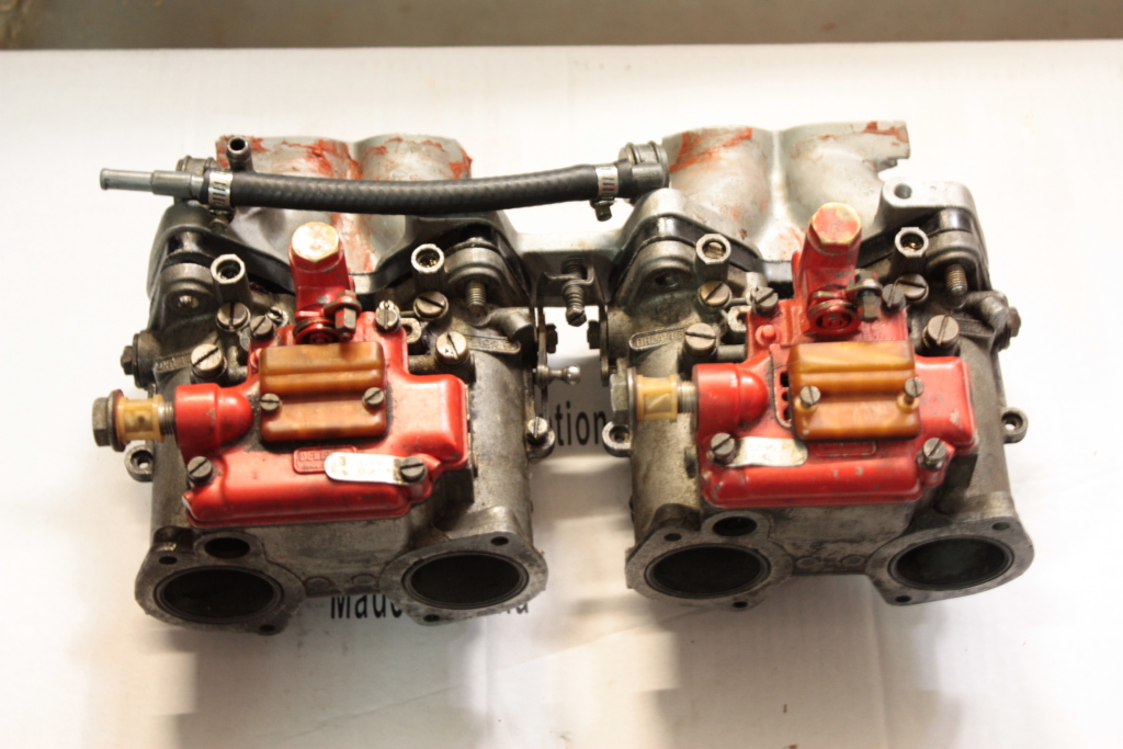

I've also posted a trial fitup shot of some SU's that I was planning to put on. The Dellortos came up for a great price though, so I couldn't resist. smile.gif

Still, it hasn't stopped me from accumulating a few goodies for reasonable prices. It should keep me quite busy if I ever get any free time.

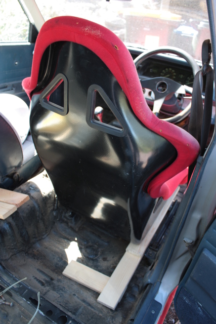

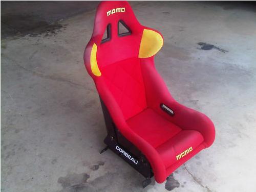

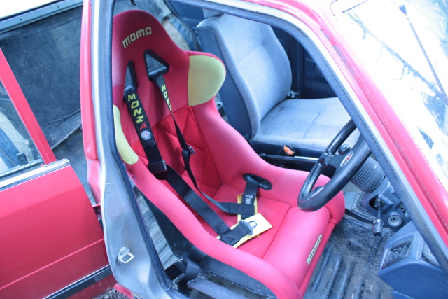

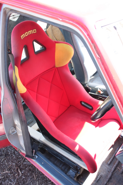

Finally grabbed a few hours this weekend. The wheel is finally on with a new 35mm spacer. Sits much better so I can squeezy my lanky legs in. Picked up the seat and started trying to mount that. I forgot what a horrible job this is! Ended up hacking up the stock mounts to get both lower runners. I'm thinking of removing the rail, using the feet and welding up some sort of steel square frame in RHS and welding the feet on that. I think that will be the easiest way to keep the whole lot level and make it strong. The horn button will go in when I get to centre the wheel. The seat feels very nice though and saves around 5 kilos. Might be less when I give it a decent mounting though! :/

hey mate some advice, iv done the rhs thing with my sparco seat in my ae71... its a c**t... go to the wreckers and pick up a cheap ke70 drivers seat, the rails are different and youl only have to drill some holes and maybe make some spacers to space the rails out a bit, piss easy compared to 71 rails
Hey buddy,

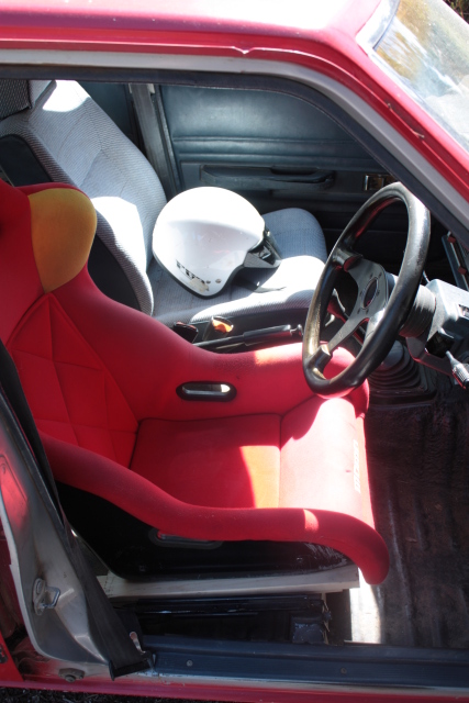

Thanks for the advice. I'm pretty sure they were actually KE70 rails anyway. The seat is all mounted now and very very strong :) It ended up being made out of plate 50x5mm with the feet removed from the original seat mounts and welded on the bottom. It's very strong. It was a bit of stuffing around to get the right position and probably heavier than necessary, but if things go wrong I should be OK.

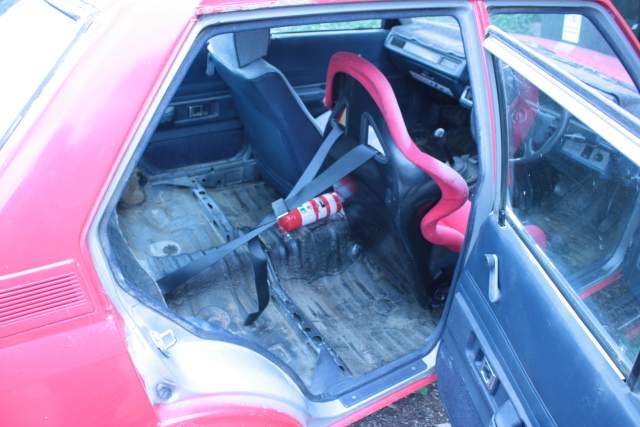

I should put in an update. Seat is mounted. I bought a fairly cheap Monza 3 point ADR harness which is in. Feels pretty good. Something bigger would have been better, but I'm on a budget at the moment. So far we're looking pretty good for my first event mid July. I have an extinguisher to mount then I'll do a brake bleed and give all the suspension components the once over to make sure she's safe. :)
Seat all done, cheapo harness in (hopefully the mounting is OK with scruits) and the fire extinguisher is in too. Fixed an exhaust leak and then worked out how dodgily the exhaust is actually mounted, bugger! I wondered what all the noise was when I started the car, it's the exhaust bashing on the floor. I'd always planned to replace the lot when the extractors go on, but that will have to wait a few months.
All that is left now is a flush of the brake system, safety check and rego. Mid July just isn't coming quickly enough!!

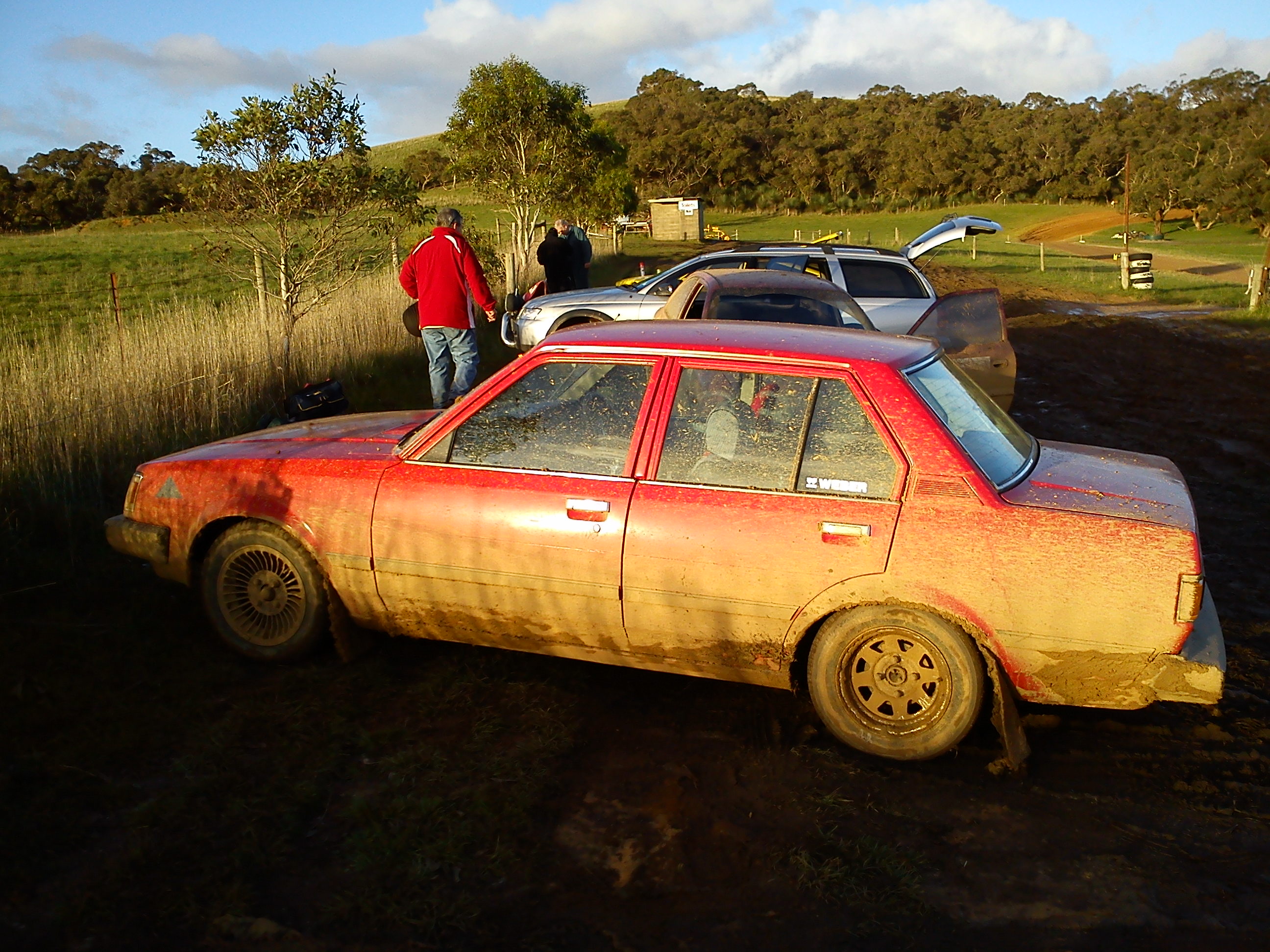

Well it had its maiden voyage in terrible conditions today. I had a blast, but was way down the back as far as times go. I need to sort the handling, the back always wants to overtake the front. I think I'm probably not driving it aggressively enough with the locked diff in it. I'm working through some movies that I took, I'll post them later.

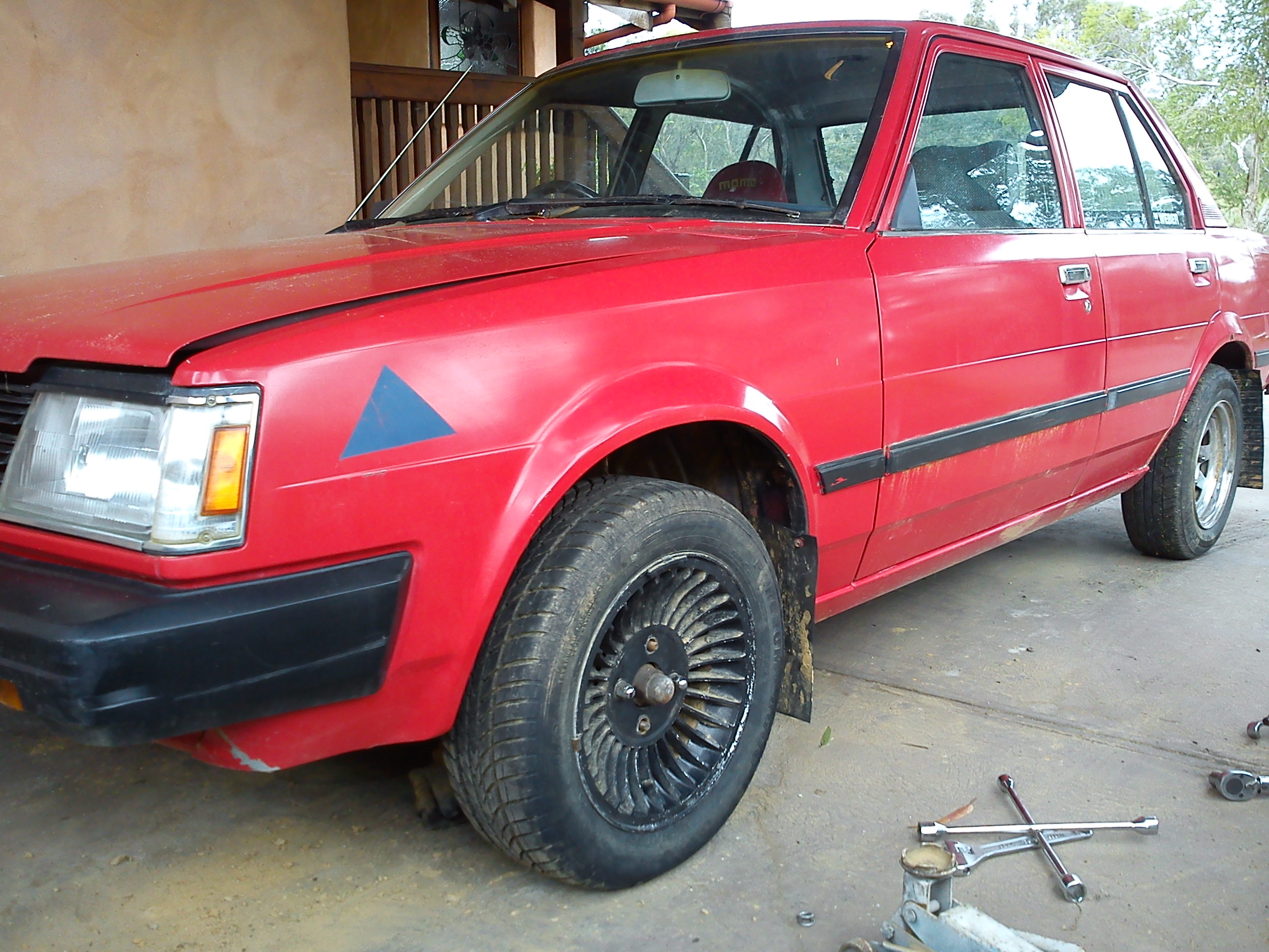

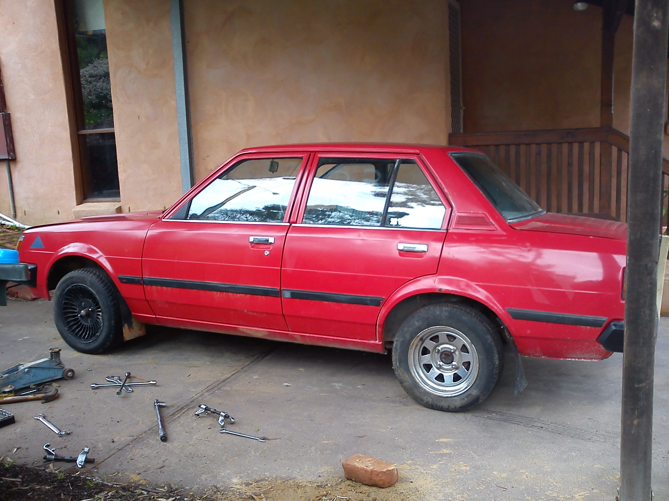

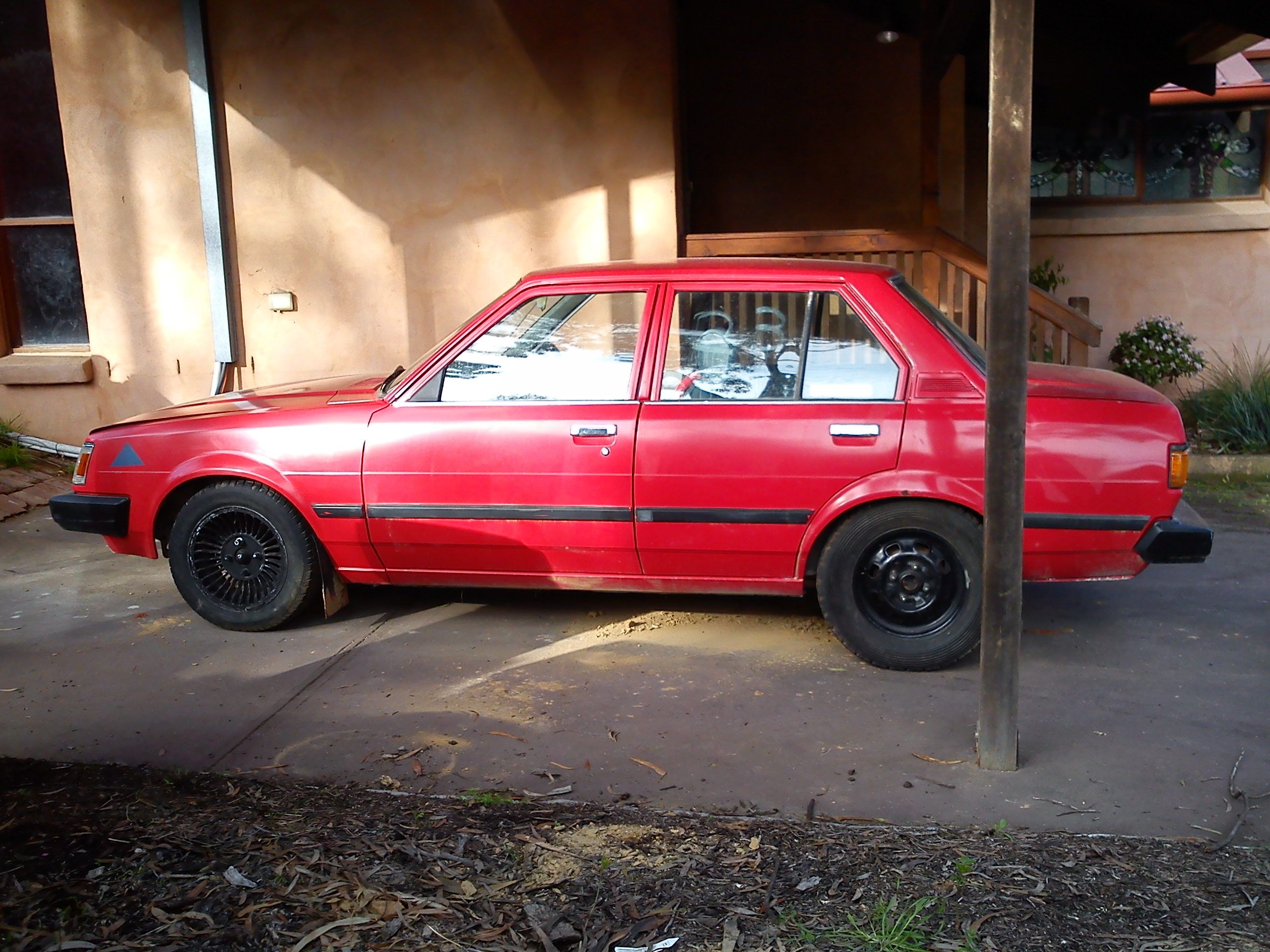

So it's been a pretty productive couple of weekends. Last weekend I put in the free sprinter springs that I scored. It jacks up the back a fair amount, it's taking a bit of getting used too. I also mounted the 14" rally tyres. They are huge!! It's all looking a bit 4wd at the moment. It will do but I'm thinking for khana some lowered springs might even be a good thing.

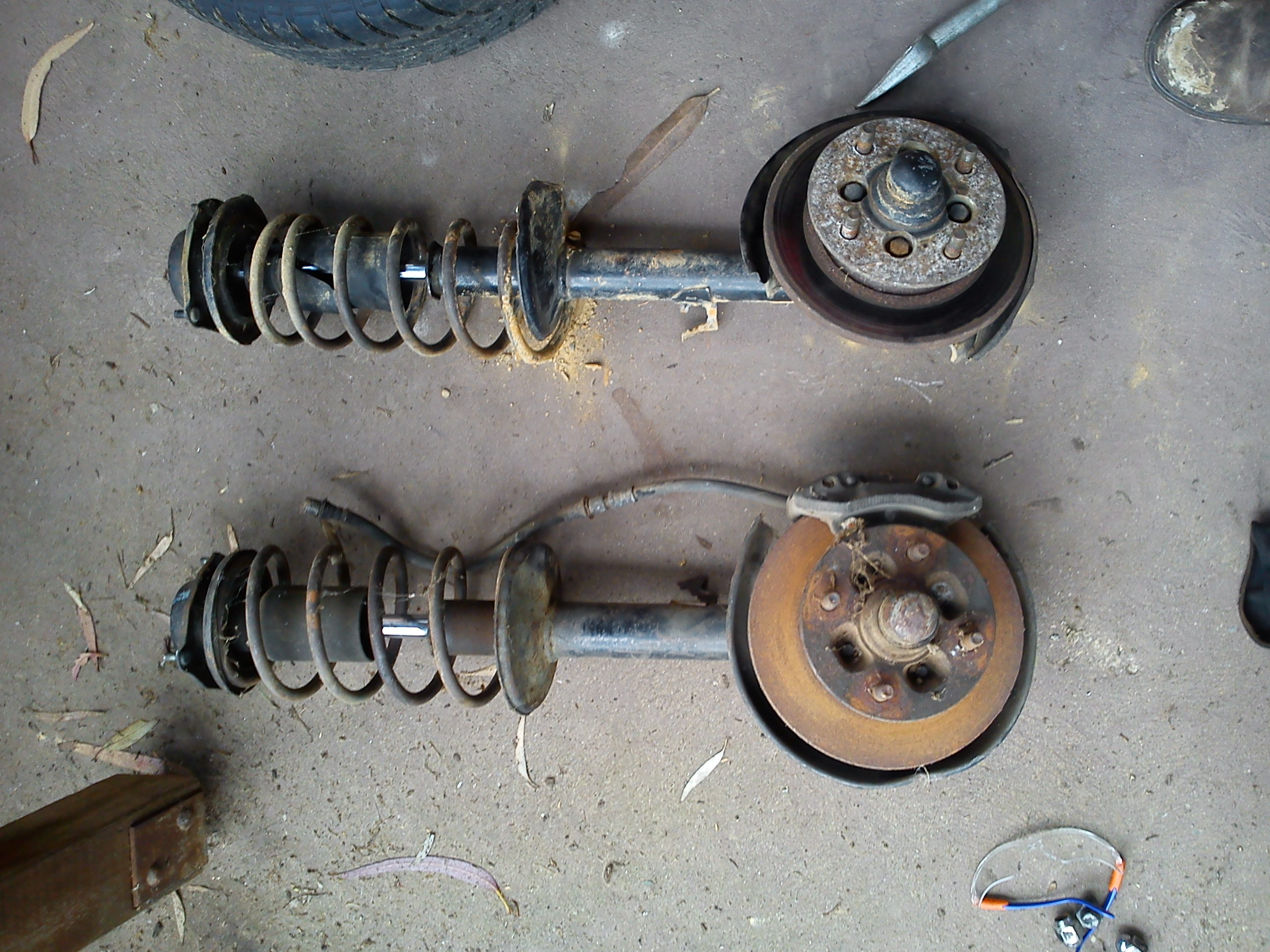

This weekend I had a crack at getting in the TE72 struts. In doing so I found that the last owner did the most dodgy of things with the ball joint. The thread on it is munted so he put three thick washers on and engaged as much thread as he could. That was probably about three threads. Getting the arm off required a light tap rather than the constant bashing you usually have to do with a well fitted taper. Oh so dodgy! I'll have to bring forward cleaning up the KE30 arms and new ball joint fitment. So the struts went in quite well and now the front matches the back in it's 4wd look! I didn't hook up the tie rods, so I wasn't able to really roll the car back and forth to settle it, not that that would have made a heap of difference. Still not sure I like it, but the rally tyres don't clear the spring perch on the KE70 struts but do on the TE72 struts. Also the 72 struts are much bigger and have the spring rate that I want, more or less. Plus bigger brakes. The 70 struts are back in while I recondition the TE72 struts. Next khana isn't for quite a few months unfortunately as I'm becoming a Dad in less than a month! We'll have to see how well I'm able to negotiate leave passes.... :)
