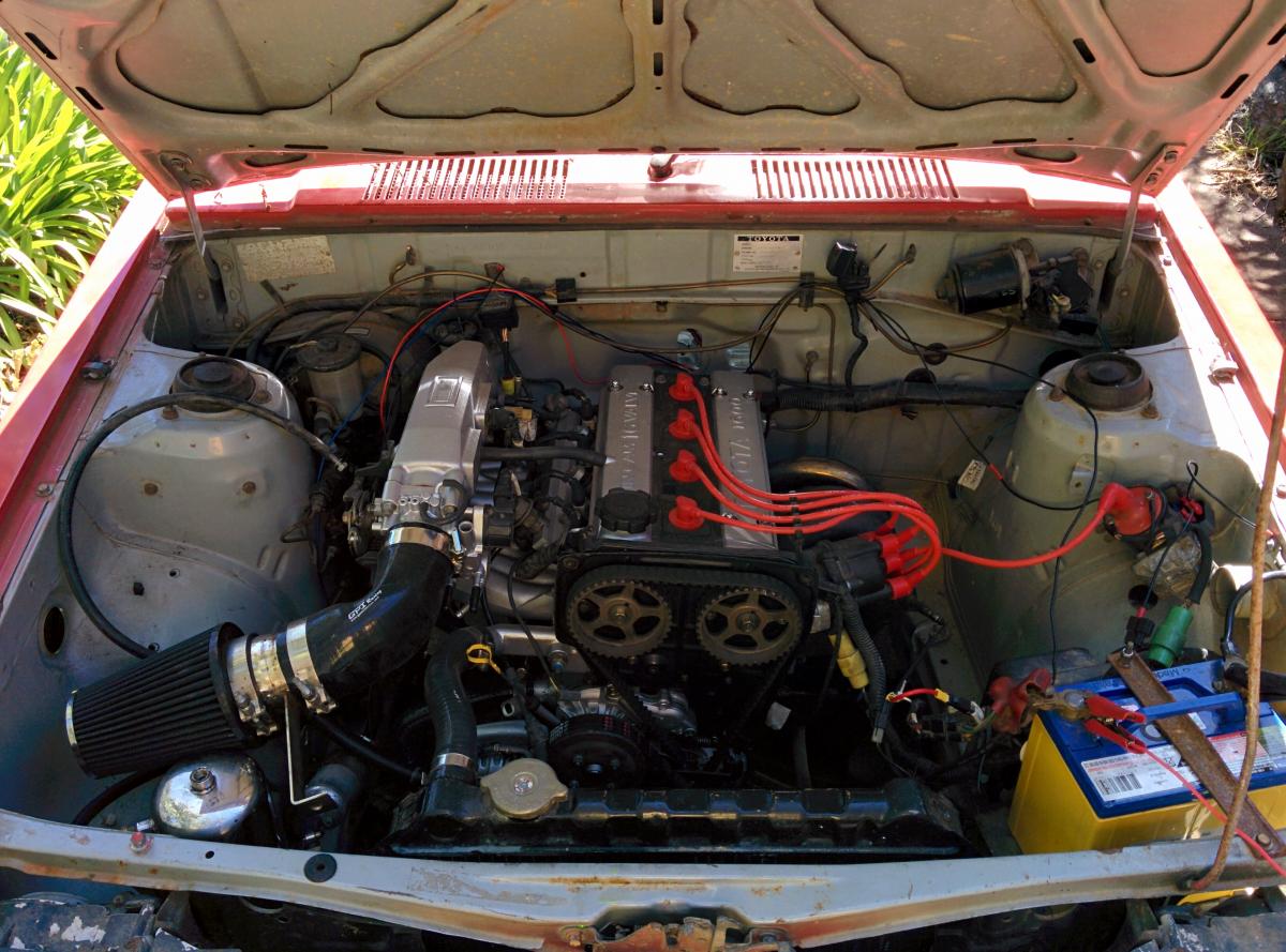

So, this runs! Life has been insane, but now I need to rip down the shed around it so it has to move or there will be dramas.
It actually came together fairly easily. I'm only running a temporary wiring for the moment. I wanted to run it all first to work out how it would fit together before doing proper wiring and using nicer connectors. My wiring came together well. I only fried one wire of my own making when I hooked up a relay in the same fashion as a Toyota relay and internally they were different. Easily fixed and fortunately I didn't kill anything else.
I was a little worried about it not working, I'm using the AE86 loom I have along with an AE86 dizzy which I hadn't used before, so there were some unknown quantities. I turned it over and got some back firing, so I knew ignition was OK. Then I remembered I'd only put the dizzy in for show, not for go. Corrected that, hit it, and we're away! It's very loud though, I may need to do something about that, not sure.
Unfortunately I was having the floating idle problem. A quick google told me one of the first things to do is check the coolant level. I did, there wasn't enough. Then I found the leak. Damn it!
I decided to use the RWD water pump I had, because RWD, but I think the seals have dried up and it's not water tight. I've ordered a new FWD version and I'll just use that, I'm going to run thermos anyway.
I have to say though, it's nice and easy getting the water pump off on a RWD car! I'd forgotten how nice it is to work on them.
So for now, panels are on, the tailshaft is in. I just need to put the pump on and the steering wheel and we should be OK to move it around.

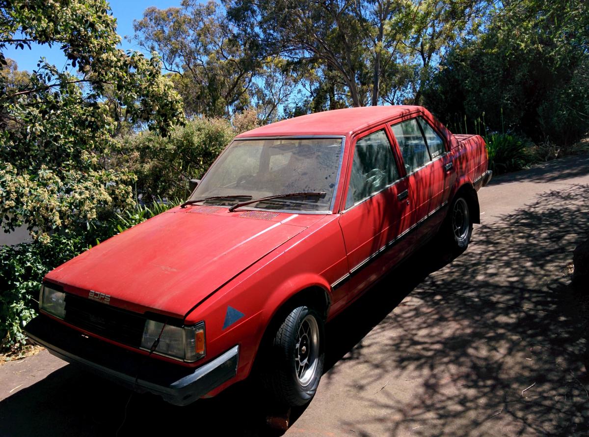

Yeah, might take some chasing. Pump is fixed but the problem remains. This is an untested throttle body so I'll put on the other that I know is ok and see how that goes. But, it's outside! Has only taken 4 years ???? So I've discovered that the flex in my exhaust leaks, and my driveway is steep enough for fuel to come out of the line when parked on the slope!
