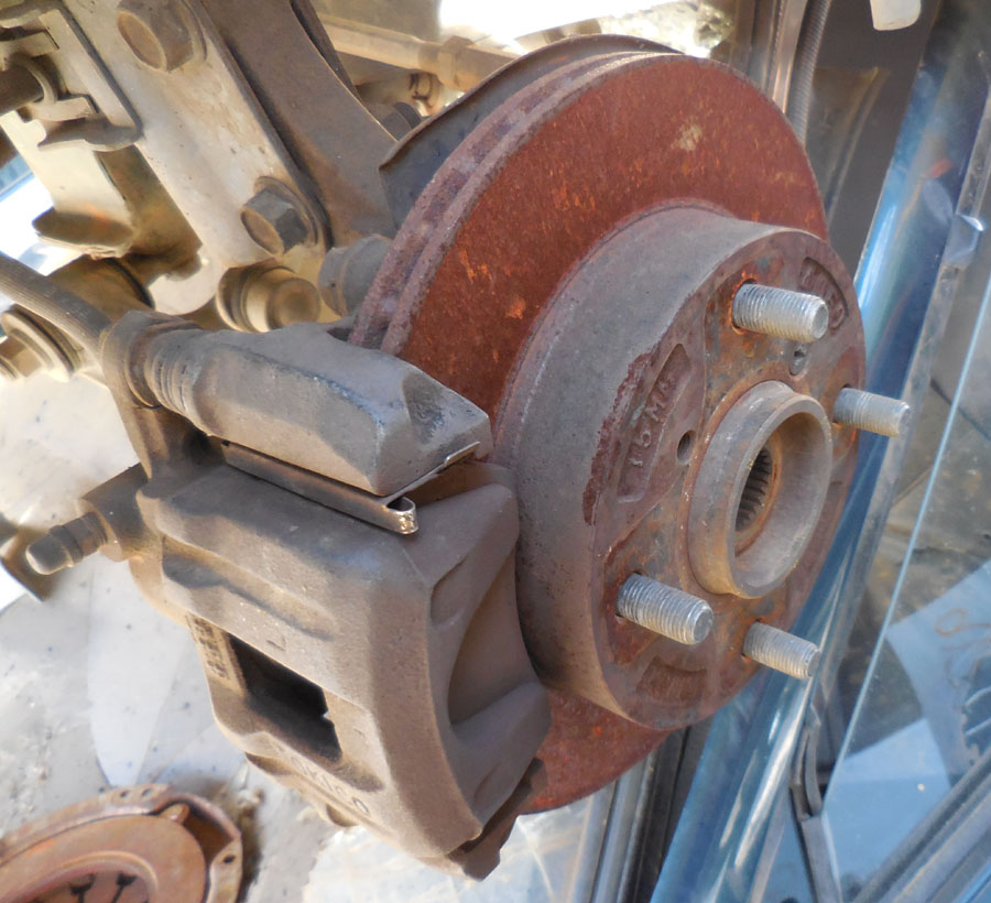

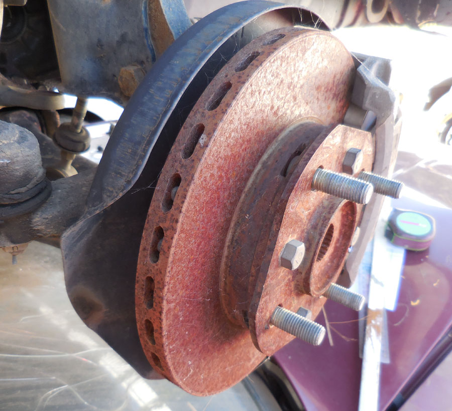

Nothing off a fwd look like fitting?? The Suzukis and Mirages have small ventilated discs, but I haven't really chased it up since we put the rally car on hold.
Well the caliper is designed for a 12.7mm disc, so I'd have to juggle all that. I guess it would be possible to make spacers to make the caliper wider, but I get the idea that that's generally frowned upon. I searched through a brake rotor catalogue and found a heap of discs that could be made to work, some almost perfect in size.
Given there are already big slotted rotors on there with decent pads I'll probably use them to start with and worry about it later. It's a project far down the track! I did measure up to see if I could use my current springs with them. It might work OK, not sure what it will do to the height. I might muck around with that after she's running.
