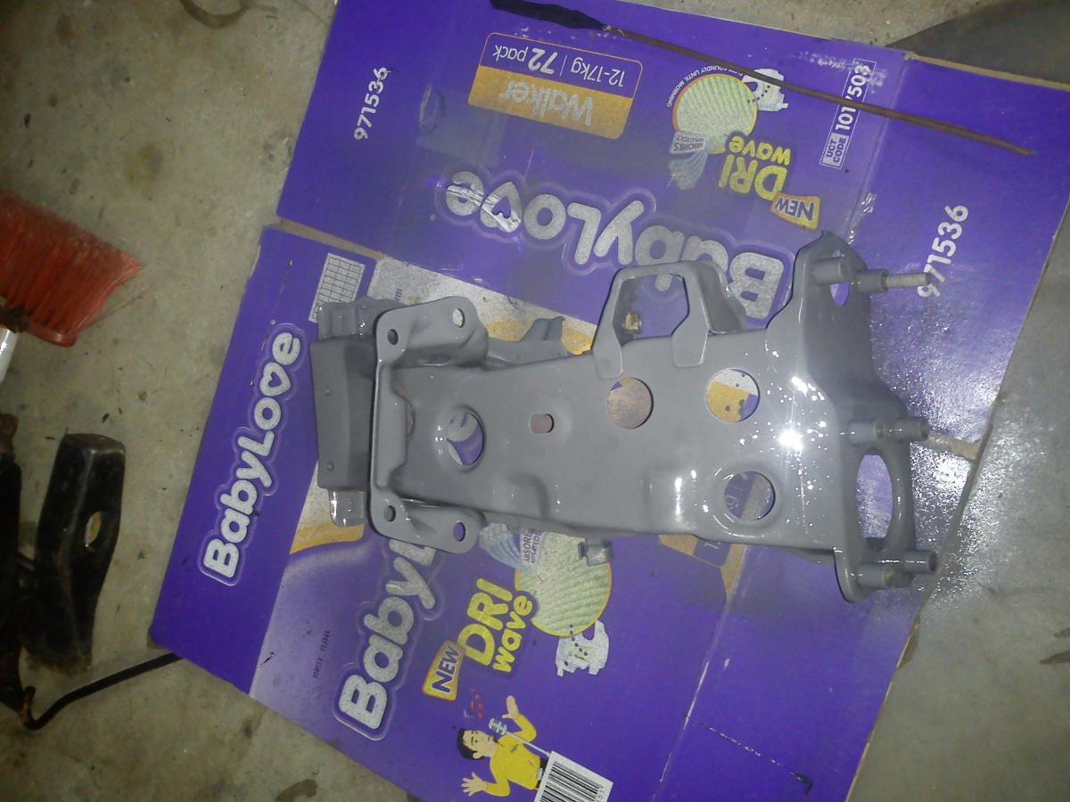

Over the past week I stripped the pedal box and started painting it to get the conversion going.
I also picked up a Bosch 070 on the weekend. All I need now apart from sundries is a radiator (still have the KE70, but it's pretty rough) and a lift pump.
Here's last nights effort etch primed. I'm not sure why these are bare metal from factory...

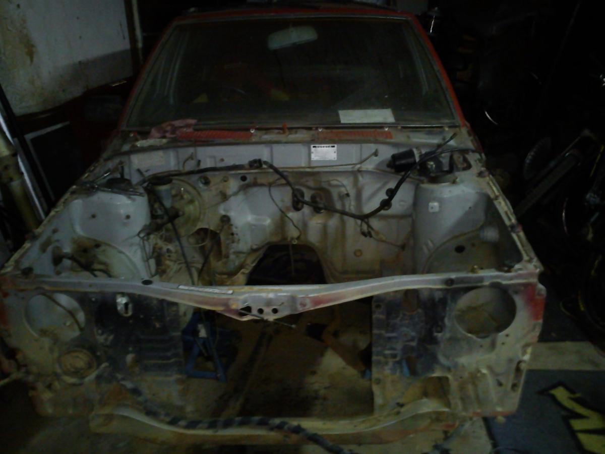

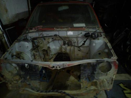

So, it's on like Donkey Kong! Last night was a productive night. Guards are off, cross member and most of the suspension is out and the engine bay is nearly stripped. Being a Khana car there is dirt everywhere and a bit of rust around the place that has always bugged me. The intention is to scrub it all, paint bits that need painting before putting in the 4AGE. I also took a bit of time to start familiarising myself with the KE70 wiring loom so that I can do a tidy install when the 4AGE goes in.
After the frenzy, this is what I'm left with:
Pedal box is also done, just needs assembly.

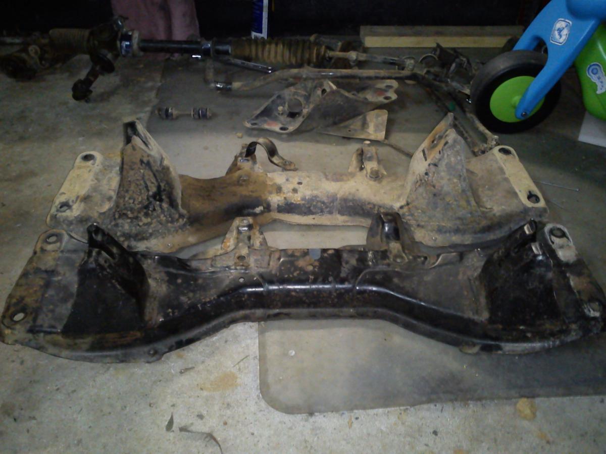

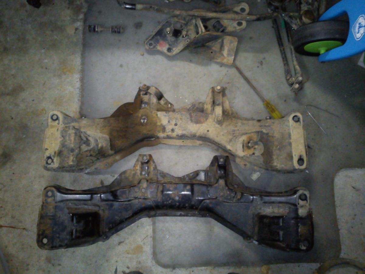

And just 'cause I could never find it when I searched, some pictures of the cross member, narrow mounts are for K motor, wide for A motor.

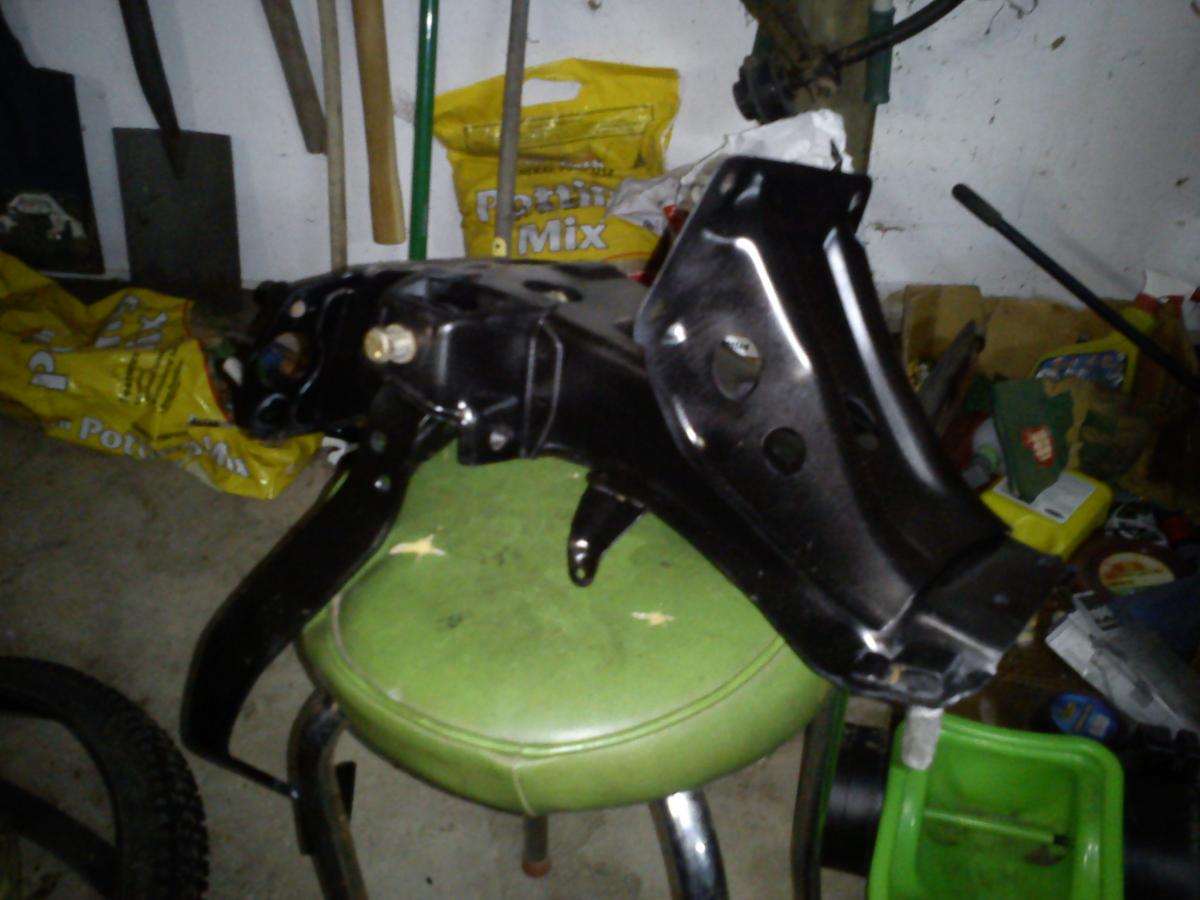

Pedal box is reassembled and installed. Clutch slave is in and some of the dash is back in. I'm still trying to remember where everything goes, but it seems simple enough.
