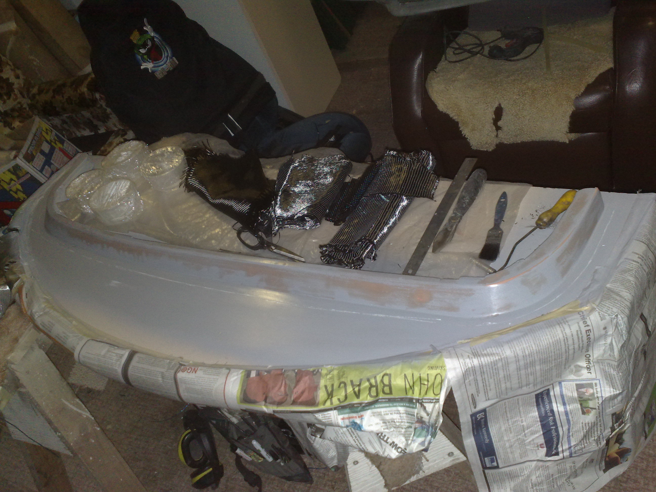

While I was still lucky enough to have been working with carbon fibre I had also knocked up a mould for the hatch spoiler (no photos atm).
The plug for & the actual front bumper lip to replace the cut-down Cressida plastic item.

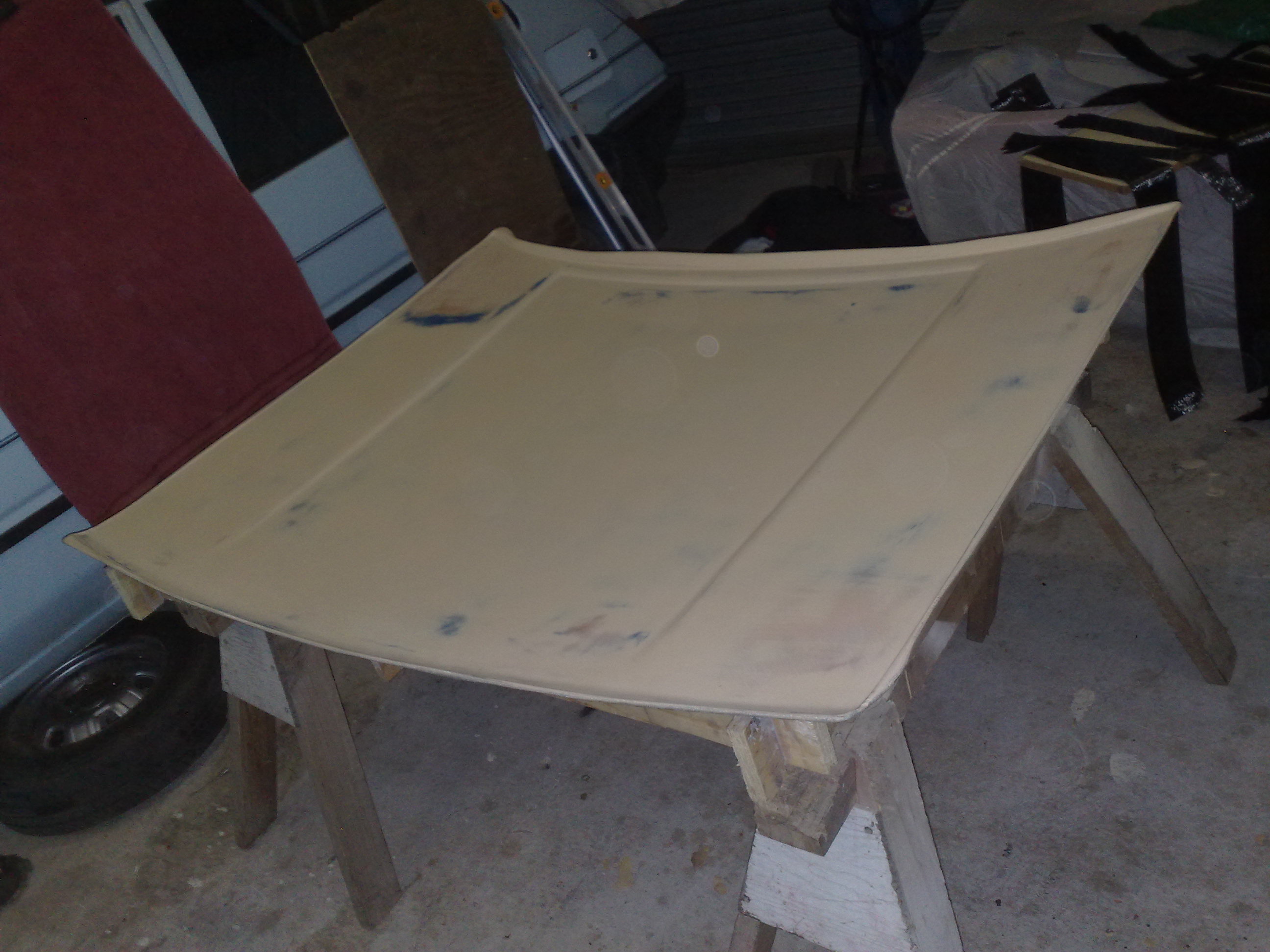

Mould for bonnet

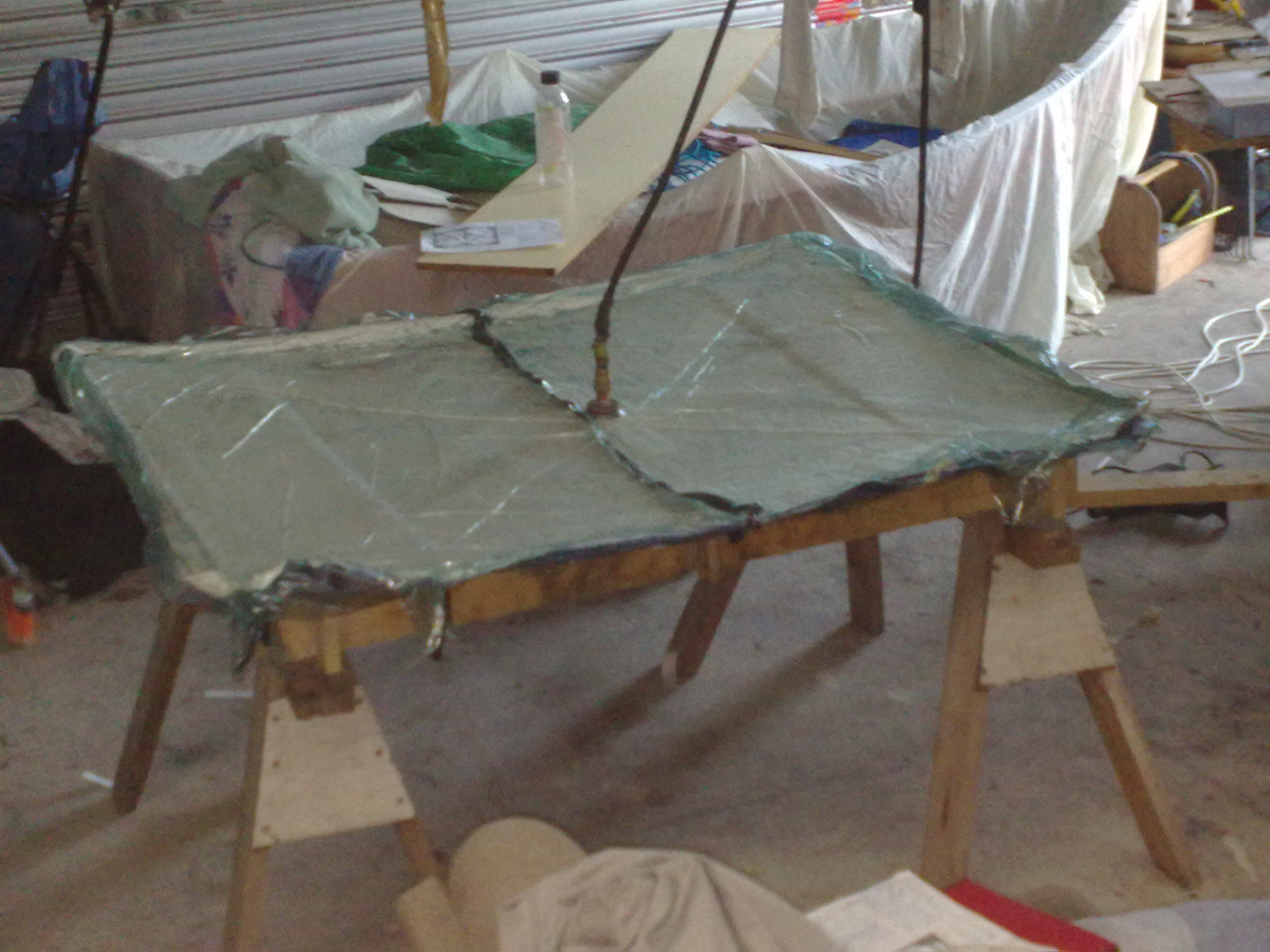

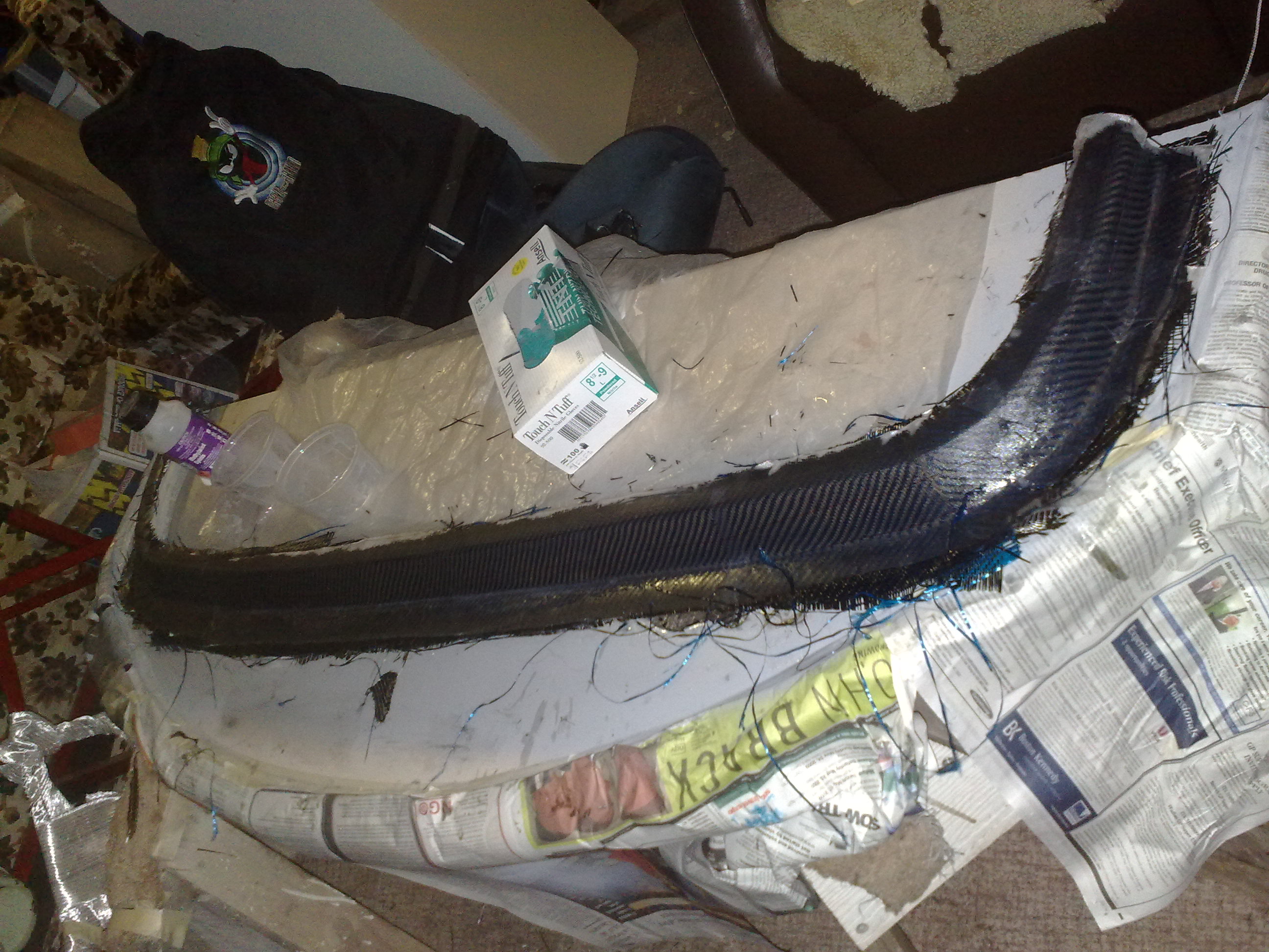

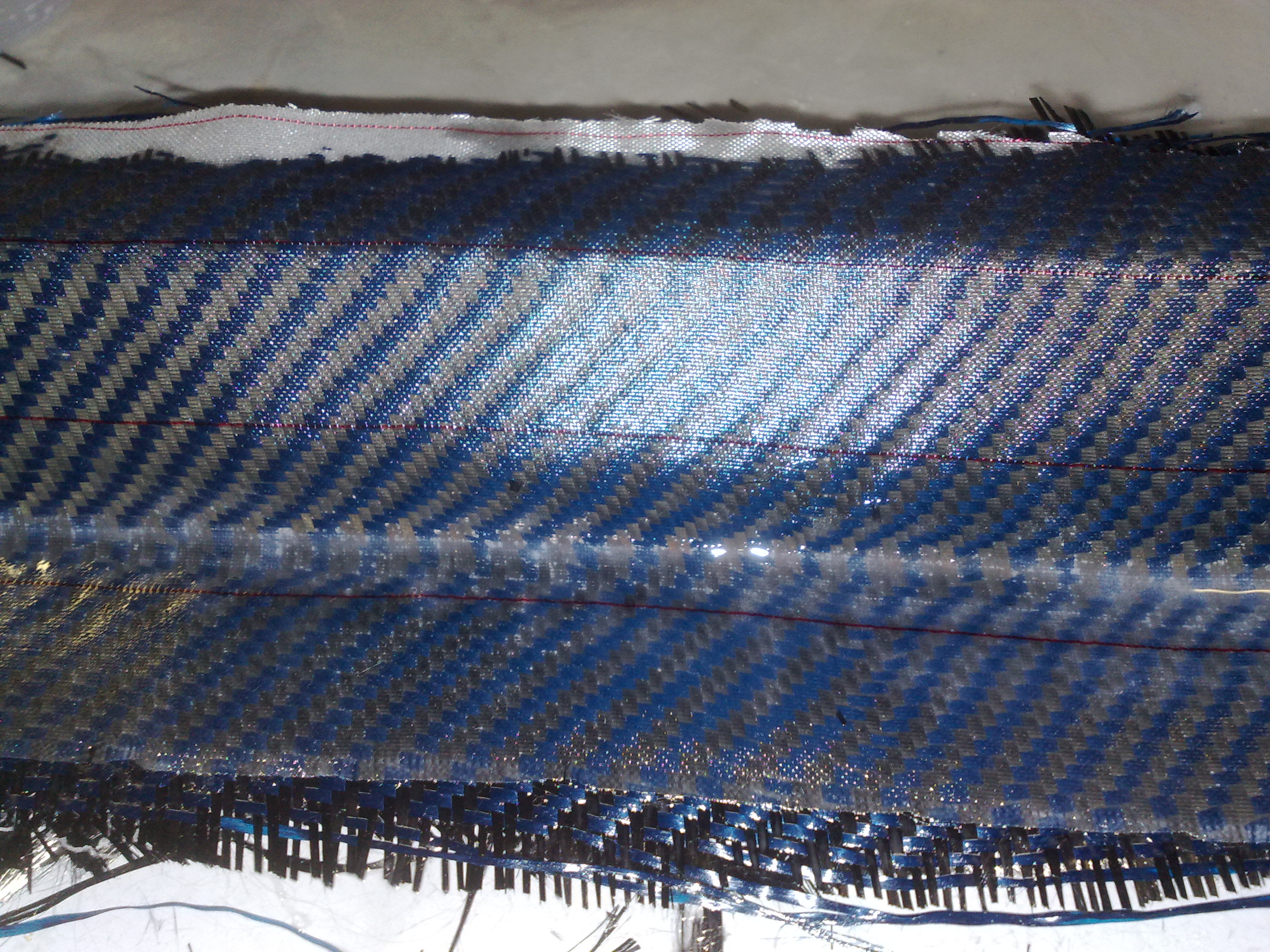

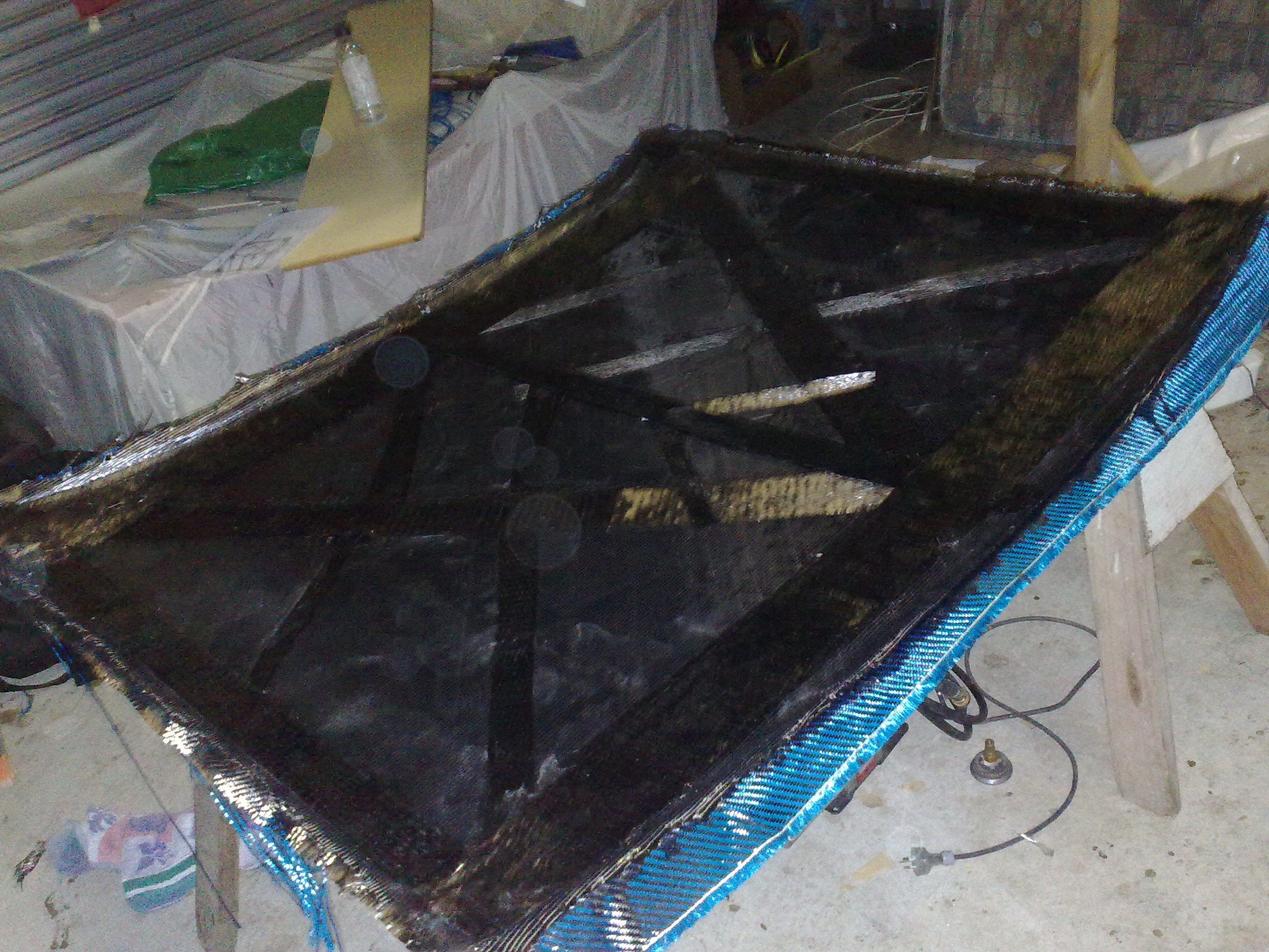

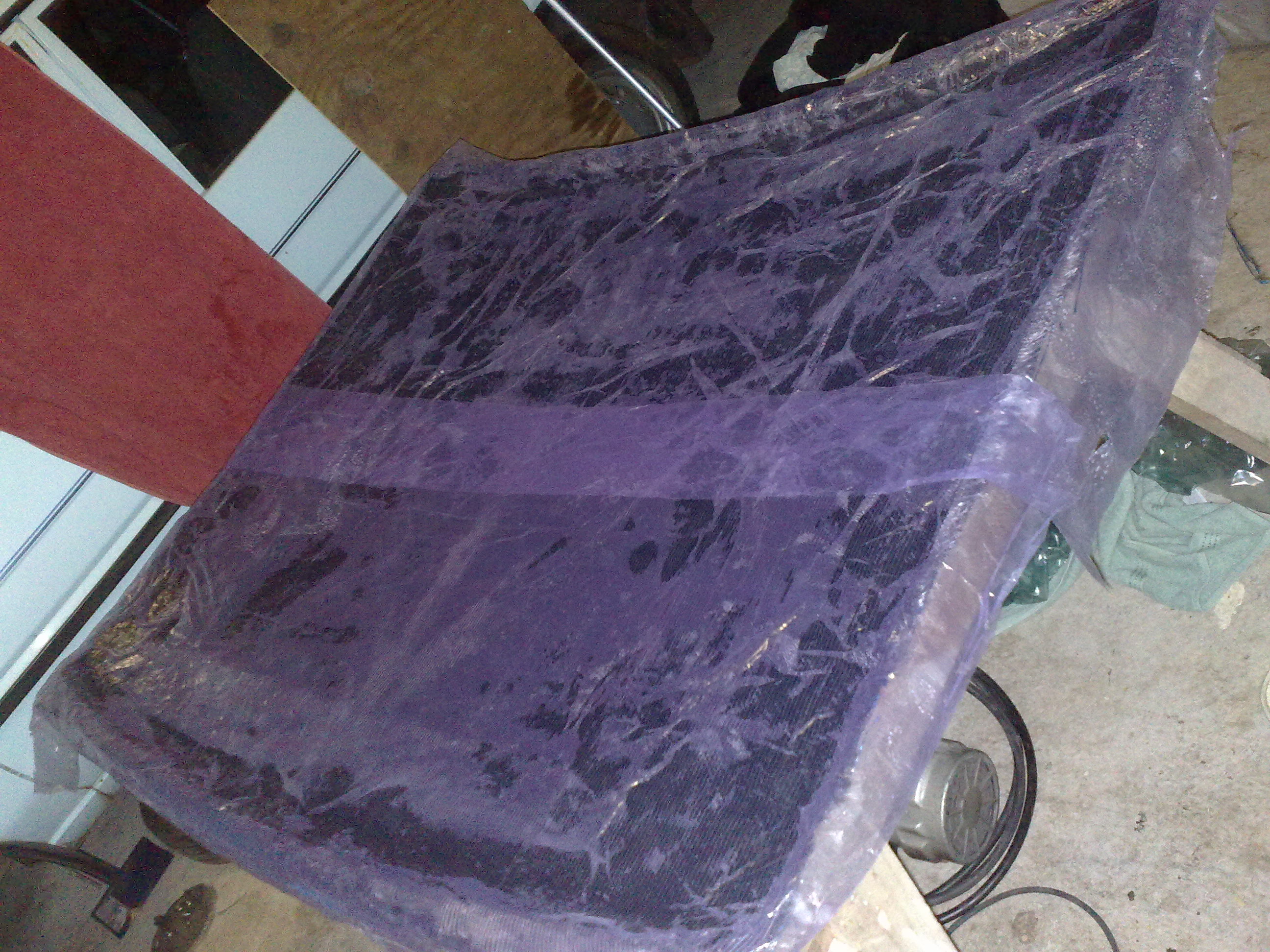

Laminate layup, good fun on a warm evening as I was mixing the epoxy resin in buckets so had to seal the tops & store them in the fridge between layers to stop the stuff exotherming on me. Making a tool that was capable of the high temperature cure cycles of pre-preg material was financially painful so I went with a wet-layup method using a vacuum pump to ensure as void-free a laminate as possible. The normal skeleton thats under the bonnet panel was incorporated into the laminate design, not sure how it would go pedestrian crash safety-wise but I don't drive on the footpath so not relevant :wink:

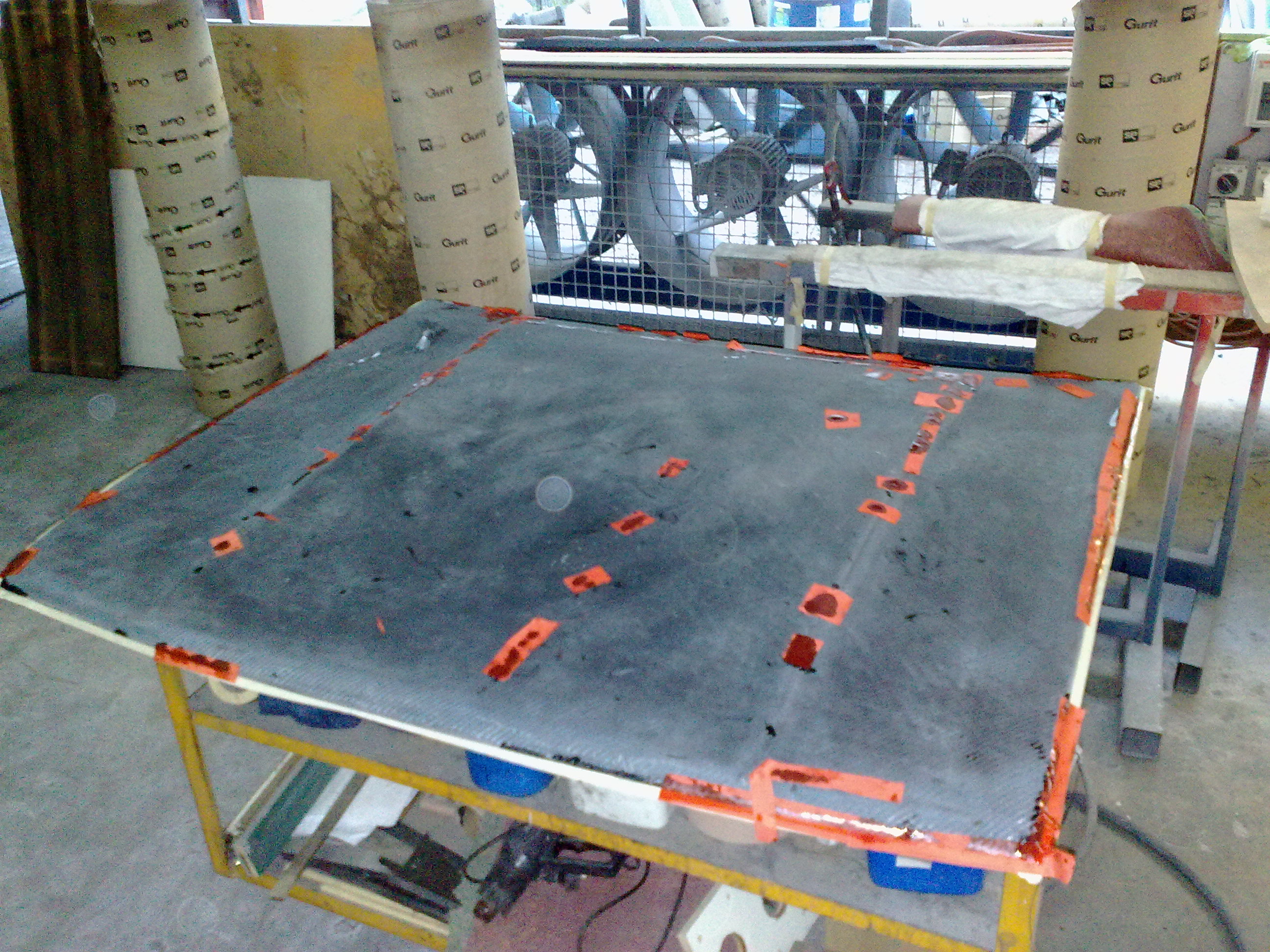

A bit sticky coming out of the tool but that was prob due to me not preparing the small repairs I'd had to do on the tool properly.

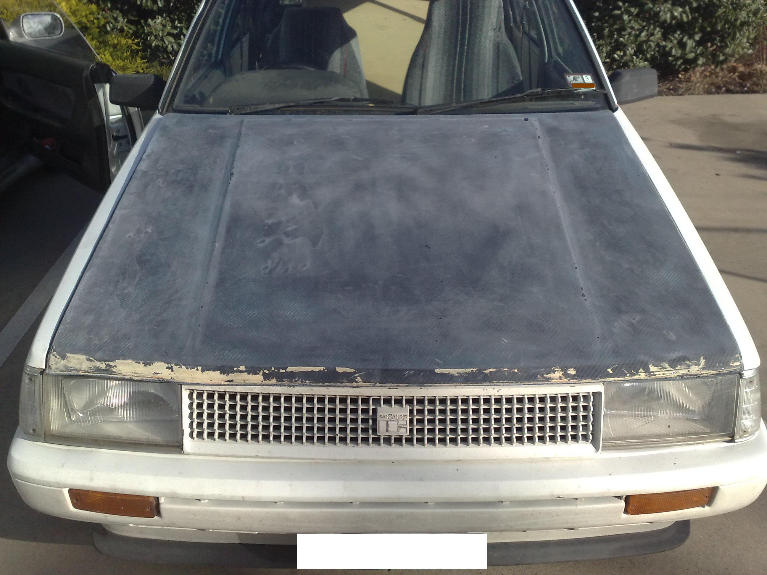

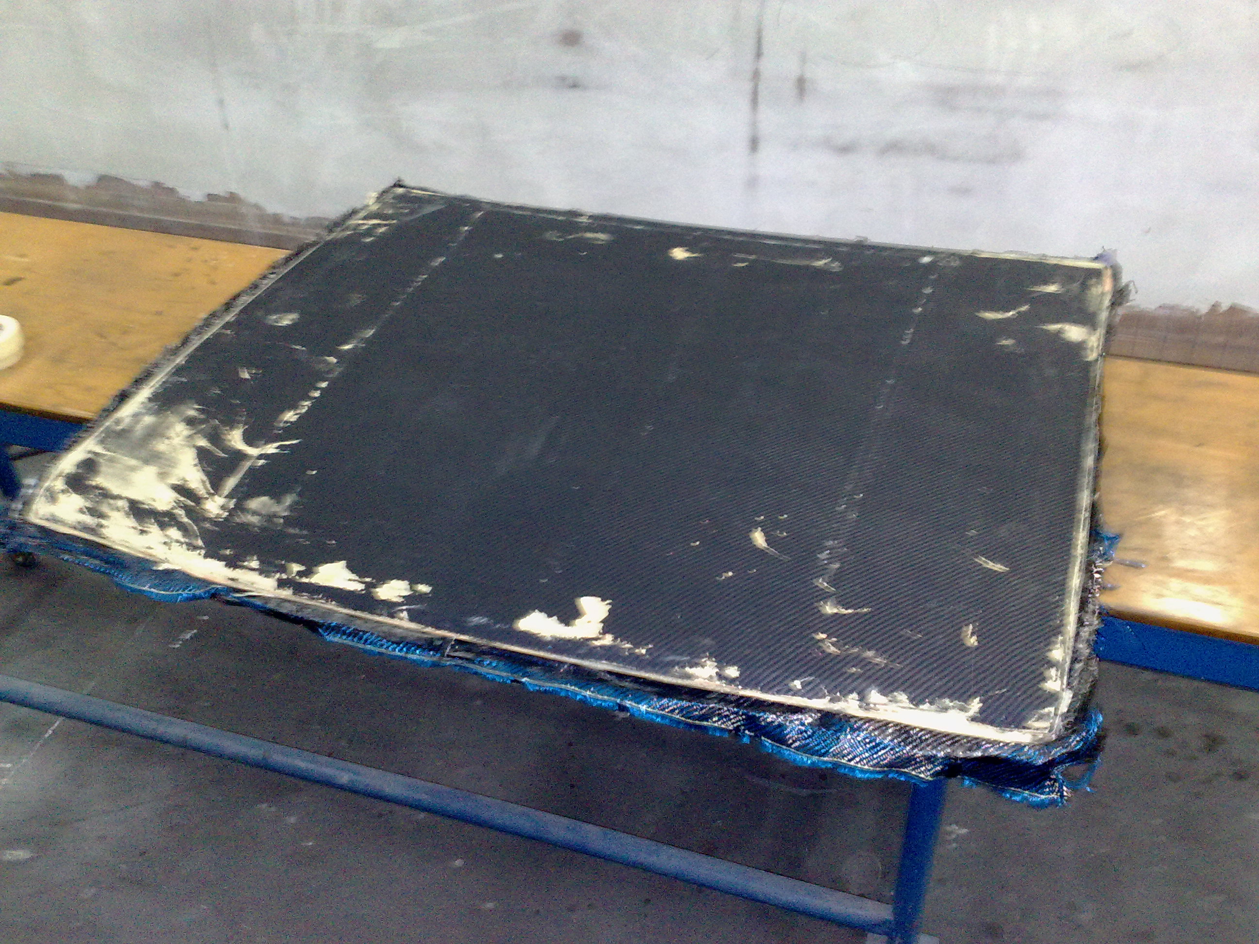

Test fitment on car, came out nicely! Original bonnet weighs 14.5kgs....this little baby tips the scales at 4.5kgs so after final fitout & paint a touch over 5kgs is the target.

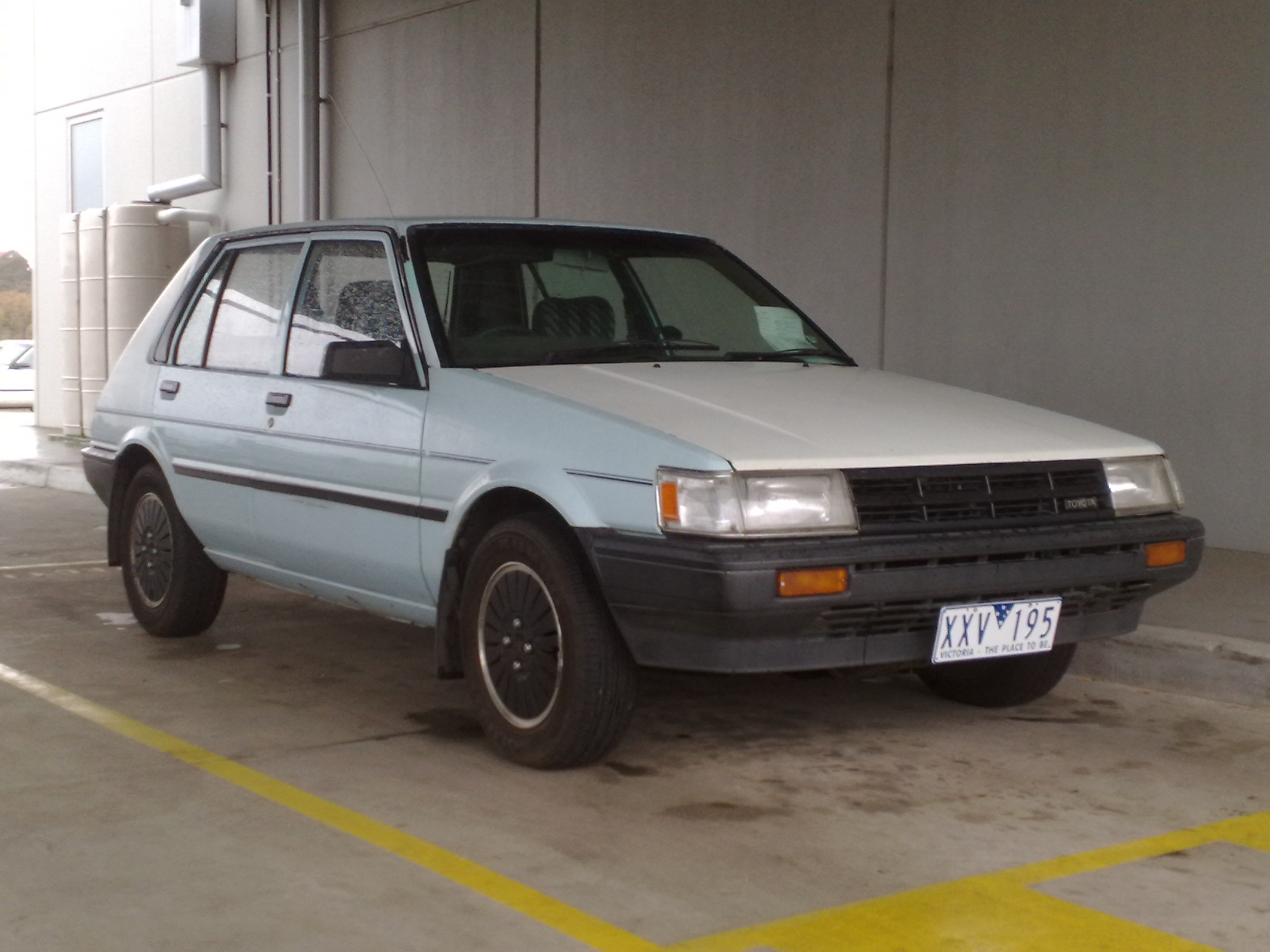

*Looks at Sudi* Hmmm, quite a bit of rust in all the usual spots plus the panel/chassis damage...
*Looks at Parts* This car must've been garaged, bugger all rust & things are pretty darn straight...
*Looks at Sudi* Mechanicals are all new/less than 20,000kms old...
*Looks at Parts* It could do with a new paint job...

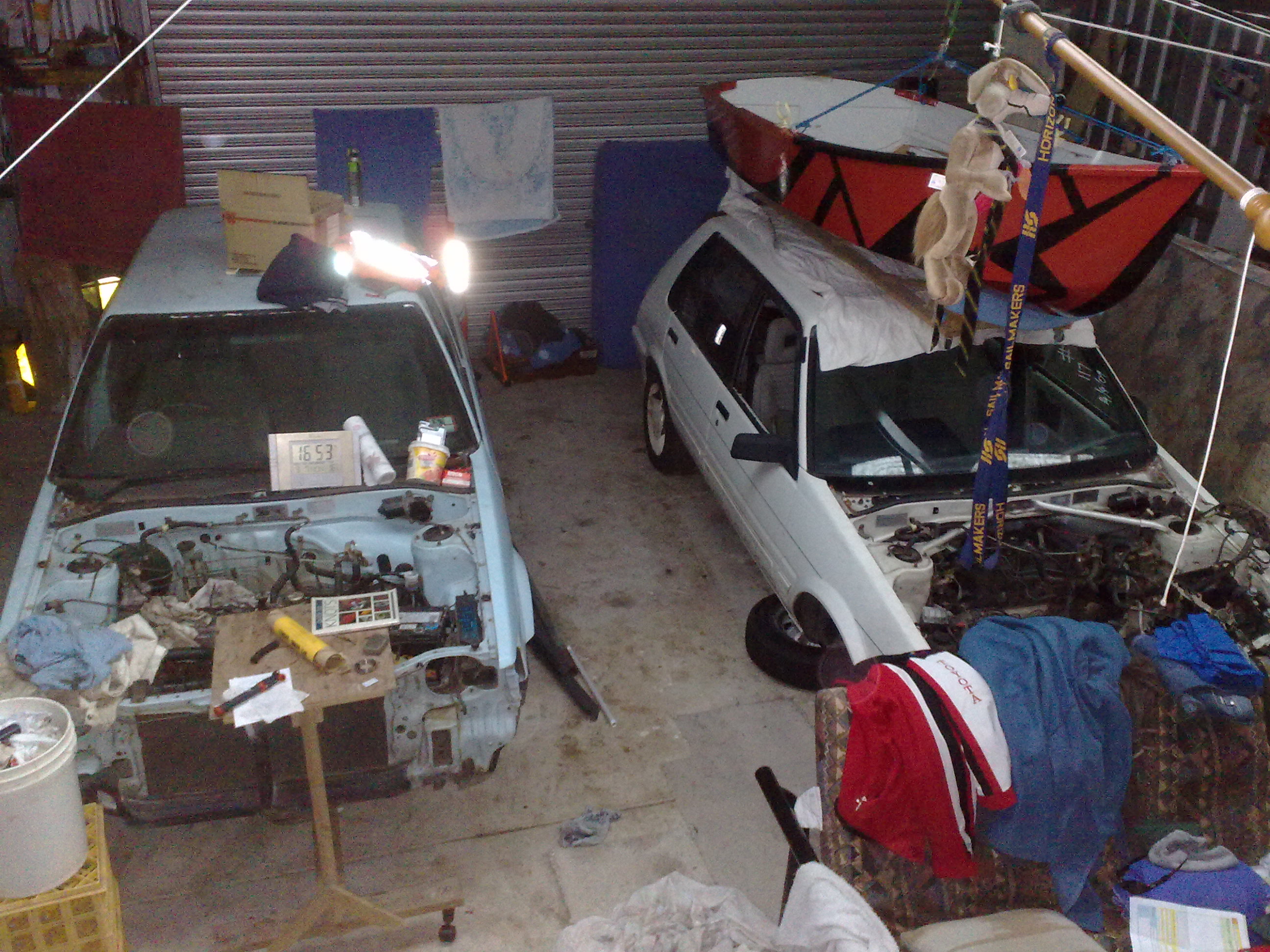

So the plan was born, strip Parts of every nut, bolt, clip & pin, get rid of rust, respray, install mechanicals & basically have a brand new AE82. Closest thing to a new car I'll have owned :laff: A 4AGTE/4AGZE upgrade was contemplated but having just started the first year of a apprenticeship at this stage it was a dream that'd have to wait.

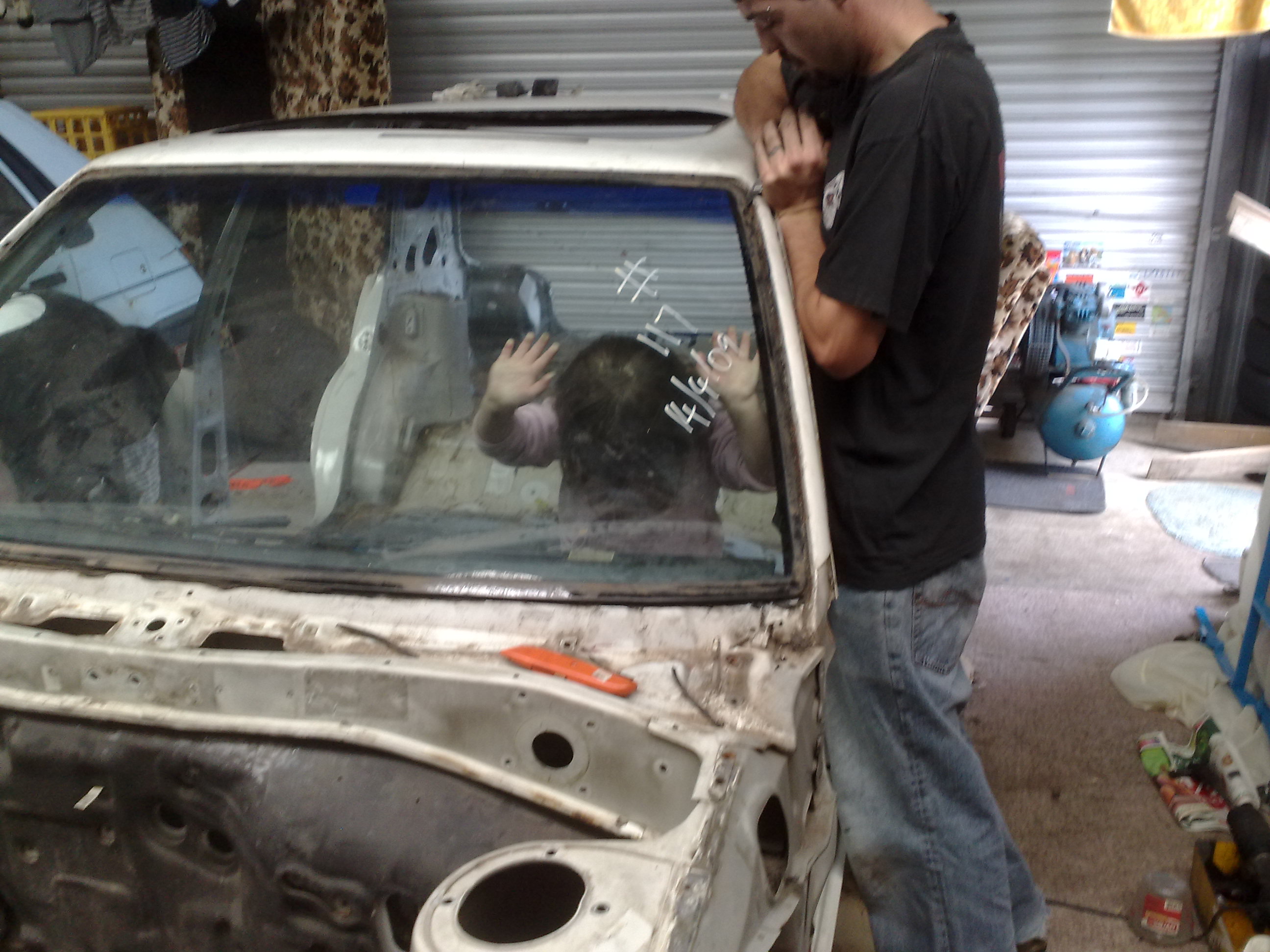

Yes this is a 3yr old girl helping us yank out the windshield, we start 'em on Rollas young around here :P (especially when the father's trying to get her to be a new Ford Mustang fan *shudder*)

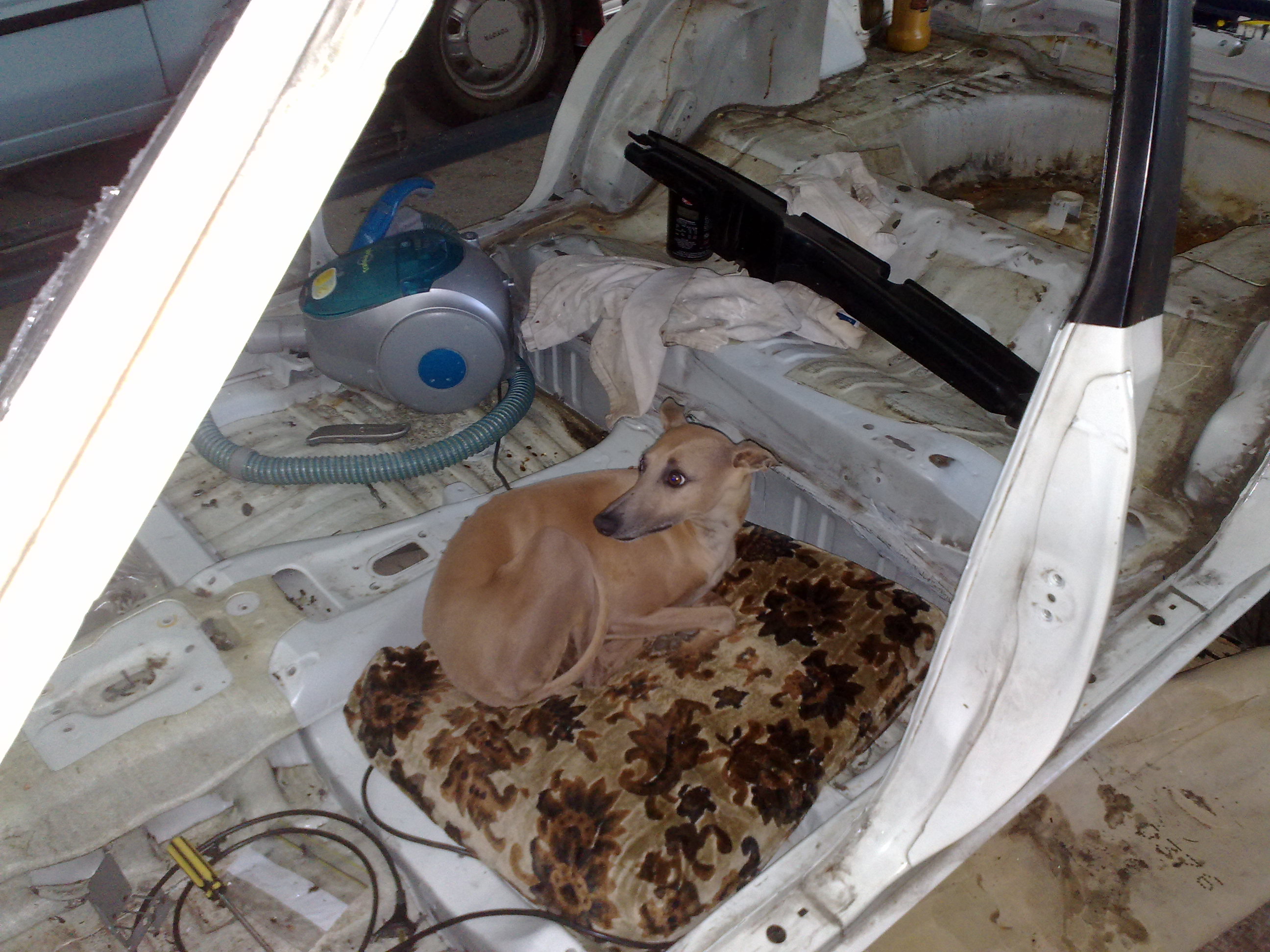

Apparently its no longer my project but my dogs kennel...

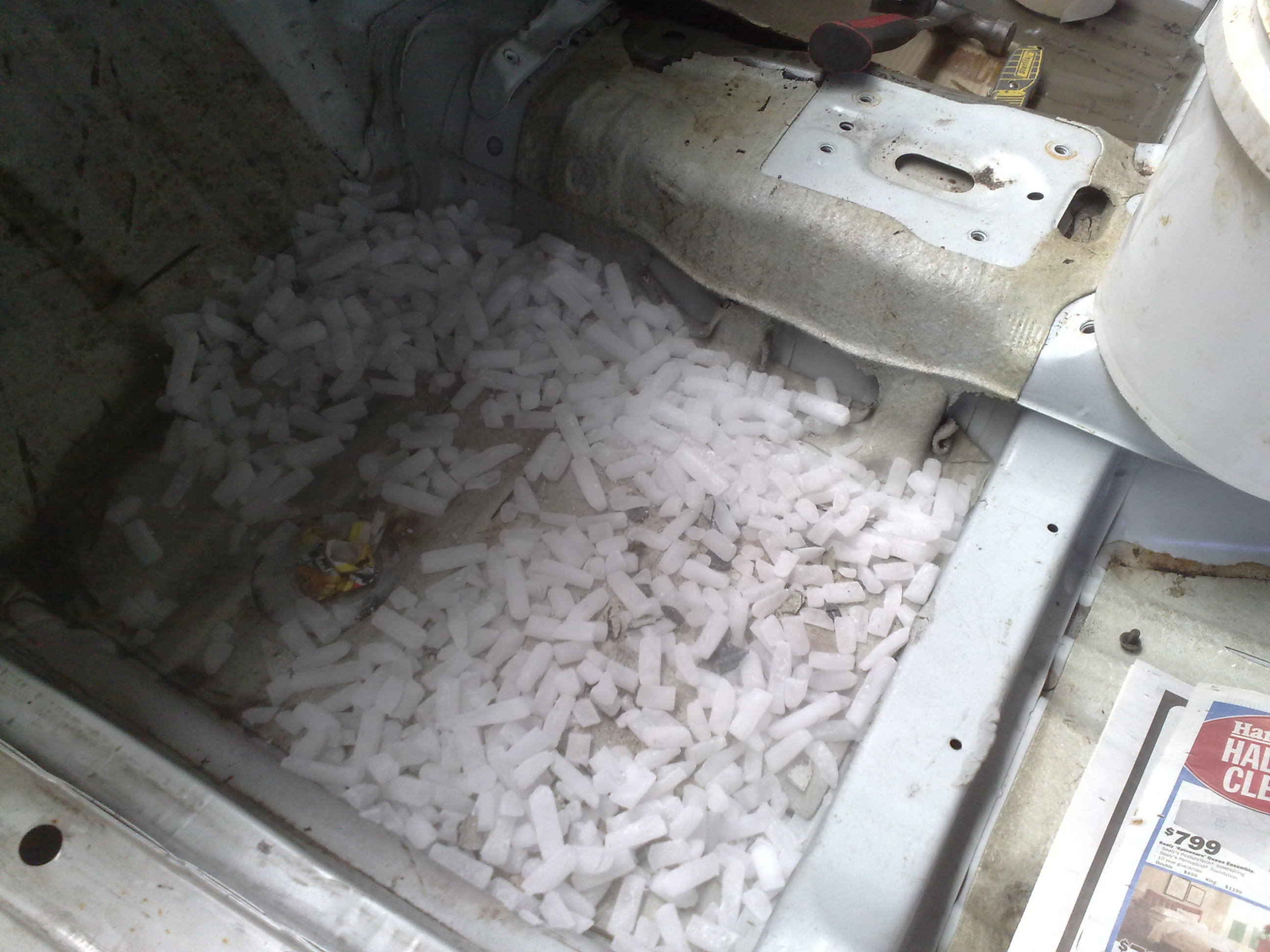

If you don't like sound deadener as much as I don't, dry ice is the bomb!!

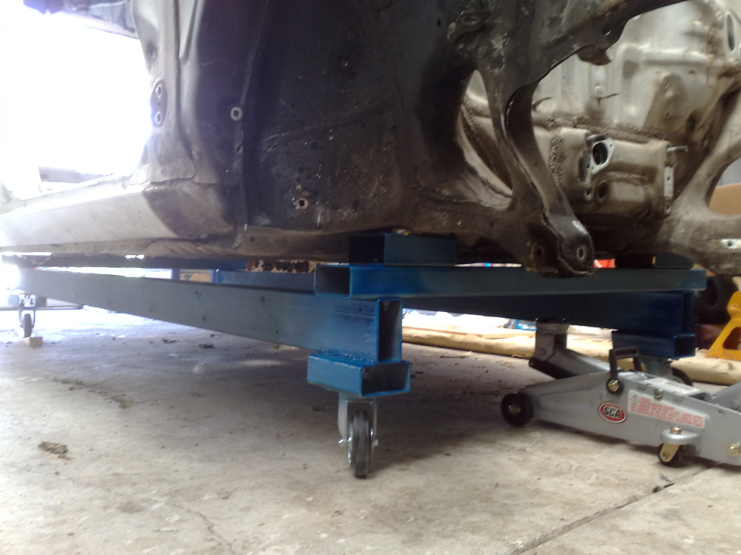

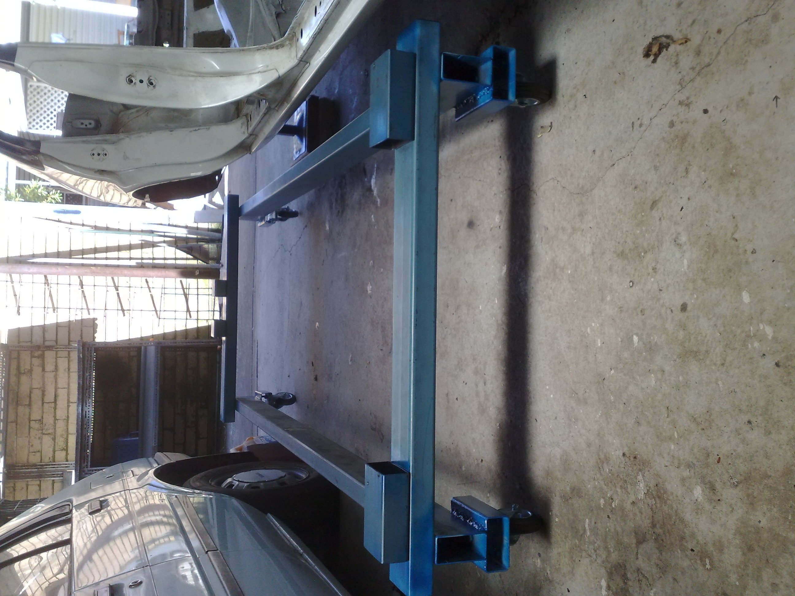

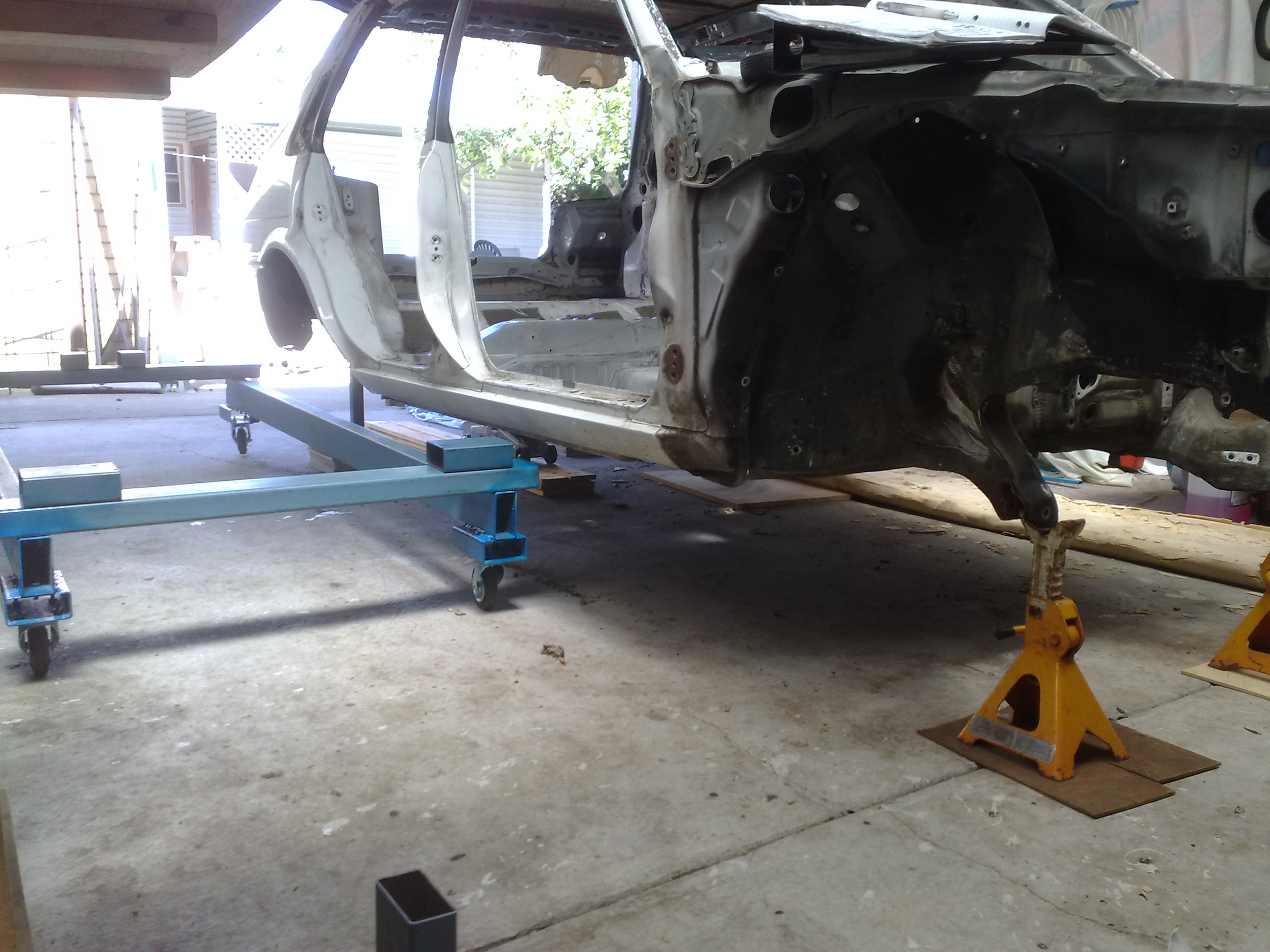

I figured I'd need/like a way to be able to move the chassis around at any given point so I knocked up a buggy for it to sit on. For about $200 inc beers after construction it has been well worth it, gives me enough height to be able to crawl underneath too.

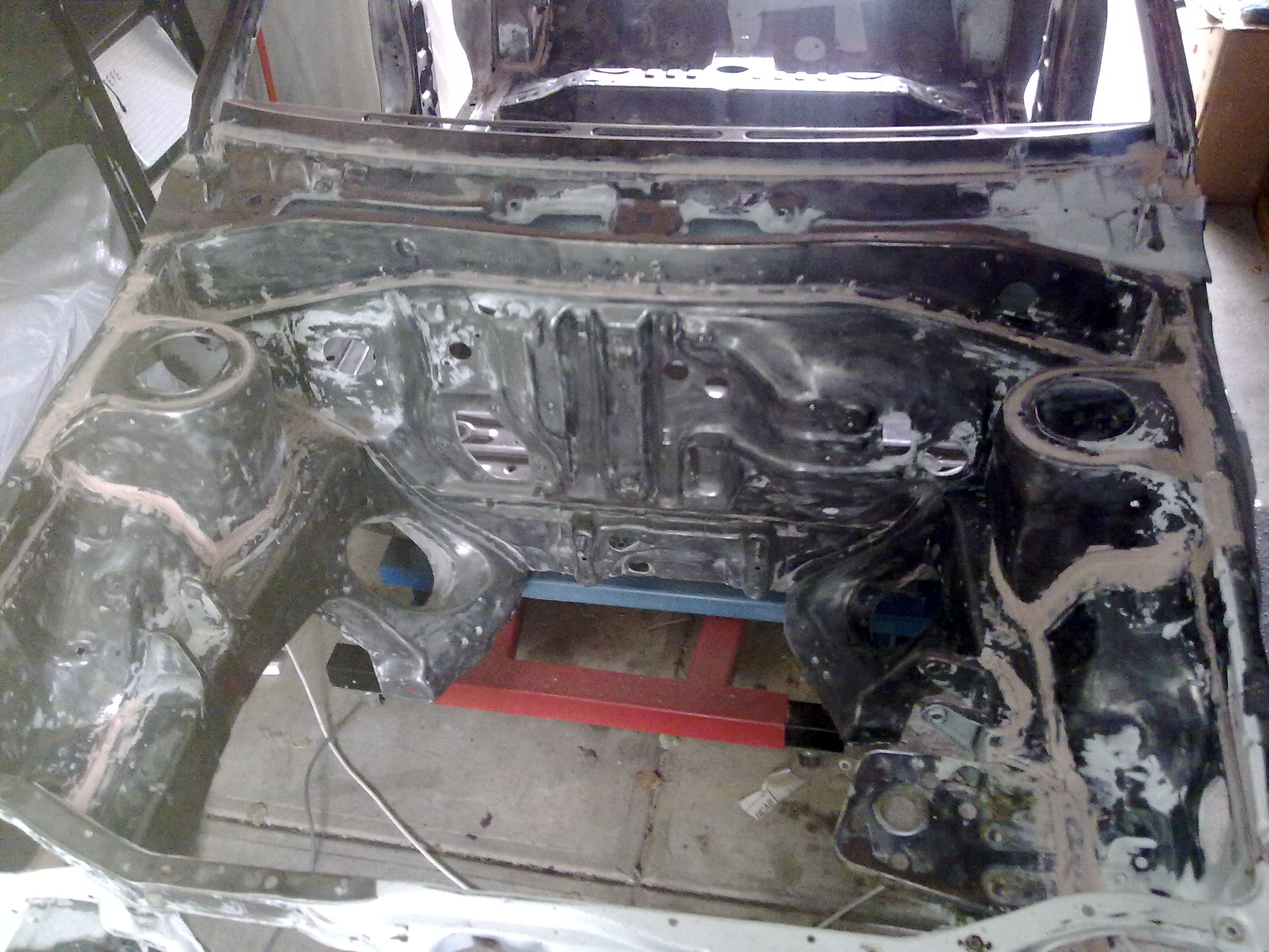

Rightio...now that the sound deadener was gone it was time to start playing with some serious chemicals :dance: Here's a tip though: if your car does not require going back to bare metal, don't do it! You're merely vastly increasing the amount of work required :blush:
I'm the pedantic type, anything that was 20+ years old had to go. That meant any spray putty, body filler, paint, primer etc that was present was about to meet a methanol bath following by a pounding with various grades/shapes/sizes of wire wheels on both grinder & power drill.

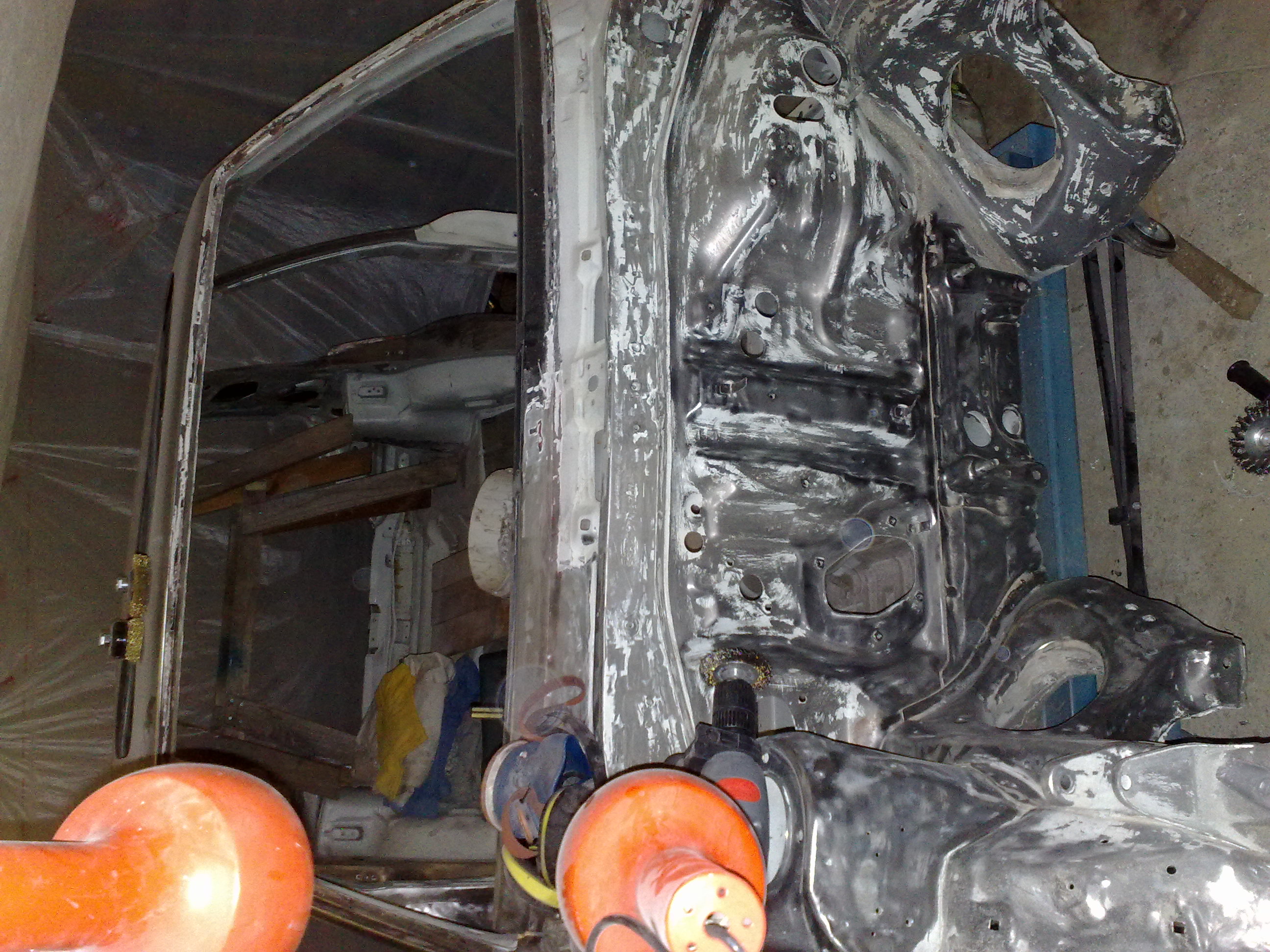

My attempts to contain the dust from grinding...epic fail LOL

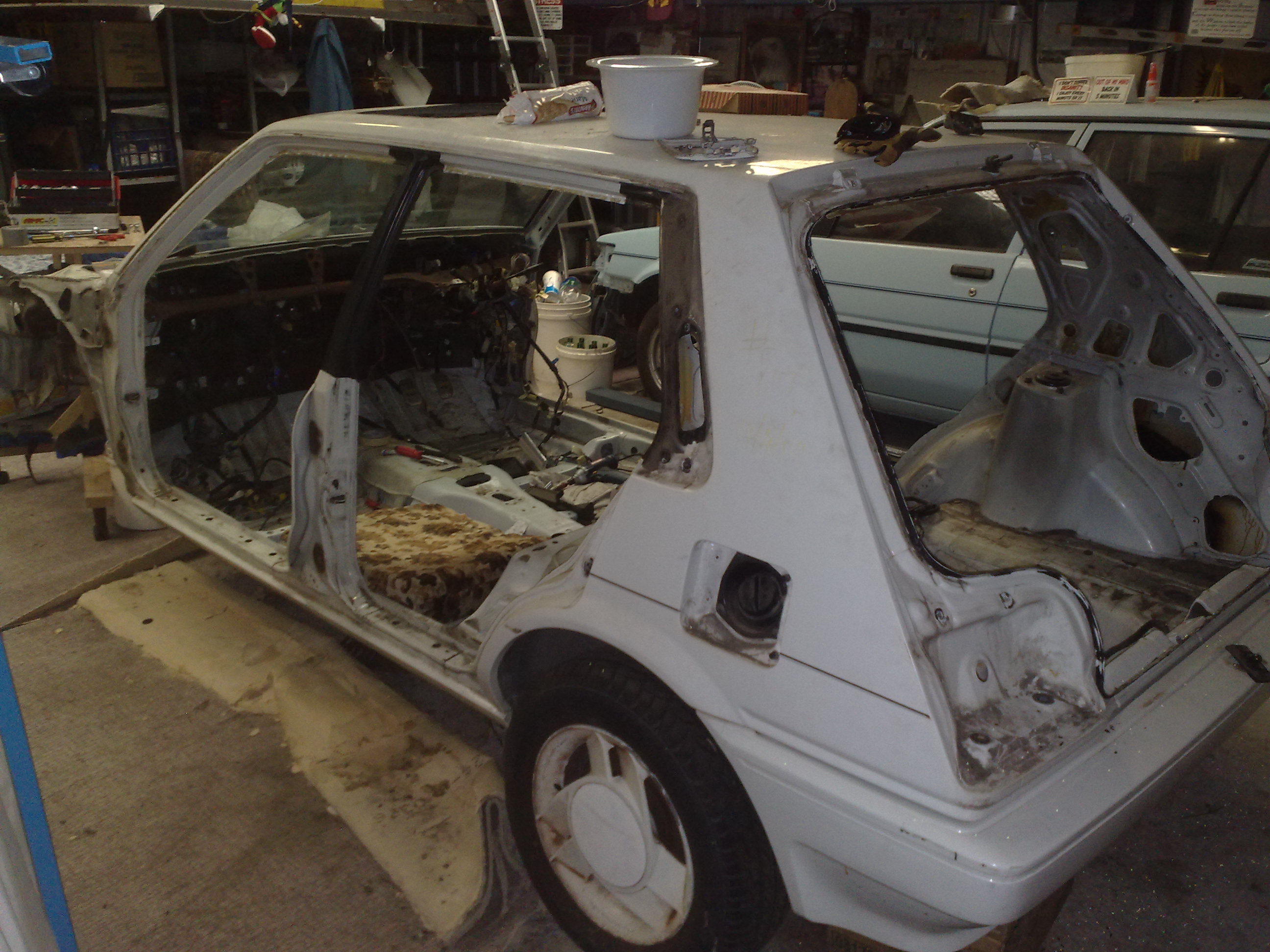

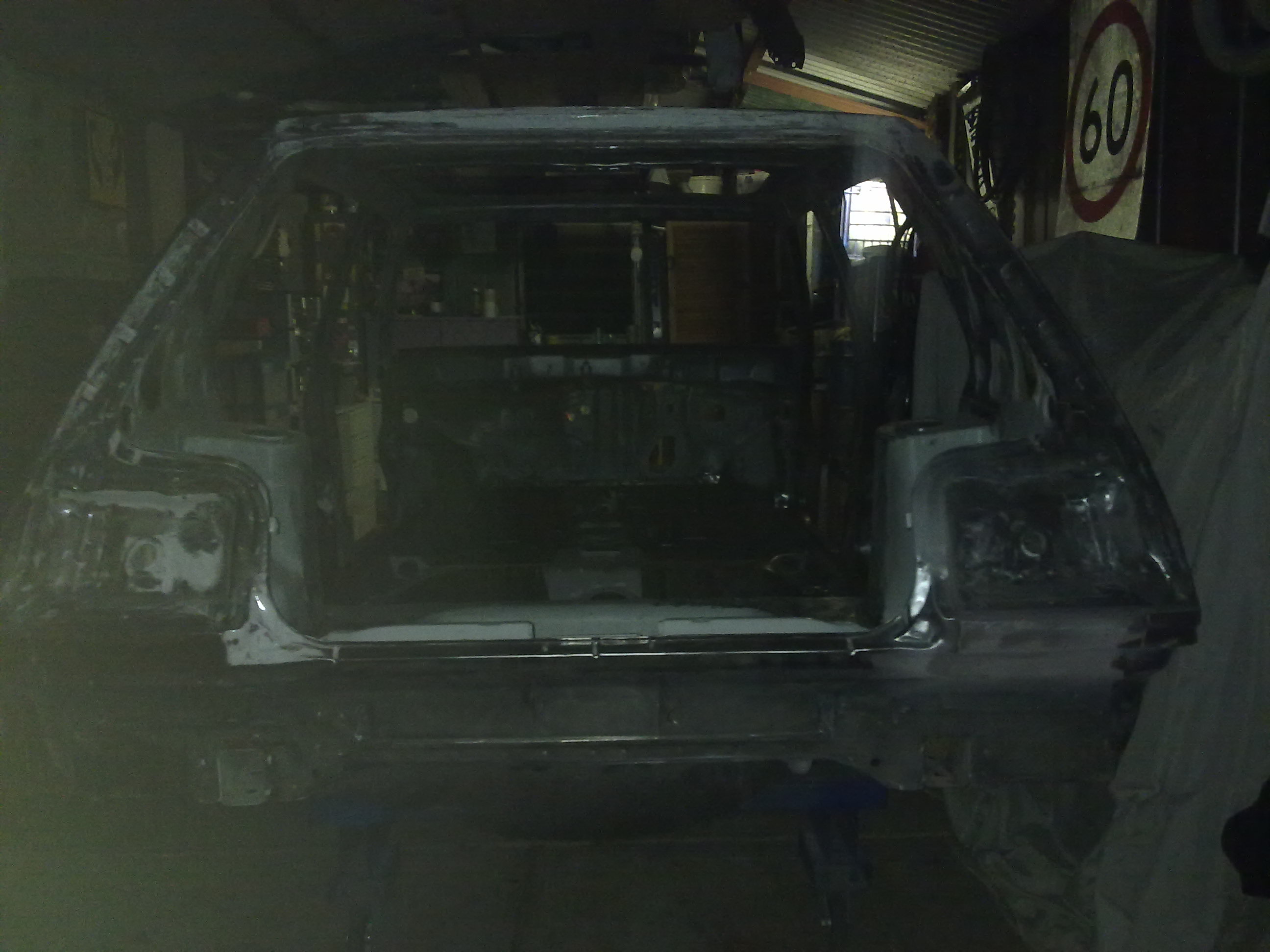

Rear end all naked

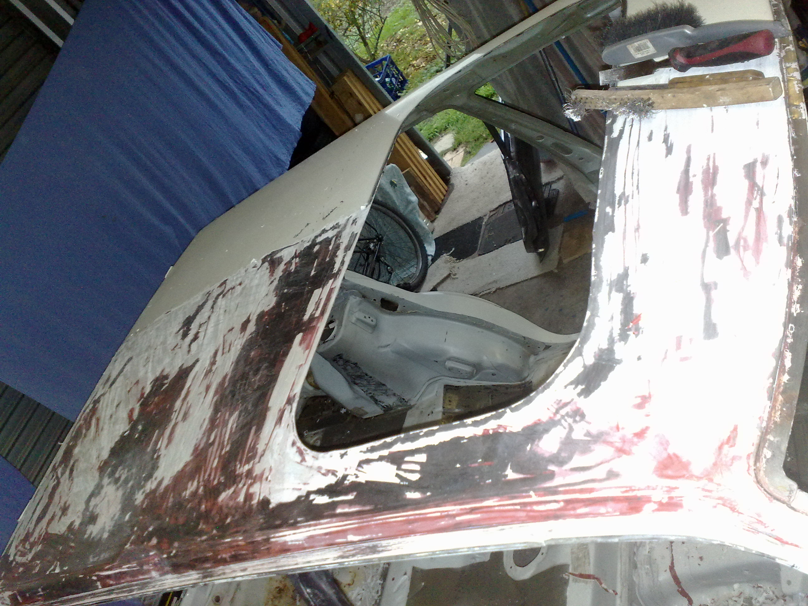

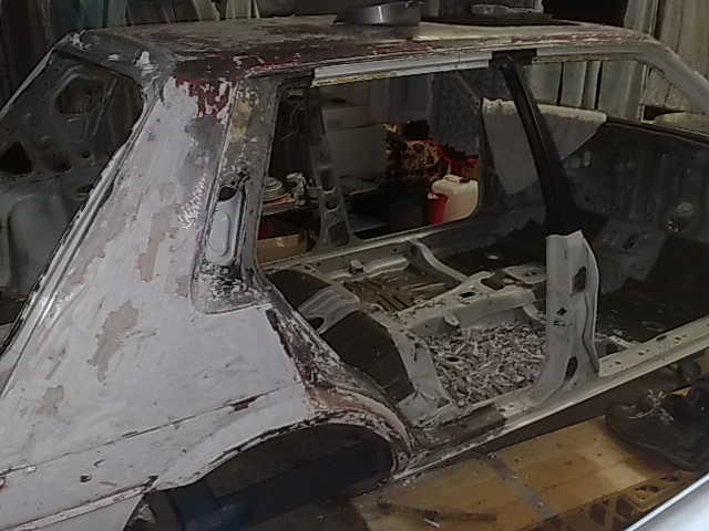

Chugging through the roof section
And down the C pillar...

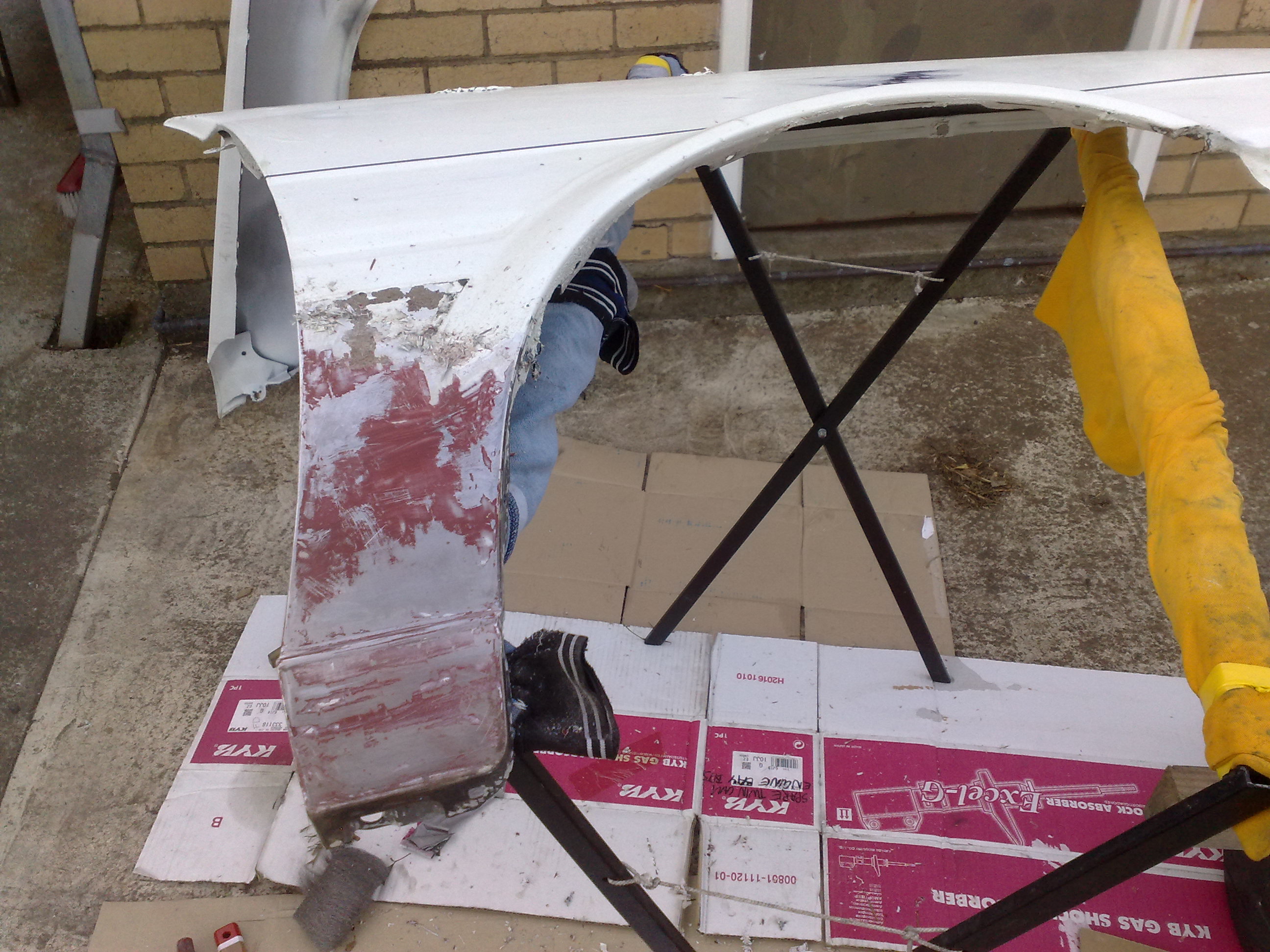

Guards...(took some time out to knock up a pair of panel stands for myself, fold up when I don't need 'em too)

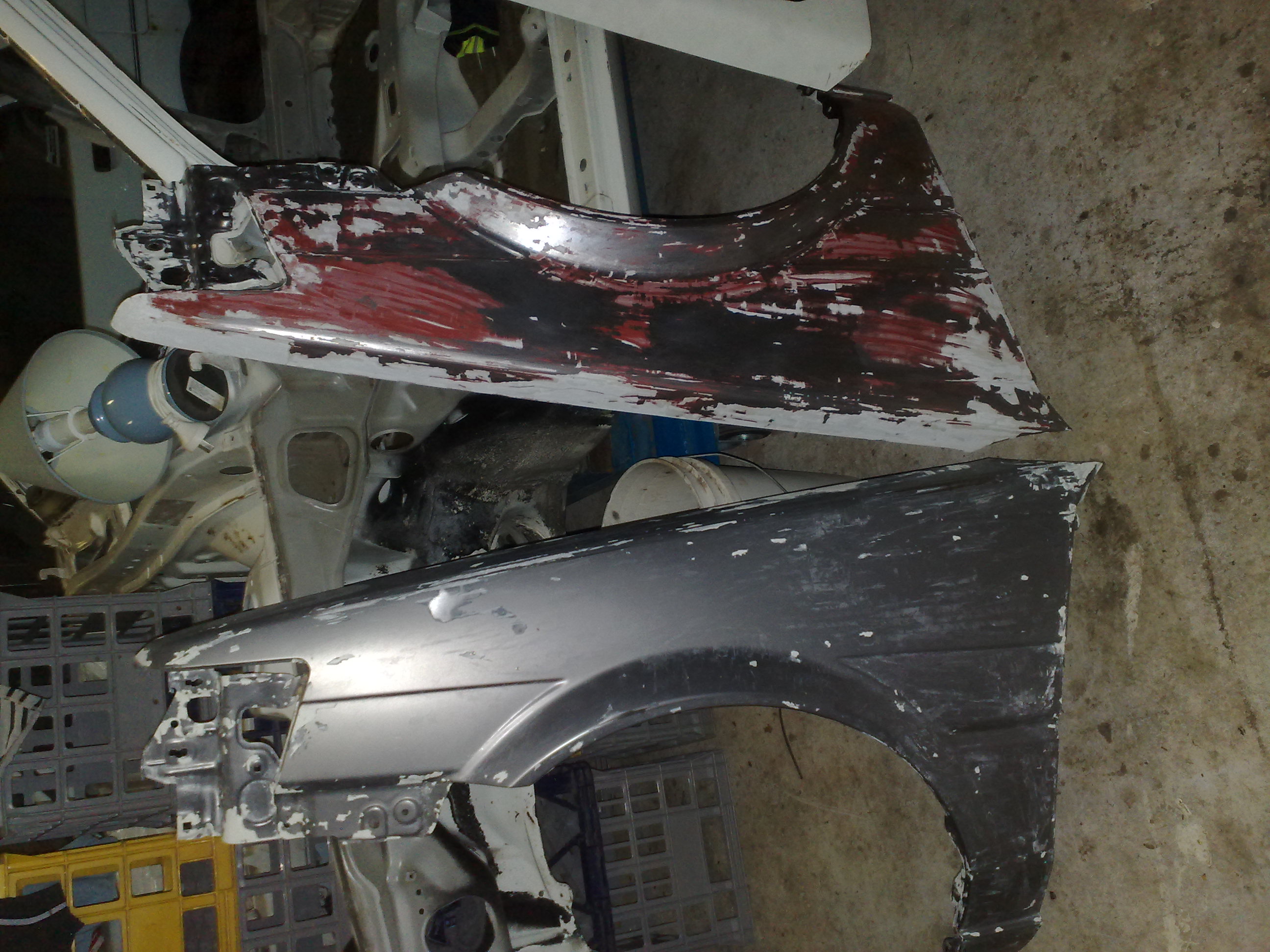

More guards

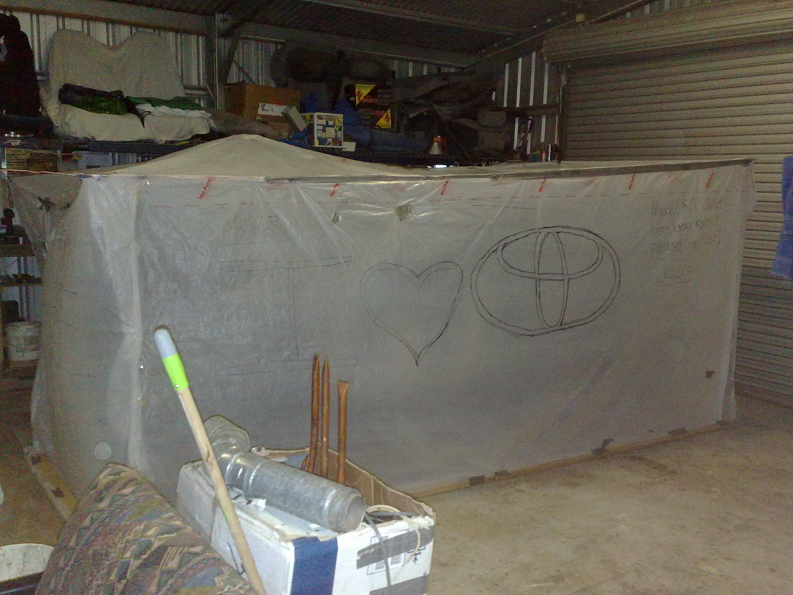

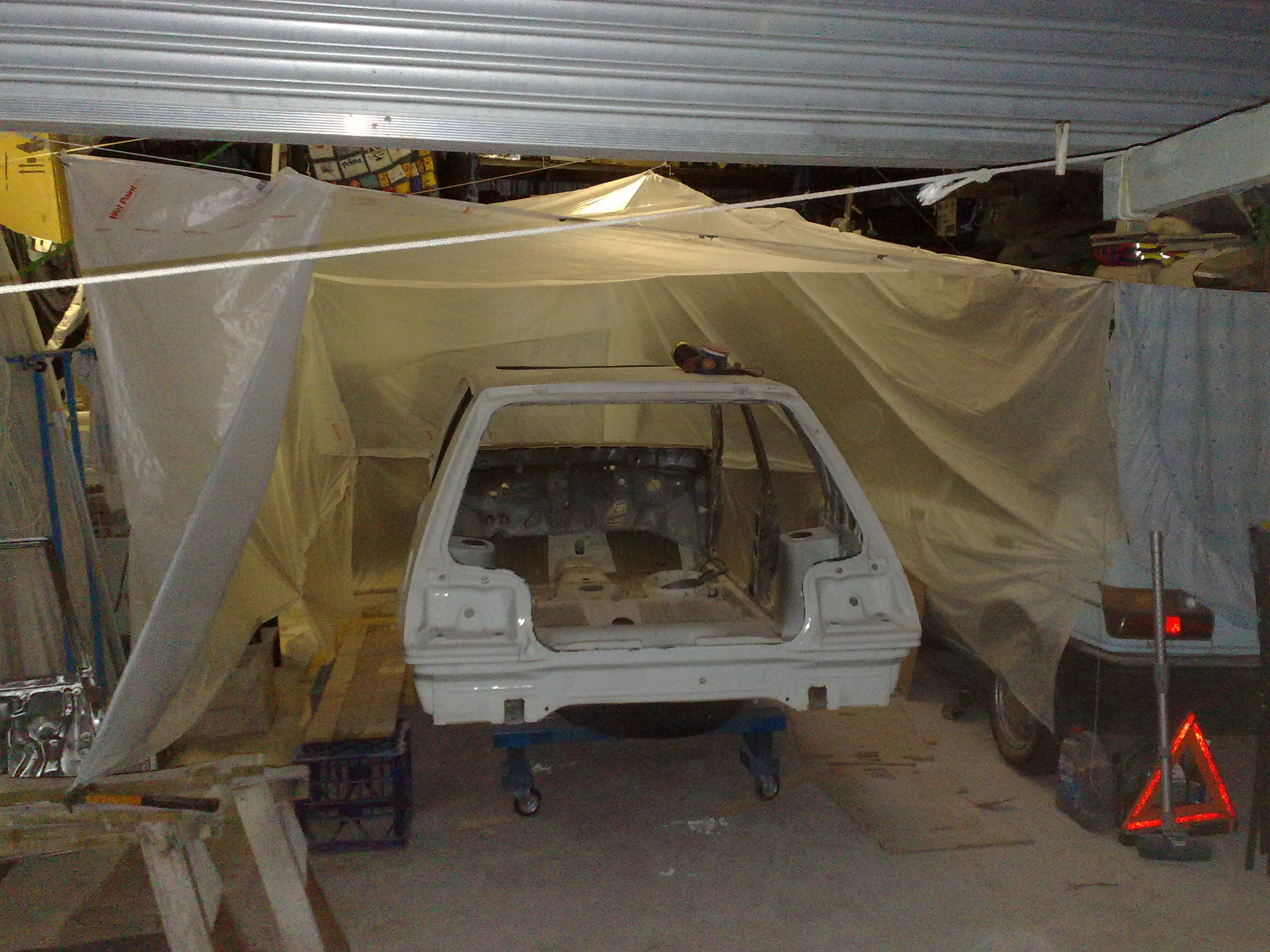

New upgraded grinding booth as Blue Thing finally dragged out of the shed, was fixed up & made to run. Then some idiot gave it a RWC & rego so it could be my new daily hack! Considering I'd just spent 5 months riding a pushbike (registered Twin Cam needed new fuel pump, new rear tyres plus more to get RWC, was a 1st year apprentice at this stage so $$$ were bloody hard to come by. The old Blue Thing was cheaper to fix) 45min (was 60min but nailed it down as I got fitter) to work @ 7am 5 days a week (through a Melbourne winter I might add!) this was extremely welcome, I had thighs of steel but having a heater for those cold mornings is bliss!

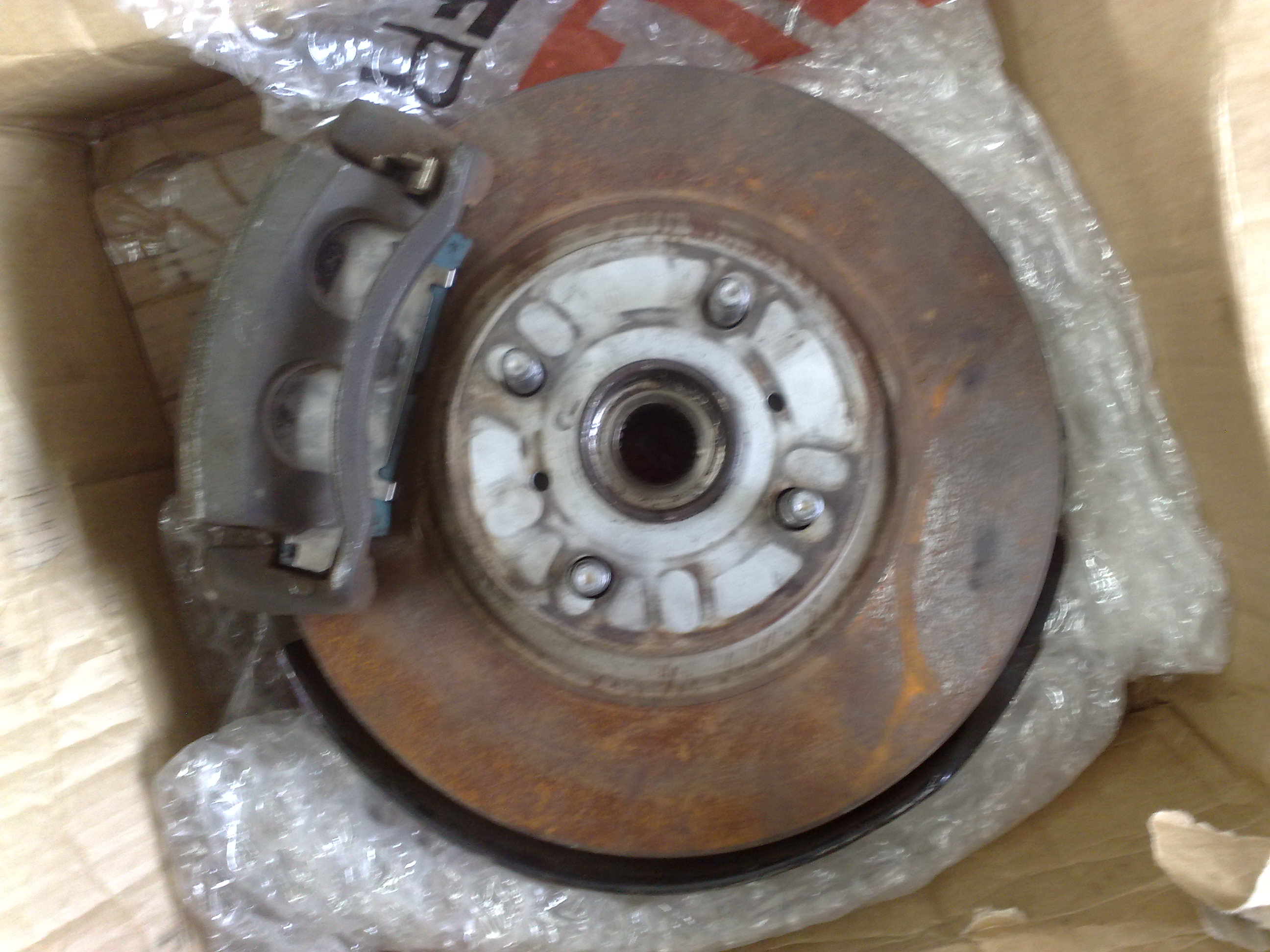

Not completely neglecting the project build at one point I purchased a set of AE101 JDM front struts complete with hubs & brakes. There's a thread floating around on ToyMods which had caught my attention regarding brake upgrade options for the AE82. The option I chose is probably the pricer & more complicated option but the way I figured it was, once finished I'd have brakes designed for an 1150-ish-kgs car on a sub-900-kgs car :wink:

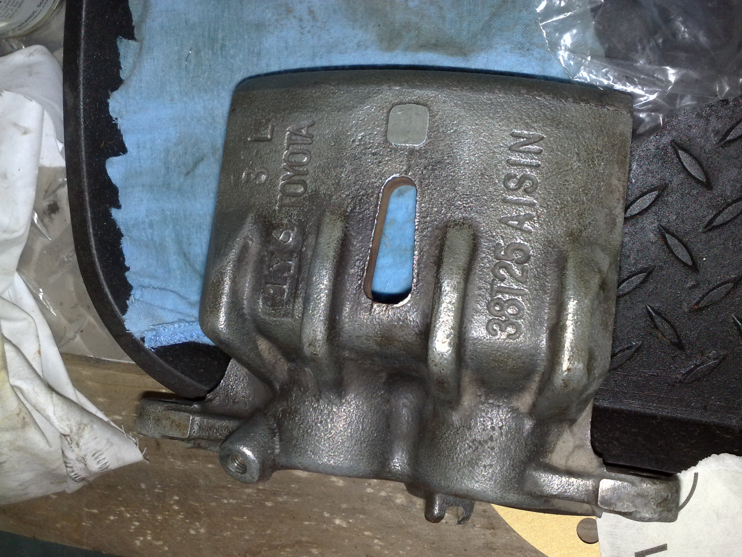

After much mucking around (parts guys really DO give out fake/made-up part numbers, feels good to catch them out by showing up at their shop 15min after getting off the phone) I got ahold of some caliper rebuild kits so set about pulling them apart & painting them before putting them back together.

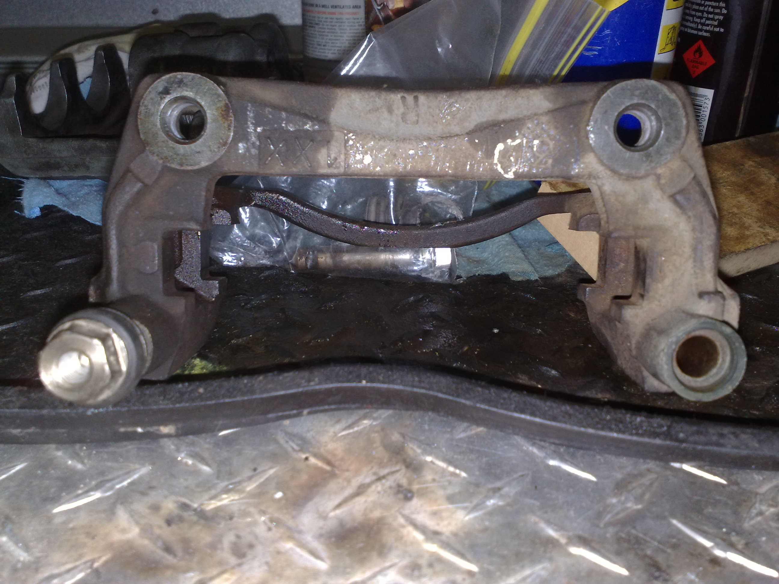

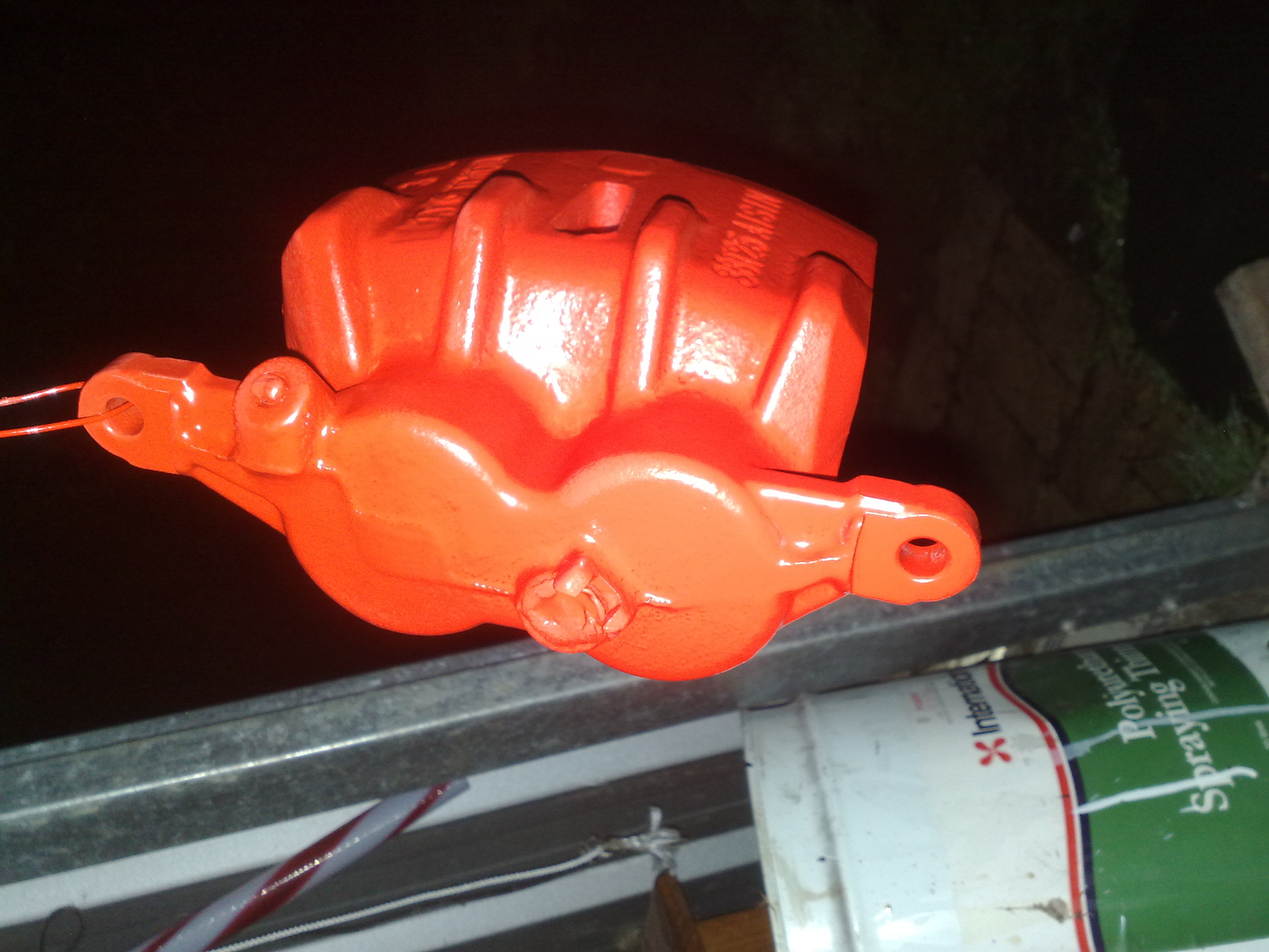

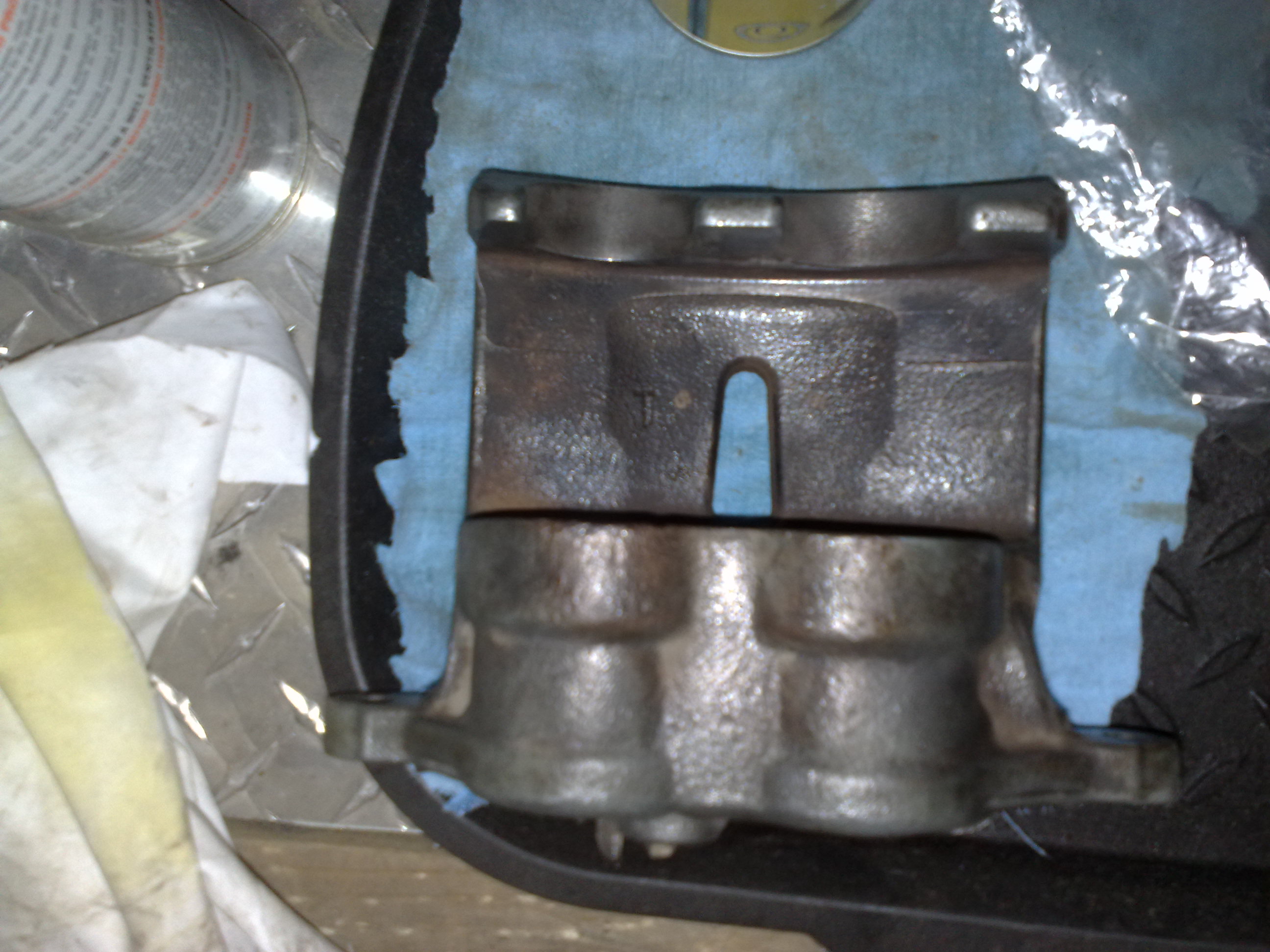

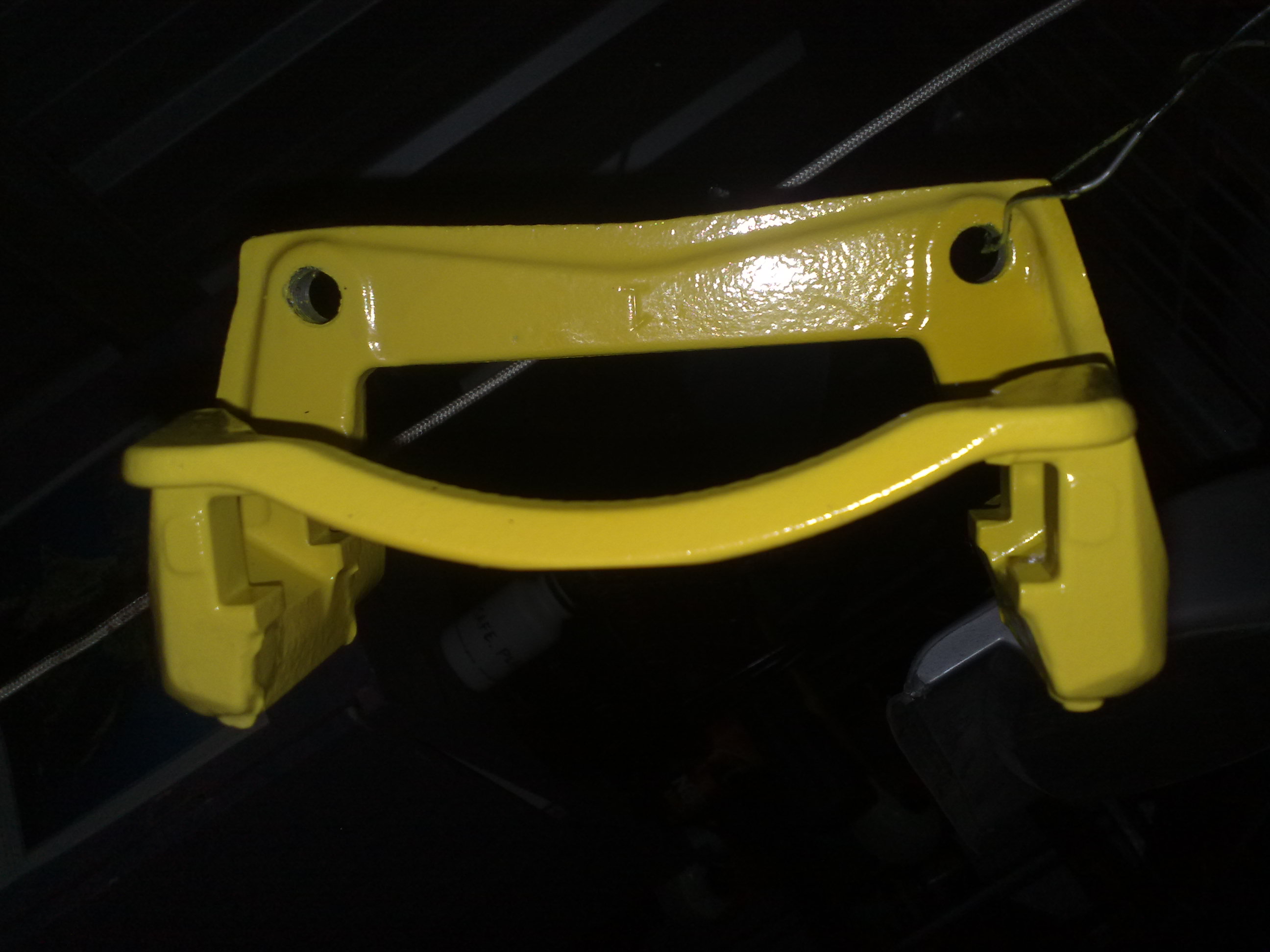

Getting twin pistons out of their bores takes a bit of fiddling about with an air compressor & a block of wood but it was managed. Everything checked out okay, no scratches/wear marks on the pistons or the bores so off to be prepped for paint.

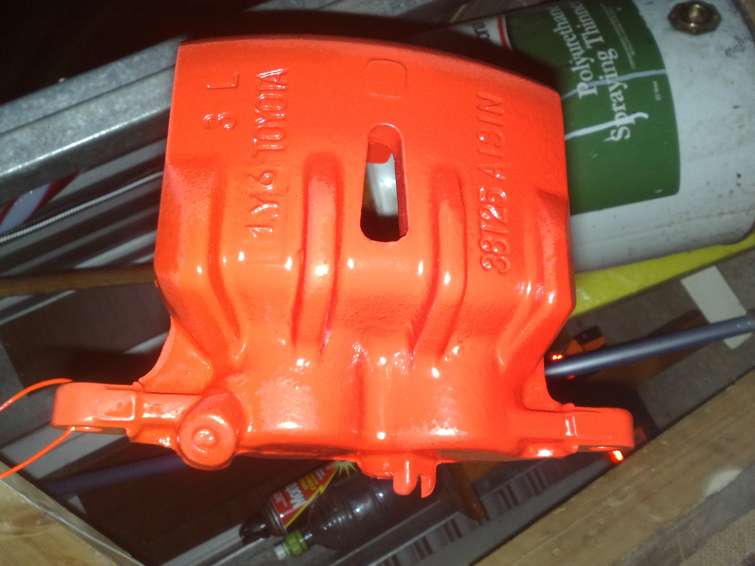

don't quite know why yellow except I had some laying around needing to be used or thrown out?
Does red make you stop faster too?

Not my little girl (thankfully lol) she belongs to the guy in the photo giving me a hand to remove the windshield without breaking it...we failed...miserably! :laff: But she seemed keen (strongly insistent?) on helping me "fix" my car so what could I do? The hard part was finding something where she couldnt injure herself too badly, she's a bit on the accident prone side even now :P A mad keen Dora the Explorer fan & from memory the fav toy/s atm are her marbles. My housemate's child likes my car but admits she's not interested in helping me (usually involves actual work & like, effort) & gets told to bugger off when I'm playing with power tools or funky chemicals. Paint stripper + lack of sufficient ventilation = $h1t I nearly fell over, time to take a break!

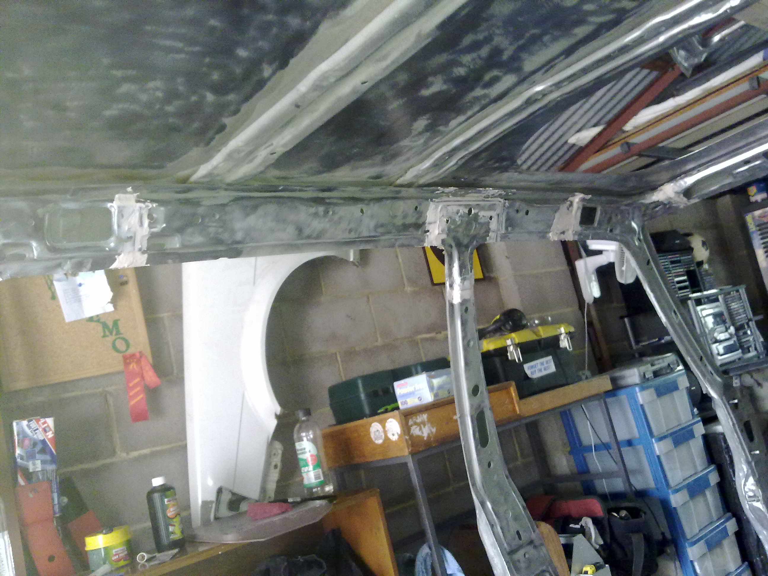

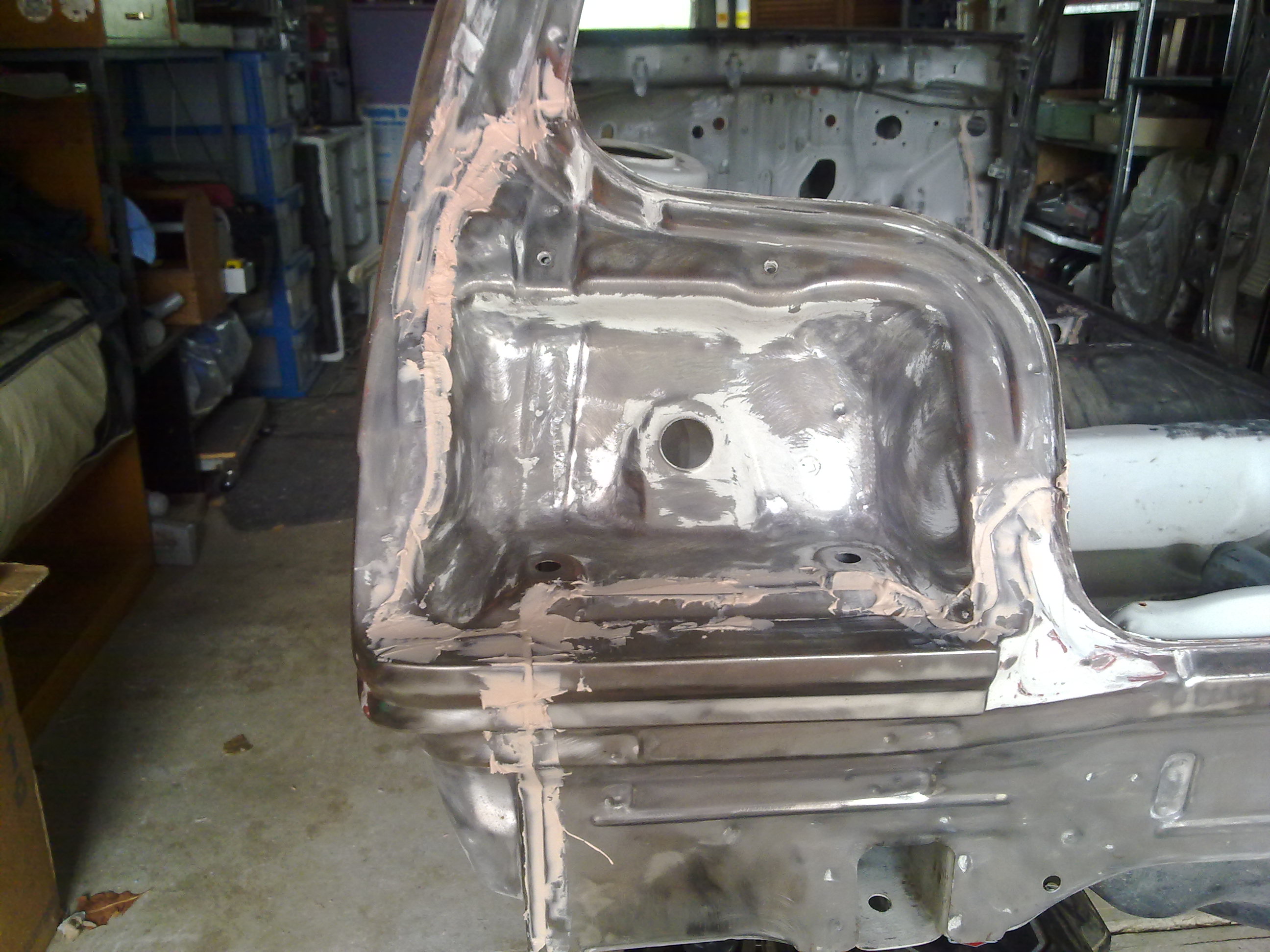

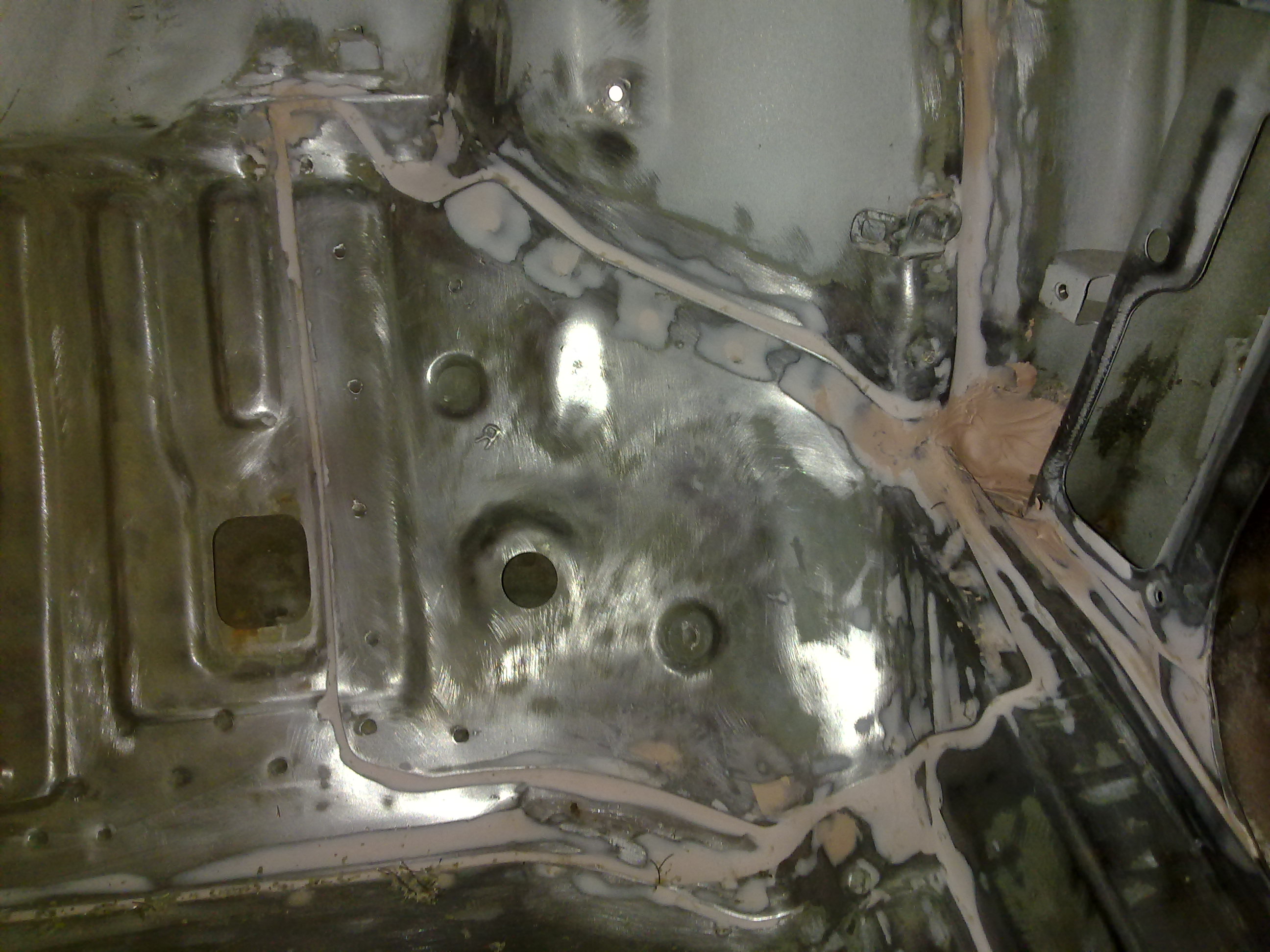

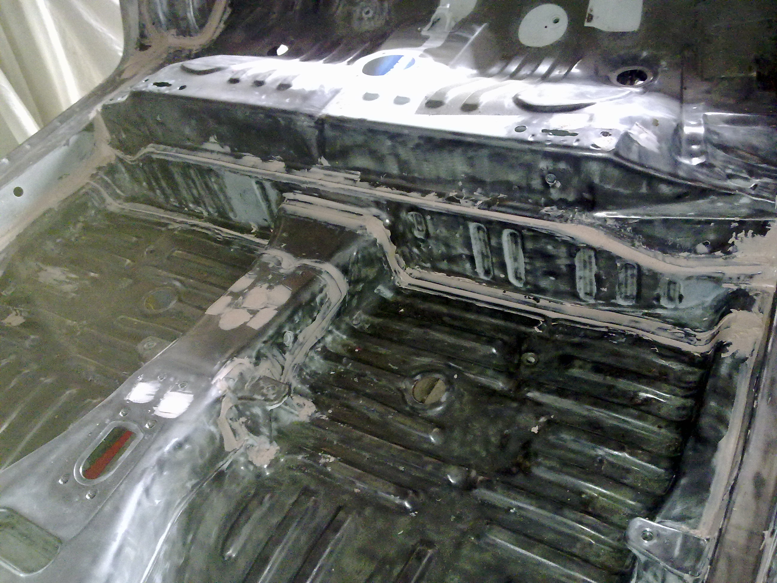

The next task after the car was stripped was to break out my old mate, polyester body-filler! Well okay, BOG. :wink: I still don't quite known what possessed me to do this but I took to all the seams on the body where metal overlaps metal & just put a small cove of bog in there. This was so the paint would just flow from one piece to the next without the small gaps that had irritated me previously, hopefully it'll look just that little bit cleaner/smoother.
Interior was done also as the only things left in the cabin wil be: front seats,dash,centre console, front door trims. So with a lack of carpet to hide stuff I took the time to make sure it'd look nice without it.

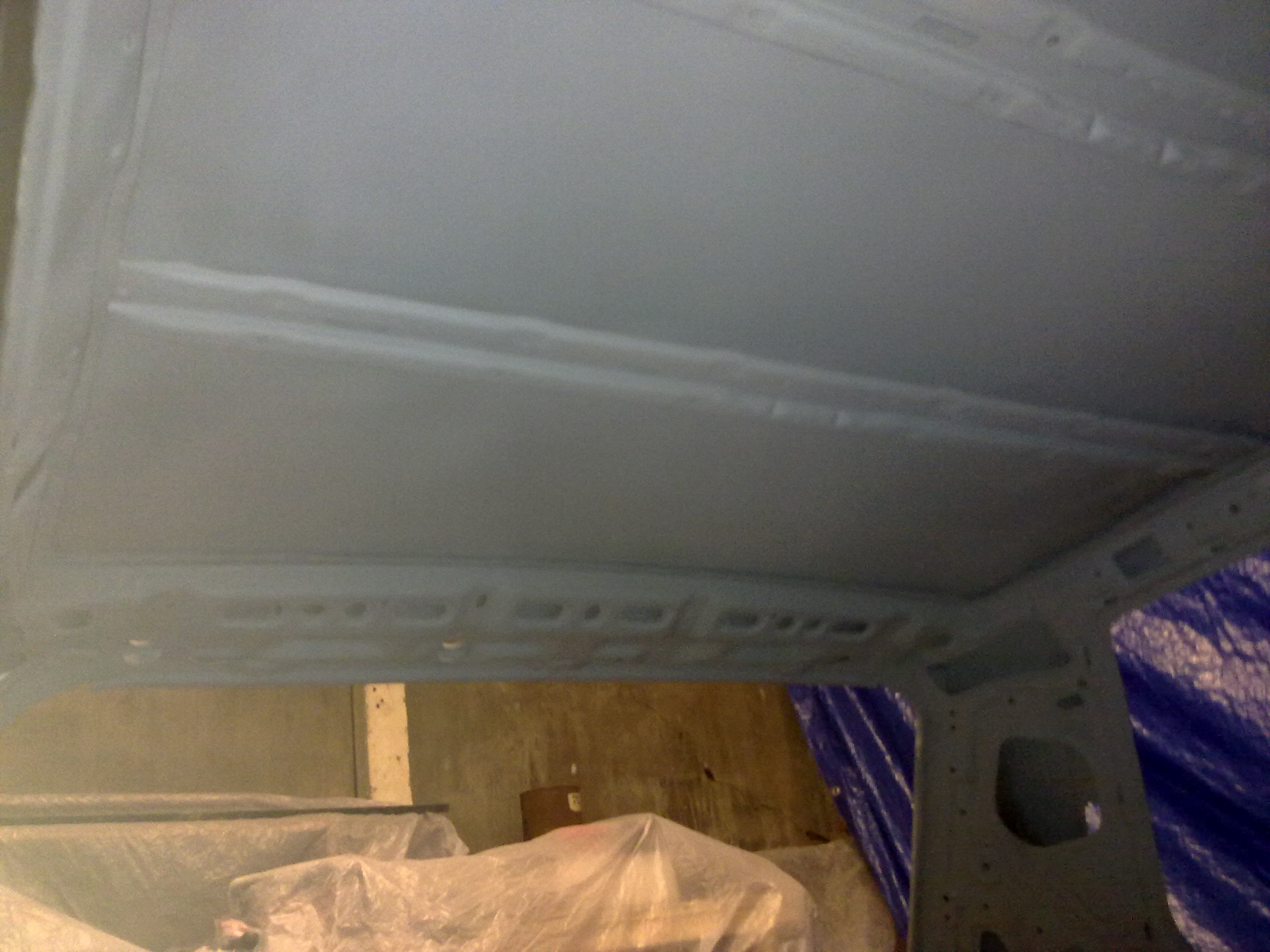

No bogging needed on ceiling thank fork as grinding overhead hurts after about 5min >| Nice shoulder workout tho!

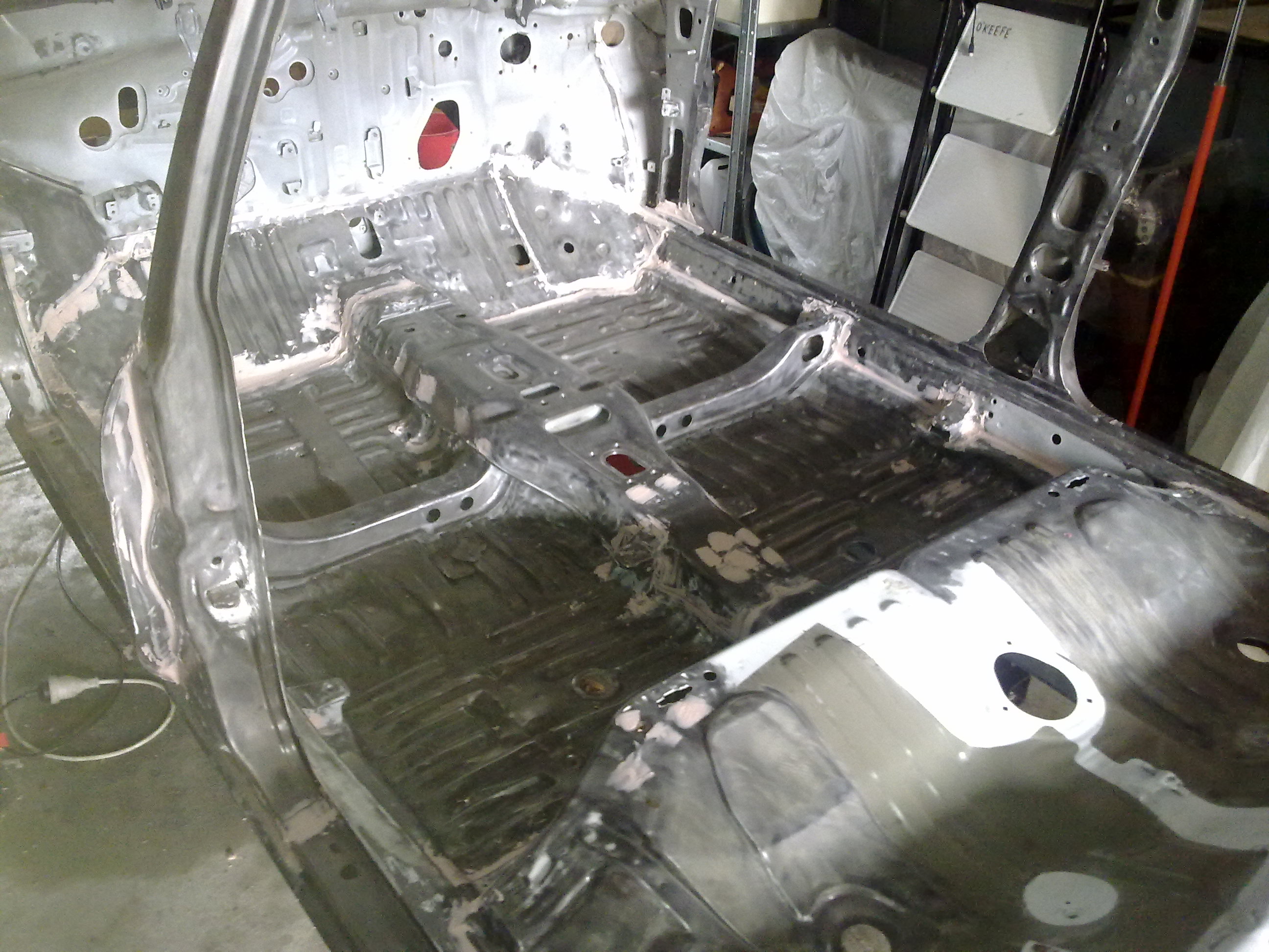

Drivers footwell

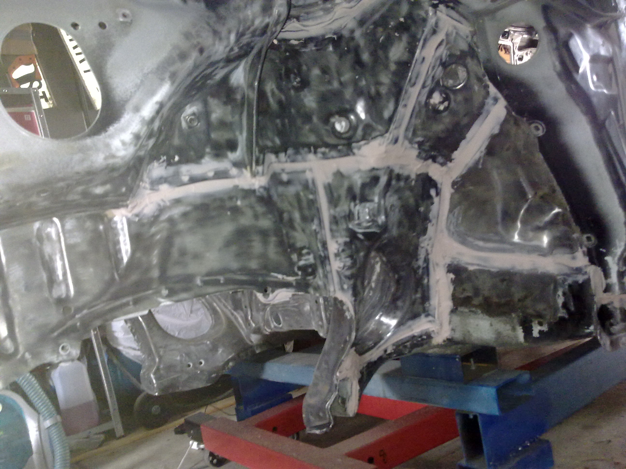

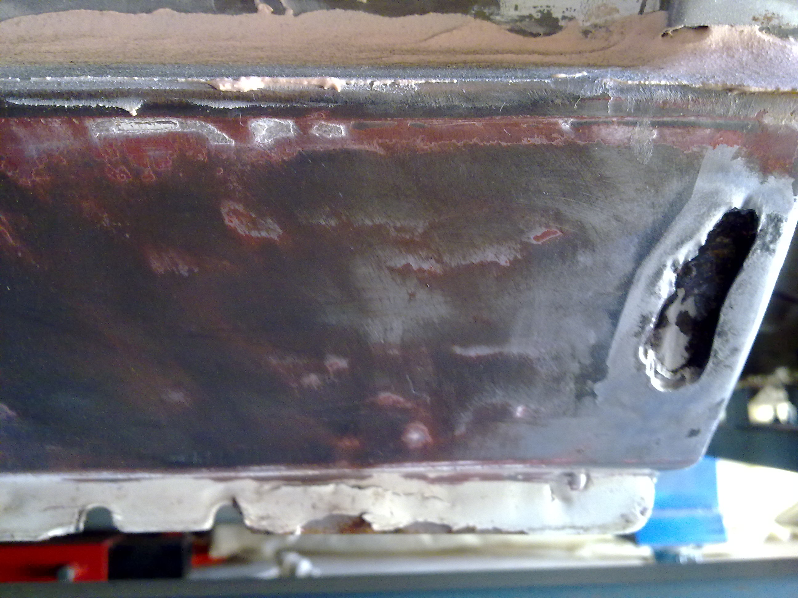

Found small rust spot in front of rear wheel arches (both sides) that turned into big rust spots the more I ground away...Gave them a good hit of phosphoric acid then washed them out & used Metal-Mend to fill up the hole.
Got a bit carried away, the tail lights will cover most of this..

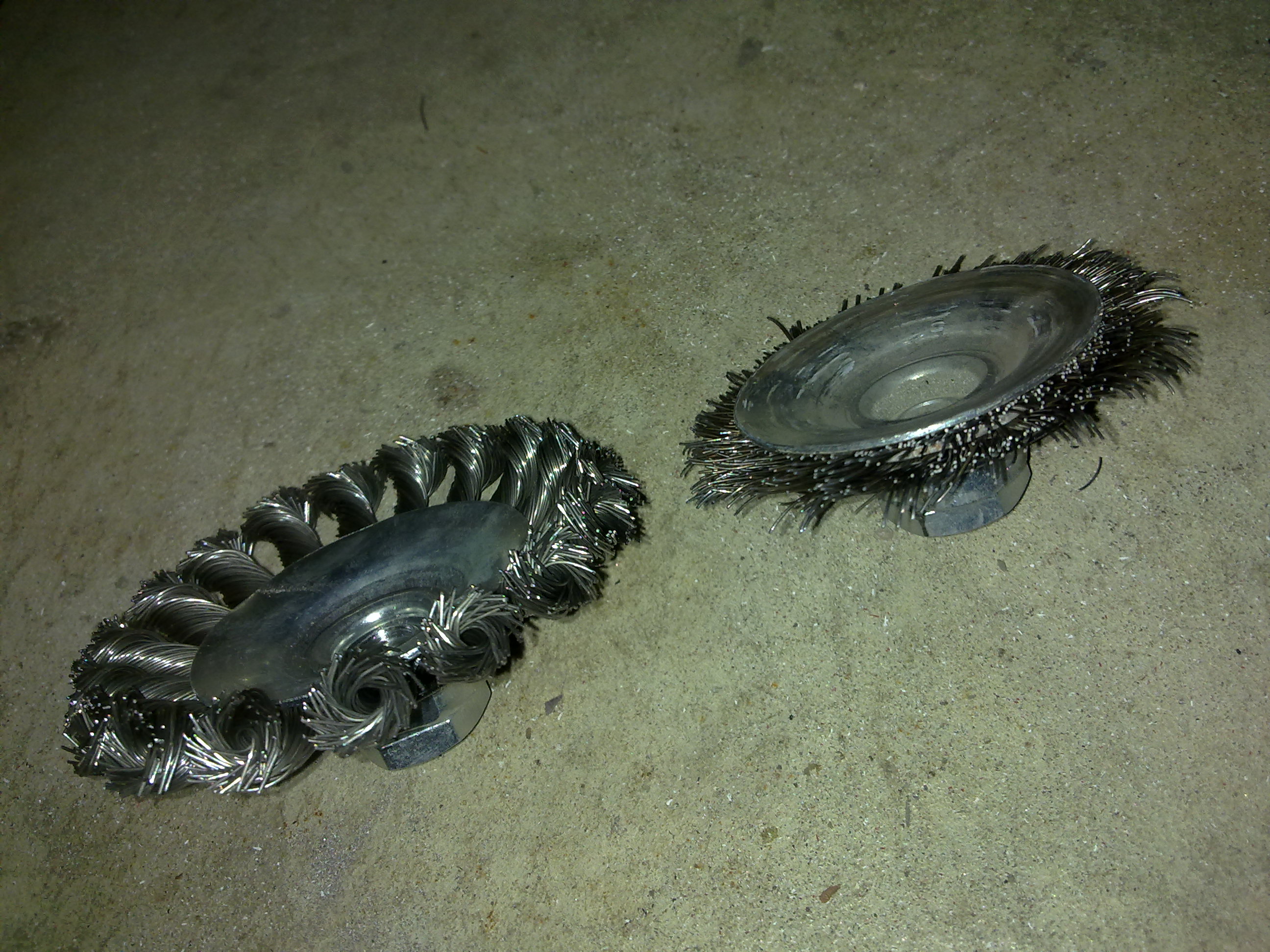

Wire wheel for angle grinder before & after shot

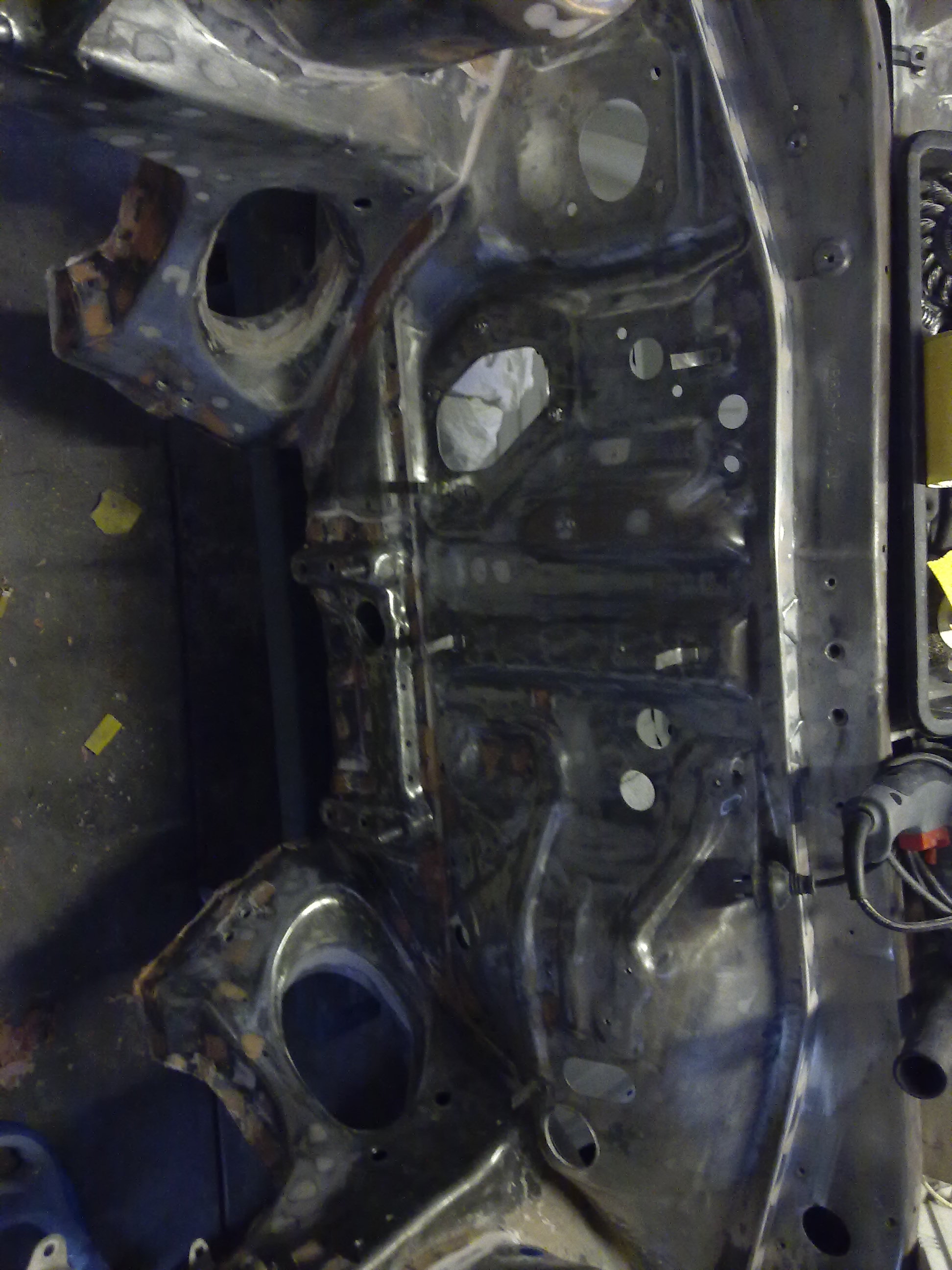

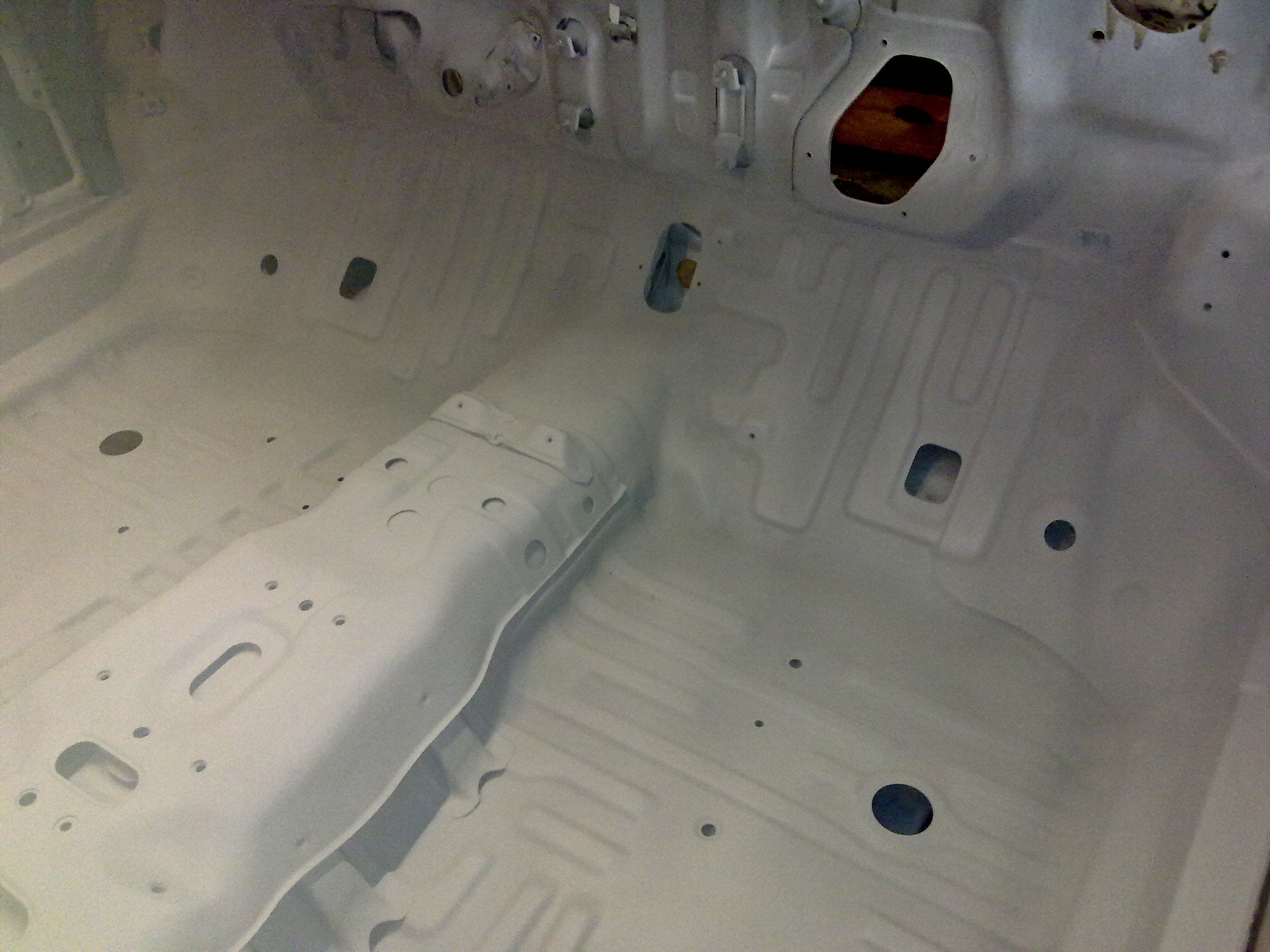

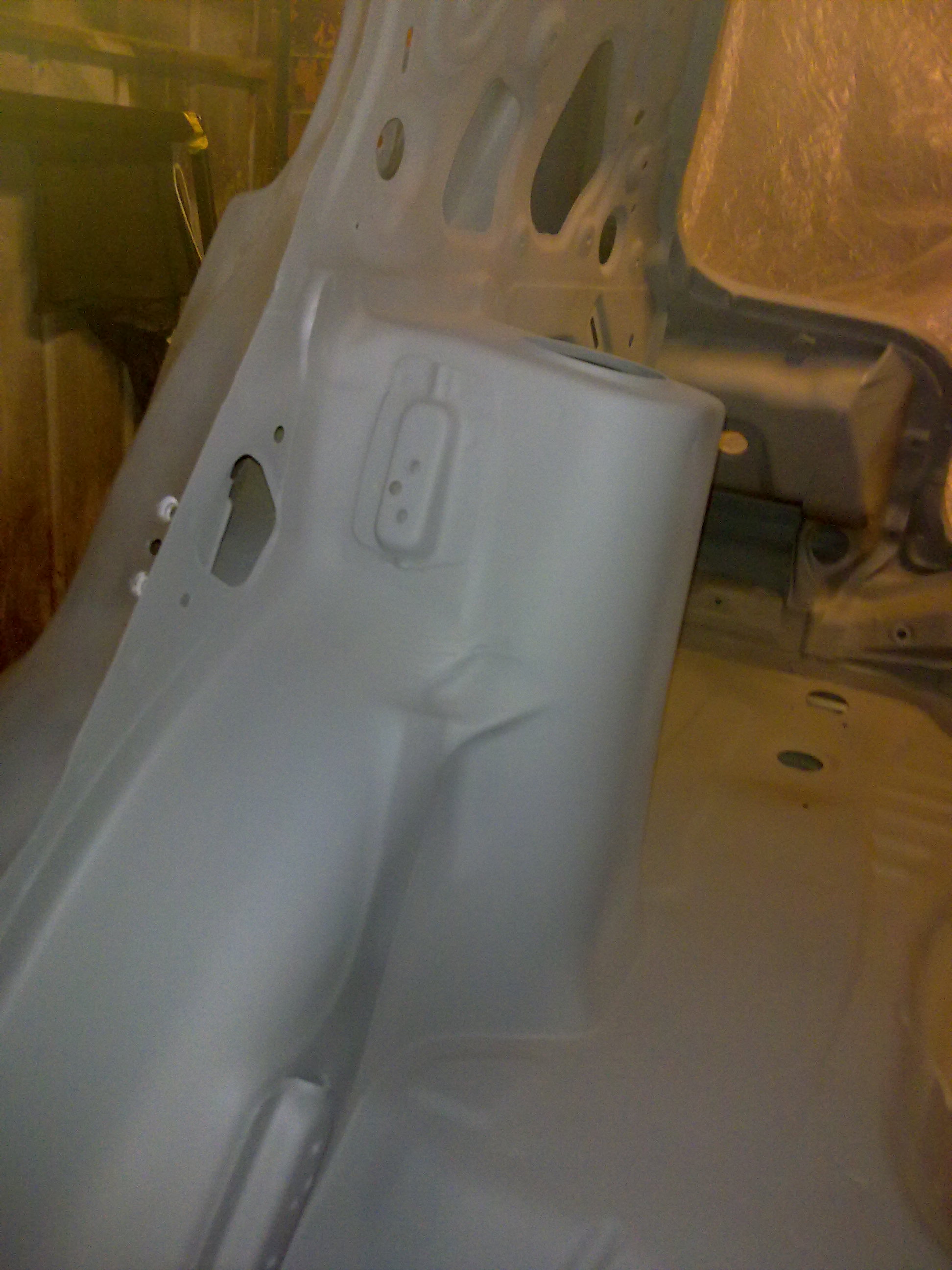

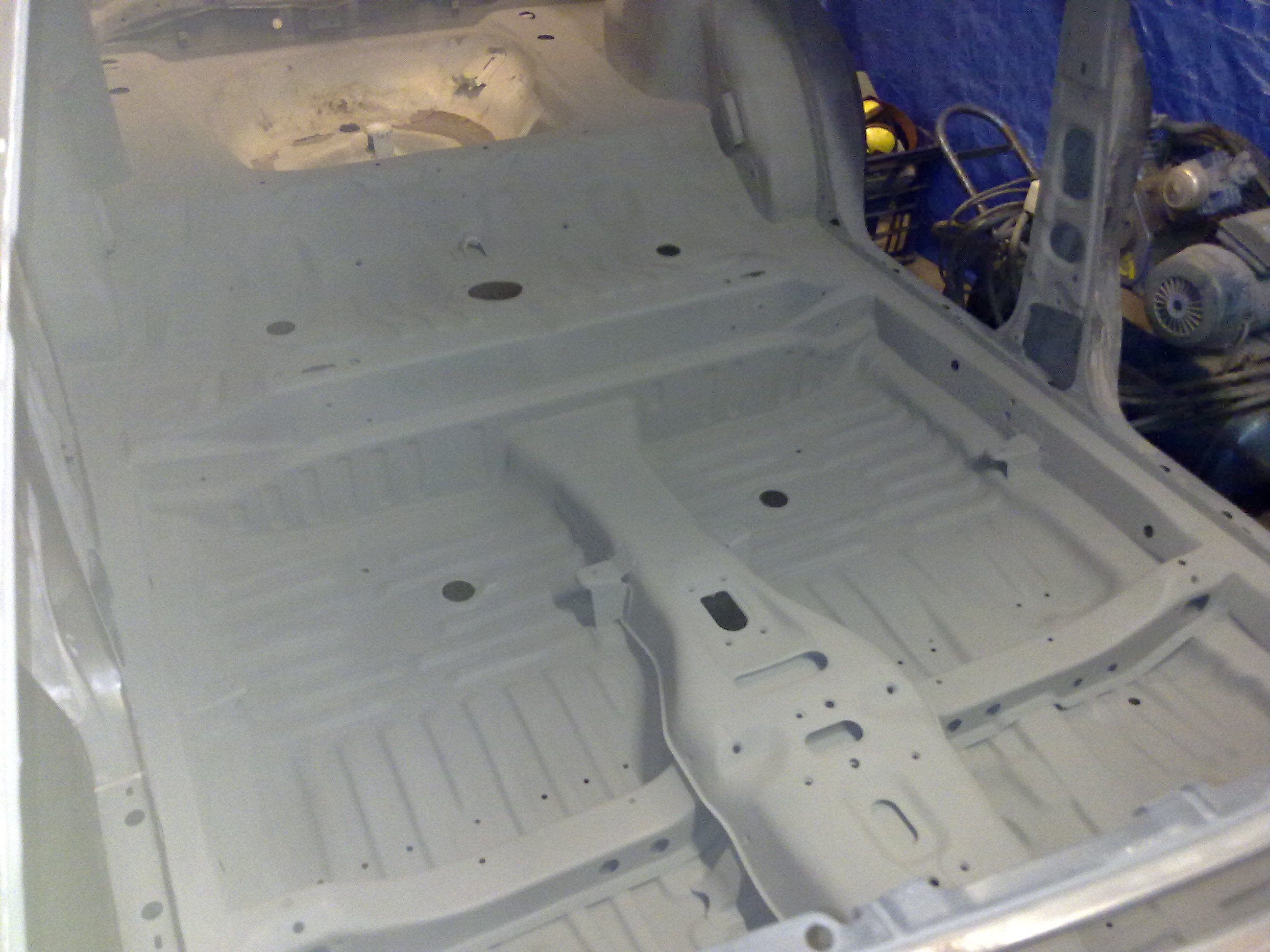

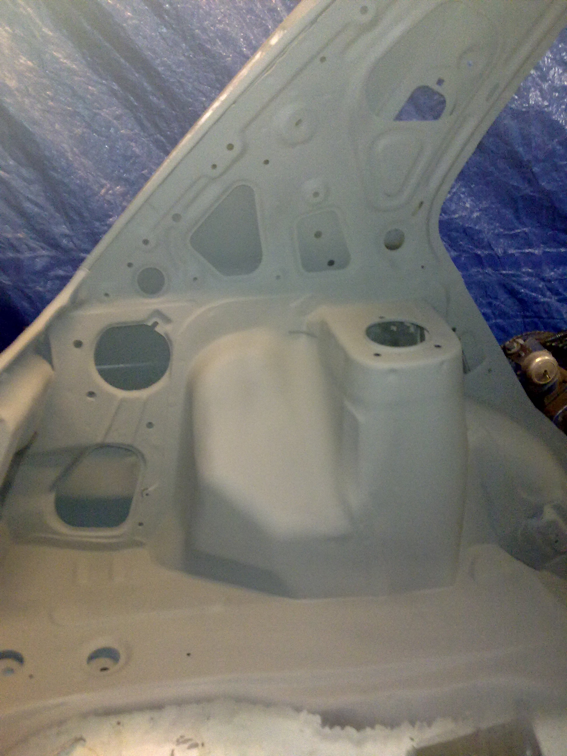

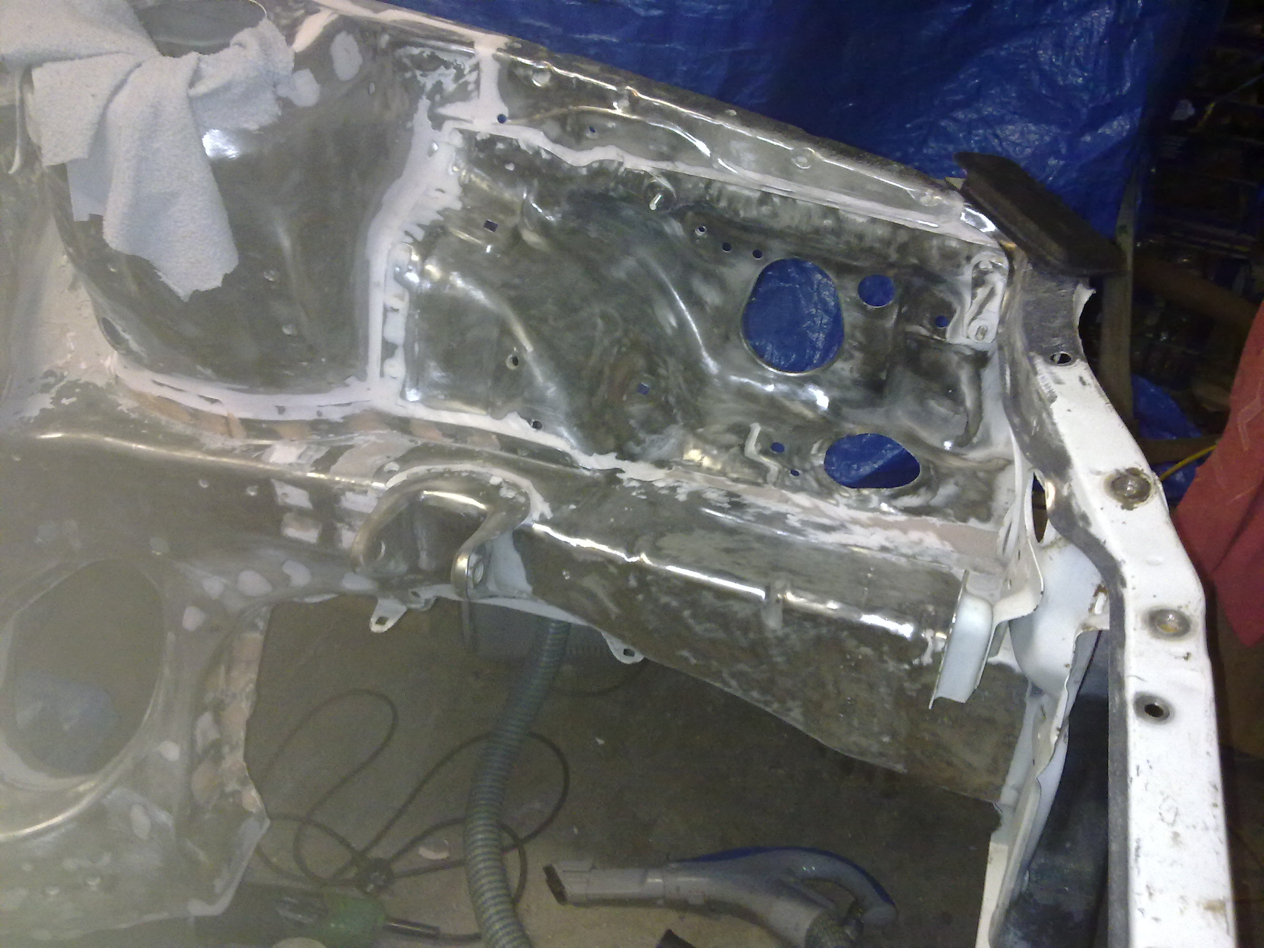

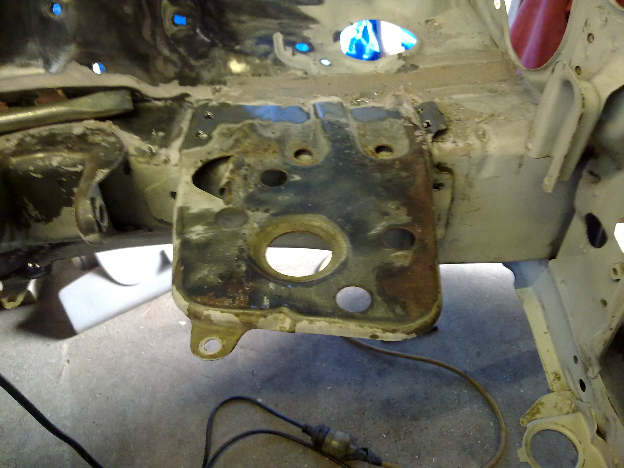

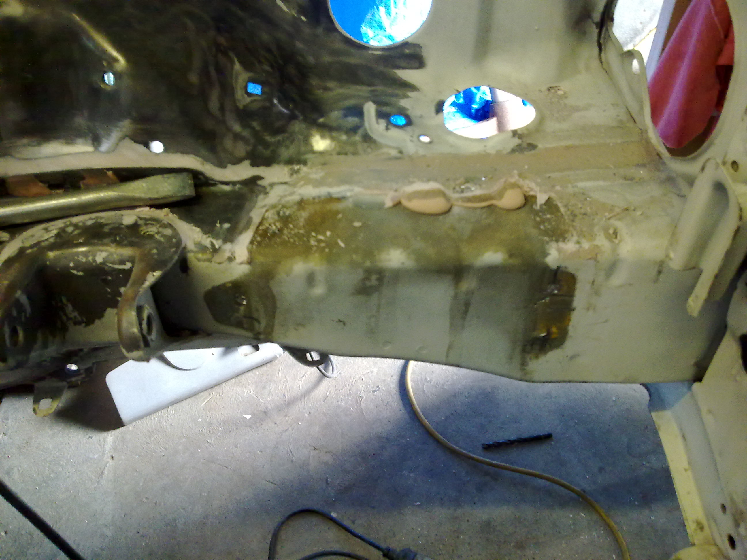

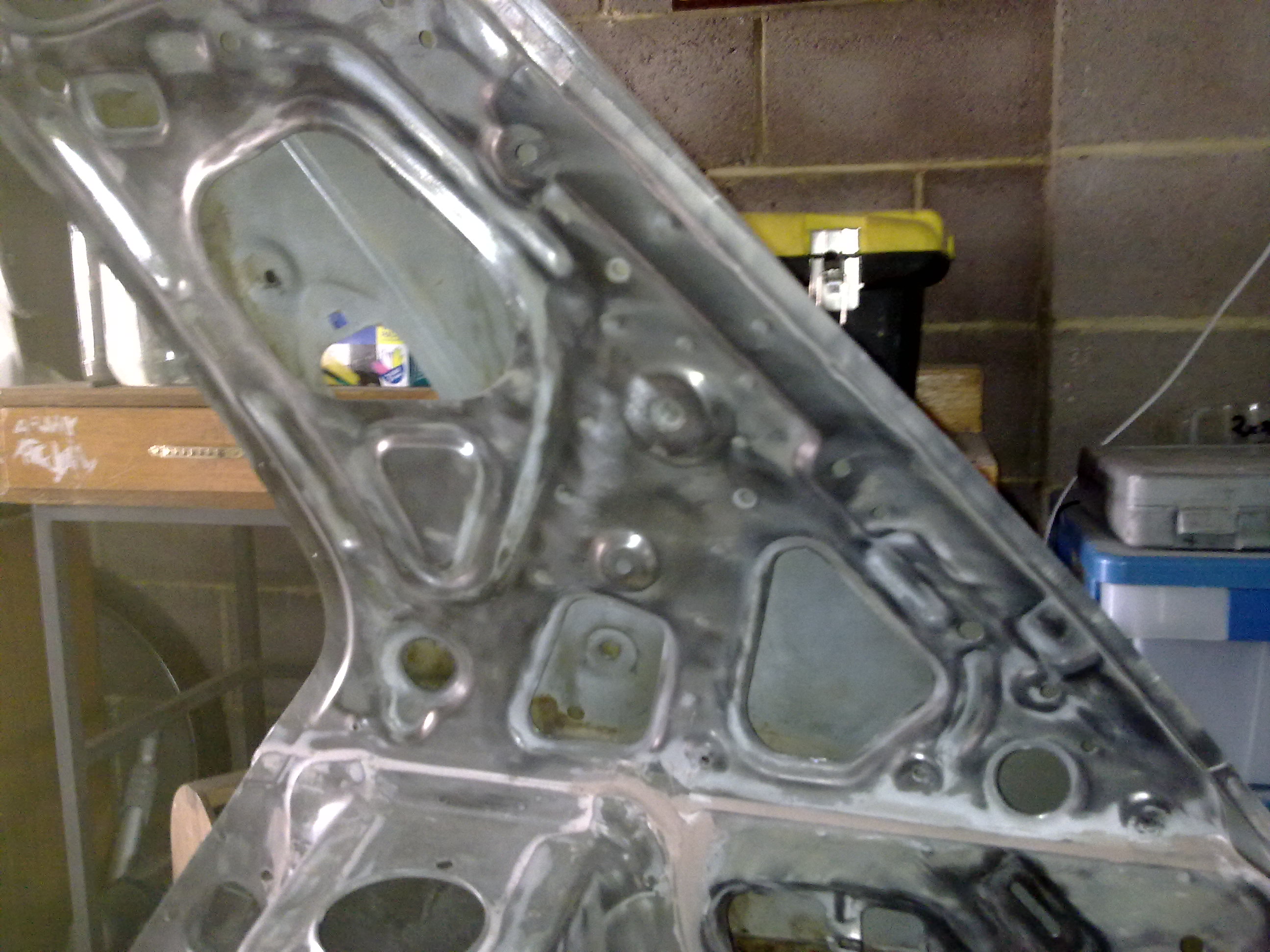

Prep for primer continues, anything rusty gets ground, hit with rust converter, washed, then everything is ground/sanded, bogged, sanded again, dusted off, prep-washed & ready to roll.
Edited by carbonboy

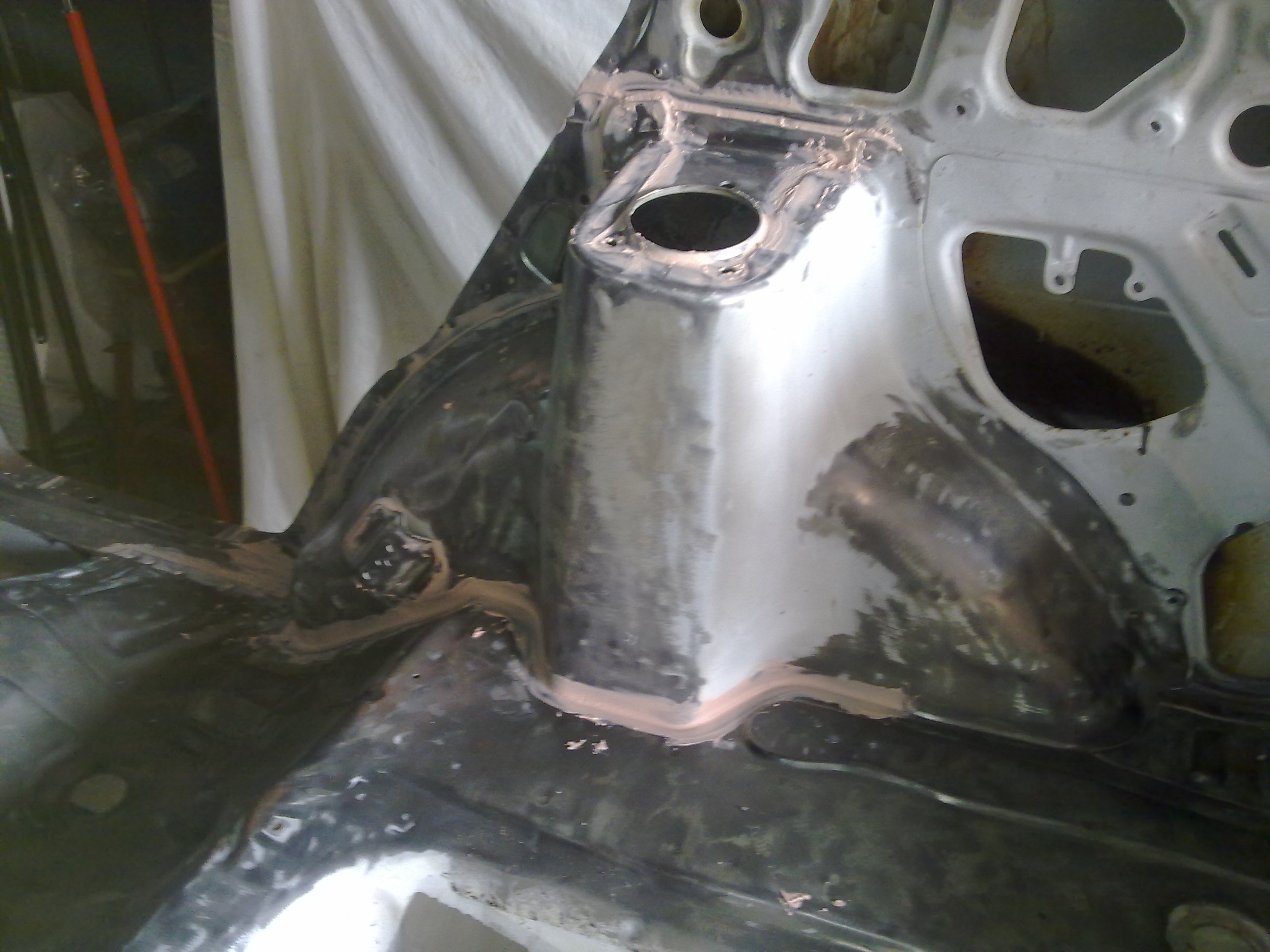

Okay ran out of room for photos in the last post so I'll continue on here :rolls:

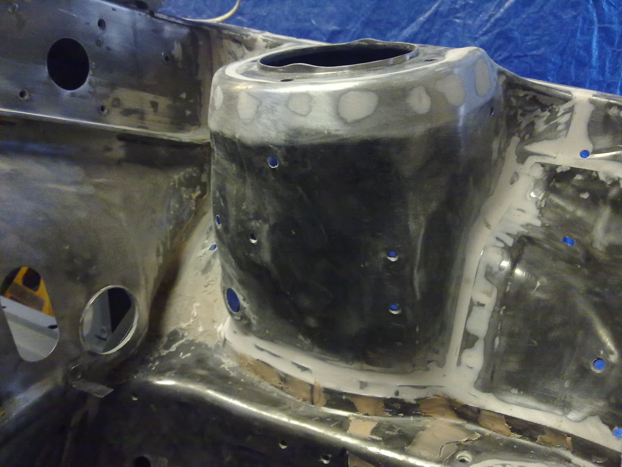

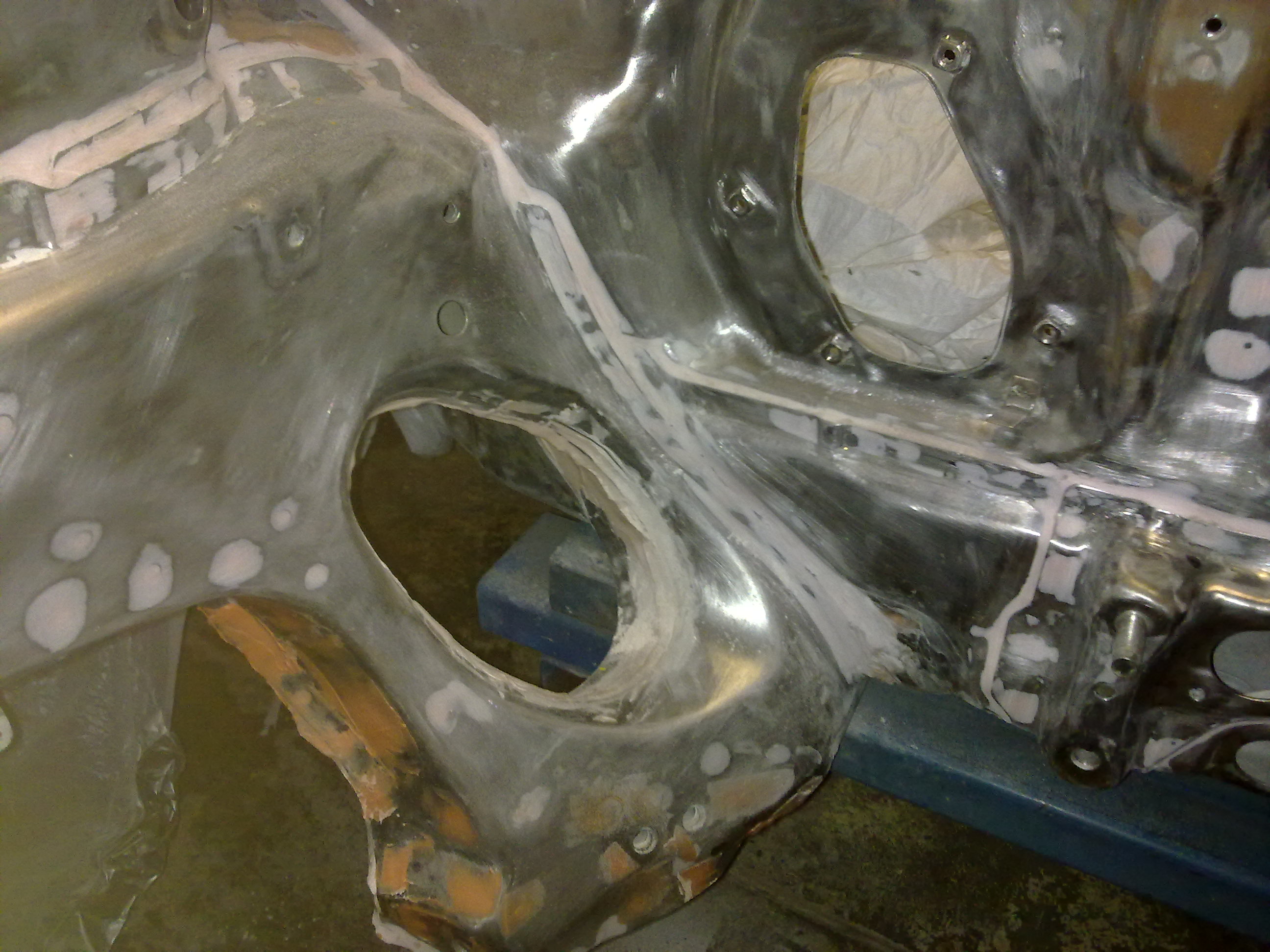

Front strut tower.
Where steering arms go. Previous stuff looked brushed on, it'll look much nicer now when I have to drop my gearbox to change the clutch :lolcry:

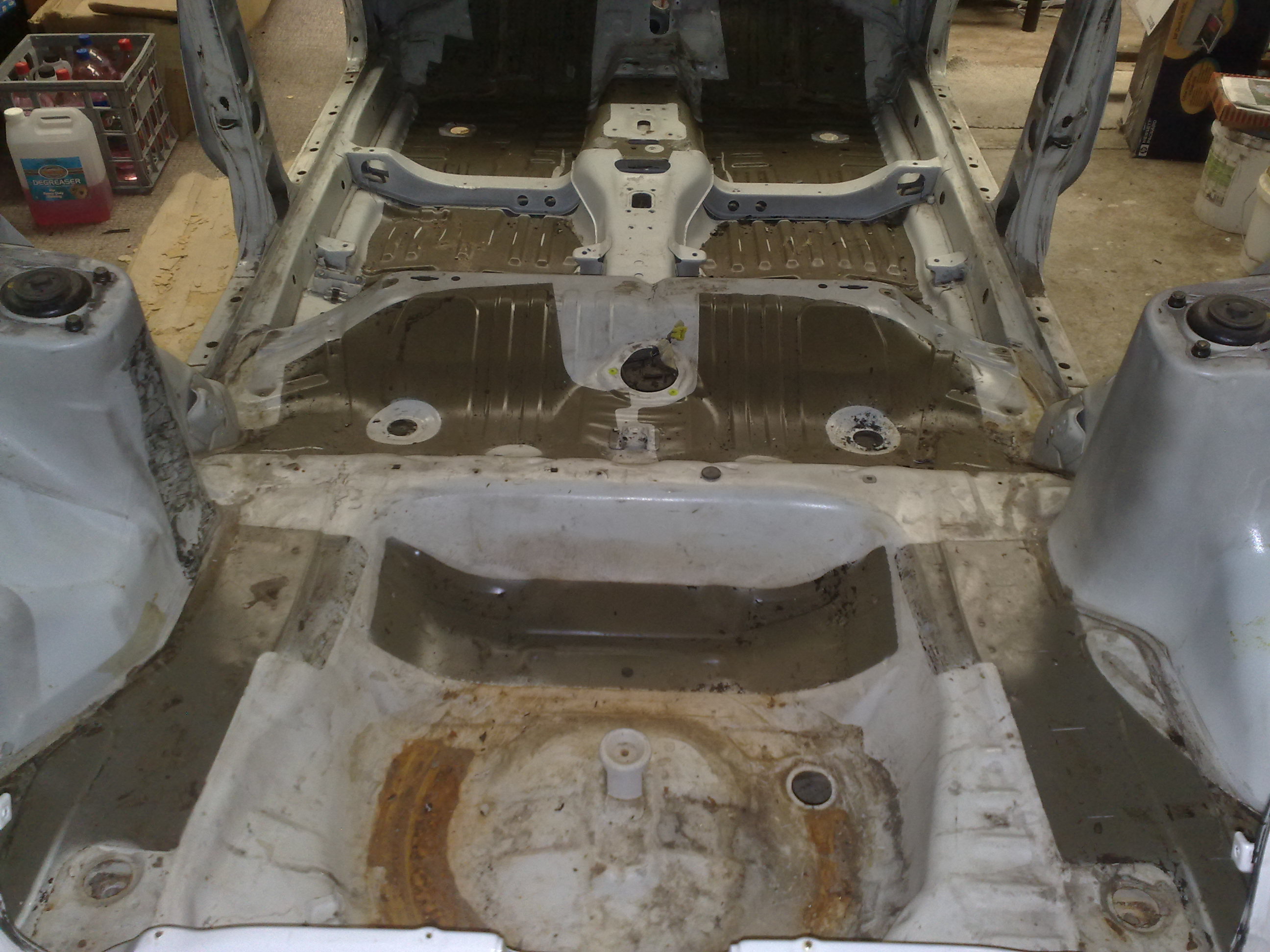

Note that the spare wheel tub is not done, this is because of some serious rust that is to be cut out & good metal welded in. Since the house move/s my plans of doing things in an order went out the window. You get used to it I guess lol. Besides, more priming to do on other bits so it could wait.
