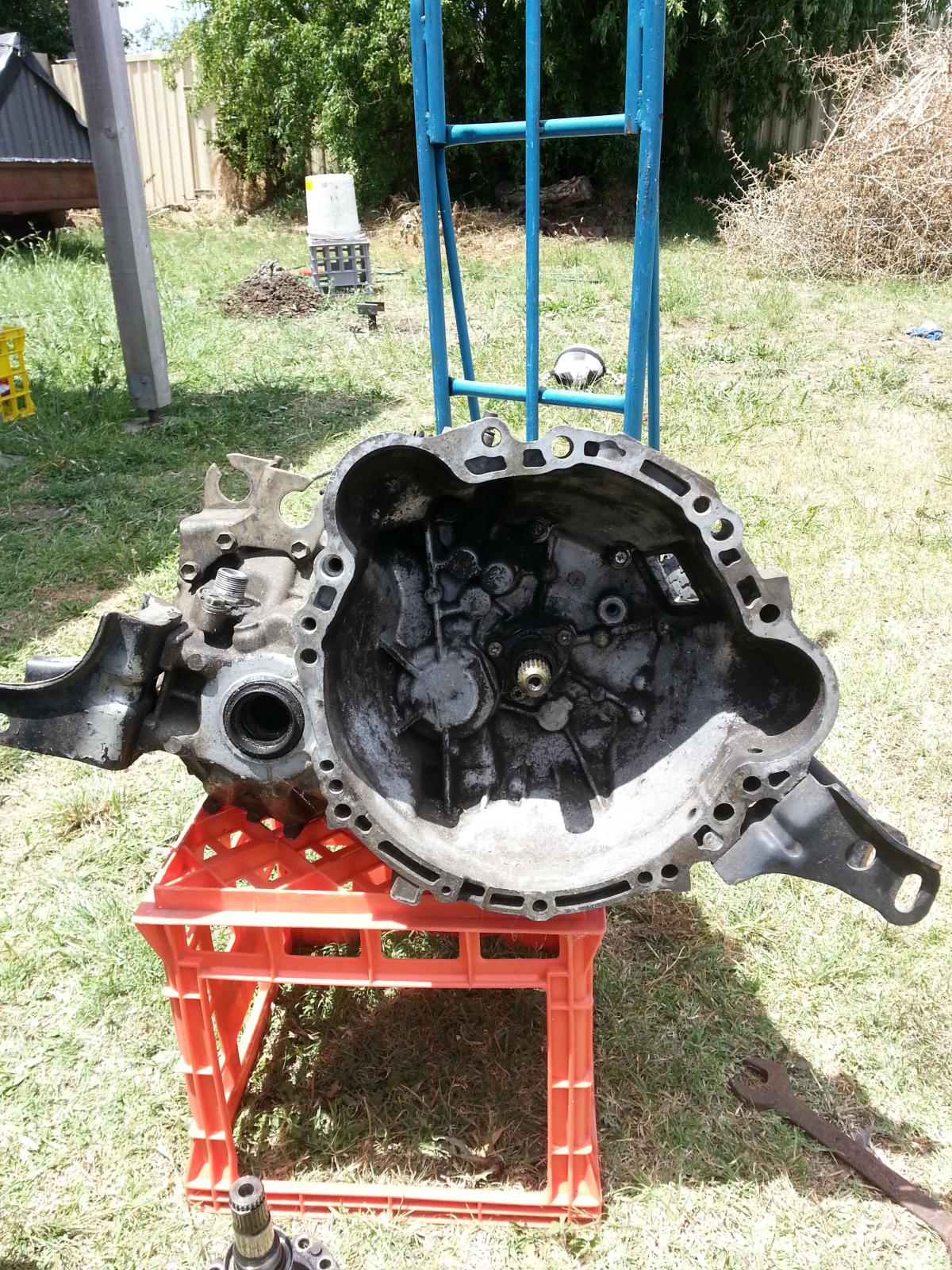

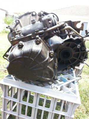

carbonboy Posted December 30, 2012 Author Report Posted December 30, 2012 (edited) It'll get there. :P Did some fiddling about with some spare gearboxes today, you might recall a few pages back I attempted to get a C52 into Blue Thing to replace the C40. That gearbox had issues, so back out it came, but I did discover that the C40 output shafts (small bits straight out of the gearbox) fit into the C52. So I dug out the gearbox I got as a spare when I bought my original AE82, from what I know it's from a 20v ST from an AE101 so likely a C56. As the output shafts from the C52 fit into it, I'm fairly confident I can use the C40 output shafts & driveshafts. Almost an insult putting it behind an 8v engine. :lol: I did need to swap over the switches for the reverse lights, they're the same device just different plugs for the wiring loom. Also, the speedometer sensors are different in that the C52 item is a cable drive & the C56 is an electronic item. The gears on them have the same markings (35/31) & the same number of teeth, thinking that swapping them over shouldn't hold any problems. Will compare them to the C40 item & check speedo accuracy with GPS afterwards. While I'm here, upgraded the shagged rubber bushes on the shifter cables to something a little firmer. Edited January 2, 2013 by carbonboy Quote

carbonboy Posted December 30, 2012 Author Report Posted December 30, 2012 Different ratios/final drive than a C50/2, managed to dig up the info. C401st 3.545 2nd 1.904 3rd 1.310 4th 0.969 Final 3.9 . C50: AE82, AE92 (All), AE101 w/ 4A-FE) MR2 Mk1a Gear Ratios: 1st: 3.545 2nd: 1.904 3rd: 1.310 4th: 0.969 5th: 0.815 Reverse: 3.250 final drive: 3.722 C52 1986 on?: ae82 4age, ae92/3 4age, ae102 w/ 7A-FE, ae101 Silvertop 20v (1st generation), MR2 Mk1b gear ratios: 1st: 3.166 2nd: 1.904 3rd: 1.310 4th: 0.969 5th: 0.815 Final: 4.058 C56: AE101 Silvertop 20v ((2nd generation) & AE111 Blacktop 20v) gear ratios: 1st: 3.166 2nd: 1.904 3rd: 1.392 4th: 1.031 5th: .815 final drive: 4.312 Quote

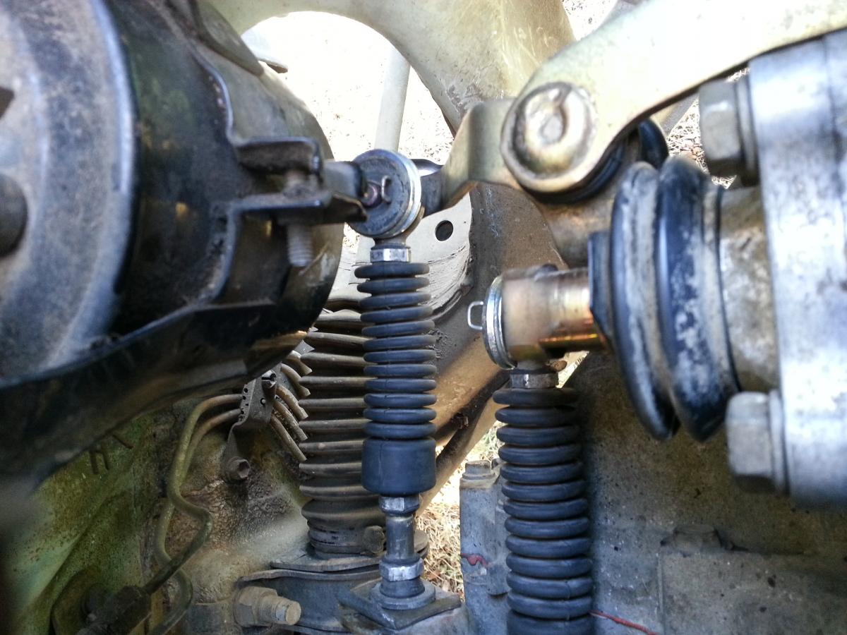

carbonboy Posted January 1, 2013 Author Report Posted January 1, 2013 (edited) It turns out the swap wasn't as easy as I'd hoped for (when is it ever?), not only did I have a locating pin from the block meeting up with a corresponding one in the gearbox to deal with (a BIG hammer & a punch says fixed), I found out the brackets for the engine mounts on the front/back/passenger side of the gearbox are ever so slightly different. Unfortunately this was as I was trying to get the crossmember back in, not only do they not line up at all, the bolts for the mounts don't fit through the brackets. Cue epic rage fit & rapid swapping over of the brackets. The C56 also has an extra 'rib' underneath the passenger side driveshaft, meaning that getting the driveshaft in is not as easy as it once was.Also managed to cross-thread a crossmember bolt for about the third time, so I tapped a coarser thread & put a new HT bolt in. C40 out. 4 speed to the right, 5 speed to the left. Extra washers required for shifter cable bush replacement. Took it for a short test drive, second gear is a little crunchy if I try to rush shifting into it, but it could be that I'm used to a sloppy four-speed. I'll wait until I've driven it a bit more before I write off the synchros. RPM at 100km/h with the four speed was ~3600rpm in fourth. With the 5 speed it's now ~3200rpm in fifth. It's only ~400rpm I know, but it makes a big difference to noise levels, maybe fuel economy will get a little kick too. Edited January 2, 2013 by carbonboy Quote
