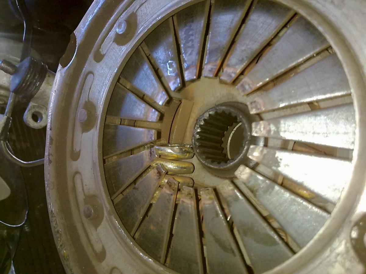

Blue Things clutch decided that it no longer wanted to disengage on Thursday, so with the help of a mate I managed to get home, grab a spare slave cylinder & get back. Swap it over, same problem. Cracked the shits & drove it home without using the clutch.
Pulled the gearbox out today to inspect the clutch fork, showed signs of splitting at the pivot point. Pressed steel fail. Also, the setup for the C40 differs from the C5x series in that the pivot point (bolts into housing) is smaller, as is the clutch fork itself.
C5x on the left, C40 on the right. Swapped the whole setup in.
Get the whole shebang back together in record time to find that nothing's changed, clutch still won't disengage. :(
Time for a new clutch kit or am I missing something here? Buggered pressure plate? :hmm:
