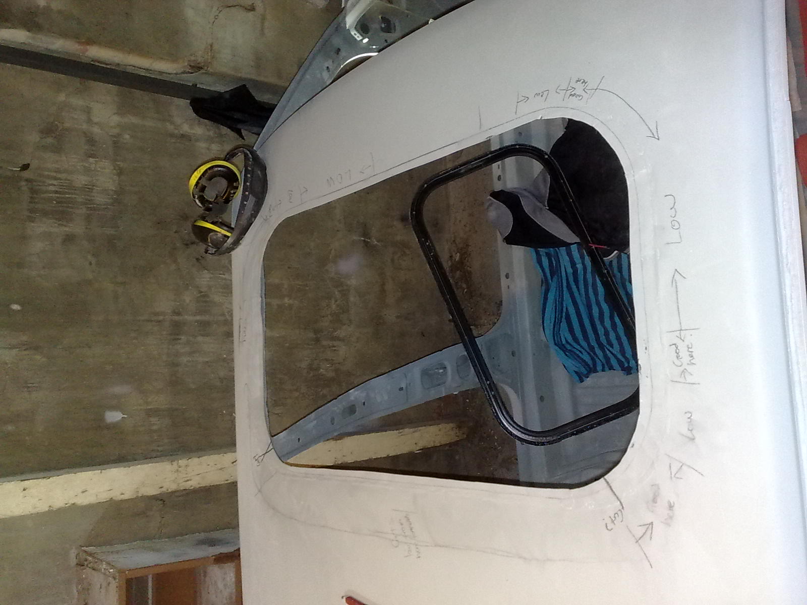

I'm only taking the roof 'skin', on these it's a sheet panel that's spot welded along the bailey (spelling? correct terminology?) channels, top of the hatch & windshield areas. The internal frame/bracing/structure stays put, does this make much of a difference? I realise I still have to measure, remeasure & measure again, but hopefully there isn't too much difference, both being AE82 TC. :hmm:
No visits to the wrecker required, I have Sudi (the original Twin Cam) sitting in the driveway ready to donate her undamaged roof sheet if required. That car won't be going back on the road ever, the plan was to cut it up once stripped, scrap most of it & keep the firewall-forward section for dummying up engines. :wink:
On the flip-side, I could go Plan C & cut a new hole the correct size for the sunroof... :bash:

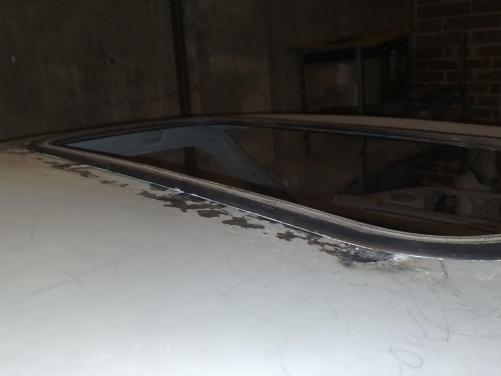

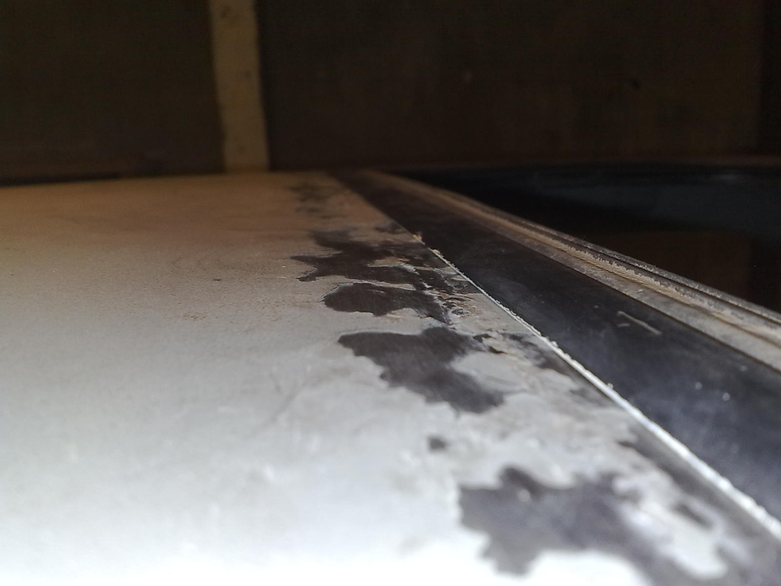

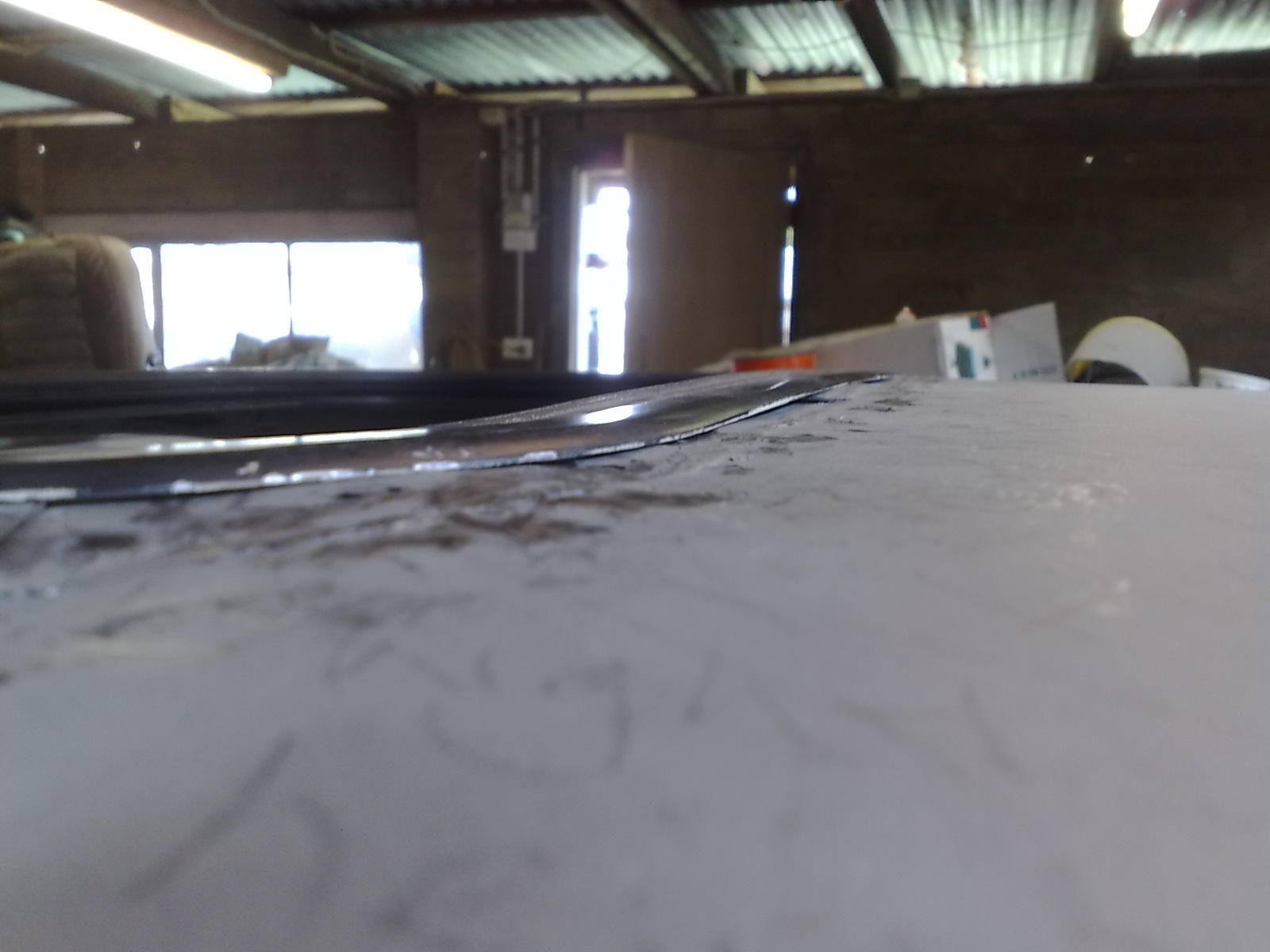

Progress pics, needs a few more tweaks (read: hammer taps) before I weld up the cuts I made to relieve stress I created. I'm not the greatest panel beater but I think it's better than what it was, good enough for me. :D
Have been doing a bit more thinking about how to go about this & spent some time making up a clamp arrangement. I really should've done something like this (or just paid attention) first time around. :( You learn!
Propped it up a little to get the shape I'm after (ghetto, I know), going to weld it after I make some dinner. Hopefully, it will somewhat retain this shape after I remnove the clamp. :hmm:

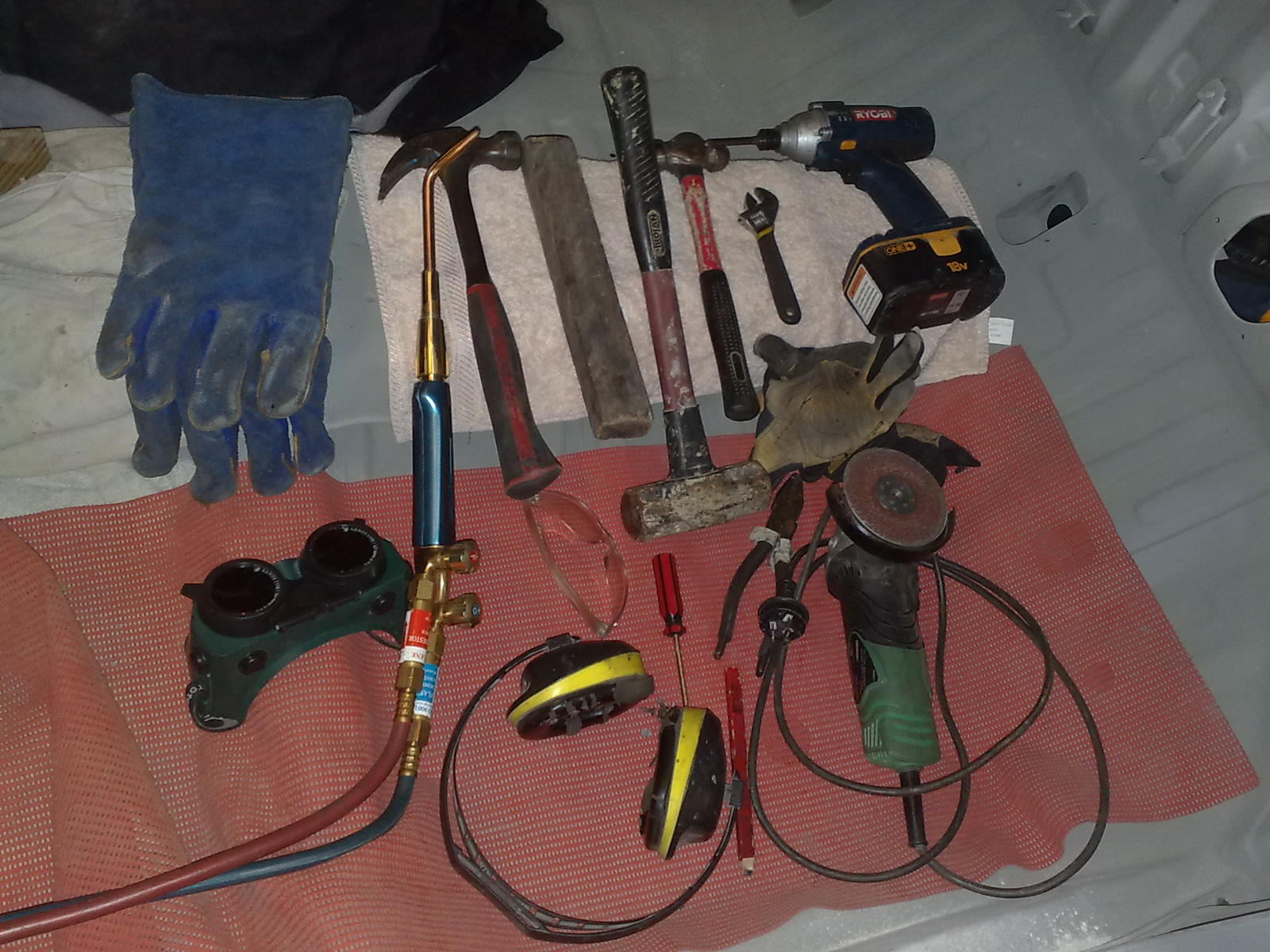

Everything involved in this process... :lol:

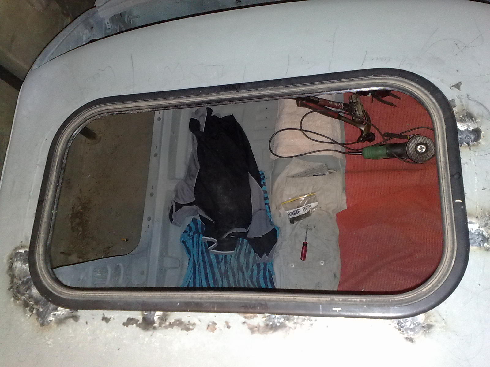

Got the cuts welded up, hadn't forgotten how to do this thank f**k!
Removed the clamp, kind of hard to tell by the pics but it's a helluva lot better than before.

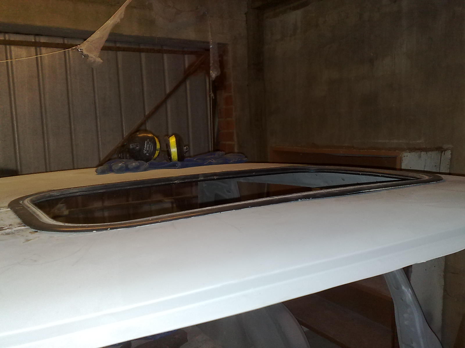

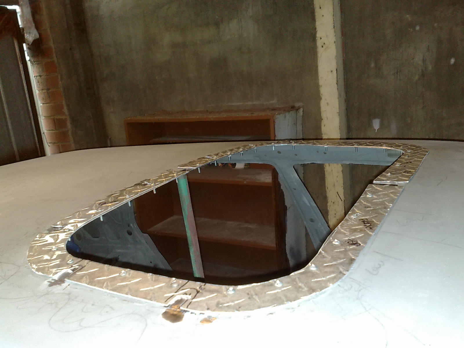

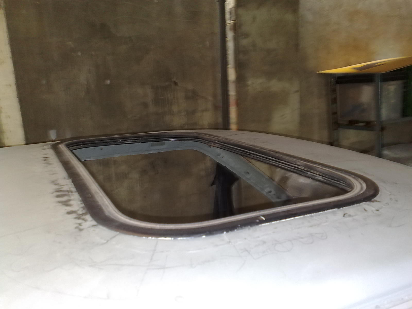

A bit more tapping with hammers & the sunroof frame sits in like this.
Front
Rear
MUCH better!!! :)

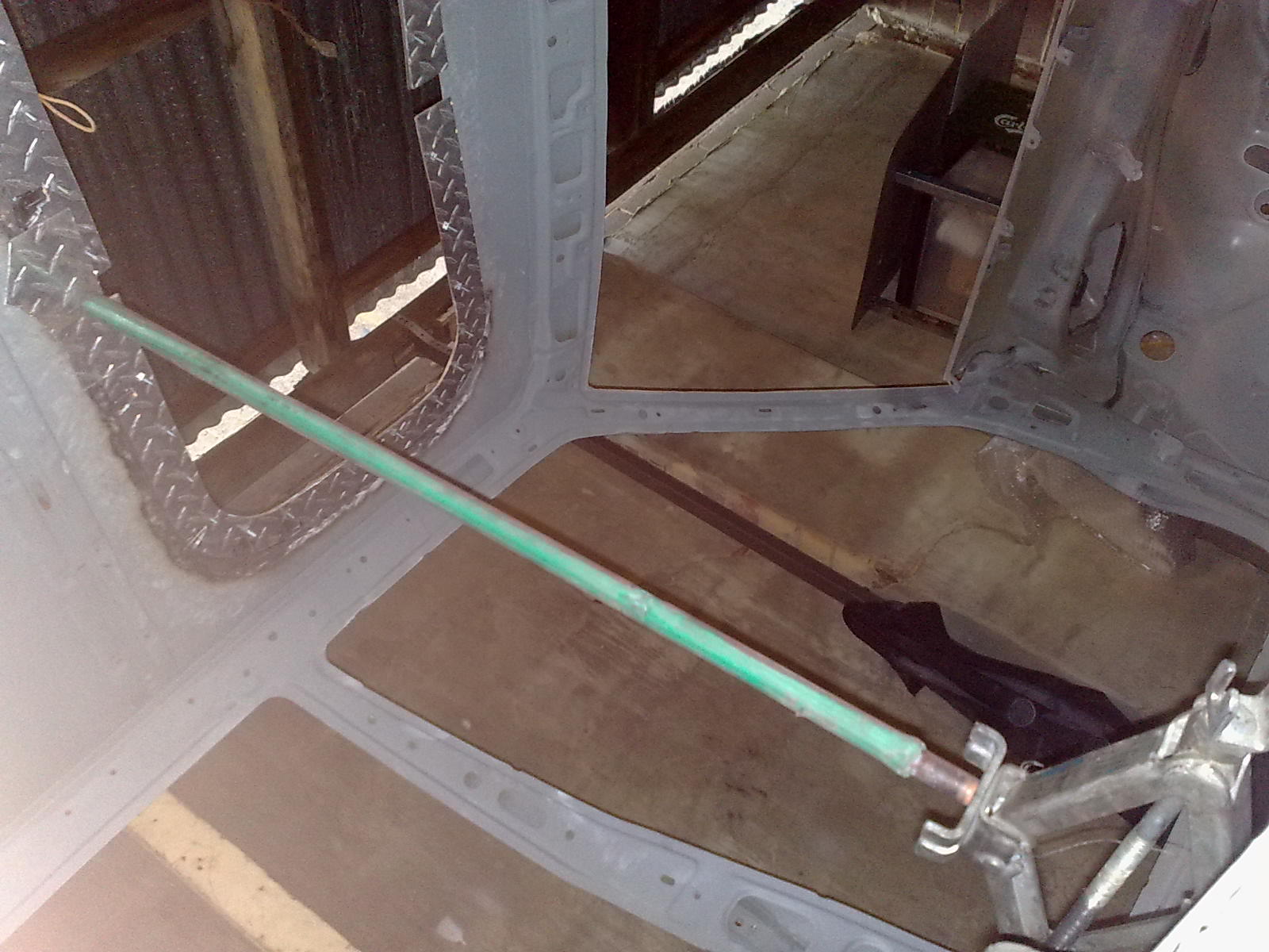

With the bottom section of the frame screwed in, it looks like this.
Front
Rear
Roof still has it's natural shape/curve to it.

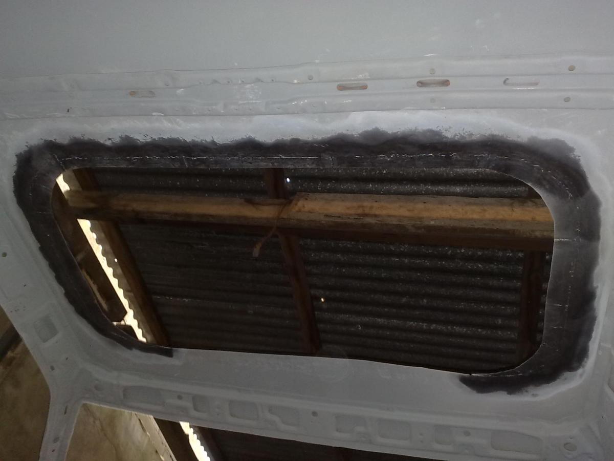

Have some adhesive backed foam-rubber to go under the horizontal support to stop the roof panel from flexing so easily. Not so much a worry when the frame's in (is quite stiff) but when it's not...for bog & paint.
That looks great, clear use of a broom pole? lol - you forgot to include it with the photo of the tools!
For a sec i thought you welded that checker plate onto your roof, I started to get a little worried lol
Thanks Tom, very happy it turned out this good. :happy: More ghetto than a broom pole, a scrap piece of lagged copper tube. :lolcry:
The thought of having it as a brace crossed my mind, then I realised that it's aluminium. I thought it was stainless steel, but once I started cutting/drilling it, the realisation sunk in. That & it's too fully hectik cuz!

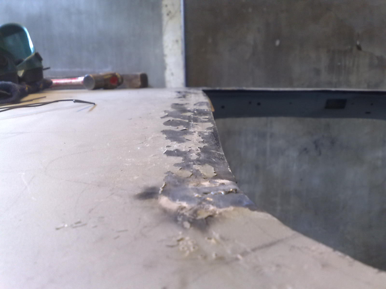

Cleared domestic duties backlog, finally got into the shed.
Ground back the welds & wire brushed the surrounding area.
Inside too.
Rust treated outside & inside. :blush:
Wire brushed the lot again.
Primer is applied, all the photos came out horrible, can't be bothered getting new ones as it's now dinner time! :D
