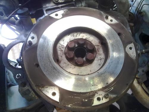

^ I don't know how the f**k I missed that yesterday, unsure if it had even fallen out at that stage. Either way, the gearbox came back off this morning.
Noticed the spring & felt glad I'd just gotten back from picking up a new clutch kit. Wasn't the master cylinder, lines, slave cylinder, fork or bearing...not much else left to replace. :)

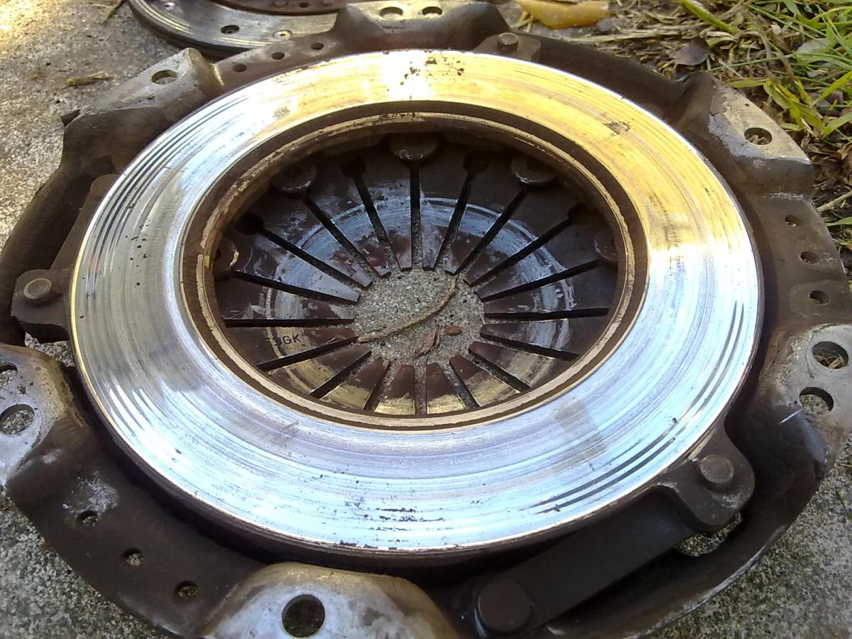

Pressure plate surface was properly rooted.
As was the clutch plate, one wonders how an engine with so little power can do that to the metal plate. :lol:

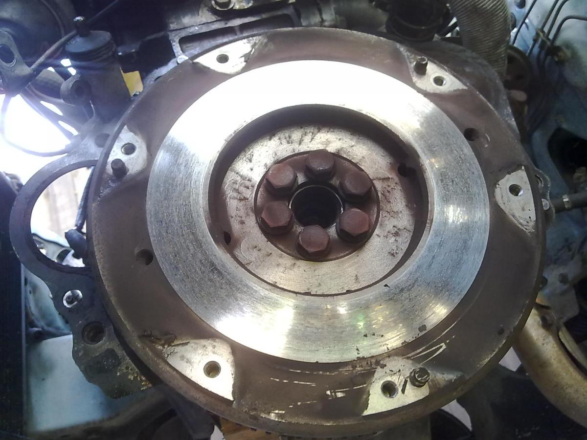

Flywheel was okay, gave it a good clean & a rub with some emery cloth after the photo was taken. REALLY should have gotten it resurfaced.....but Sunday... :( Odds are the clutch will outlive the engine anywho.

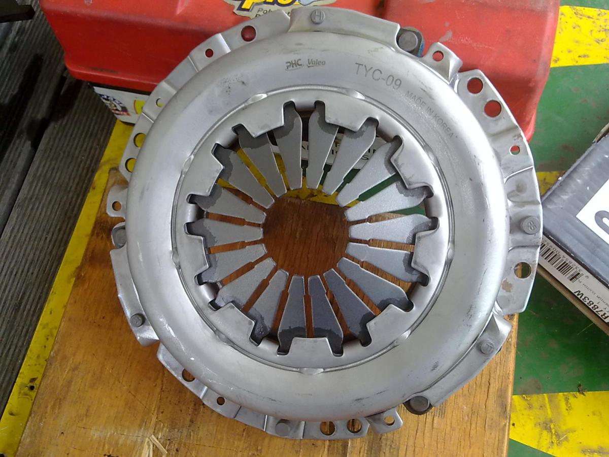

New pressure plate.

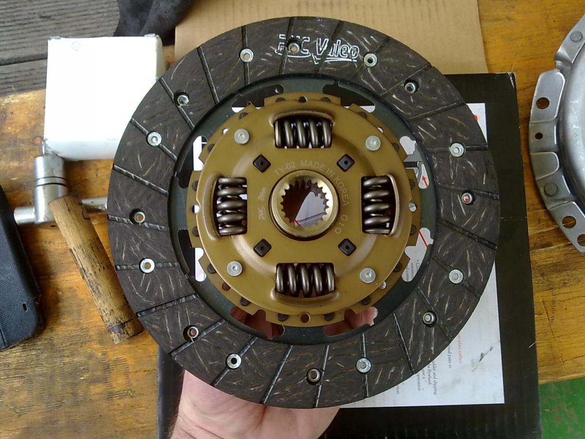

New clutch plate.

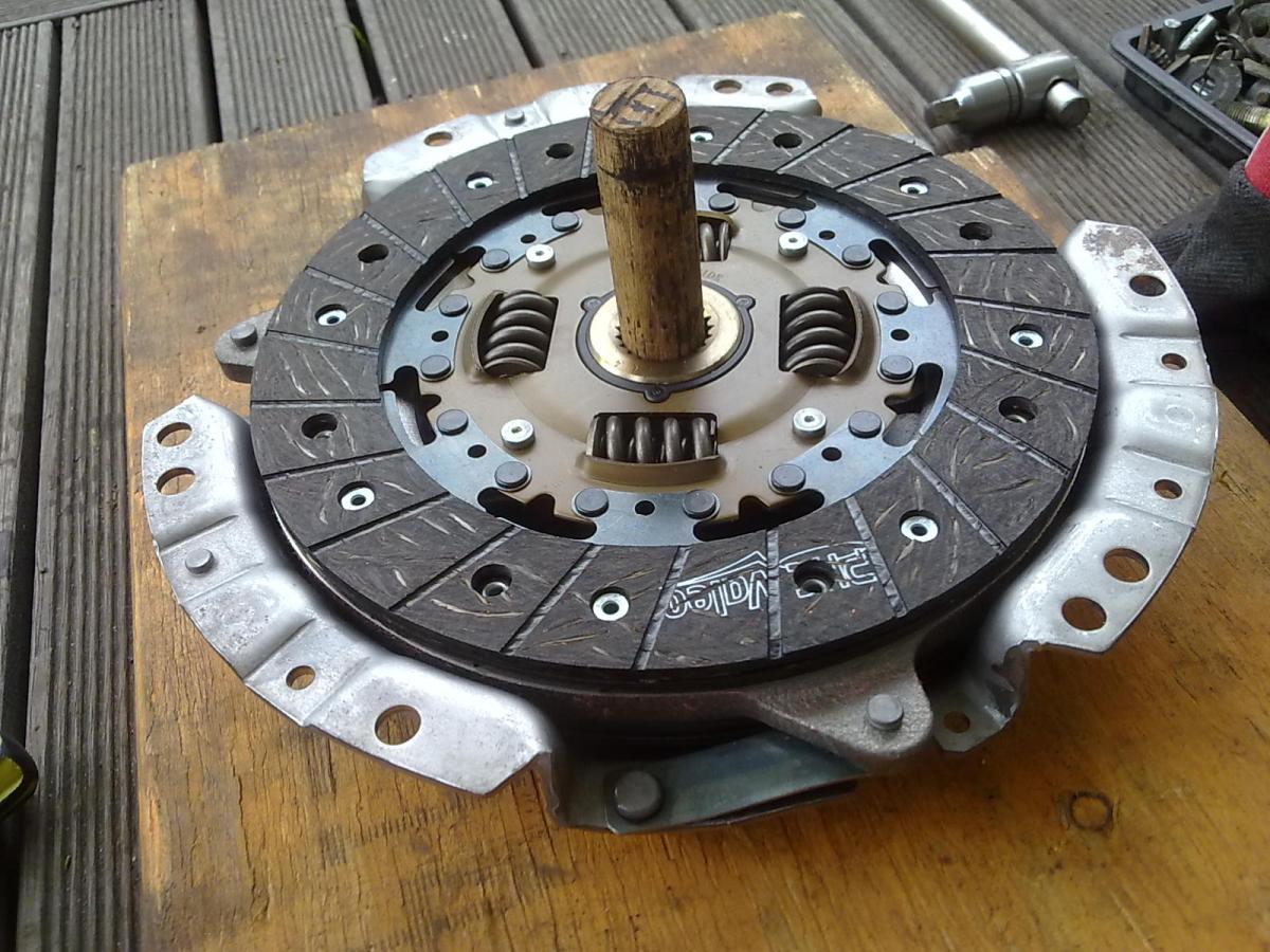

Complete with uber-expensive clutch alignment tool, sanded down broom handle.
Bolted the whole lot back together in a new record time, bled the clutch fluid to be sure & went for a test drive. Have never known the clutch to feel this light! Does skidz courtesy of rain, happy chappy!

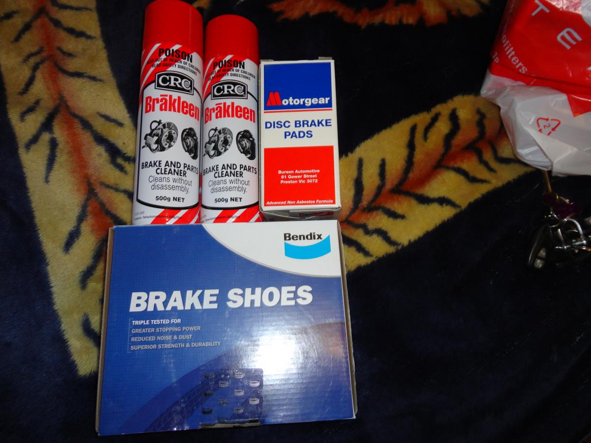

Well, my wreckers run was successful! Found a set of front discs & rear drums from an AE82 hatch that were in very decent condition. I think I know the cause behind the strange feeling in the brakes, the discs were worn under the minimum thickness (12.5mm), the drums just over maximum diameter (201mm) & all the pads/shoes had borderline minimum material thickness (1.0mm) left on them. Lesson learned on how hard trackdays are on parts compared to normal driving. :)
Replaced the lot in between rain & hail sessions, bled the system again & bedded the brakes in this morning. I have stopping ability again! :D
