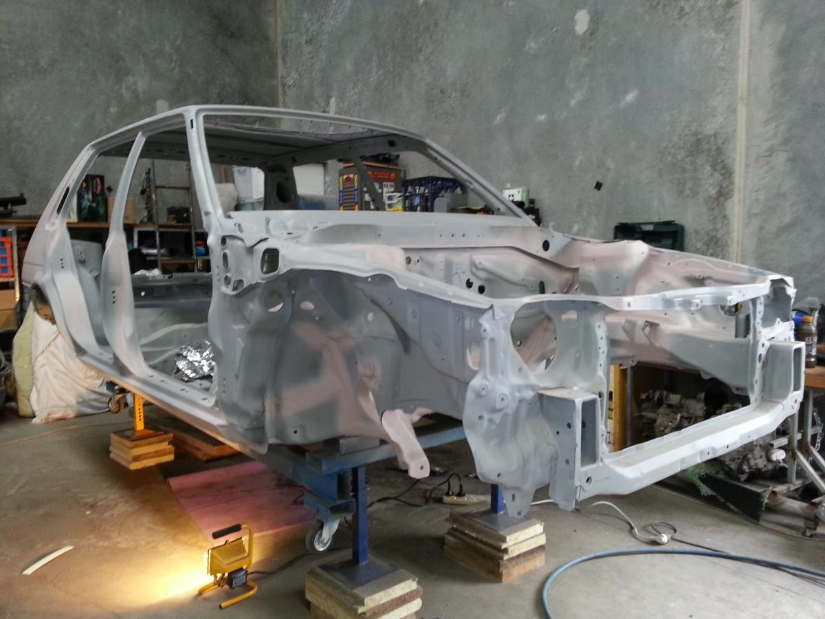

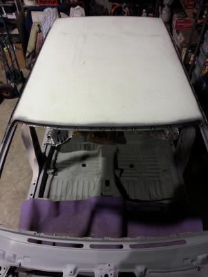

Things be happening again, as in, finally finishing the underbody grind/prime.

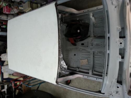

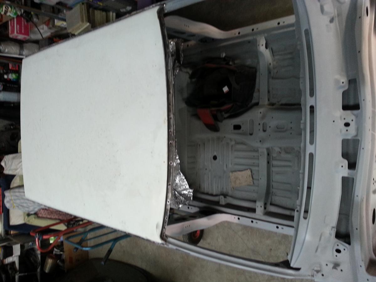

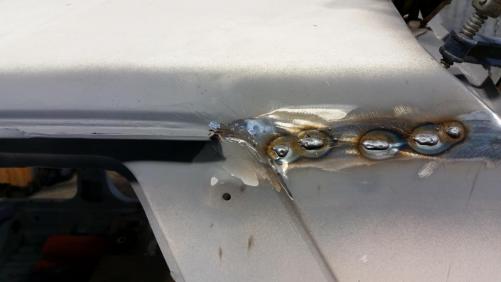

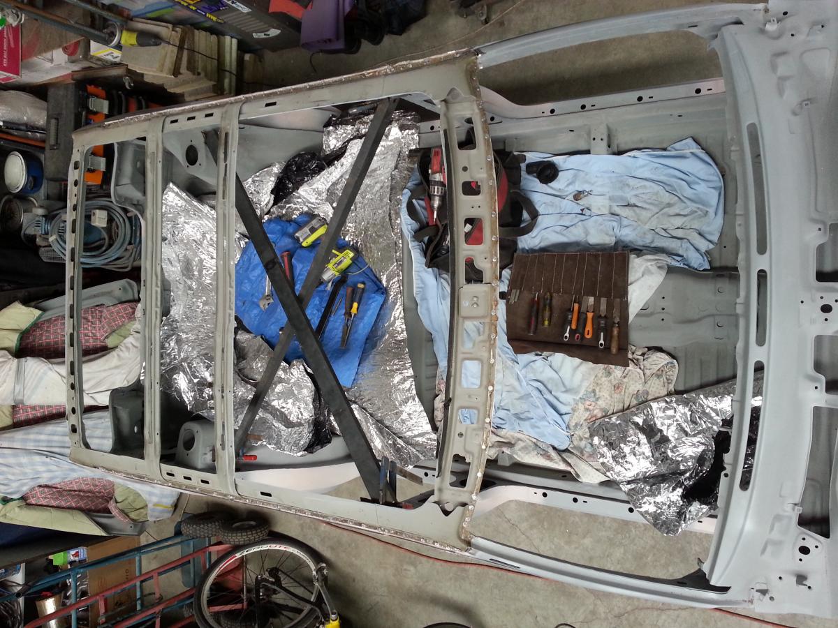

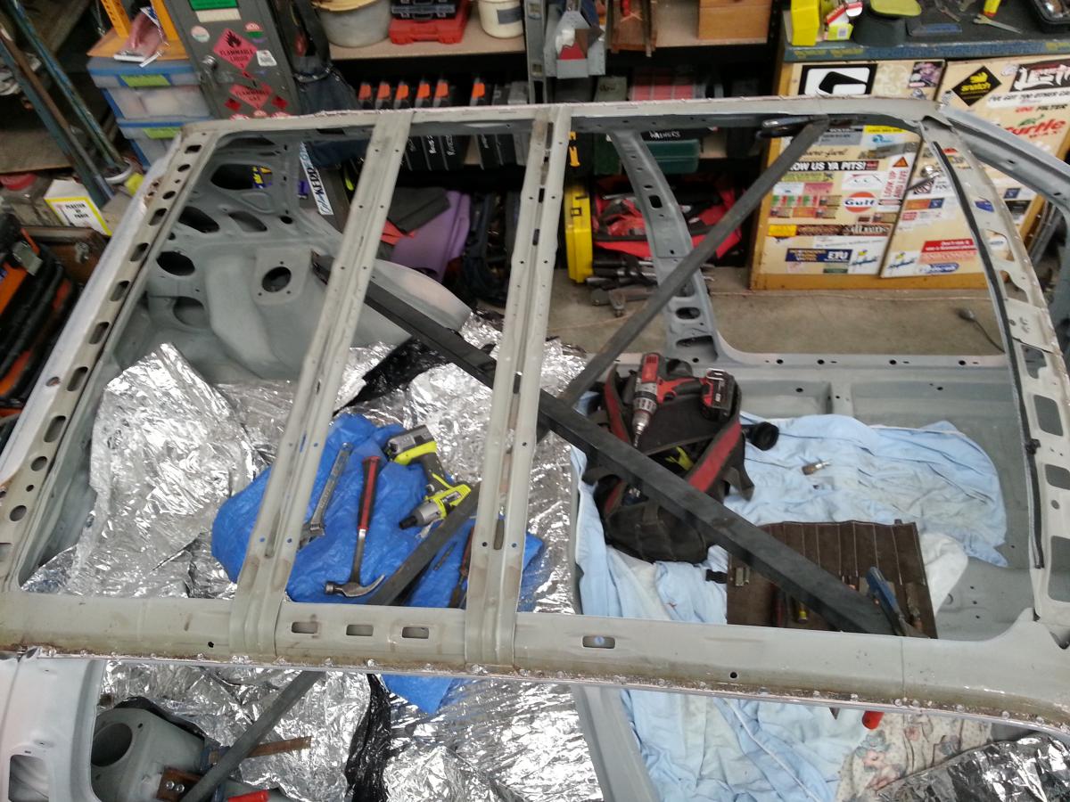

Since my welding caused a fair bit of distortion in the roof panel, I was beginning to run out of ideas as to what to do.

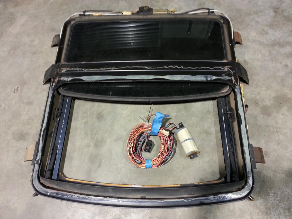

A random phone call asking if I was interested in an electric tilt/slide unit from an AE92 made that a bit easier. Scrapping the manual pop up option & am making this fit instead. Its size/shape allows me to cut out a lot of the distortion & it also braces the roof panel to reduce any flexing.

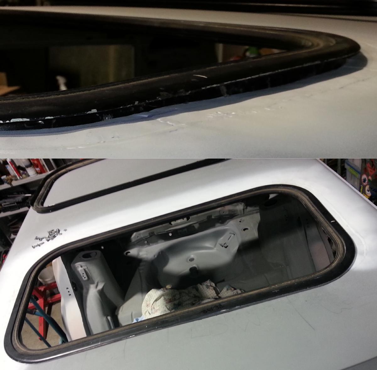

Back to Gokai, the AE92/3 sunroof isn't going to work. The roof panel supports are different between AE8x & AE9x, the AE82 ones will foul on the sunroofs installation & operation. Either that or the sunroof glass doesn't even come close to lining up with the existing hole.
**insert lots of swearing here**
Am seriously considering cutting the roof panel off & welding on one minus sunroof hole.
Have I ever mentioned how much I'm not a fan of sunroofs?
