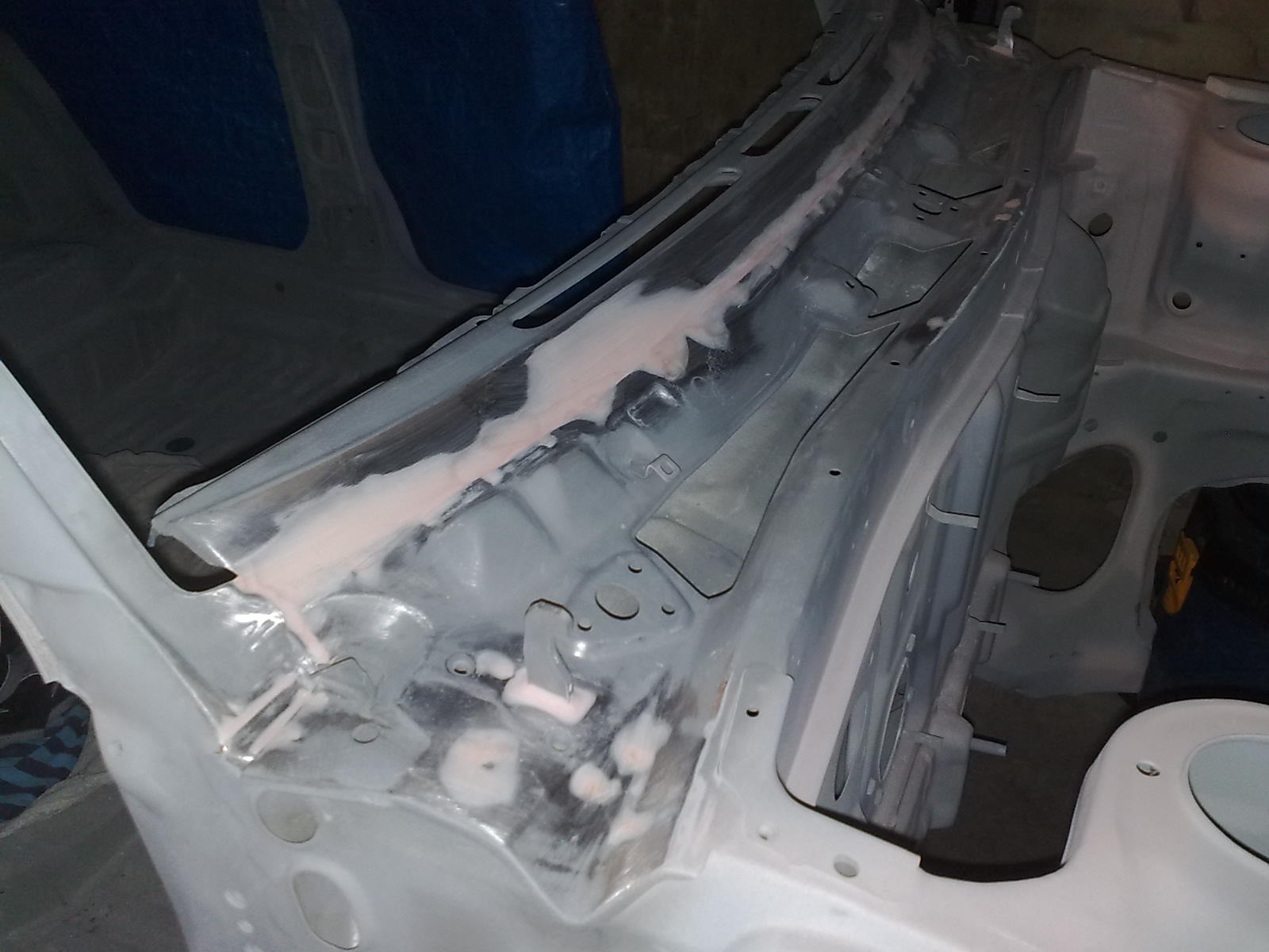

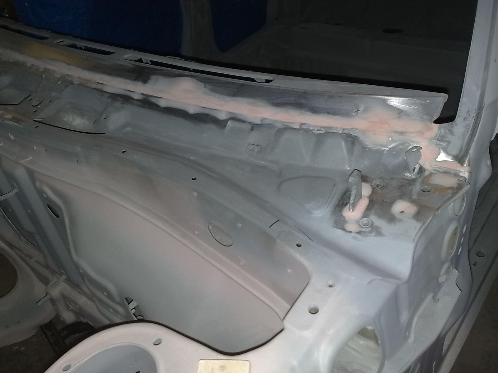

Didn't like the first round of filler while sanding it, gave it another hit.
*Removed finger*
Going for dinner to let the primer dry before I start sanding some areas that need moar attention! :wink: The more you look, the more you find, I should stop looking! :laff:
You know that feeling you get when you've forgotten something? I forgot to do the rear drivers wheel arch. :blush:
Fortunately, an absolute minimum of surface rust had formed (the metal had only really gone dull rather than shiny) so it was a simple matter of shaping the filler, giving it all a good sand, wash & it now has a lick of primer. Gotta stick my head back in there, there's a few spots that need filling. :laff:
