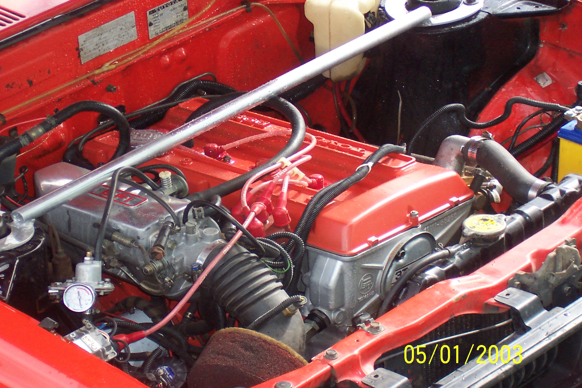

Quick update:
She passed rego (but my wallet didn't), has all of its electrical stuff done (cept the driving lamps)...
Then once the wheel alignment was done... Issues!!
Its got -6 degrees camber!! About 3 times too much!! The LATE model Sigma arms are too long, and I will have to change them for shorter, EARLY model Sigma arms. They are similar in appearance to the Corolla unit, but about an inch longer... Which should be perfect (fingers crossed)
