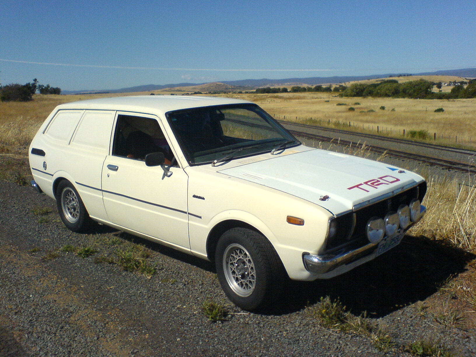

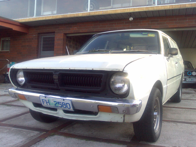

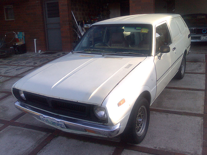

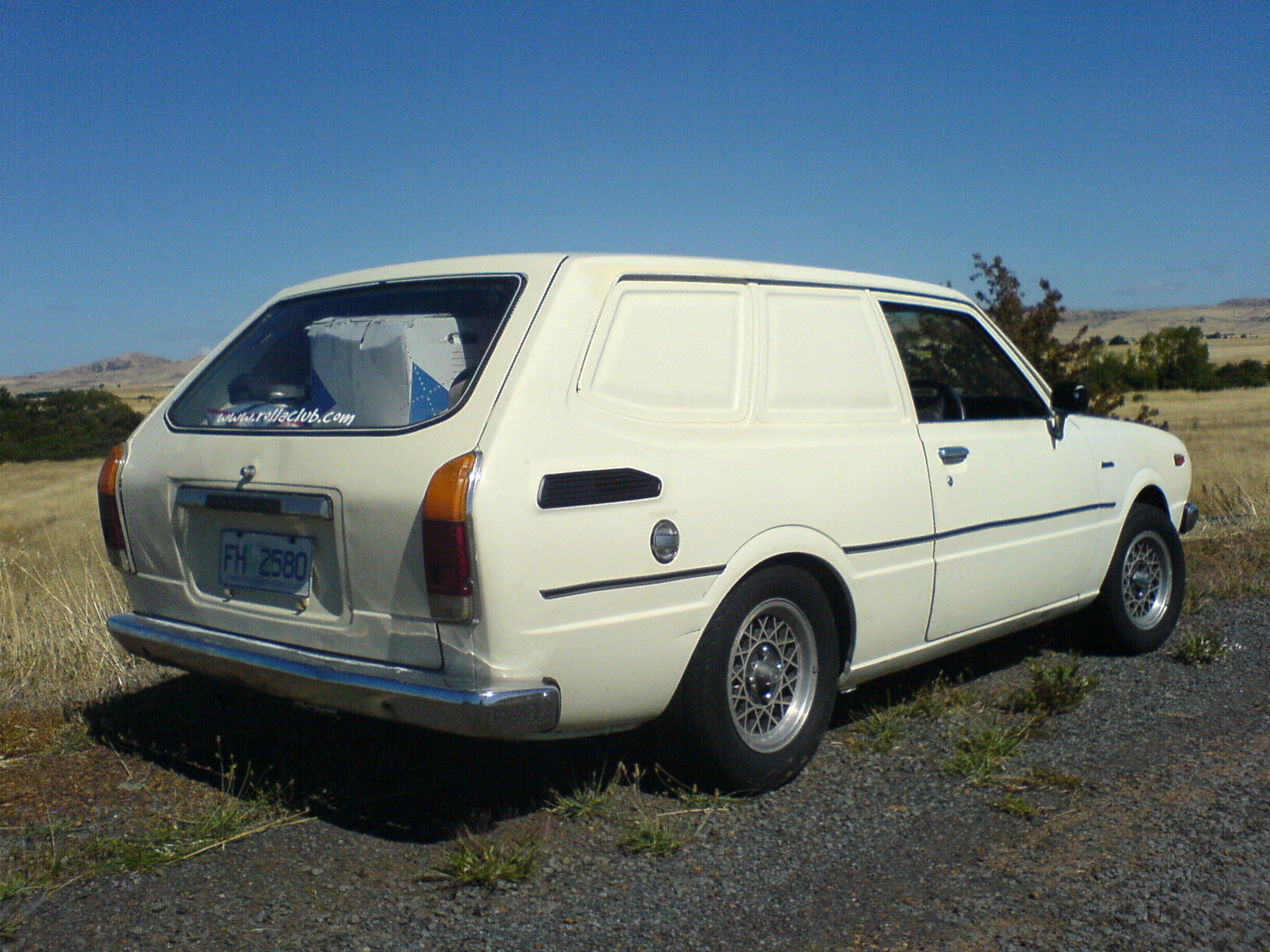

Well... Its to an acceptable, usable standard now, so:
Here Tis:

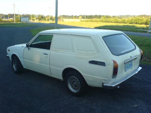

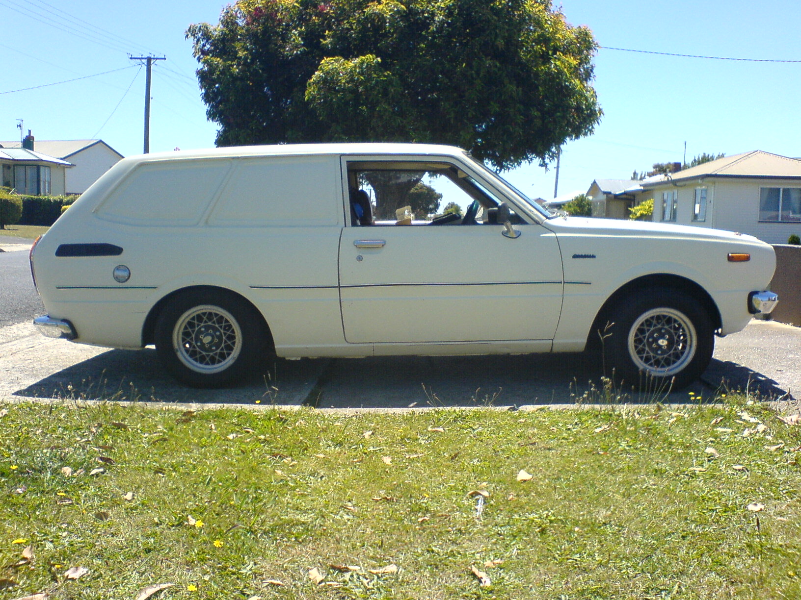

Pics 1 and 2 were the day it was regd.

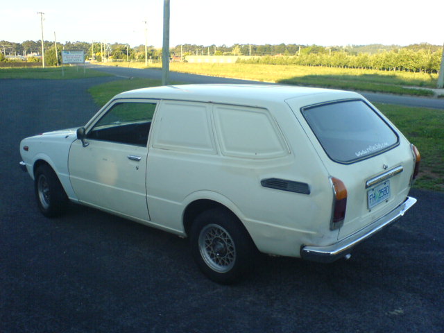

Pic 3 is a pic of the ride height... 300kms+ like this, and she still did 120km/h and passed people!! :y:
Pics 4 and 5 are in current condition. Taken on the side of the highway on my move to hobart... Note the rear ride-height.
Although I should have left the van springs under the back til AFTER the move... She got the bumpstops a few times!!

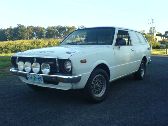

UPDATE: FEB 06...
Been a little while, but Ive been flat out trying to get used to hobart and get ready for uni next week.
P:36 (GIR, as its unofficially dubbed) has been pretty good. The driving lights are all hooked up, only issue there is that they vibrate and bounce like a muthaphukka... Will have to build some steady bars for the bumper. We are also part-way thru the alarm/immobiliser install. Changed the front engine seal, as it was knackered, and now she doesn't leak a drop of oil anywhere!! NOICE :D

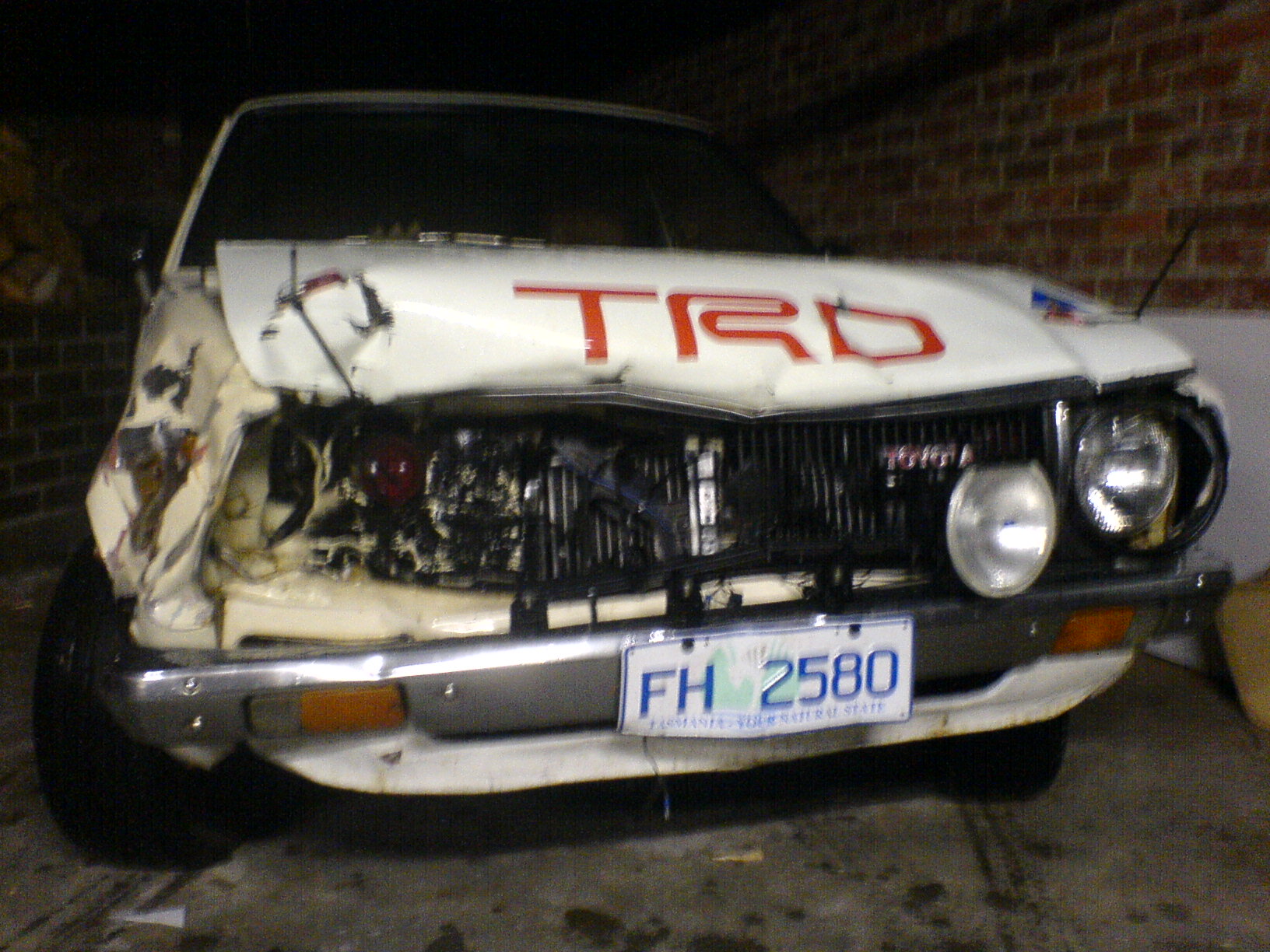

Collected a deer early in the morning.
Damage is fairly extensive, but thankfully majority appears to be non-structural (ie rails don't look damaged).
However, if there is structural damage, it'll more than likely be 'good-night Nurse'... Lets hope not :P :)
Stay tuned for more pics and documantation of repair (maybe some structural enhancement too??)
Gonna strip off the busted/bent bits and take it to the bodyworks to see if rails are straight...
If they are she lives... :)
If they aren't she dies... :P
