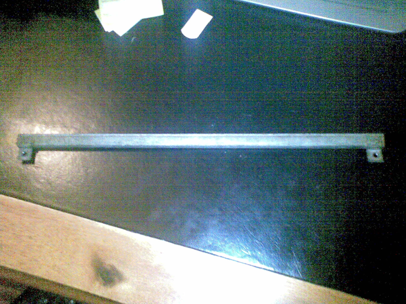

dbr11k Posted June 20, 2011 Report Posted June 20, 2011 sorry to gate crash a thread but i got new windows today (well second hand) put them in an than this come off.. would i be able to get back on or is it buggered? i don't wanna break the windows Quote
B.L.Z.BUB Posted June 20, 2011 Report Posted June 20, 2011 Silicone/glue them on, in the same place though. About 40mm of the windows aren't seen at the bottom so be generous. Quote
dbr11k Posted June 20, 2011 Report Posted June 20, 2011 mmm i might have to give it a go .. maybe epoxy or something? i tried putting it back on 5 times already and it just keeps popping off.. tried playing around with the regulator but it wont have a bar of it. Quote
Taz_Rx Posted June 21, 2011 Report Posted June 21, 2011 I'm now a pro at putting those rails back on. :lolcry: :wink: Push the rubber bit over the glass, then use a hammer to tap the rail onto the rubber. Don't be scared with the hammer as it takes a bit of force to get it back on properly. Quote
ke70dave Posted June 21, 2011 Report Posted June 21, 2011 i usually (yes it happends often) spread the metal bit open with a pair of pliers, put glass inside with rubber bit, put whole thing in vice..and squeeze it. then it will probably fall off again about 1 week later. silicon is the way to go! Quote
dbr11k Posted June 21, 2011 Report Posted June 21, 2011 yeah mine has fallen back off twice in two days so i think i might try lining it with silicone.. gotta love corollas hey ! Quote
