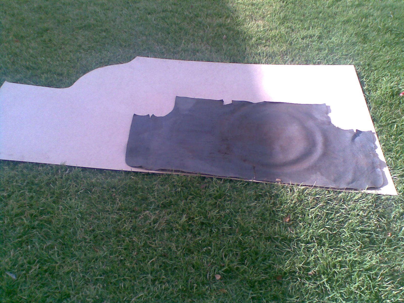

I used old underlay under my new shit. Knox stuff doesnt come cut out so save your old shit as a template.
I had to lay my old stuff on top of the new stuff and use chalk to mark the holes to cut out. Seatbelt/ seat rails etc

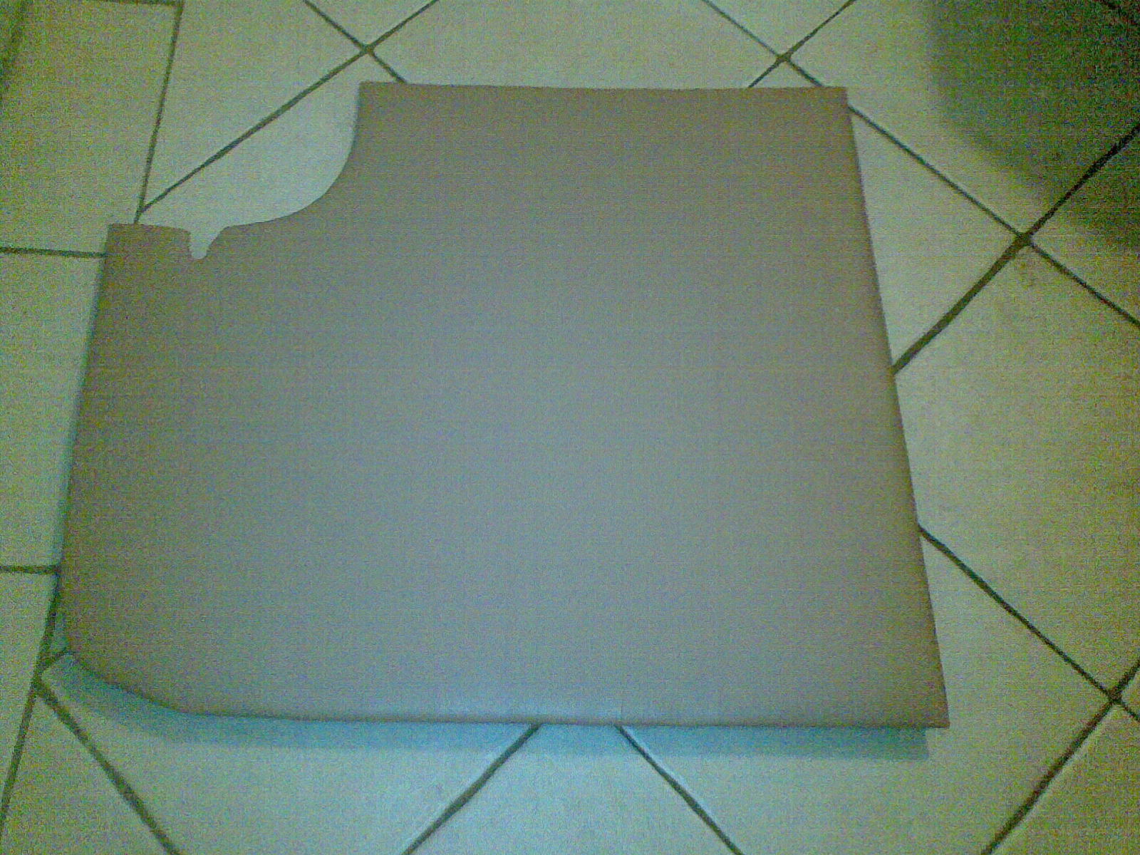

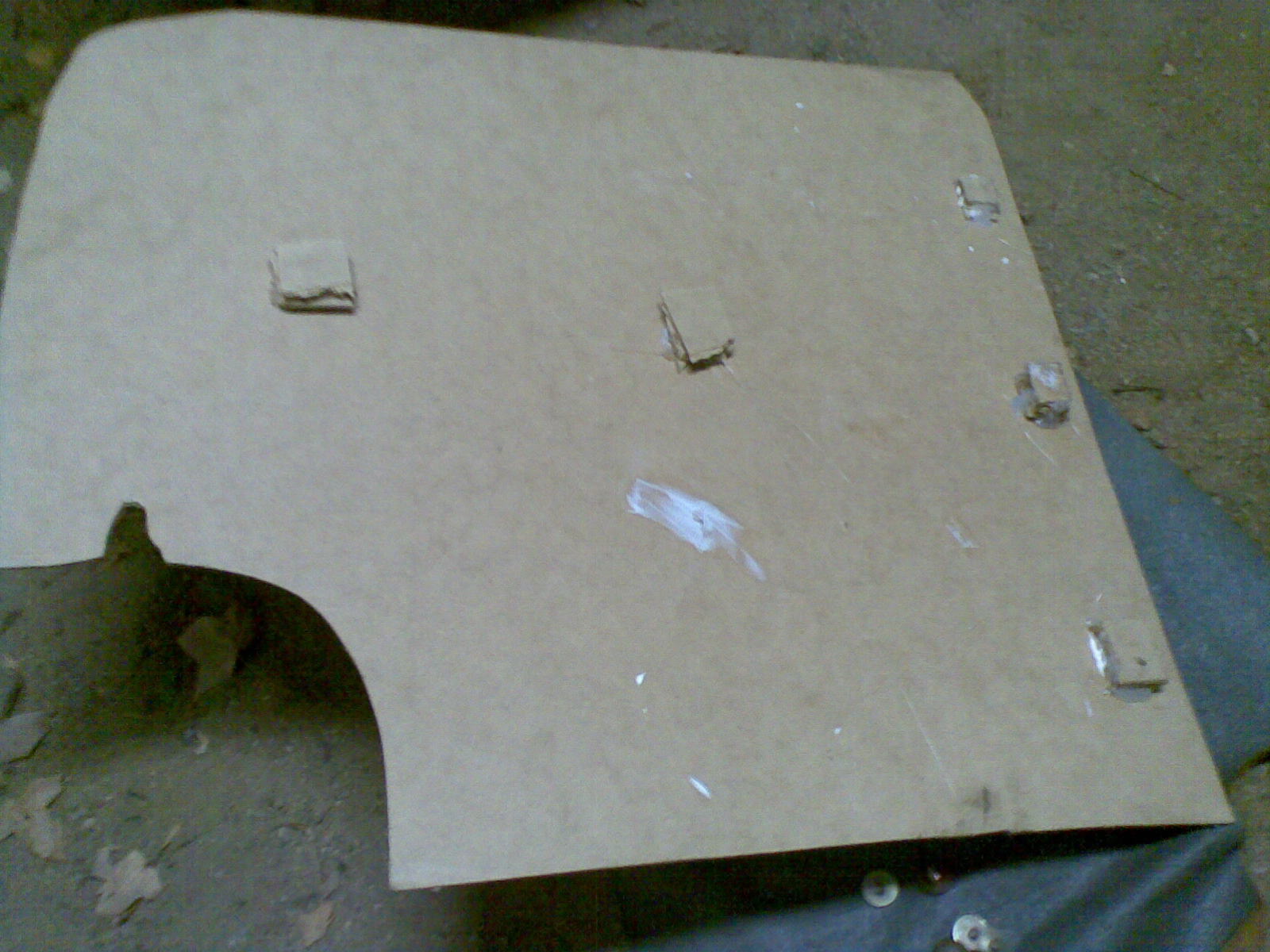

so i got around to buying a decent staple gun so i could re trim th rest of my door cards, made it a million times easier. we are only using old carpet underlay as foam just to save a bit of money, it works pretty well and makes them heaps spongey, also layed heaps of underlay down under the seats and anywhere we could to make it a bit quieter inside the car while driving, and glued some sound deadening stuff into the insides of the doors to make the stereo sound better.. only got two more door cards done as one of th cards was mouldy and falling apart :/ so we will hav to cut out a new one tomorrow when we do the parcel shelf, than after that we decided to re trim th boot while we are going as we have about 5 metres of vinyl lol :P

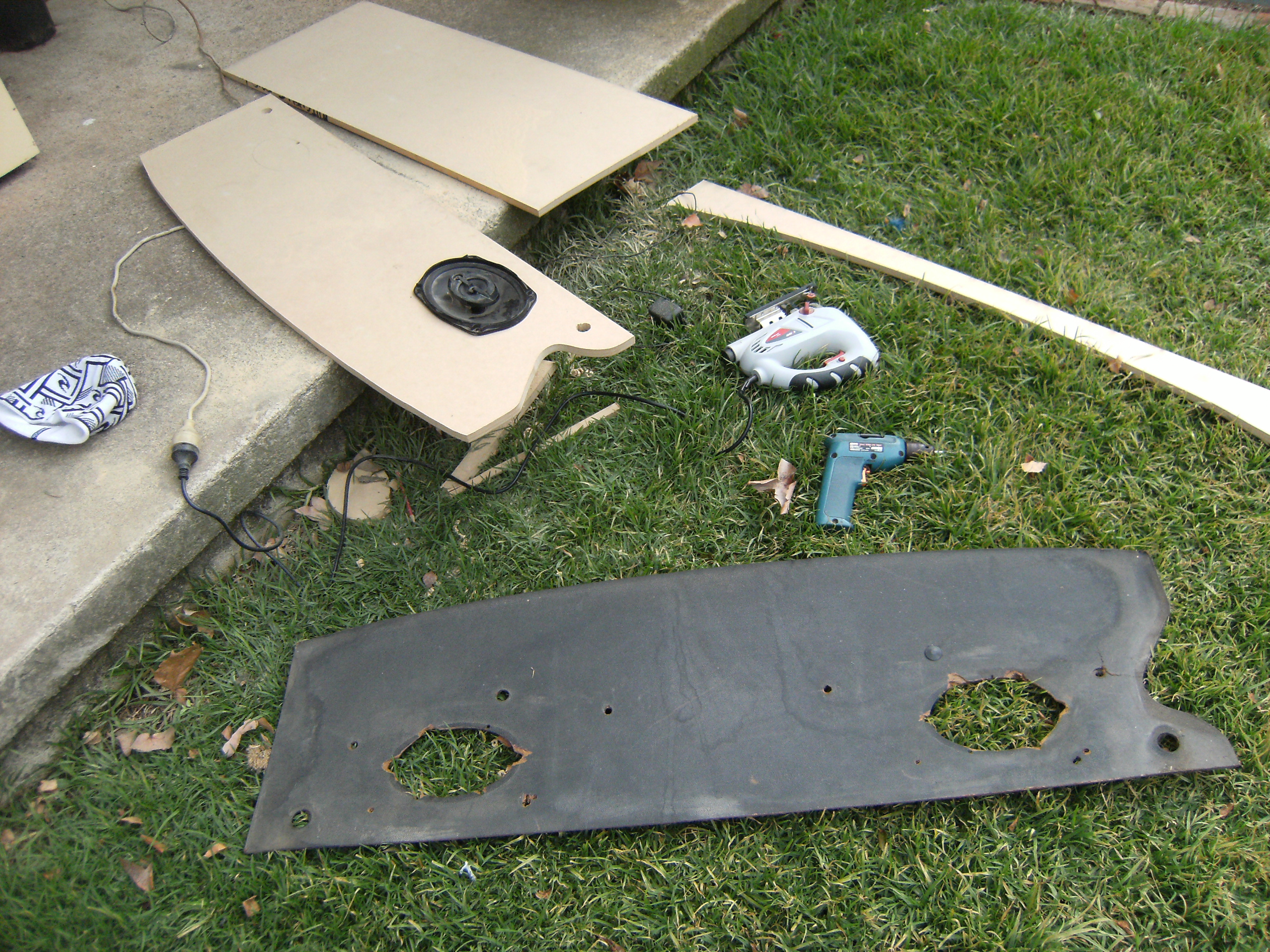

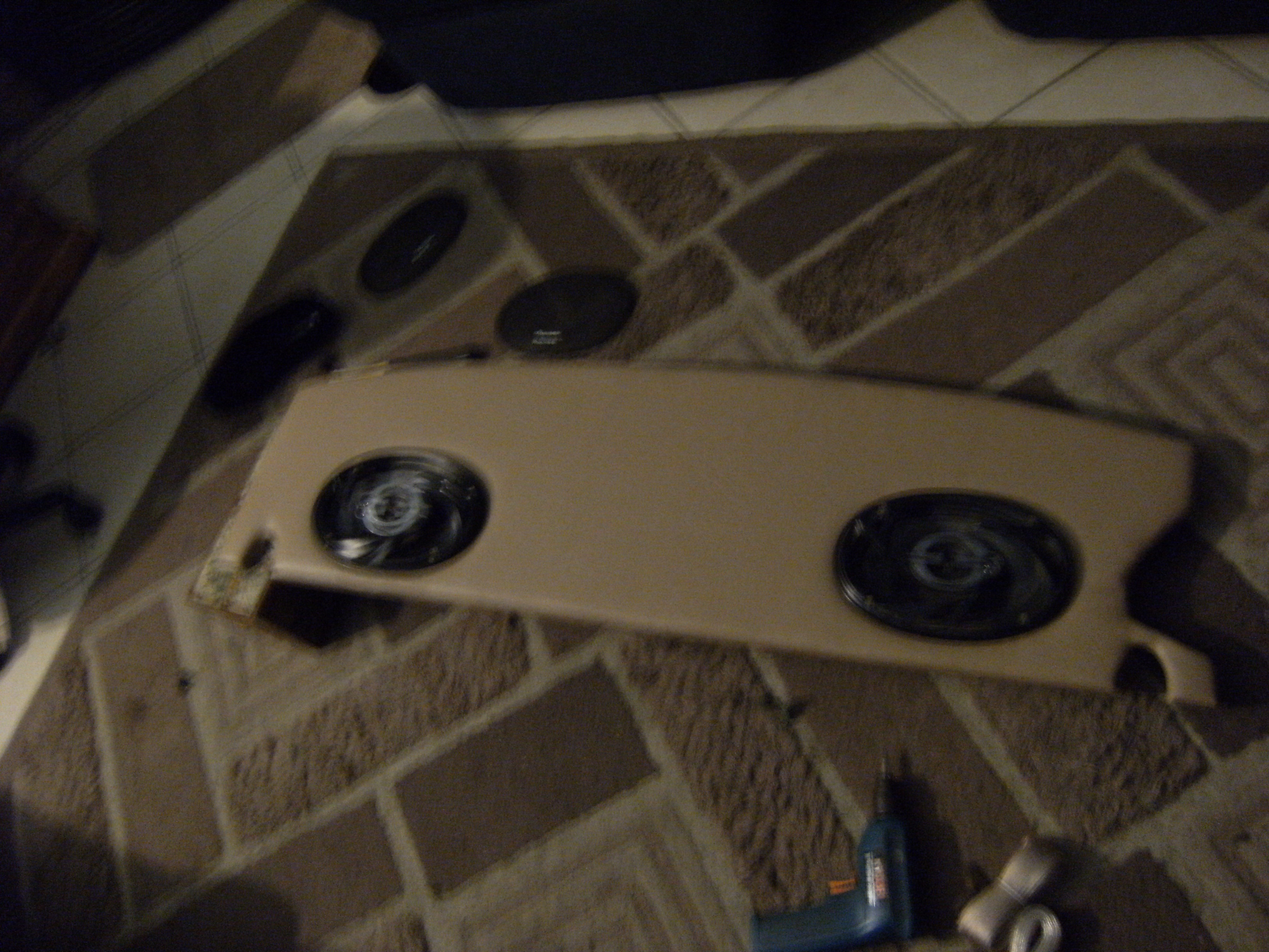

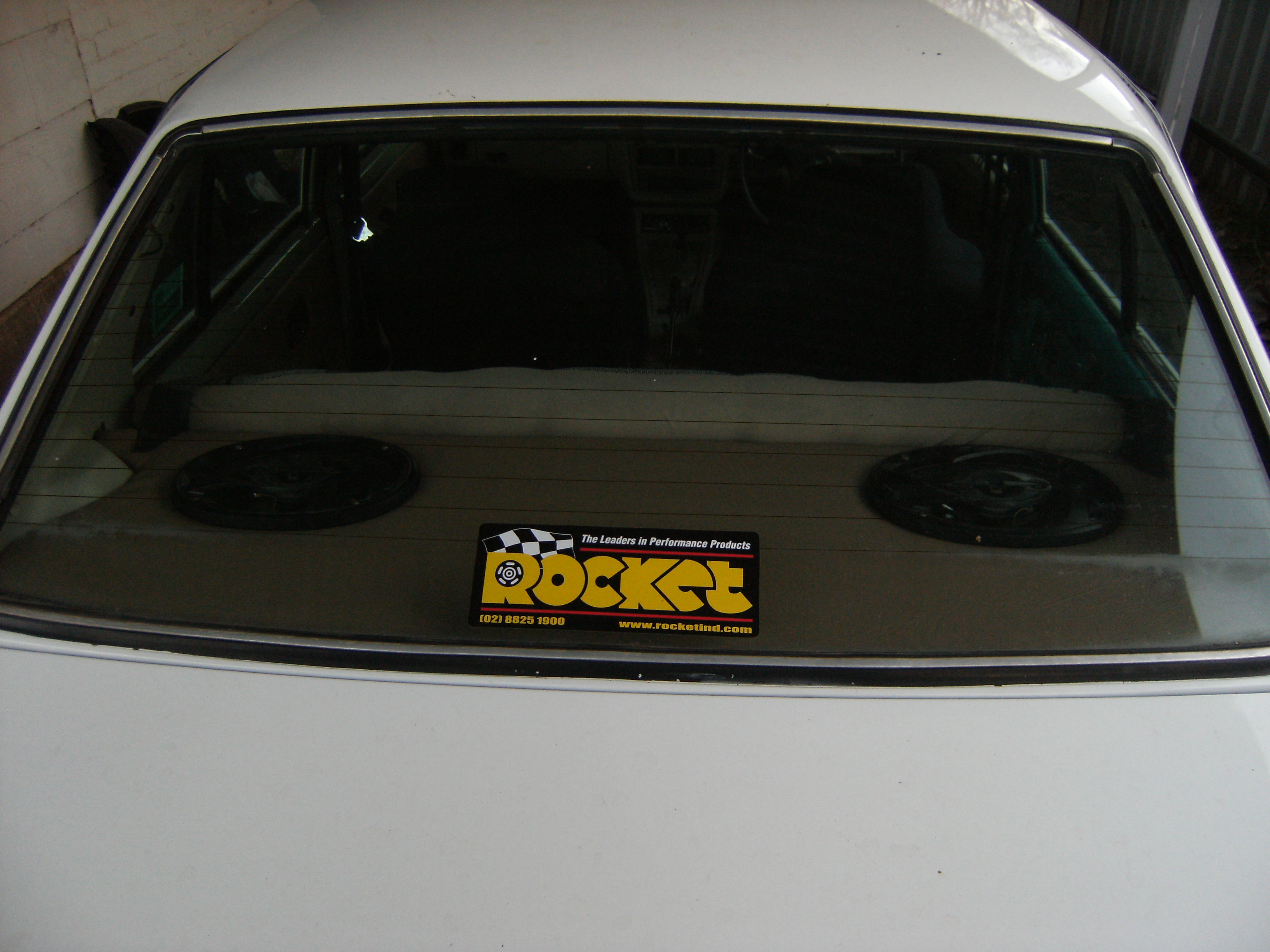

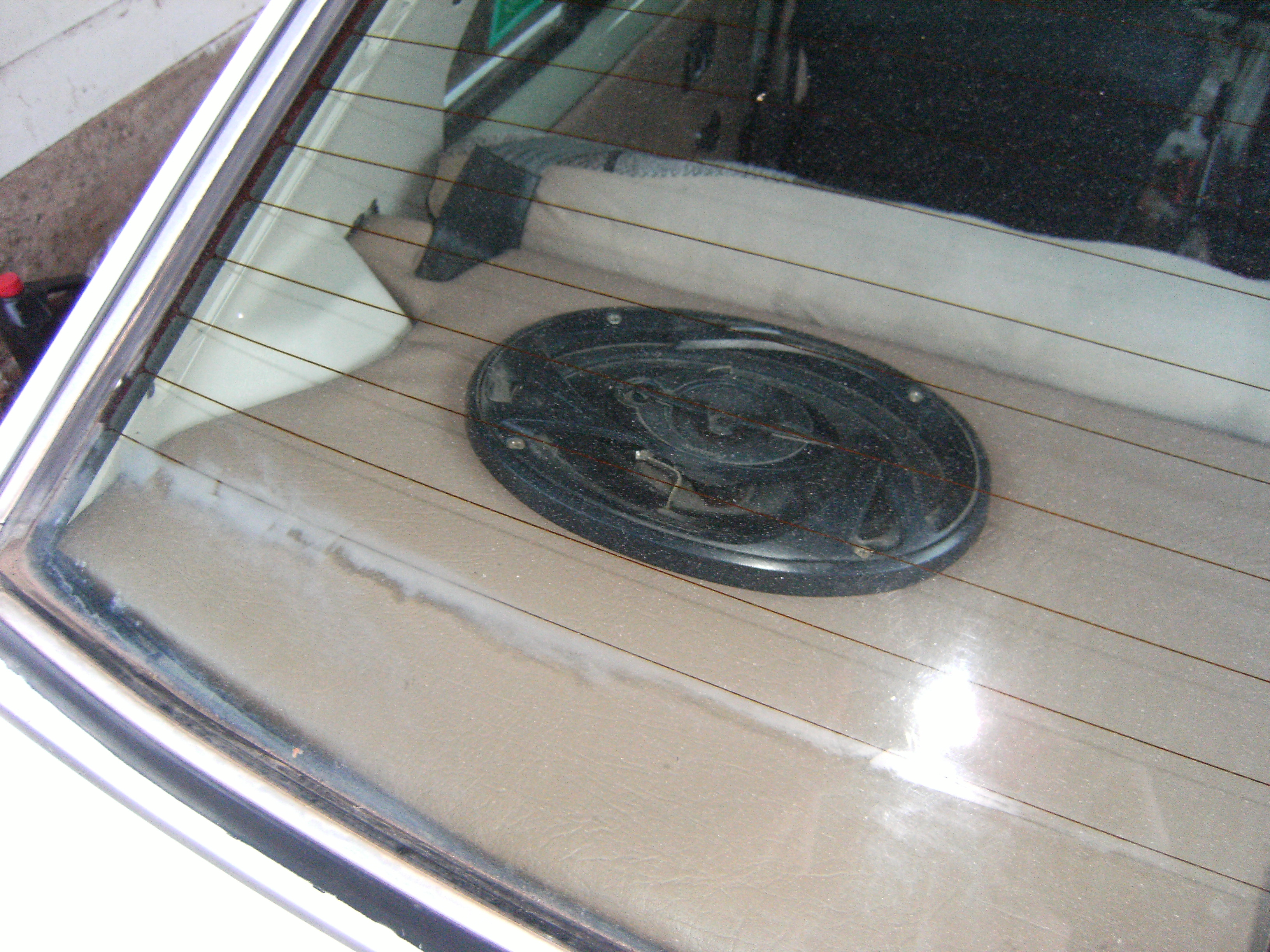

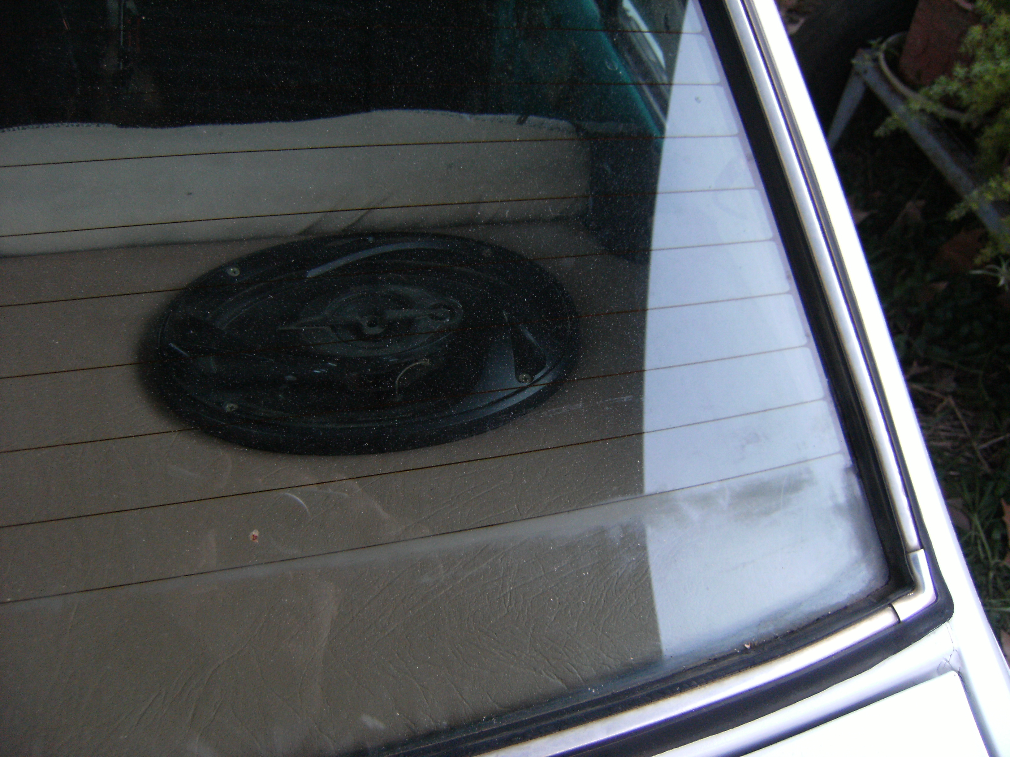

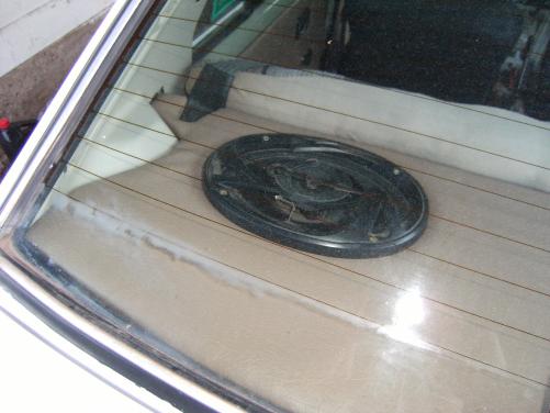

so, finished making the last door card and trimmed it, and finished off the parcel shelf this arvo and fitted some 6x9's, they're only running off the head unit at the moment but actually sound really really good considering they aren't anything special like components or anything like that, later on when i find some amp cable, I'm going to run all four speakers off a 4 channel amp.. and a mono block amp for the boot after i get around to fibre glassing some sub boxes for it..
the parcel shelf was a dead set c%^*t to get right but after test fitting it 20 times it didn't come up to bad

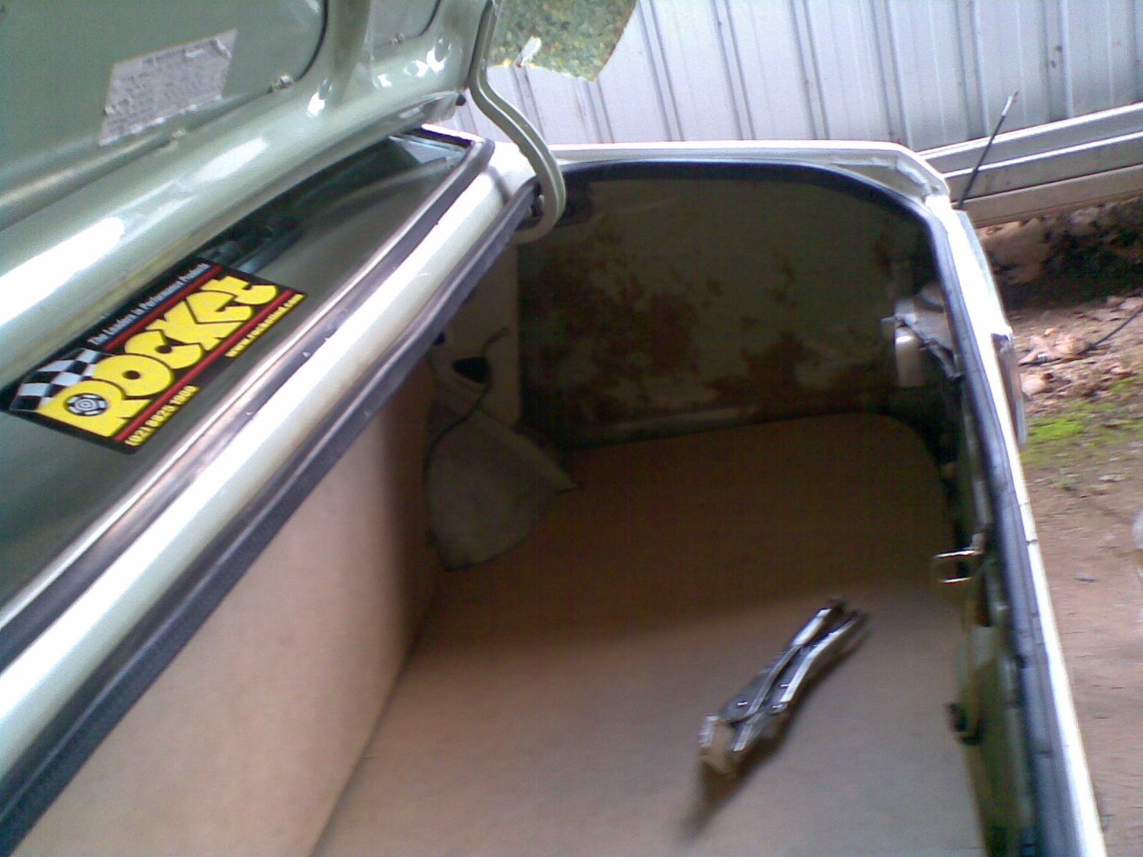

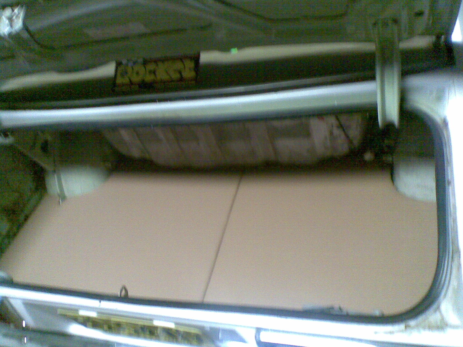

started off working on the boot this arvo .. also went a bit mad last night and bought some decent 4 ohm dual voice coil subs at 400wrms each.. and bidding on a sound stream tarantula.. hopefully i win cause i haven't done a decent stereo set up yet and that amp would be a great start running 2000wrms at one ohm stable.. until i get the amp i can't do to much more to the boot as i want to make a dummy fuel tank cover and mount the amp embedded into it. also lookin at some fatmat or dynamat, beofre i start the fibre glassing of the sub boxes... when funds prevail of course ..

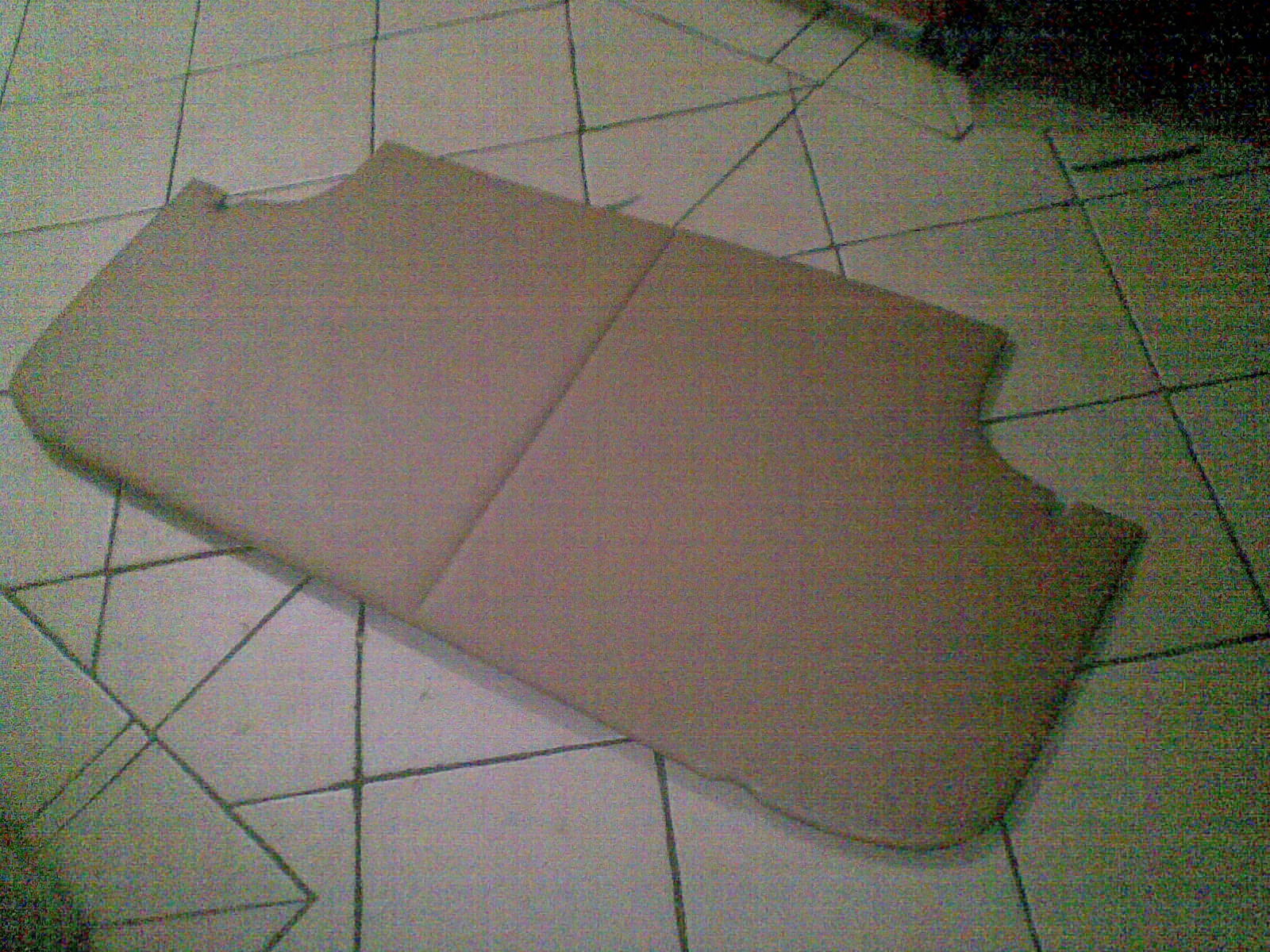

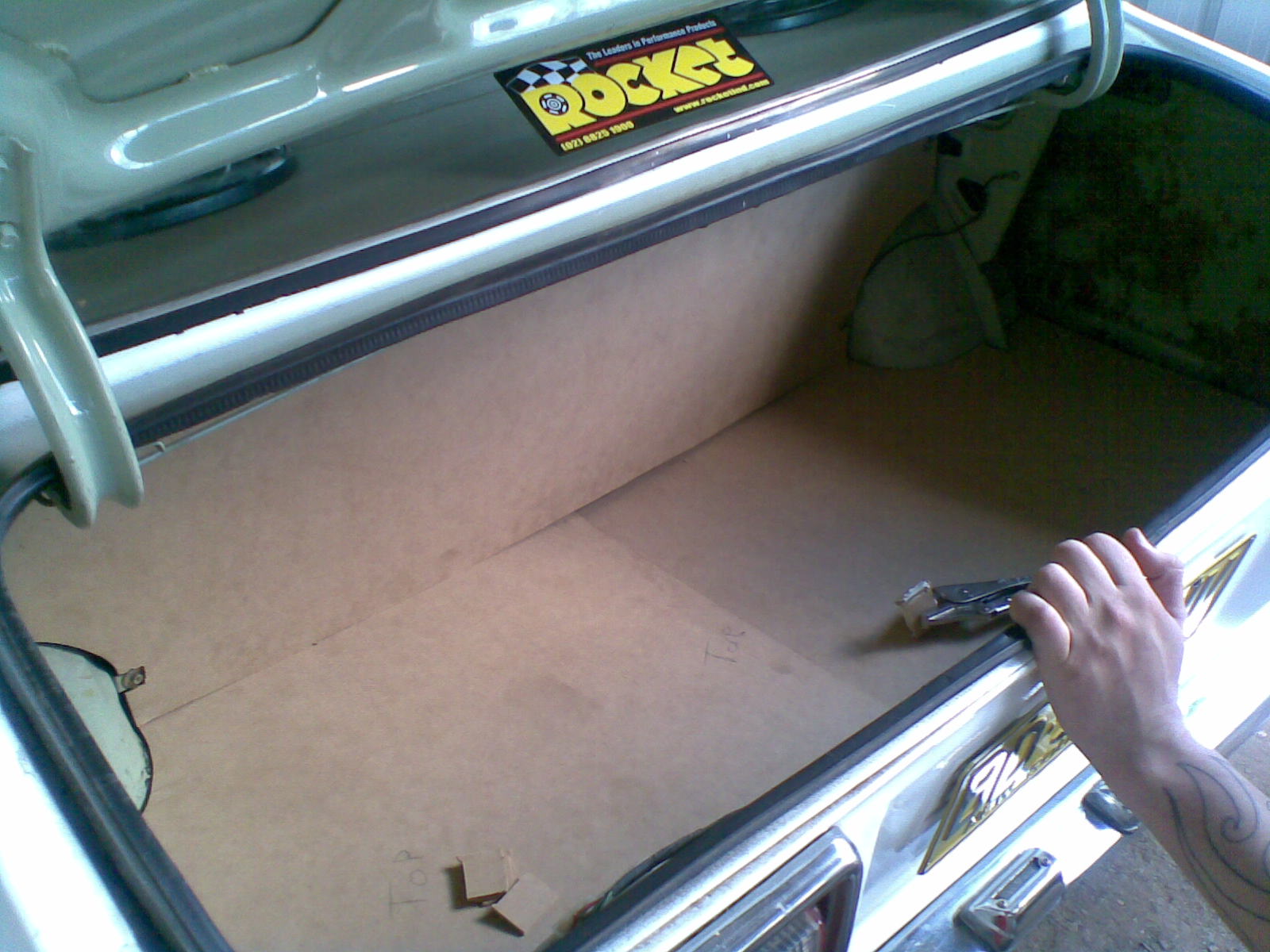

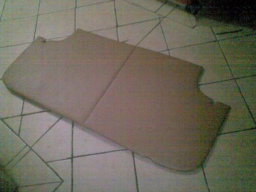

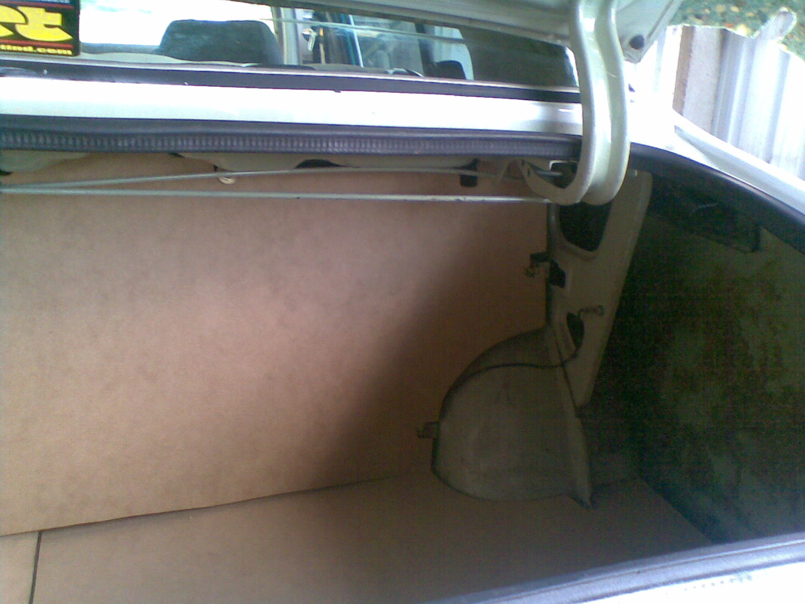

unfortunately i had to cut the floor in half to get it in the boot lol .. but it still looks pretty neat i suppose.
i put some sandwiches under it to help it sit even.
all trimmed up.
