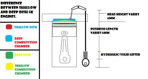

Yes, i'm running this conversion and it works. If your running a dished piston 5k with hydraulic lifters you'll need a 4k cam or your current one reground, a 4k-c head, adjustable rocker gear, the holden 202 red motor lifters and the A12 pushrods.
The lifters come in sets of 12 but some parts stores will order/sell then individually. The pushrods will probably be the hardest thing to find. I manage to find a dude on ebay USA selling lightweight items out of Japan.

You don't have to use the 4k cam it's just that 4k's have solids lifters as standard. If your 5k currently has hydraulic lifters you will need to have it reground to suite solids.
But this is where everyone tells you the conversion is a waste of time.

Well. The reason behind it is to run the 4kc head for lower compression for a turbo build. If there was another way around it i'd do it
Would normal a12 pushrods suffice?

Standard a12 pushrods are fine. It's the length that makes the datsun rods ideal @ 152mm.
